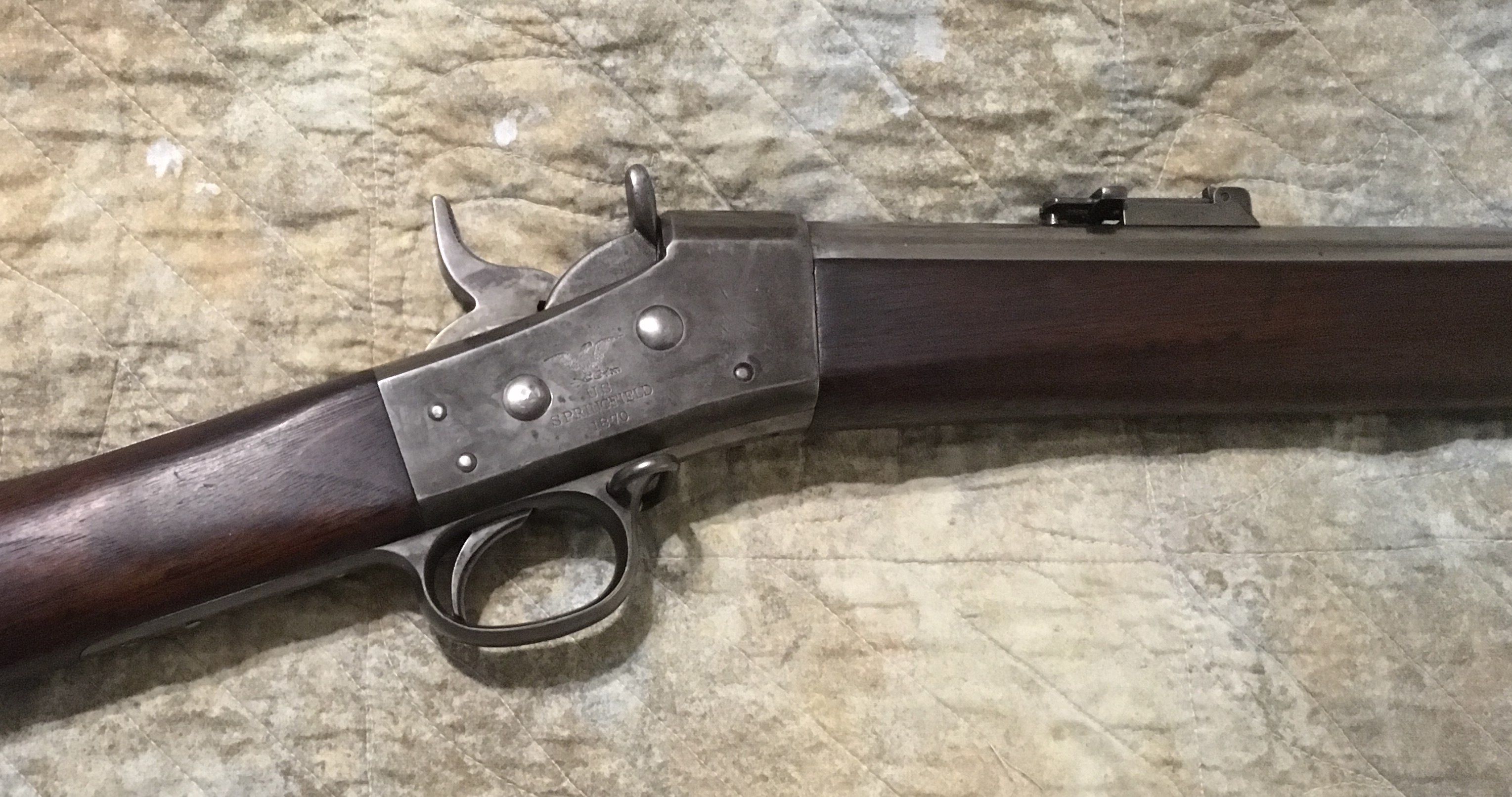

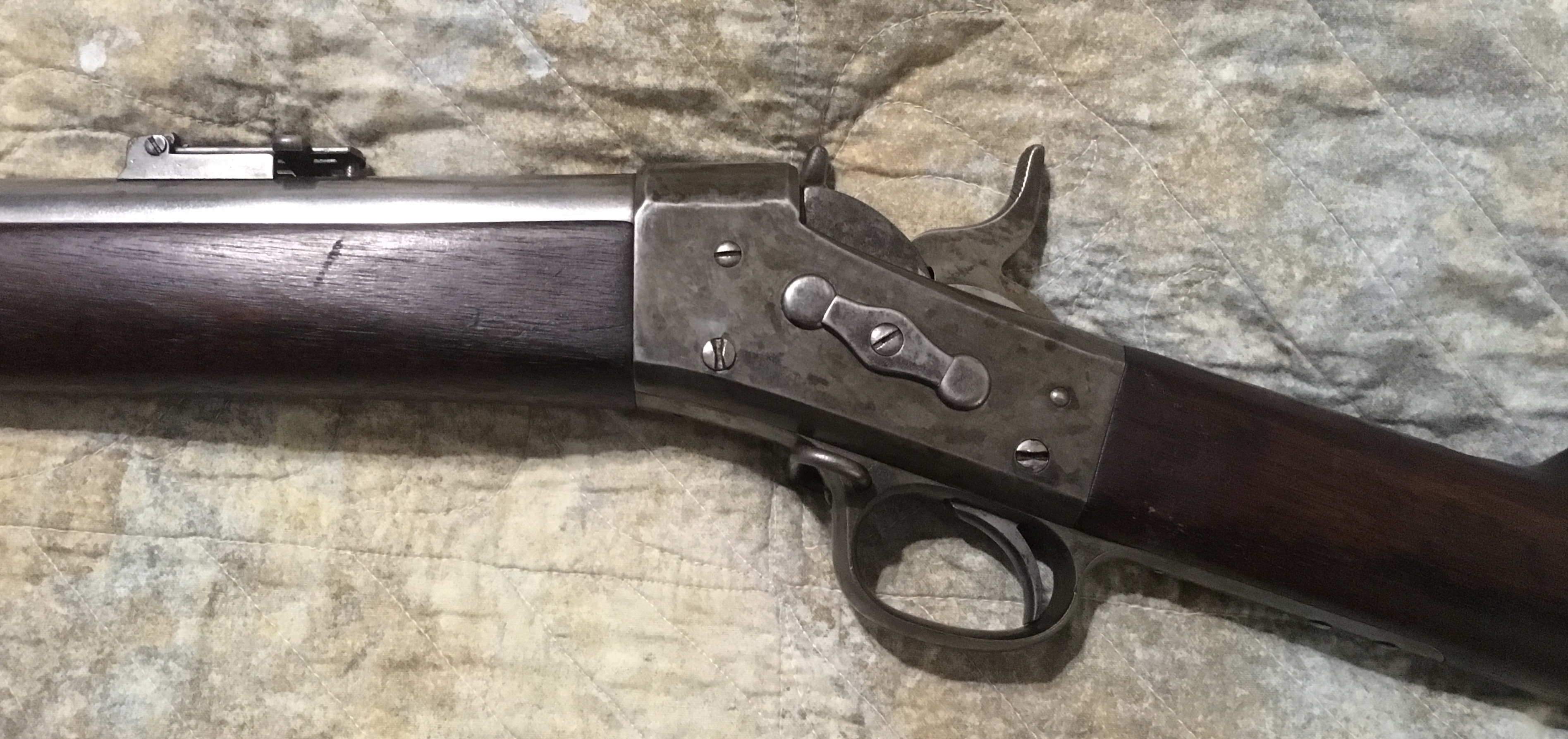

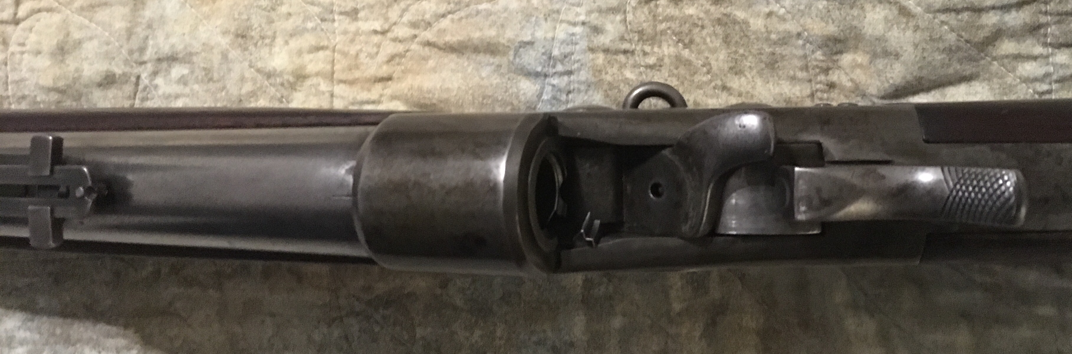

I have An SA Rolling Block I picked up on a whim, while looking at an estate gun collection with Enfield and S&W’s. I am a 10 year collector of Enfield rifles, so this is an ancillary find.
It appears to be an 1870 trials rifle. BUT NOT 100%. Wonder about breech block without side screw. Also, could this be an “oops” Franco/ Prussian rifle that got out with the rear sight in the “correct” location.

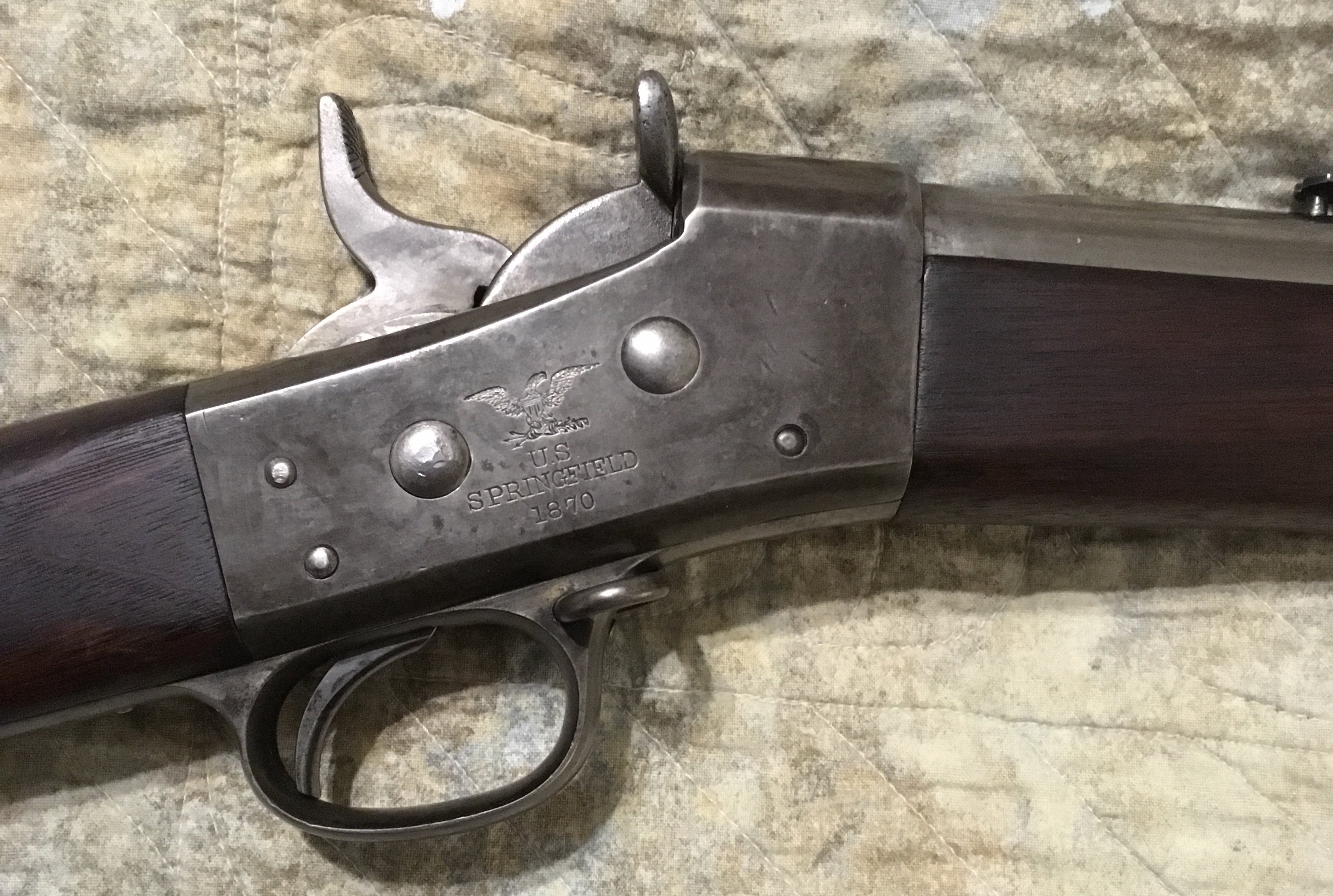

Receiver Left side: No marking. Right side:
US (no “N”, and no sign of it being removed)
Springfield
1870
Appears to be a type 2 receiver with a non concave breech block.

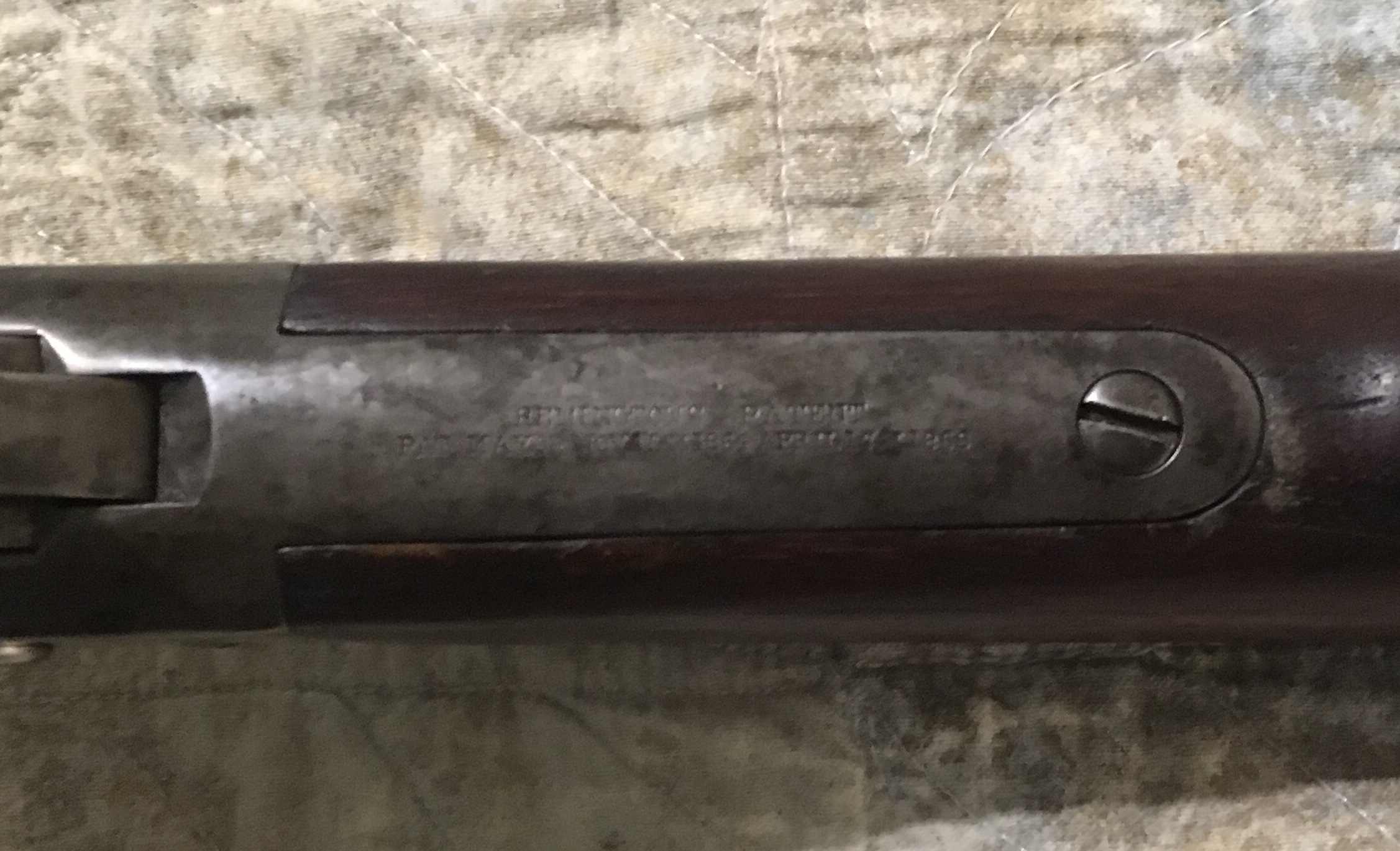

Tang is marked:
Remington‘s Patent
PAT. MAY 3d (line under superscript d) NOV 15th (superscript underlined th). 1864 APRIL 17th (ditto) 1868.
The barrel is 32 5/8” long with NO bayonet lug (except barley corn front sight). There is NO anchor on the barrel just in front of the receiver. (also no sign of it being removed) The witness marks line up. There are 2 barrel bands, both marked with “U”,s. There is a notch to retain the cleaning rod. It is chambered in 50-70.
The rear sight is 3 1/8” from the receiver ring. The sight is the same as I have seen on other Navy and Army rifles. The ladder is marked 2, 3, 5, 7, & 9.

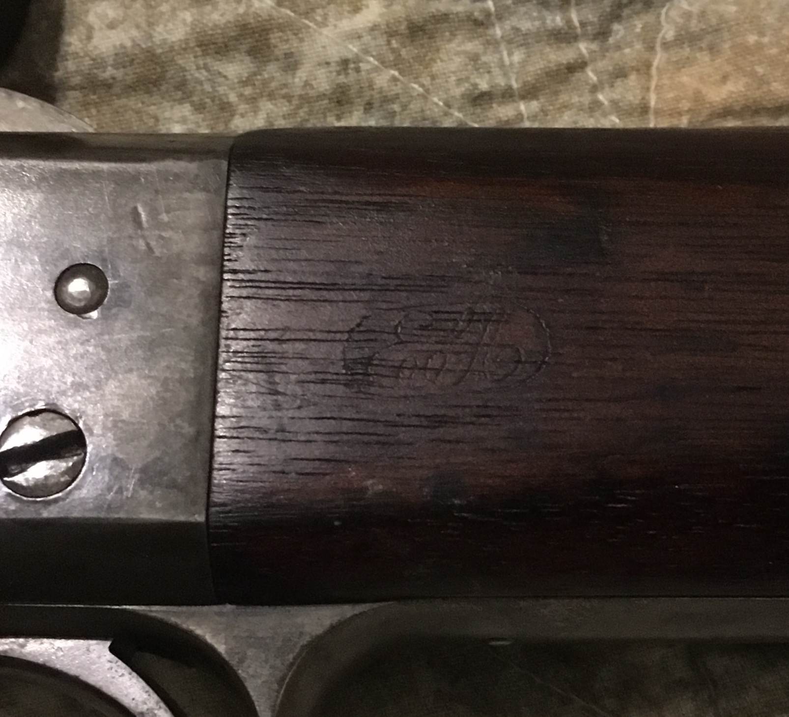

The stock cartouche is ESA.
I have attached pictures.

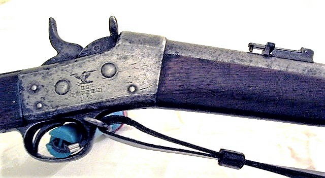

More pictures of the receiver, tang, front sight, barrel bands, etc...

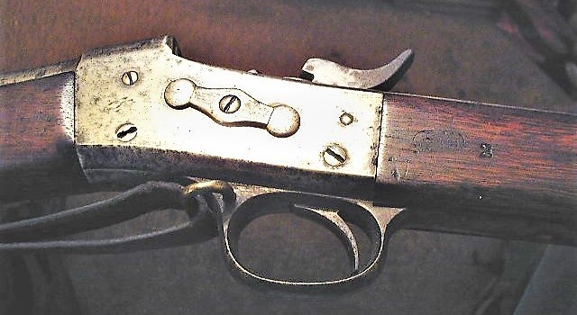

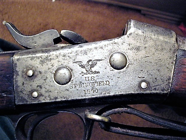

Hello DeLisle45,

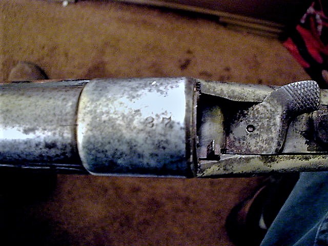

What you have is a Springfield 1870 Trials Rifle. The only thing that I can see wrong with it
is the breech block. The breech block would have a screw going through the breech block to
hold the firing pin in place. Also the firing pin would have been spring loaded to keep the firing
pin from protruding out the front front of the breech block when the hammer was cocked. So
I believe that the breech block is a replacement. Below are some photos of my 1870 Rifle, sorry
for the poor quality they were taken at 15 years ago.

Thank you. That is what I sorta figured. The breech block is why I wasn’t 100% on the ID.
Is there a specific breech block for those rifles? It would be interesting to try to get a replacement breech block. Sources?
What are these things worth? I’ve seen auctions go from less than $2K to over $3.5K, for similar condition. Though in all fairness, they did have the correct breech blocks.

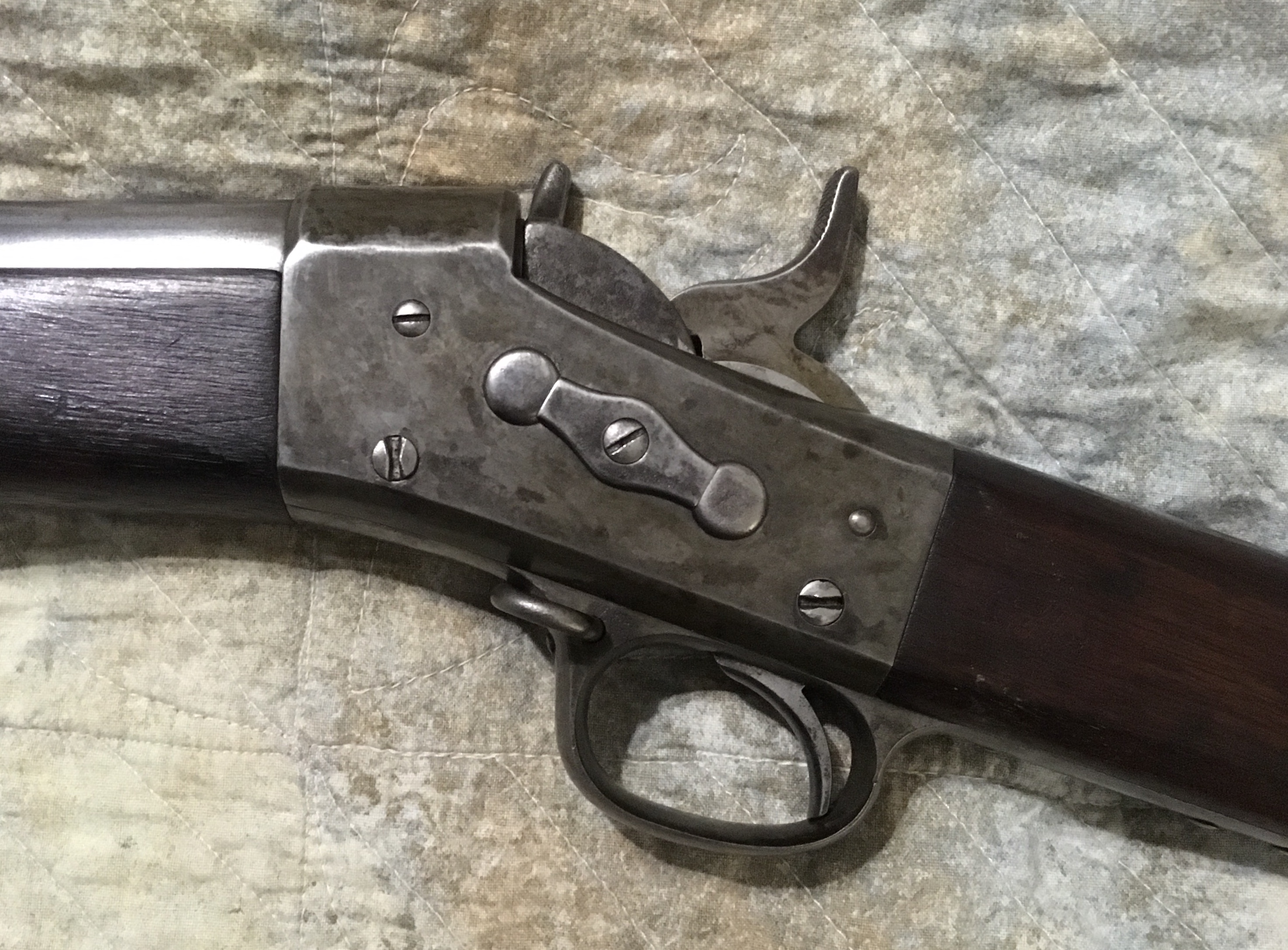

Hello Neal,

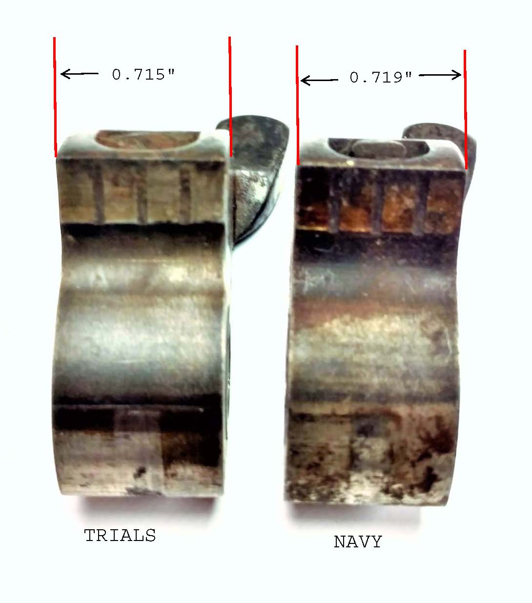

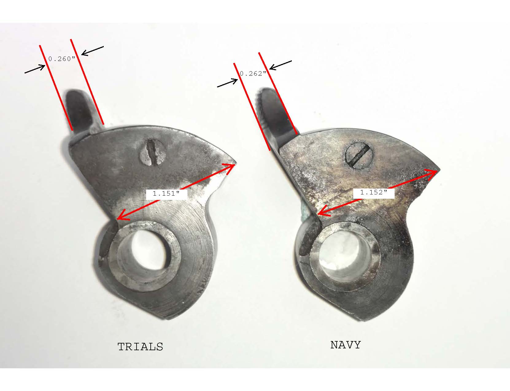

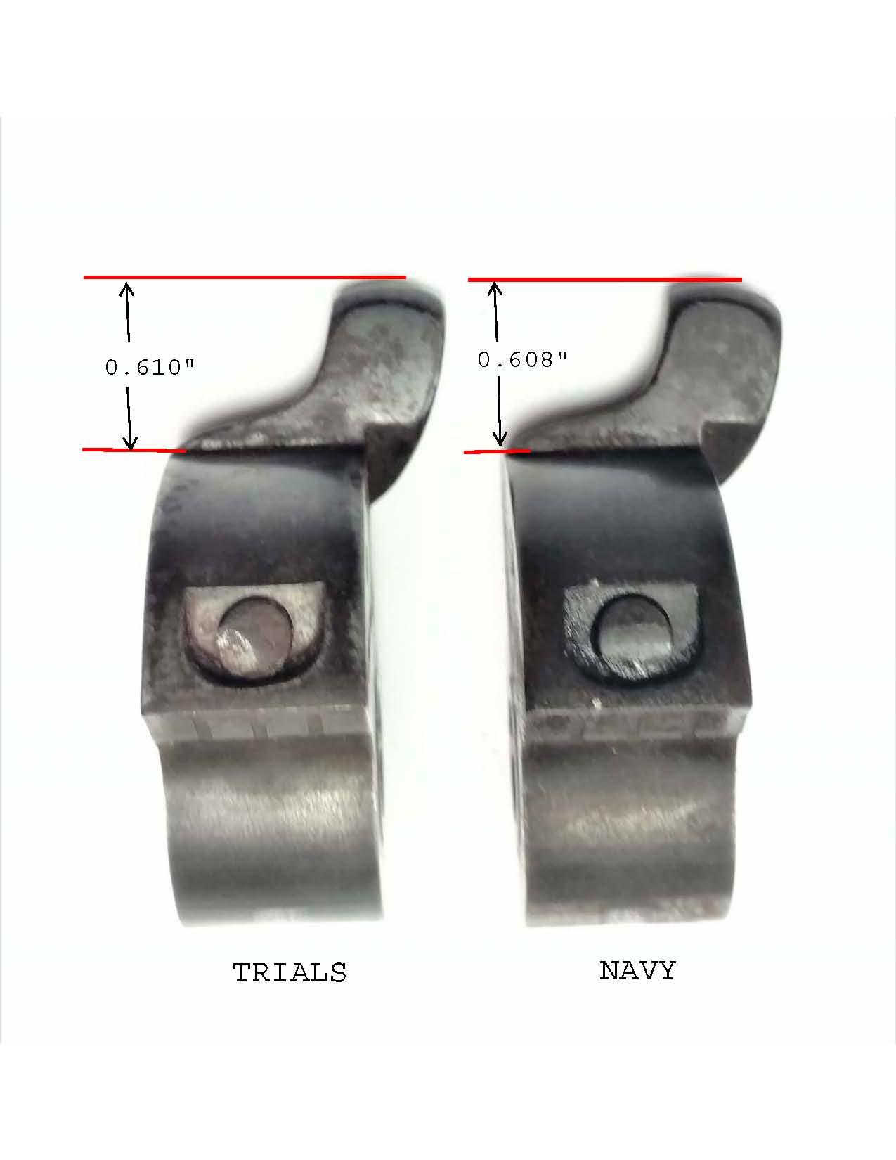

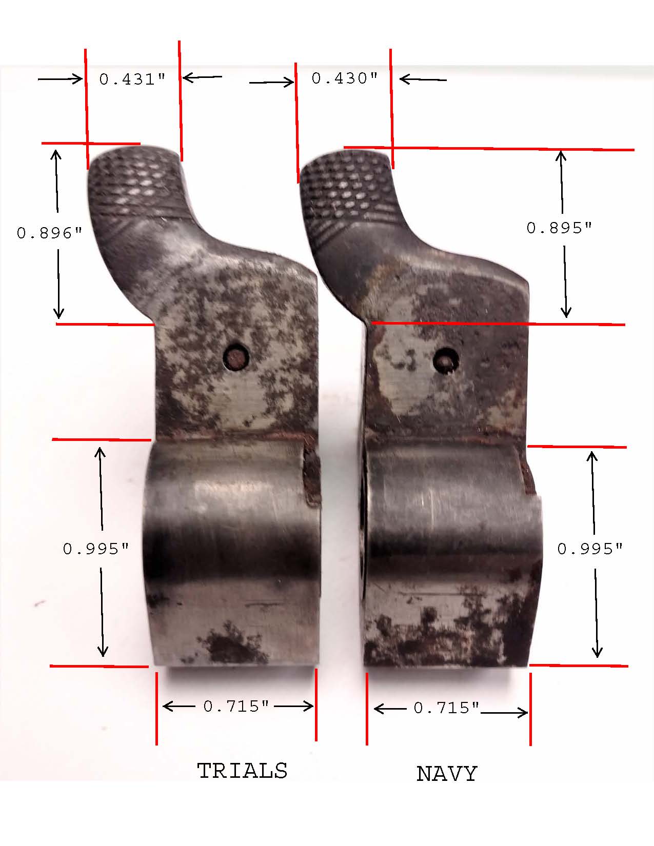

I took some photos and measurements of the breech block from the 1870 Trials Rifle and the 1870 Navy Rifle.
The breech blocks look to be the same shape and size. Have a Good Day,
Matt

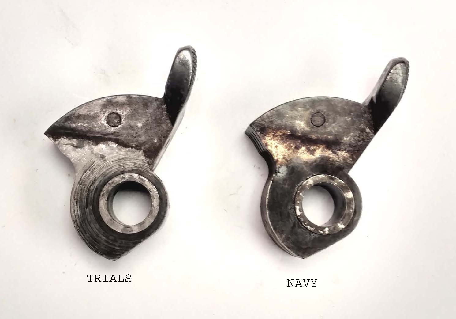

Re: Help ID’ing an old rolling block
Matt,
Nice analysis!
Unfortunately, it was my error in suggesting that it was the breech block that was different (senior moment). It was the hammer shape that was supposed to be different.
Apologies.
Ed

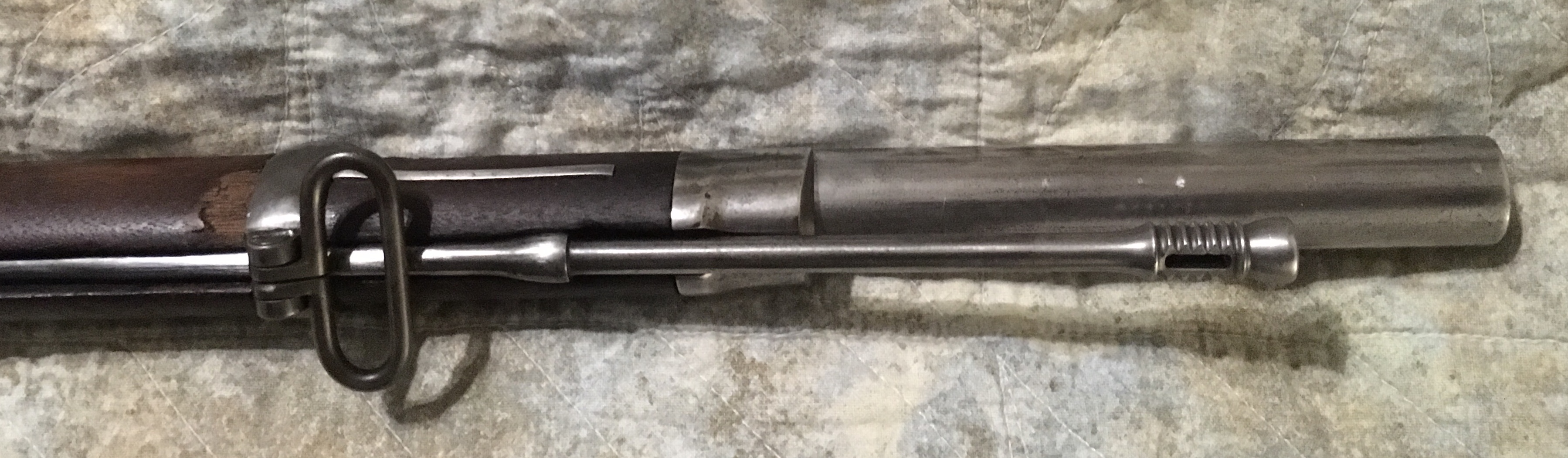

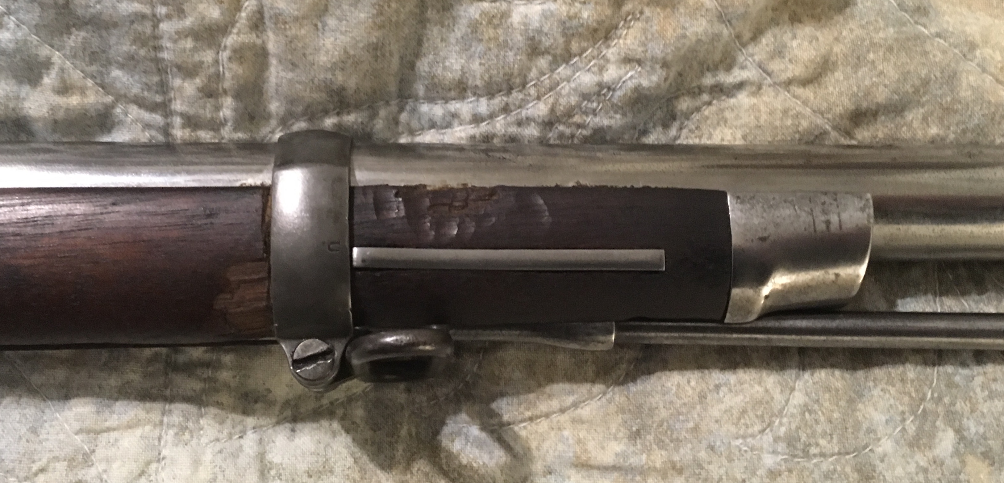

I cannot place my finger on exactly why or what, but there is something "wrong" about the first picture (of the muzzle area). The rod (whose front end dimensions never changed) looks "right", and the rifle (exposed stock wood dimension) proportions look "right", but the rod is supposed to be flush with muzzle when seated and that one isn't even close. Is the barrel too long? Has the wood been set back? If so, was the rod trimmed at the rear end? Ed's rifle shows the correct set-up, and agrees with mine. Just wondering?

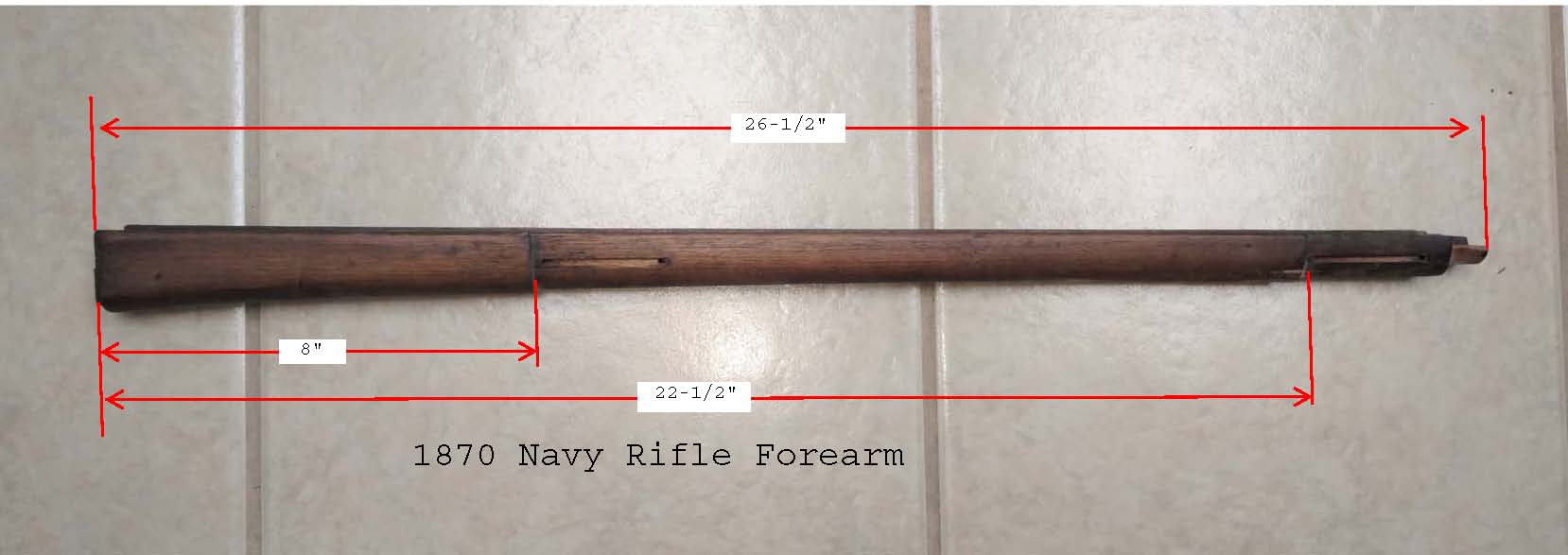

What is the length of this rifle’s forestock? Maybe the stock was replaced by a Navy Model stock?

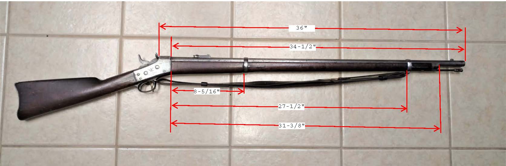

Hello Neal,
Your rifle looks like the barrel and forearm may have been cut down. In your first post, you note that
the barrel length is 32-5/8 inches. The 1870 Trails Rifles were made with a 36 inch barrels. See photos below.
Also attached is a photo of a forearm from a 1870 Navy Rifle without metal nose cap. Have a Good Day,
Matt

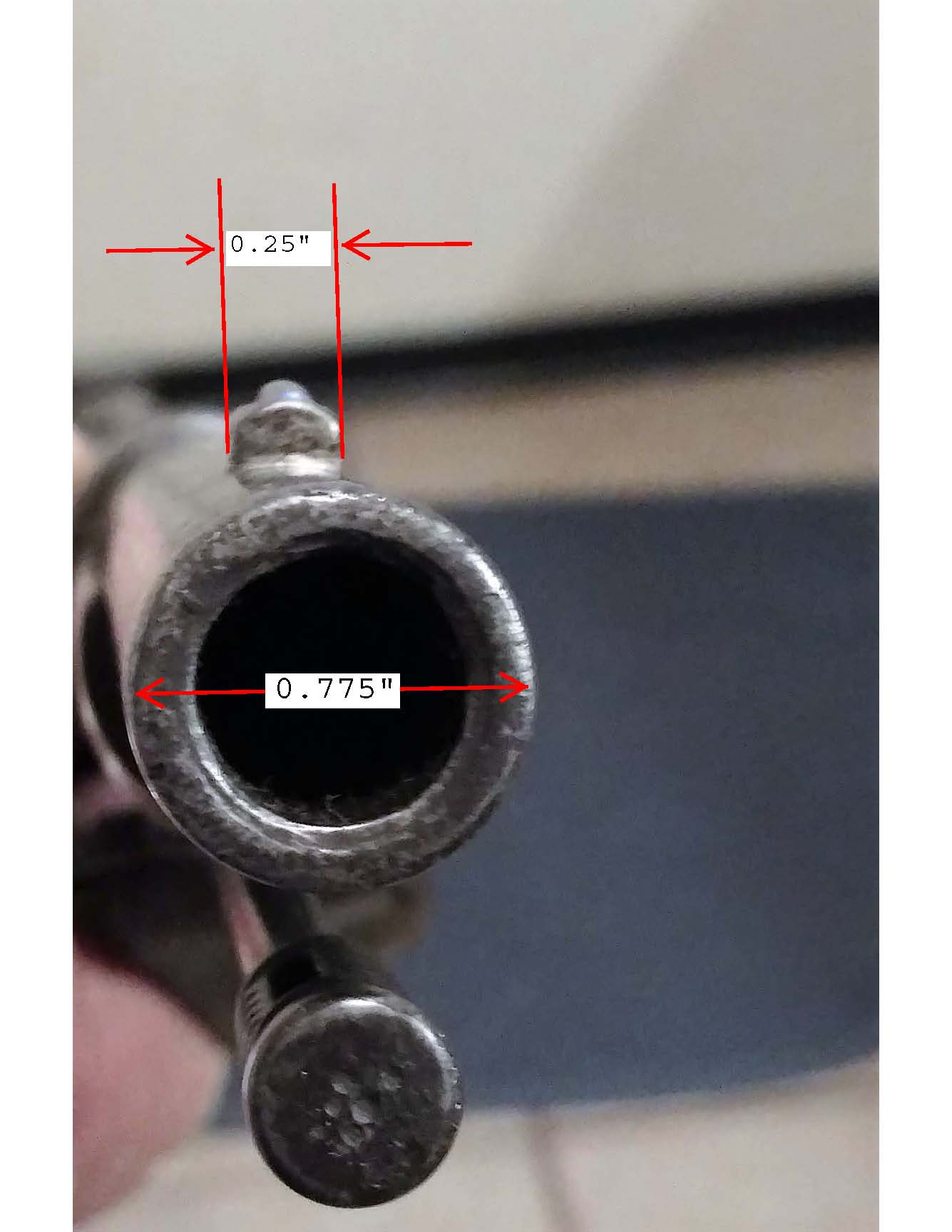

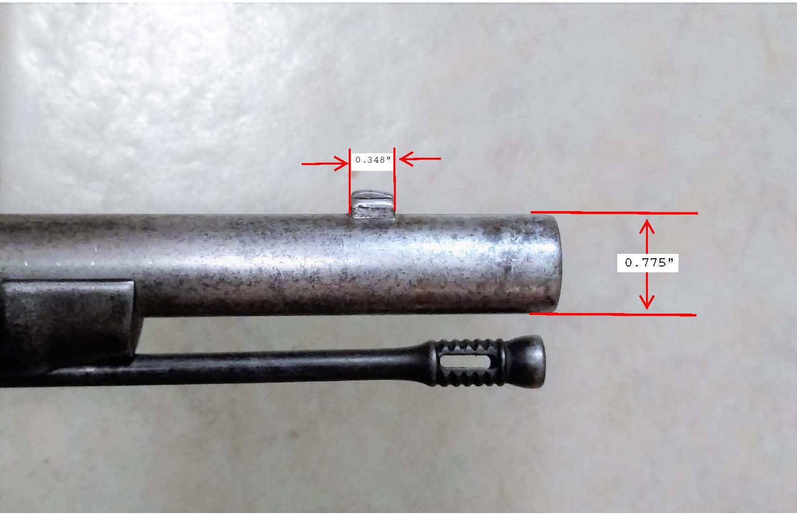

Here are some more photos with measurements.
The 1870 Trials rifle uses the standard Springfield Civil War bayonet.
My guns are not readily accessible at present, but I believe the hammer is (also) the same between the Navies and the Trials rifles. Barrel length, forend length, rod length, and right-side receiver markings are the determining factors. The hammer and block are both distinctly different on the 1871 Army.
