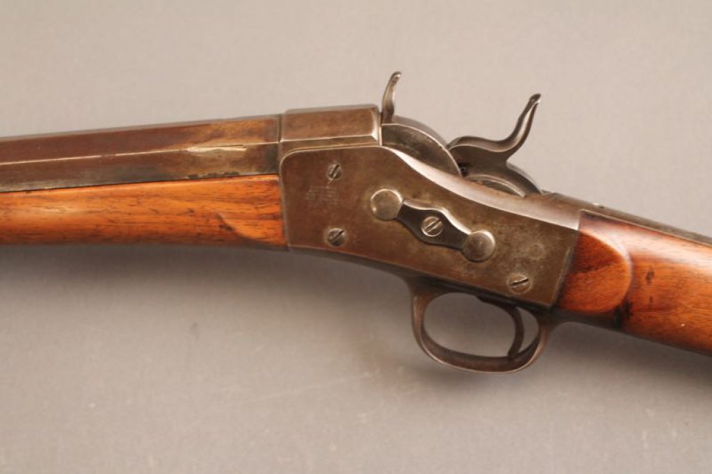

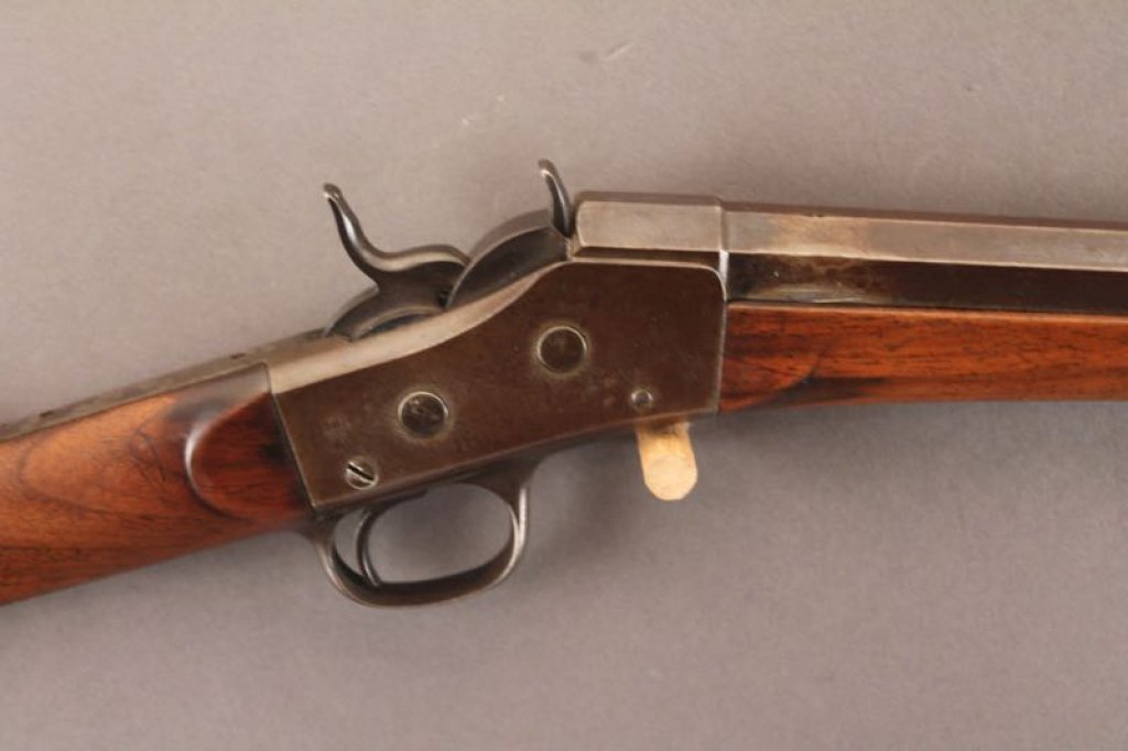

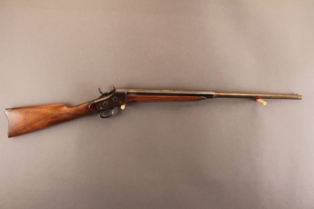

I just came into a sporting action with all the parts. Someone (likely possesed) had cut the barrel to a round configuration and lord only knows the whole story. So, time to build it back into something to shoot.
I have plenty of 45-70 kit and would like to stay with that, or something that can be built from it. Here is a chance to build a new gun! Shoot a reply with your choice of:
Caliber and reason
Barrel configuration (across the flats and taper)
Sights?
Gun is still in transit so I do not have any more details at the moment.
