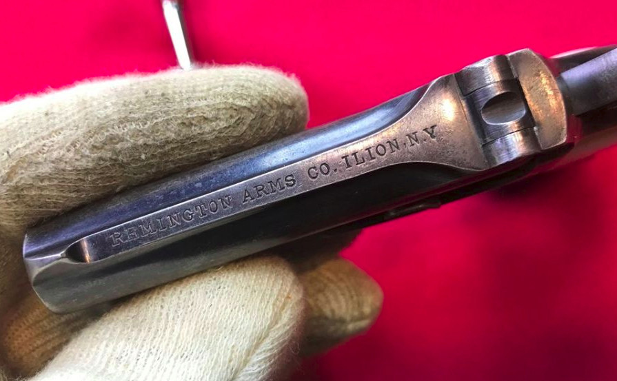

As admin stated, a photo of the barrel markings would be the most accurate identifier.
The various type/models are primarily determined by the company names and placement.
Is yours marked E. Remington & sons, Remington Arms Co., or Remington Arms U.M.C.?
If Remington Arms Co., then the style and length of marking will determine the variation.

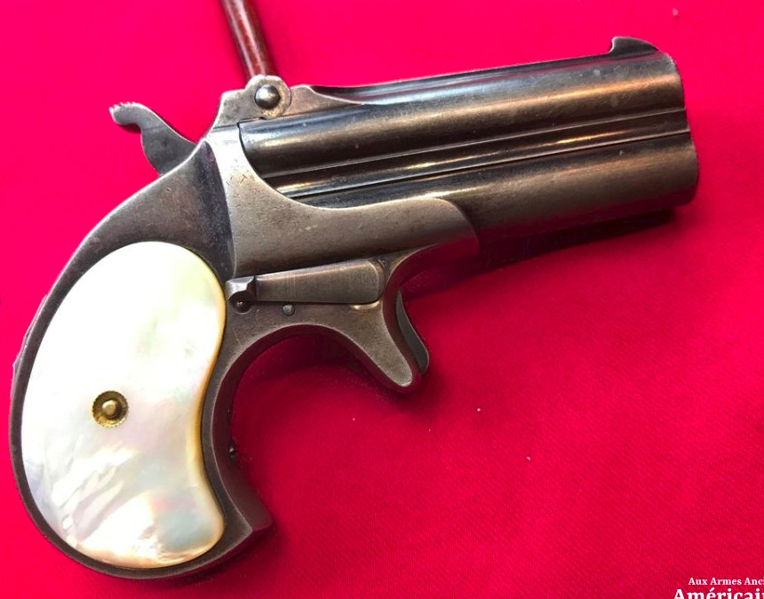

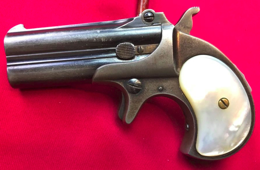

As you asked, here are somme pictures of my gun. I know that this model was produced between 1888 and 1911, but what I'd like to know is the exact year of production.
Do you think that its low serial number (416) could mean that it was manufactured in 1888 ? Visibly, it has never been fired because the barrels are absolutely mint, which is pretty rare on these derringers.

You have a third model, made 1888 to 1911. These were made in batches, so your gun was 416 in a particular batch. Because of that, there is no way to date the gun further. The grips are probably after market. It appears that your gun has a vertical, hairline crack on the left hinge at the 6 o'clock position, but that may just be the photo.
Re: Could anyone tell me ?
Boy, you have a very acute eyesight, aardq. I didn't notice this crack when I bought the gun ! Fortunately, I don't intend to fire it.

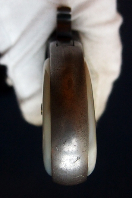

I'm not sure the grips aren't original but the screw certainly is. Maybe Dan she's something I'm missing.... I'd like to see a picture of the grips oon the gun from the back to see the width of them. Originals are thin replacements are typically thick.
Here is a photo of the grips from the back of the gun. They are pretty thin (their thickness is the same from top to bottom) and have a perfect fit.

They look right to me except the screw of course it's only my option from pictures...
Agree with David. The grips looked thicker in the first pic, and they looked too "new" to be original. They just didn't look right, plus the screw. Seeing them from the back I now agree with David.
