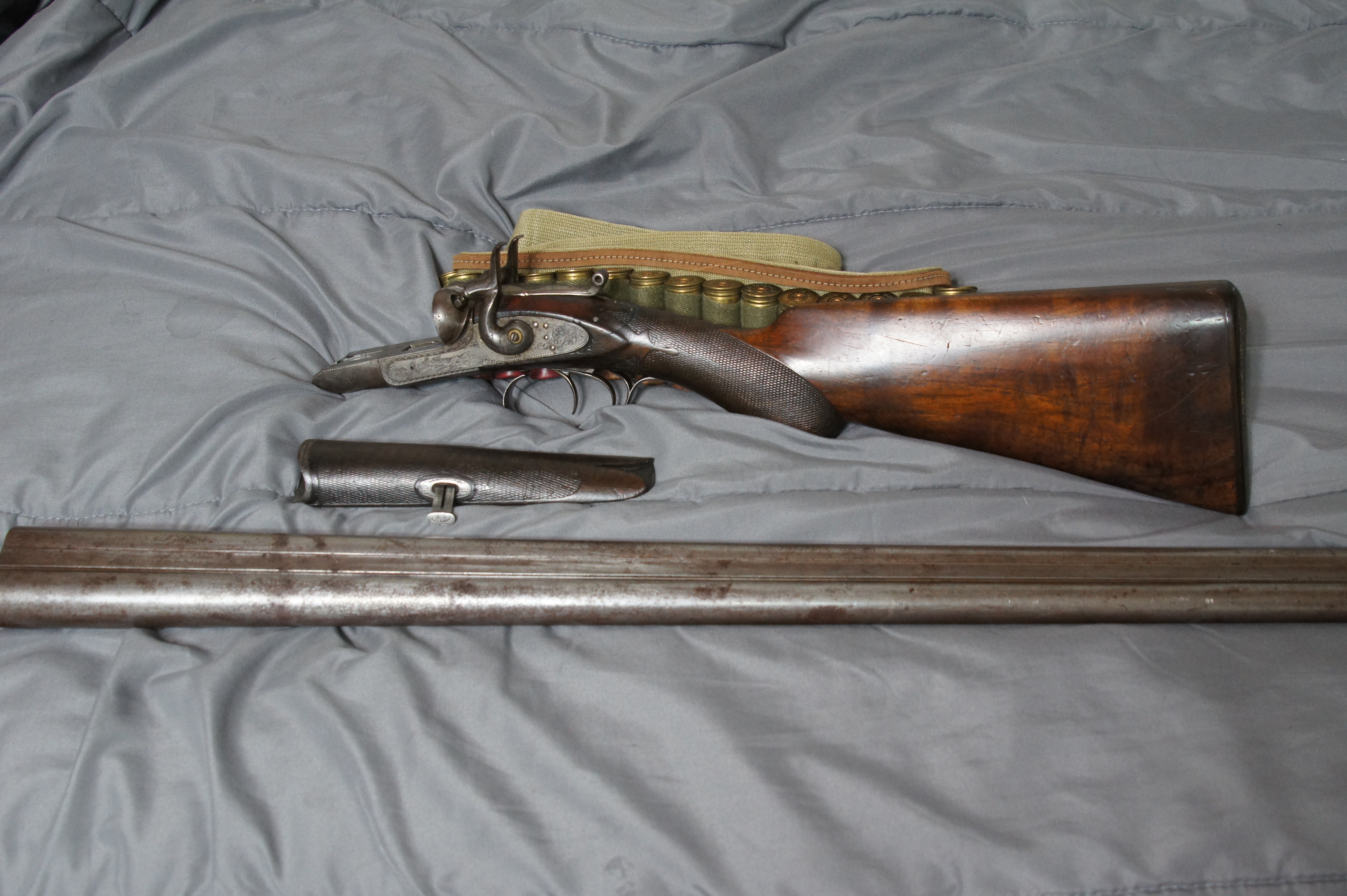

Was wondering if anyone could help me identify this shotgun.
Link to Imgur gallery https://imgur.com/a/rPwLP
I did some google searching which seems to indicate that it's a late 1800's Remington. Was hoping I could get an exact date or model name.
It's 12Ga, and marked Remington. Ilion. N.Y.

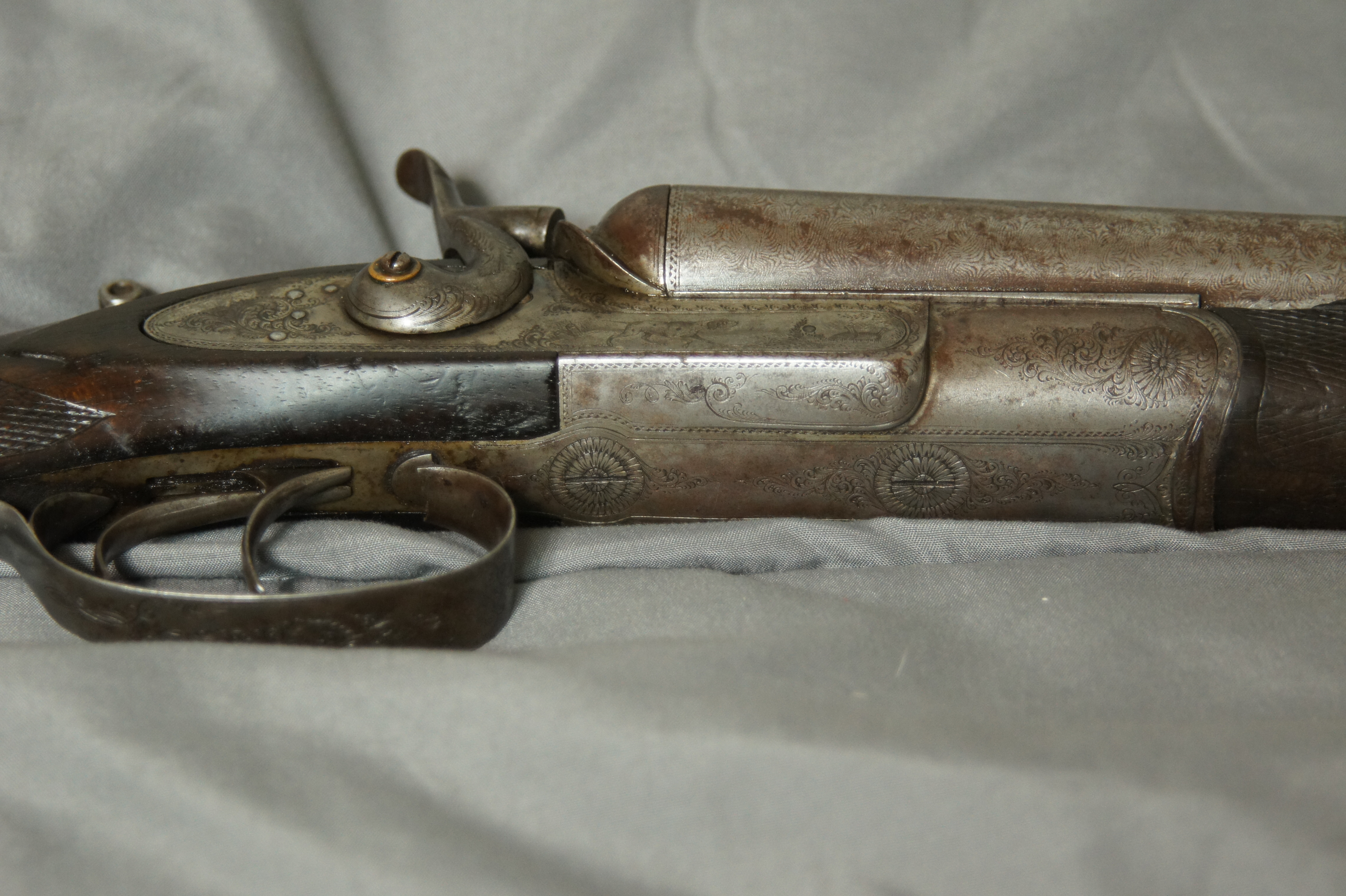

The barrel is 30'' long and Damascus steel (or possibly just engraved/etched?).

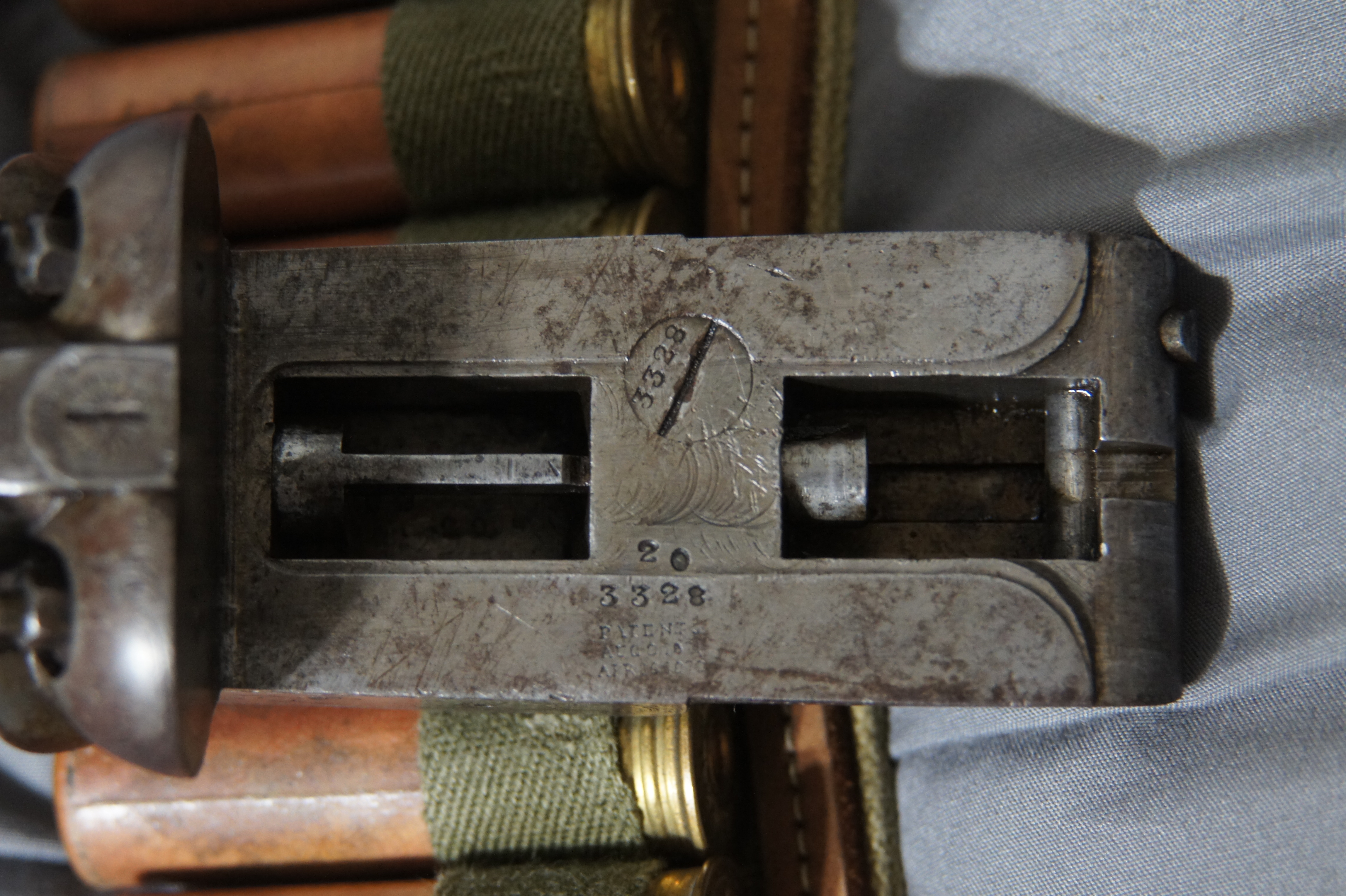

Only SN I can find is 3328, however, the receiver has a 20 above the 3328, seems to be matching numbers all the way around. (There is also patt. 1871 and 1872)

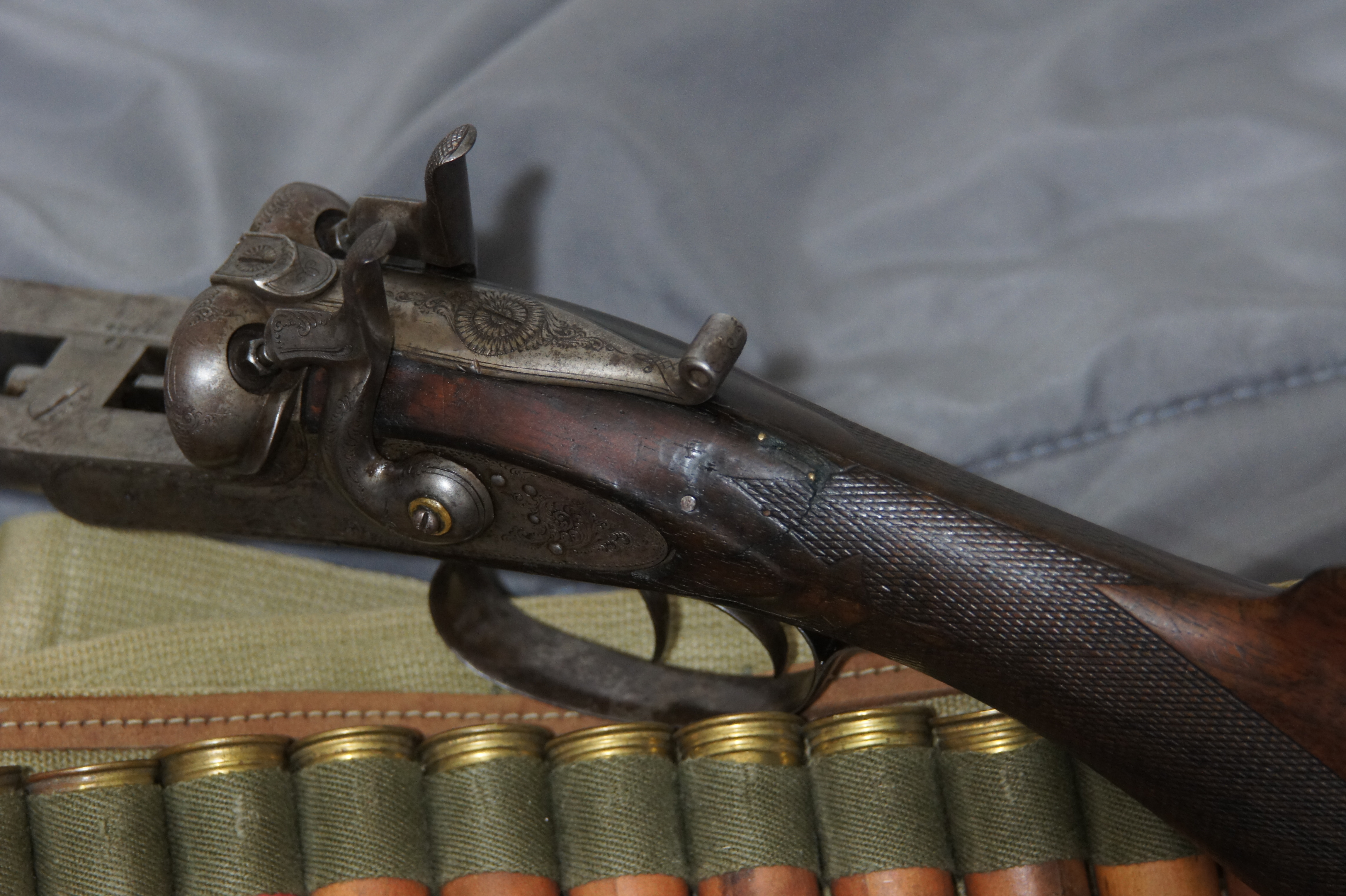

The receiver is etched with hunting dogs, duck on one side rabbit on the other.
That's about all the hard facts I have on this gun.

B. Get rid of the rust without destroying the etching or Damascus steel (Have tried CLP + cloth and elbow grease, no joy.)
C. Get the trigger guard fixed.

Looks like one heck of a beautiful Whitemore 1878 but NOT being a shotgun guy, hold on one of the experts might tell me I'm full of it (again) :lol:

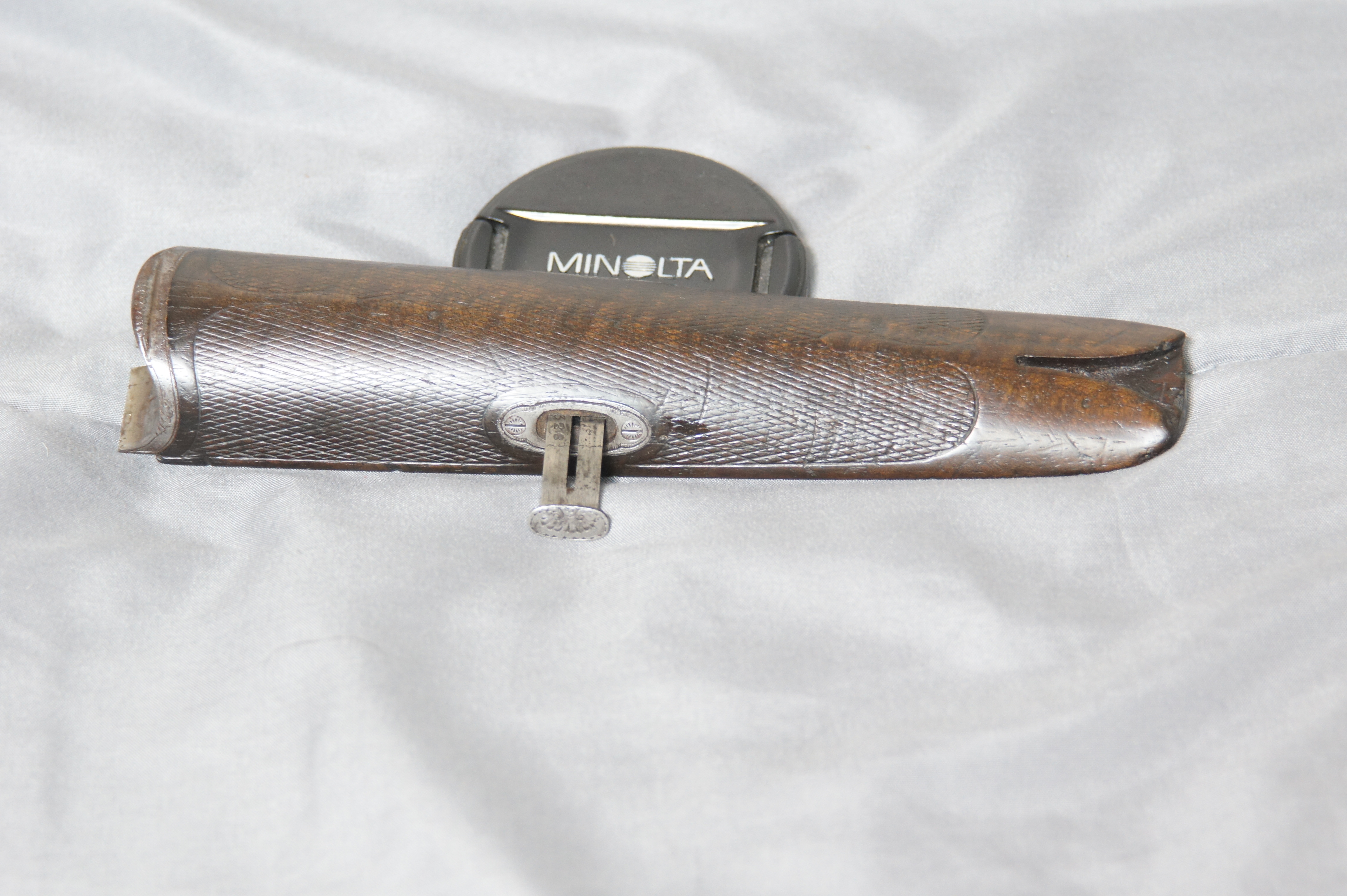

We need more pictures or detail description of the gun. if its a 12ga. it is not a 1878 Duck Gun they were only made in 10ga. How is the for end held on wedge.The engraving you said tells me it is a grade 5.Could be a 1875 or 1876.

Close but no cigar, Admin!!
The gun in question is a Model 1875 or 1876. The serial number puts it right in the transition range from the 1875 to 1876. A Model 1878 would have a dolls-head rib extension and no percussion fences. This gun was made well before the introduction of smokeless powder shotgun shells. At the time this gun was made most shooters were hand loading their own black powder shells in brass cases, or getting paper case shells from small local loaders. The big ammunition companies didn't load shotgun shells, just provided the empty brass or paper cases. In their 1880 catalog Union Metallic Cartridge Co. offered 12-gauge brass cases in 2 5/8 inch and 2 3/4 inch and paper cases in lengths from 2 5/8 inch to 3 1/4 inch. Most 12-gauge Remington doubles were chambered for 2 5/8 inch shells. Bottom line, you shouldn't be shooting it with modern ammunition!!
From the pictures the gun appears to be a Grade 5 with quite a few condition issues, but rare enough to be worthy of a proper restoration by one of our present day specialists such as Bachelder Master Gunmakers in Grand Rapids, Michigan, or Turnbull Manufacturing in Bloomfield, New York. That will be several thousand dollars. But, you are better off to leave it alone then entrust it to Joe S**t the local 870 parts replacer!!

Your gun is a grade 5 Model 1876 the hammer face is flat and short. There is one thing I see that I would fix is the hammer screws are not original Your barrels should be brown not blue they are fine. You can use # 3 or 4 steel wool with oil will help clean the rust off. You can get correct screws if the holes have not been drilled out. This is a nice Double if you want to sell it I would buy. For the hammer screws call- Jake 330-669-2138
