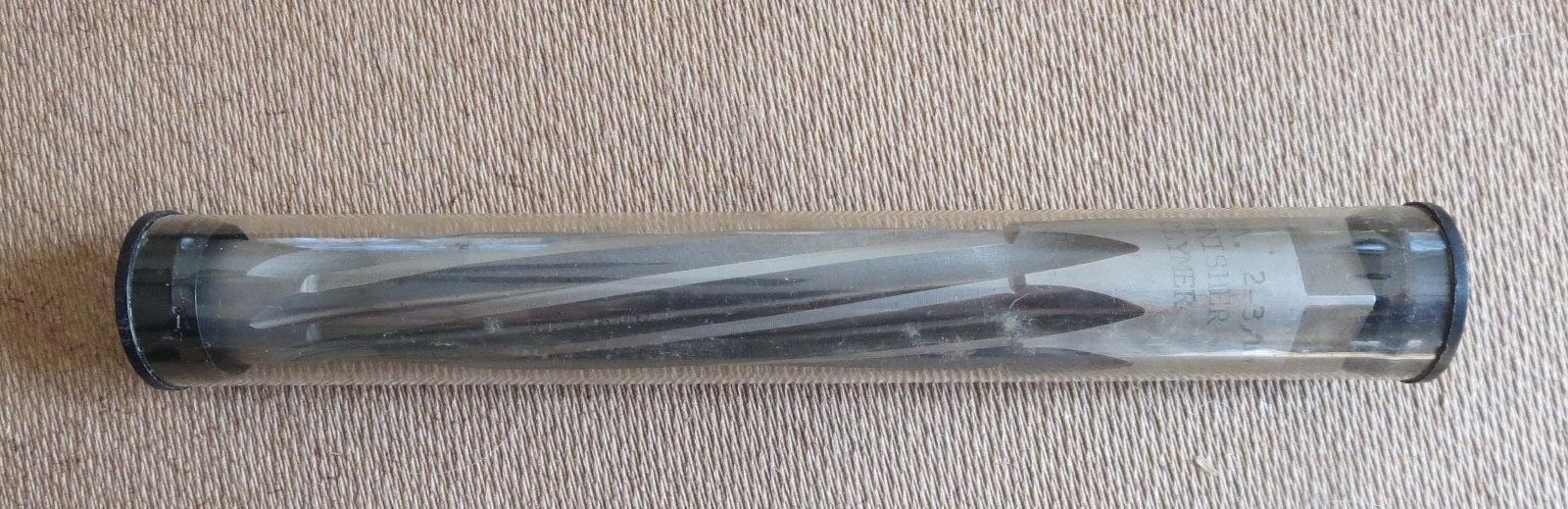

I purchased this on eBay for my; 16 gauge, 2 1/2" shotgun shell, on my 1900 SXS hammerless shotgun to lengthen the shell to modern 2 3/4" shotgun shell.
What I need to find out is if the finish reamer incorporate the force cone also?

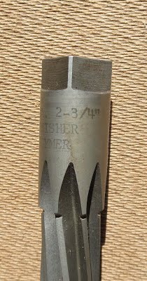

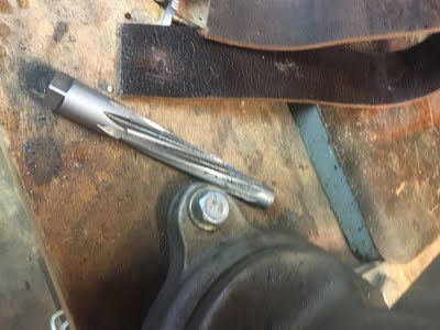

This is the reamer.

The one pictured does not include the forcing cone reamer. A forcing cone reamer would have no step at the end of the chamber reamer. I have seen some older ones that did have a very slight step supposed to equal the thickness of the hull only.
