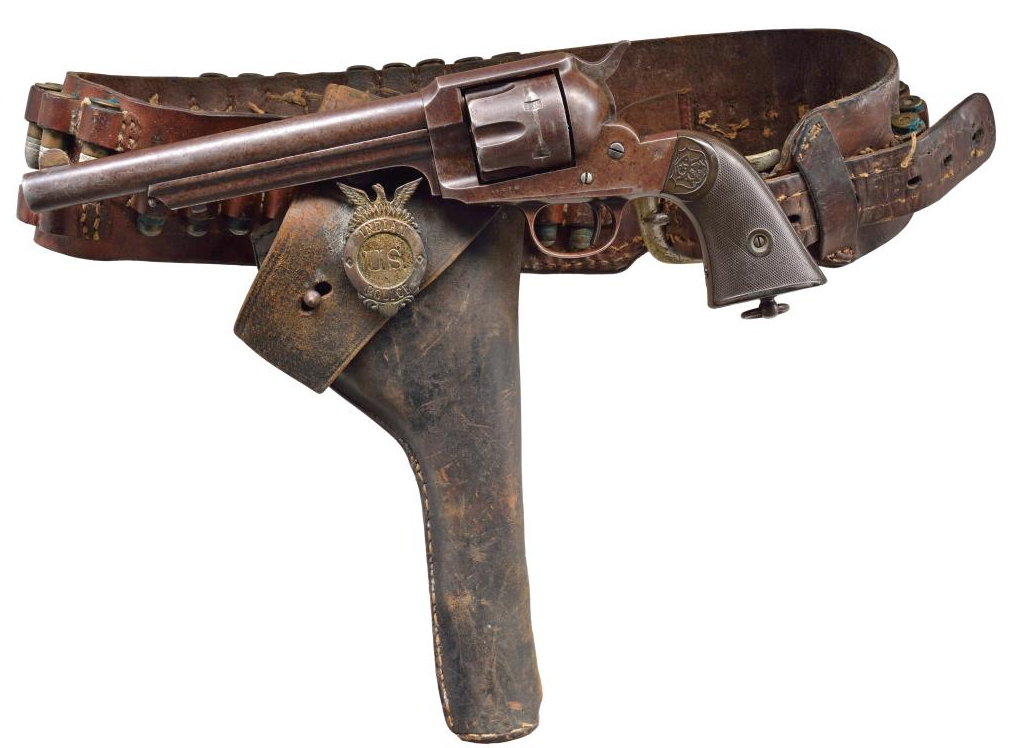

Kinda late for this thread, but doing a survey of 1890 serials in the past few days, two high numbers have shown up, 2021, and 2028! If they are sequentially numbered, something is wrong some place. Two numbers that are higher than the accepted total of 2020 raises some questions to say the least.
Any and all suggestions are most welcome.
Dan
Dan
Re: SERIAL NUMBERS OF 1890 REVOLVERS
Hi Dan,
Flayderman said approximately 2020. I think the numbers are approximate enough. By the way SN 2021 was auctioned by RI in 2013 and was supposedly owned by Cole Younger. SN 2028 was auctioned by Poulin in 2017 with a holster with an Indian Police badge attached.
Regards,
Bill
Regards,
Bill
