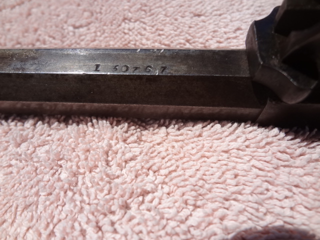

Serial #, located under the loading ram, on the bottom of the hex barrel: 1 3 0 7 6 7

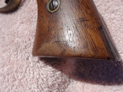

There is a 'C' proof on bottom of each wood grip panel.

The wood grips are perfect shape to match the grip frame and are matched to the serial number of the firearm.
It appears to have had a cartouche marking on the grip, but most of it's appearance has faded away.

Cartouche block appears on the bottom edge of the left grip and is approximately 1/2" in lenght and maybe 3/8" in height.
The left grip is chipped where the palm edge of the grip starts from the bottom upwards for about 3/4".

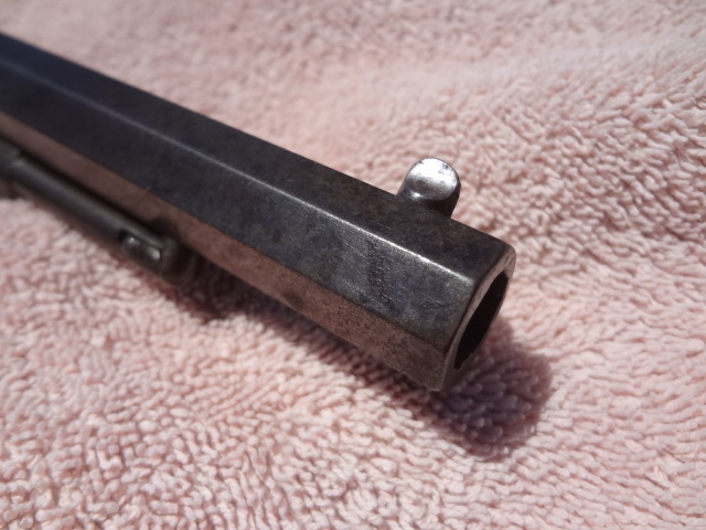

The front site (forward end of barrel) is round on the bottom, flat pinched to a slot shaped blade and the blade itself is rounded arch on the top.

- Serial # under barrel. I was curious, could this serial number have been 30767 and the leading # 1 have been added after re-work?

- Front Sight, Pinched Blade

- Left Grip Panel - Faint Cartouche, would like to know the possible name of final inspector. Last character could have been a " P ". Thanks

You have the latest variation of a New Model Army revolver with the three-line barrel address and a pinched front sight, which was made in January of 1865. The letters found on the major parts are inspection marks from the various Government inspectors. Once the inspection process was complete the Principle Sub Inspector would stamp his cartouche on the left grip indicating the revolver was accepted by the Ordnance Department. The numbers stamped on the cylinder indicate there was some fine tuning necessary to allow the cylinder to function properly and were needed to match the cylinder with the revolver once the finish had been applied to the various parts. The grips sometimes had the serial number written in pencil because they also had to be matched to the revolver.

Bill, thanks for the information, the grips are serialized with the firearm itself in pencil. The numbers are written in really nice format, that of what was typical for writing format in the1850's to 1860's.
