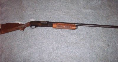

This is my Wingmaster Monte-Carlo Walnut Stock & Forend, a truly magnificent 870.

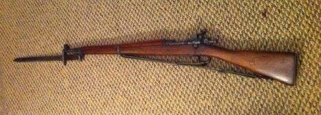

My 1943 1903a3 that I built by hand, 100% Remington

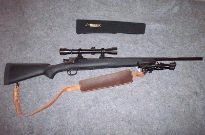

My custom Remington 1943
:mrgreen: I have much more, but you get the picture, I am good at what I do, because I research every firearm that I own. I know everything about that specific firearm all 50+ of them.
