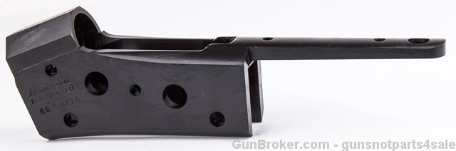

Hello, I'm a gunsmith, and I have plenty of experience in firearms.
what I'm doing next is I'm starting to build a Remington rolling block rifle for my armory, however very little information about the Remington RB1 is available on line. I could build or buy a stock RB1, however I don't want to, I want to work outside the box on this one and go into a different direction with building it. I want to use it for hunting, muck it up, and not have it for a safe queen.
:?: I'm trying to find out which, if any other vintage Remington rolling block rifles parts are interchangeable with this newer model. I've read that the Remington RB1 receiver was cast using the old blueprints of another rolling block receiver from the 1800's. :?:
:idea: I'm looking for someone, who knows the rolling block rifles with some good advice and education. Blueprints would benefit me a whole lot, a parts source other than Numrich would be awesome.
I know Numrich has parts, however I want to customize the build by using a different trigger guard, so I can get a different style of stock. I also want a full octagon barrel and forearm. I'm going to install a scope on the barrel. The hammer and rolling block is going to be a different style. I think im I'm going to nickel plate the hammer, rolling block, trigger, buttplate,

I really want to find out when exactly the receiver was made, serial number: RB 0418 I have the date of manufacturer for all my firearms.
This receiver was made in the 2000's (I'm pretty sure it's newer than the 1990's), I wanted a 45-70 for hunting in Alaska, my armory is full of different caliber rifles, pistols, revolvers, however I need a 45-70 and Remington rolling block rifle fits the need.
:D What is really important is that the receiver is hefty, solid state of the art built, excellent quality and condition receiver. It's not junk like some rifles of today. I'm able to get all of the parts from the 1700's-1800's era except for the barrel which is new. This will be awesome after I am done.
:shock: I can't even get help from the Remington Arms company since this is from the Remington custom shop. Since I wrote this post, I've learned a lot about the RB1 Remington Sporter. It's universal so it will interchange with other Remington rolling block #1 rifles so I'm going to build it my way.

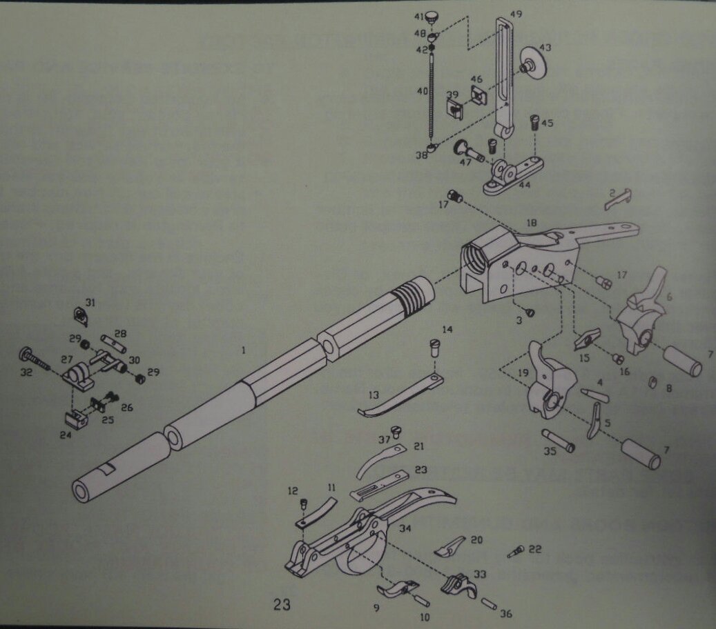

Well, since my last post, this is what I discovered by trial and success:
Using a RB1 receiver and everything else Remington rolling block rifle #1 #5 from the 1800's.
1. The RB1 receiver does bolt up to the Remington rolling block #1 trigger guard however you will need to tap the trigger guard to accept the RB1 screws for both rear mounting screws. Note: the trigger guard is really, really hardened so unless you have really top quality taps made in the USA you are screwed. :o
2. The RB1 receiver and the trigger guard don't match up in the front so you need to remove 1/8" of material from the RB1 receiver. Note this will change the barrel setting so you will have to do some milling to the barrel for the ejector, and if you use a ejector from the 1800's, you will need to use the screw from the 1800's also, another tap you will need. :!:
3. The trigger guard, aligns up with the hammer, so that is really good, however I did a trigger job using a welder, and re-hardening the trigger for better performance. Working slicker than snot. :!:
4. Both of the 1800's hammer and trigger pins are larger and longer than the RB1 receiver, however I did adjust the pins and the receiver. The pins are really hard so having the proper tools makes the work much easier to accomplish. The pins are not standard size, so I used a expandable mill bit making a real tight fit. :idea:
5. I fitted the stock to the receiver and trigger guard, then I reinforced the stock inside between the receiver and trigger guard, and using boiled linseed oil I was able to seal everything up. In Alaska the weather will screw up wooden stocks if unprotected inside and outside. :)
6. The forearm was hand fitted also, using the barrel stud, and the receiver to keep it from moving welding the ram rod into place keeps the forearm secured into place. :!:
7. The octagon barrel was fitted with a 6" Picatinny rail for the scope. This is a critical part of the scope, having a good secured base keeping the scope from any movement. Having a octagon barrel makes this easier, however I've used a blank picatinny rail doubling up on the mounting screws.
8. The sling was mounted with a barrel band, the forearm needs to be free from any obstacles.
9. The breach bolt was set with the barrel and headspace, a 45-70 finished reamer was used.
9. Everything was blued, nothing fancy just making it all uniformed, but I'd does look like awesome, like really slick. :D
Overall, as you can see from my list, it was a lot of work, and as you can see uncharted territory. That's why I was looking for someone else who worked on the RB1 receiver. It would have gone a whole lot easier if someone had the experience building the rolling block from scratch. This is the best of two decades, a new receiver, barrel and old parts that are made really tough.
Not to many people are up to a challenge of this large scale project, I enjoy difficult projects, the more difficult the more enjoyment I get of finding a solution. The rolling block is not a intricate rifle, not a difficult rifle, however when you build one from ground up it, with no information about the rifle, things can get interesting. :o
Building a rolling block 45-70 requires a lot of patience, a lot of time, making sure that the firearm is safe to shoot, and in the end a firearm that's 100% perfect and not something that bubba assembled. :shock:

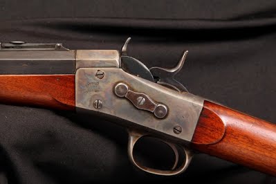

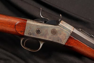

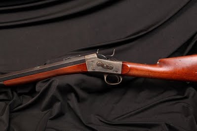

I am going to pattern my builder after the: Remington, No.1 Sporting Rifle from1873.
img_0457 (large).jpg_thumbnail0.jpg (14.46 KiB) Viewed 7280 times
It has some really nice lines, flat hammer and breech block pins, duel screws in the rear trigger guard. The rear tangs are equal, I am able to put a original screw setup from the 1800's and not the one Remington RB1 set up.

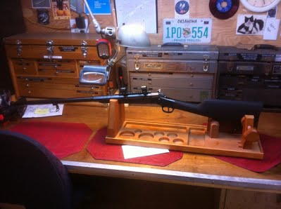

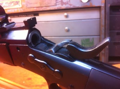

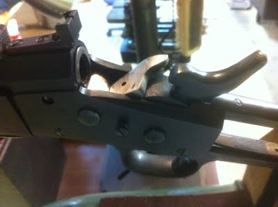

The rolling block rifle, the gun oil is shining off the rolling block rifle.
Breech block, hammer are installed.

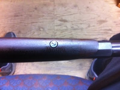

Here is some of the photos
Forend complete, screw installed.

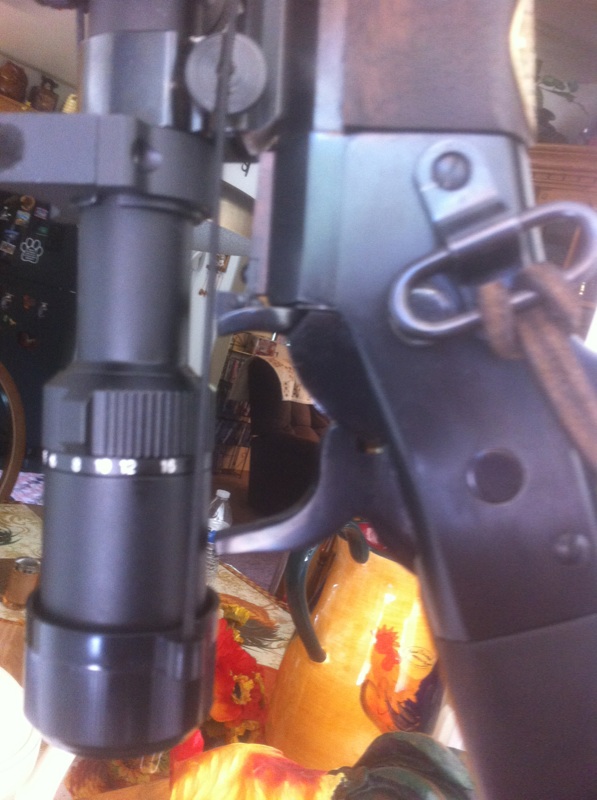

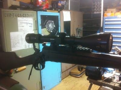

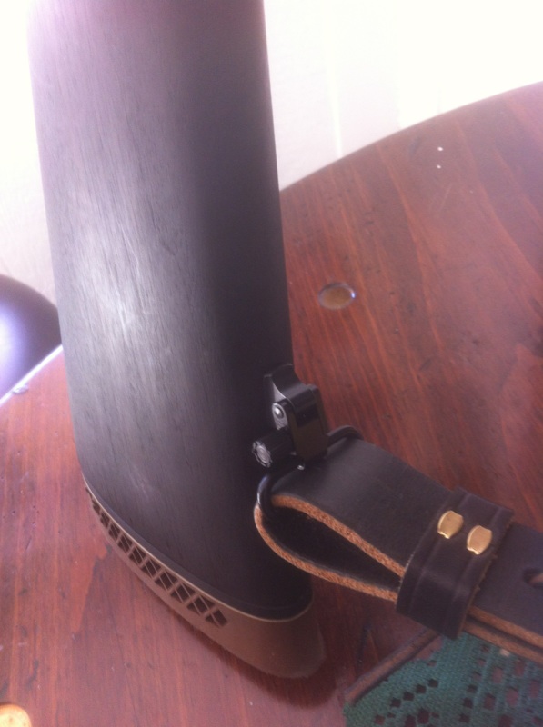

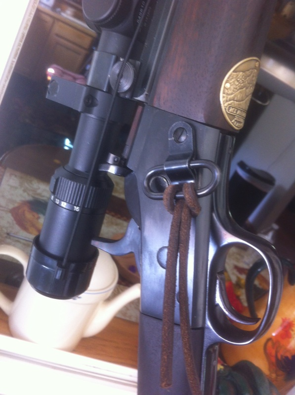

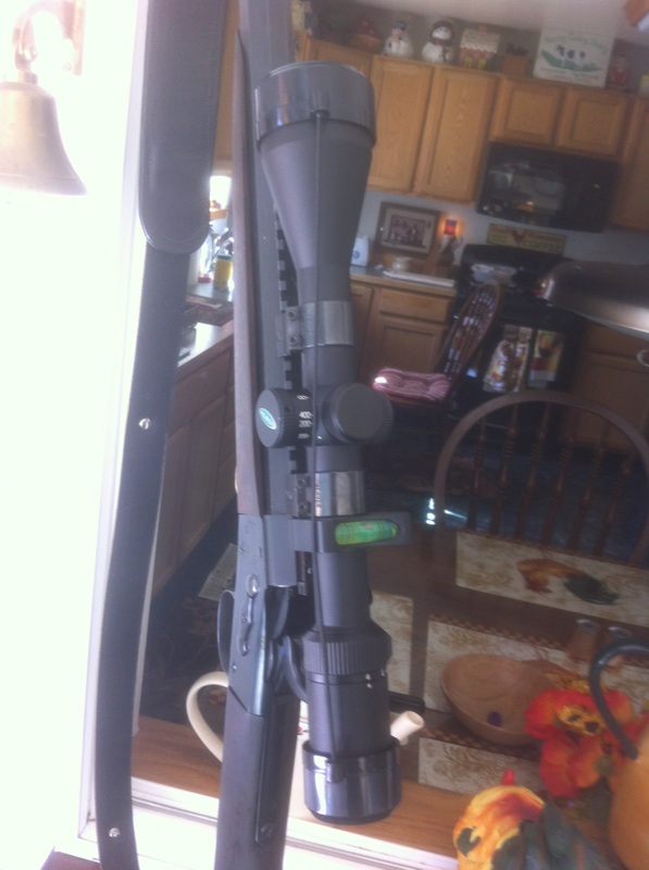

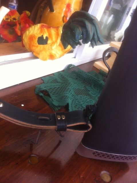

The Remington rolling block rifle has been completed:
The butt pad, sling, special swivel.
Winchester 100 year old front sight.
Receiver.
Walz
Re: Remington RB1 builder
Post by Walz »

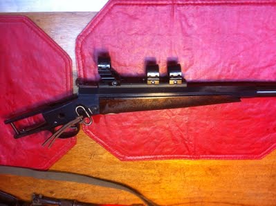

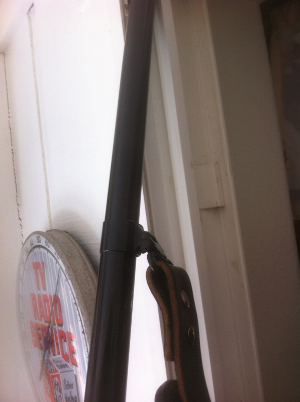

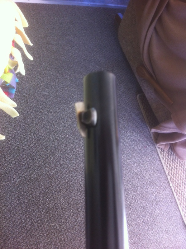

Upper swivel band, it's blued finished, and attached with a set screw.

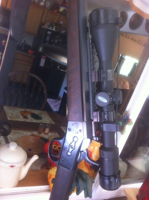

A scope, and the max 250 yards. Great for a good fair game hunt.
The breech block 100% customized.

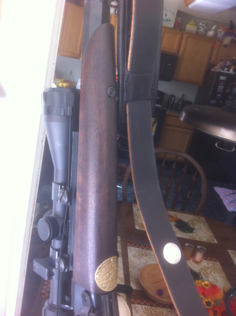

Post by Walz »
The stock and forearm are complete, I used a dark stain, and boiled linseed oil. I want a flat non shining finish, this is a real hunting rifle made especially to resist the elements thrown at it.
