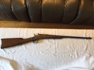

Howdy,

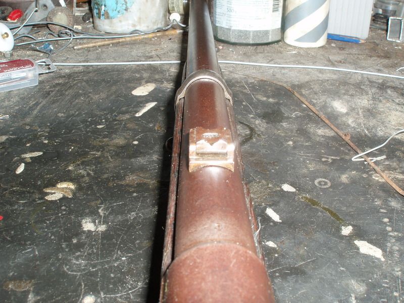

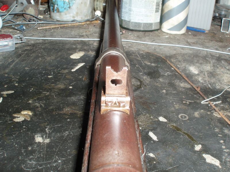

Thanks for the helpful replies to my prior post. So I confirmed this is a Navy barrel reamed out to .50-70 caliber. I went to the range with two loads. The first is my regular load of 55g Goex 3f & a 425g conical from Buffalo Arms. As usual, I posted a 2" red dot about 18" below the target's bull as these old warhorses usually shoot at least a foot high. My first shot at 50 yards drilled the red dot when the sight was held "pumpkin on a post". Clearly the funky rear sight (see pics) was dialed in at 50 yards! See the picture for the next 4 rounds: three touching each other and one 2" away. I was pleased. The 350g bullets with 59g of 3f were less successful. They hit low (?!) and did not group well. So much for that experiment; I'll stick to the original bigger bullet. The 100 yard target was also less successful with both loads not grouping well I believe largely because I had to hold the sights above the bull to get it in the black at all. I should have just confirmed that it grouped OK at 100 instead of trying to hit the bull. I plan to replace the rear sight with something more original from rollingblockparts.com.
It was a fun day; the range master commented on how the windows in his office rattled every time I set it off. You just cannot beat black powder! See the pictures attached.
rbt s.JPG (38.84 KiB) Viewed 4236 times
RB9 s.JPG (28.18 KiB) Viewed 4236 times
