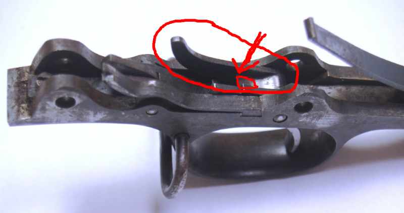

Hi all, I've become the new owner of a NYS Rolling Block and it's a real beauty. But I noticed the half-cock safety didn't work as I figured it should and the trigger doesn't set at the full cock (borrowed the photo from somewhere else on this board because I couldn't figure out how to fully disassemble the entire trigger mechanism). Took it apart and I think the red circled part below is broken off at the tip. About a quarter inch maybe but enough so the trigger can't seat correctly at full cock. What is that whole part called? It's all one piece I think. Would it be the same part as a regular #1 rolling block or are all the internals different for the NYS militia model? Anyone now of a good source for that part?? Thanks!

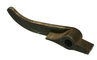

Thanks Matt, just checked out their website. Can you help me clarify....part RB215 "locking lever" seems to be the part in question. But it also says for the Original Army Model, not also the NYS one. I would doubt that they're swappable? Here's a shot from the website. The part that sticks up on the NYS model seems to have a bigger curve than the one here?

Wrong assumption in parsing, I believe. I'm pretty sure that S&S meant the part was "original", as opposed to a "reproduction". It's a fairly common format for their listings.
AFAIK, the "locking" action is the same for both the Remington-made NYS models, and the Springfield-assembled 1871 Army model.

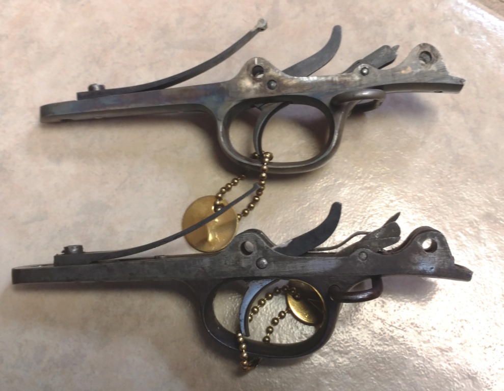

Photo 1: Upper trigger guard is from the Model 1871 Springfield Rifle
Bottom trigger guard is from the NYS Model

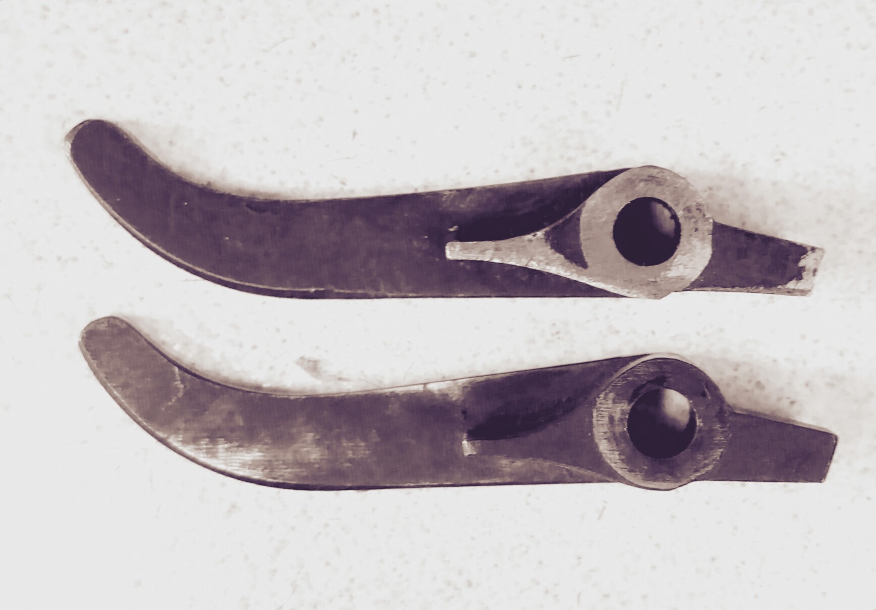

Photo 2: The upper locking lever is from the NYS Model Rifle
Bottom locking lever is from the Model 1871 Springfield rifle

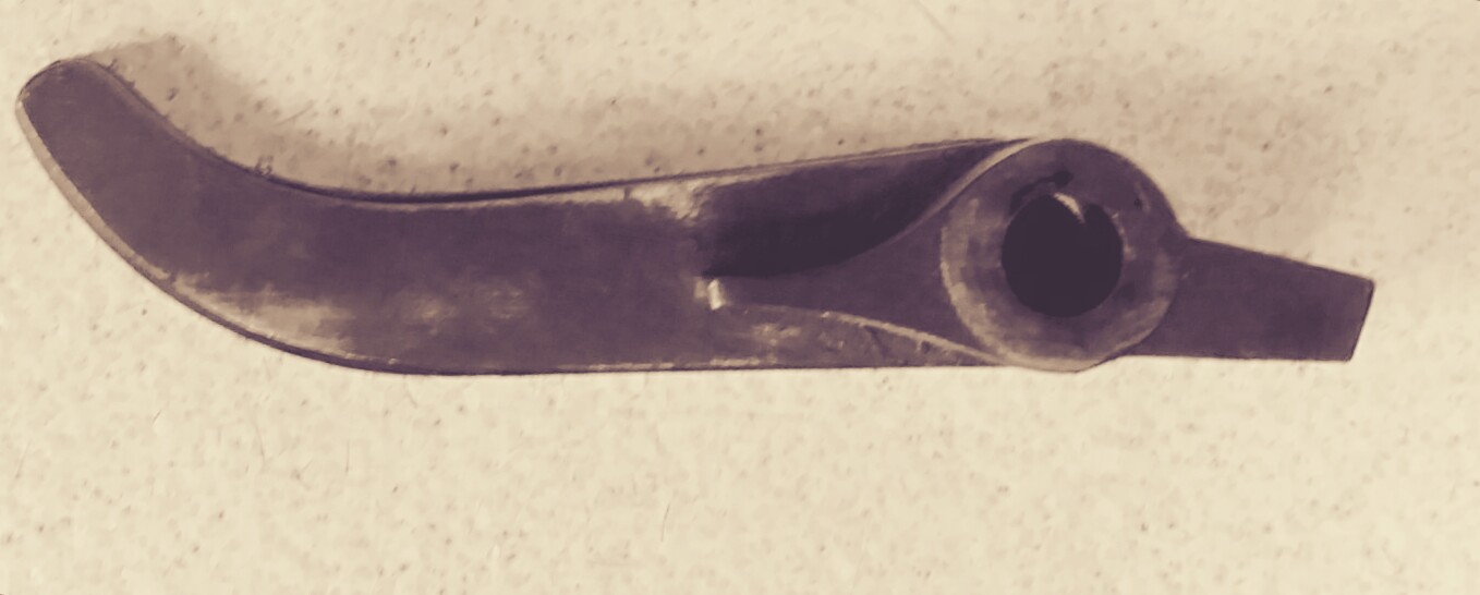

Photo 3: The locking lever from the Model 1871 Springfield rifle is setting on
top of the locking lever from the NYS Model rifle, both are the same size
So it looks like you can use th locking lever from the 1871 Model Springfield rifle
in the NYS Model Rifle.

ehull wrote:Matt- Is the only difference the roller on the end of the spring on the Springfield version? Ed
Hello Ed,
You are correct the only difference between the parts from the Model 1871 Springfield rifle and the NYS Model rifle was the mainspring. All the other parts looked the same, but I didn't put all the parts from each gun next to each other, I was watching a footballl game when i took the photos. Speaking of photos I don't know what happen to photo 1, after I posted it the photo got turned on it's side. Now the Model 1871 Springfield trigger guard is show on the left side of the photo and the NYS Model trigger guard is on the right side of the photo.
