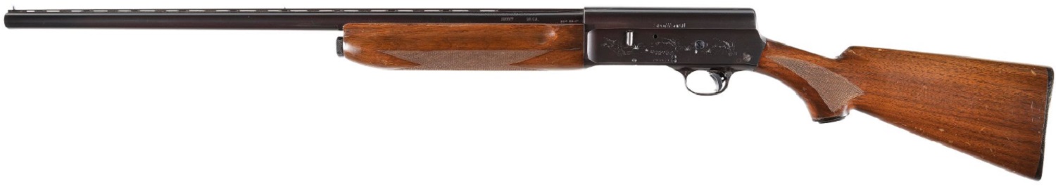

207626 01 16-gauge, 26-inch, SKEET, Vent Rib.jpg (54.23 KiB) Viewed 15141 times

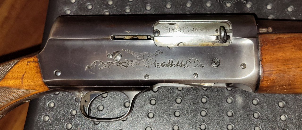

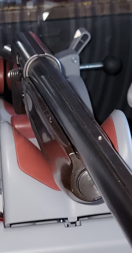

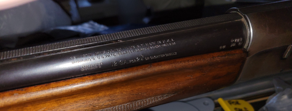

I have just recently found a 26" SKEET barrel for my Sportsman 12ga shotgun. The company I bought from posted another one today on eBay. I was surprised that the rib wasn't higher like the 11-48's I've seen that had vent ribs. I'm going to test it out tomorrow afternoon when the temps get above 60. I have attached photos for your enjoyment. BTW fitting was NOT required.
