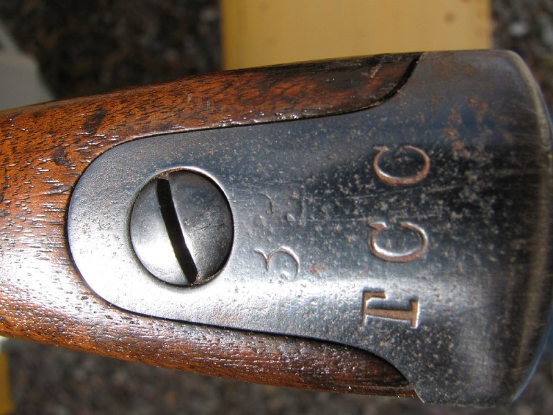

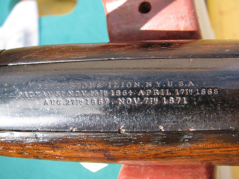

More photos of #2 NYS RB.
Tthis also just acquired NYS RB is in the blue and looks like it was hot blued at one time and then cold reblued over the original Blue using cold blue.
- IMG_3727.JPG (235.59 KiB) Viewed 3518 times
- IMG_3723.JPG (213.59 KiB) Viewed 3518 times
- IMG_3720.JPG (235.54 KiB) Viewed 3518 times

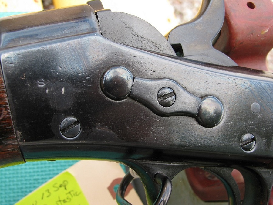

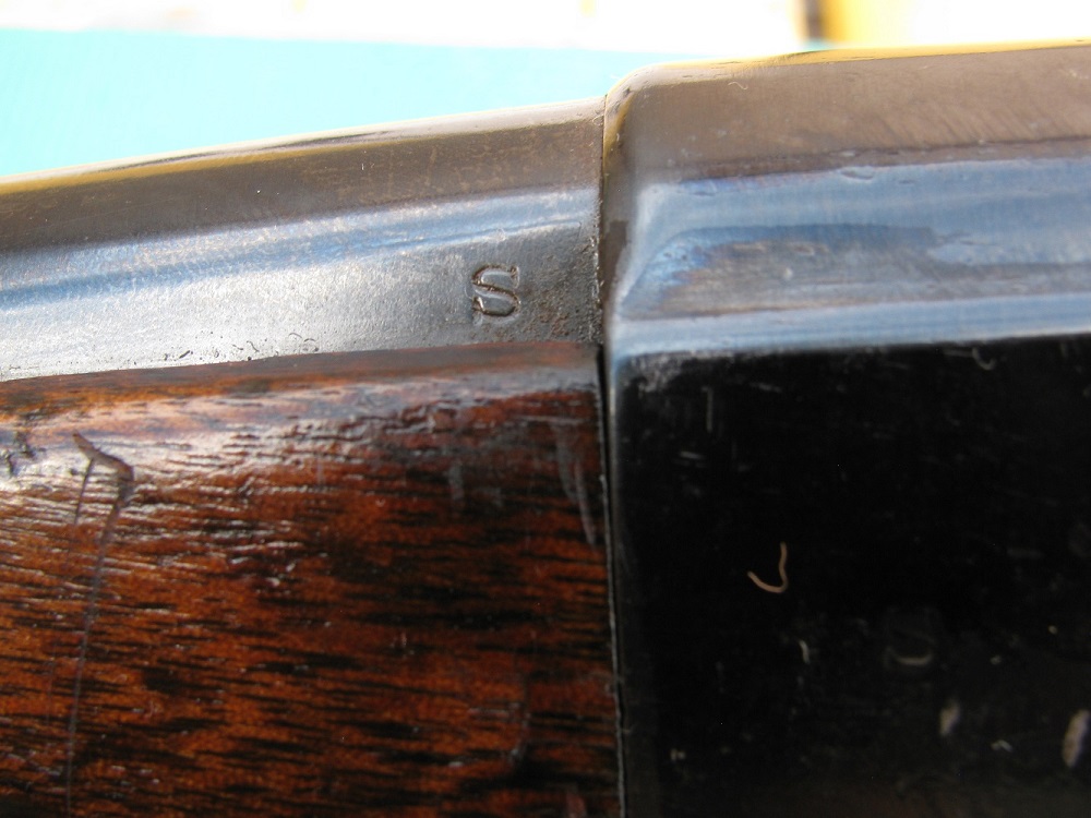

Re: More photos of #2 NYS RB.
A few more of rifle number 2 also a NYS RB
- IMG_3721.JPG (182.75 KiB) Viewed 3517 times
- IMG_3728.JPG (214.19 KiB) Viewed 3517 times
- IMG_3726.JPG (213.96 KiB) Viewed 3517 times
Sadly, it also appears to have spent quite a bit of hard time on a wire wheel, and/or a buffing wheel, somewhere in the refinishing process.
