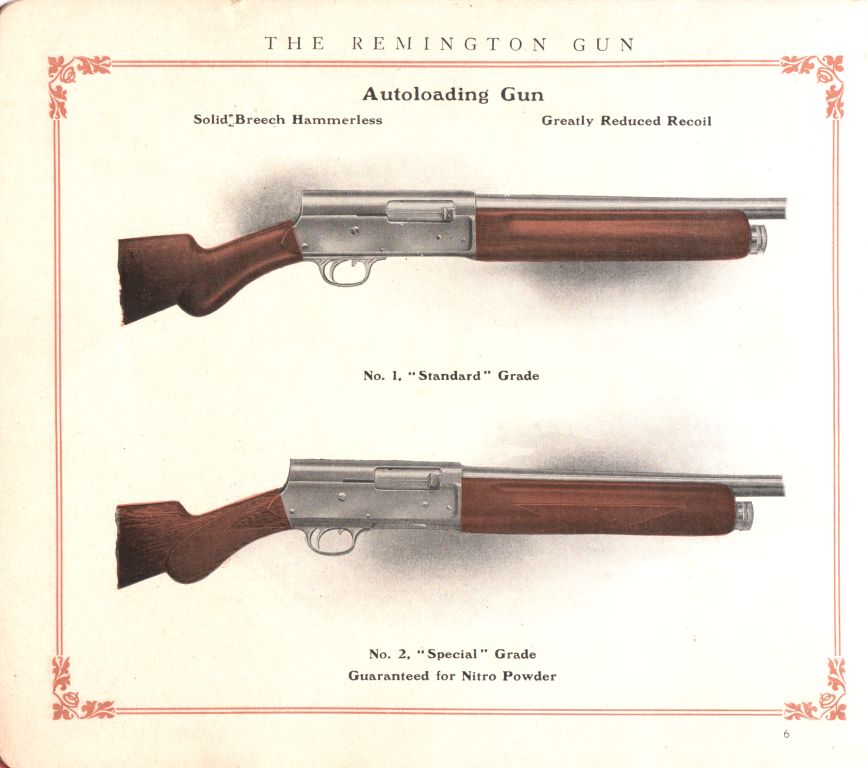

Remington Arms Co. introduced their 12-gauge, five-shot, John M. Browning designed, "Remington Autoloading Gun" in 1905. Serial number 57494 would have been from 1908.
1906 page 6.jpg (68.69 KiB) Viewed 63544 times
1906 page 7.jpg (120.97 KiB) Viewed 63544 times

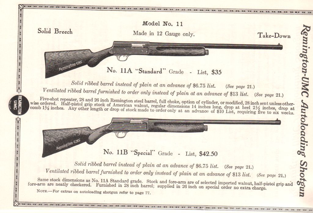

The company name was changed to Remington Arms - Union Metallic Cartridge Co. in 1911. Shortly after that Rem-UMC began calling that gun the Model No. 11.
Model No. 11 A and B 1913-14 Catalogue.jpg (128.47 KiB) Viewed 63544 times

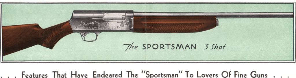

The 20-gauge “The Sportsman” had serial numbers beginning low S1? Maybe S1000? They added 12- and 16-gauge "The Sportsman" in 1931, with 12-gauge "The Sportsman" having serial numbers starting at S500,000 and 16-gauges having serial numbers starting at S200,000. "The Sportsman" had a three-bird roll-stamping on each side of the receiver.
The Sportsman early style.jpg (50.11 KiB) Viewed 63544 times
In 1934 DuPont acquired controlling interest of Remington Arms Co., Inc. In 1937, Remington reduced the roll-stamping on "The Sportsman" to one bird on each side and started putting the roll-stamping on Model 11 receivers as well. At the same time, the name "The Sportsman" or "Model 11" began being stamped on the bolt.
