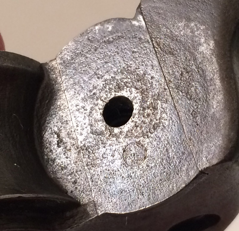

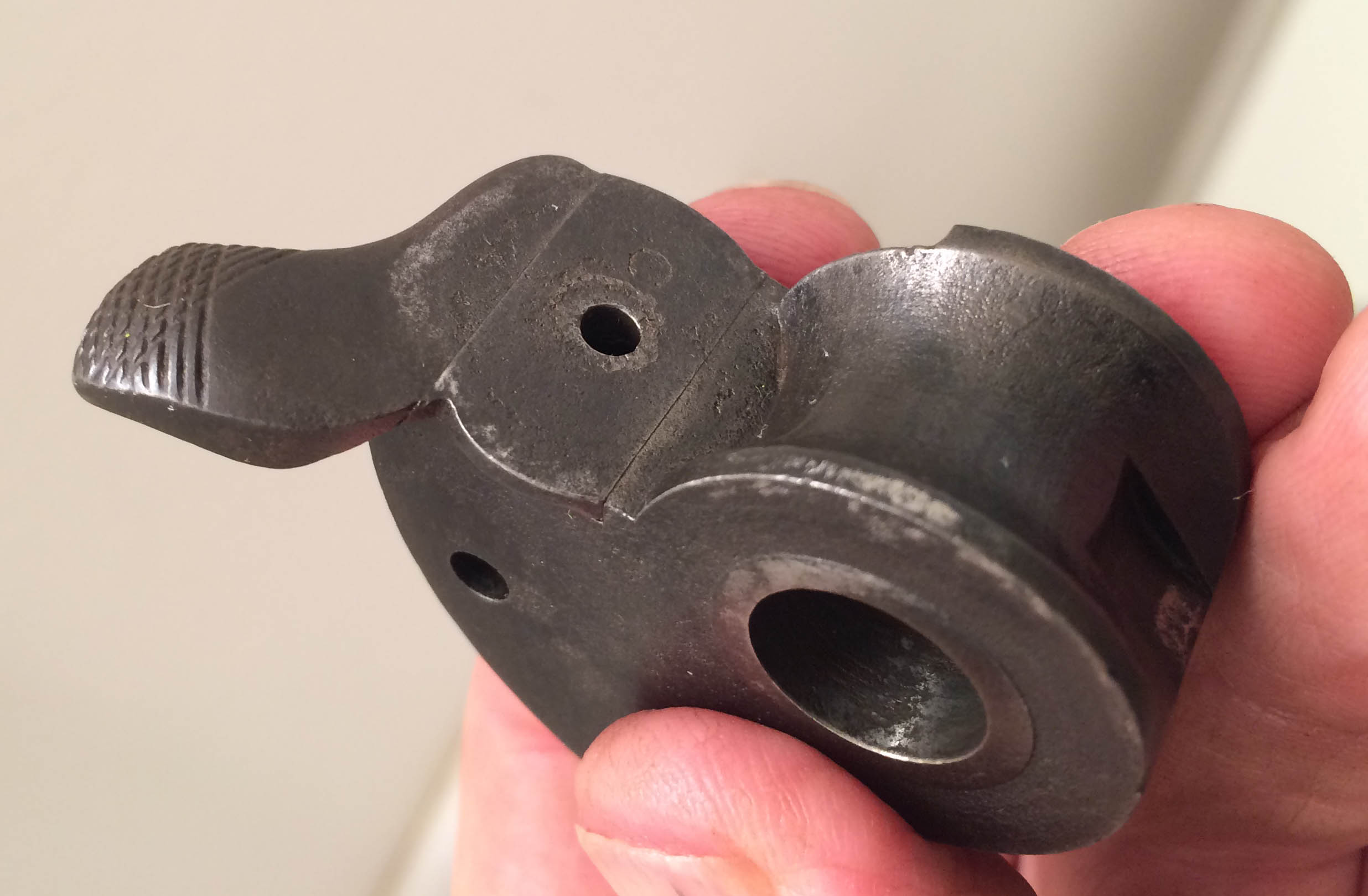

In my original post I mentioned a marking (item #8) in the form of the letter 'C' stamped onto the small plate that creates the "ears" for the breechblock. That was an error on my part. I've attached a picture that shows how I got deceived into thinking I was looking at the letter 'C'. I've also attached another picture taken with different lighting and highly magnified that shows my error. This is clearly a pin. My guess is that its function was to keep the small plate aligned along the transverse axis of the breechblock during brazing. Does anyone know if this is correct? Is that small plate brazed into place?
Having discovered that this is a pin instead of a stamping, I went back to George Layman's book and sure enough... there it is. Careful inspection (actually, really careful inspection) of the upper left image on page 17 and the image on page 172 reveal the presence of the same pin.
Apologies for the error in my original post.

Under better lighting.  Clearly it's a pin through the small plate that creates the "ears".

Under this lighting I was fooled into believing there was a letter 'C' stamped just to the left of the hole for the firing pin.
