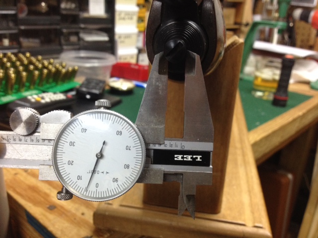

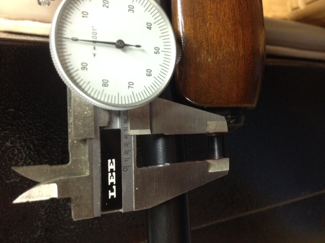

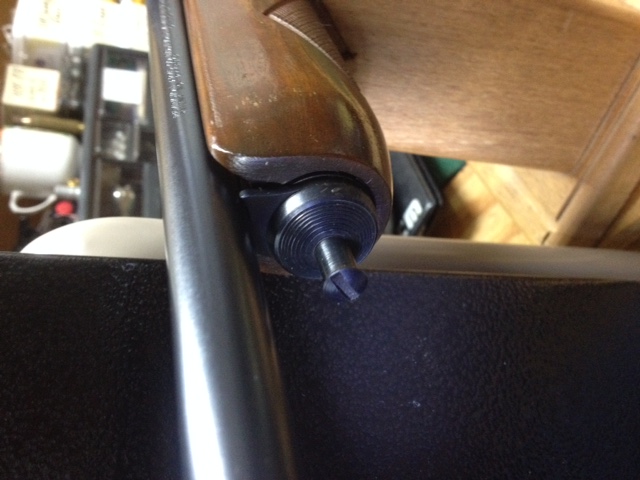

Here is what I took off the rifle... Screw length/space for the 'donut' for the swivel is .400". Diameter of the screw is .300". See screw head in the pic.
Looks like, for some reason, someone took the donut swivel holder off the rifle. No clue why, but then I can't figure out why it has the Griffin and Howe removable mount when it was factory D&T for a scope! Who knows!

Screw threads don't/won't matter. Screw shaft is smooth - not threaded. If hole in 'donut' is at least >= .300" and thickness is <= .400" - it should work.
If you are willing to part with it, let me know and we can work something out. If it won't work for me I can always send it back to you.

Bought a set of drill bit stop collars. Tapped it for sling stud, added a cone washer and I am set! Looks like it belongs!
