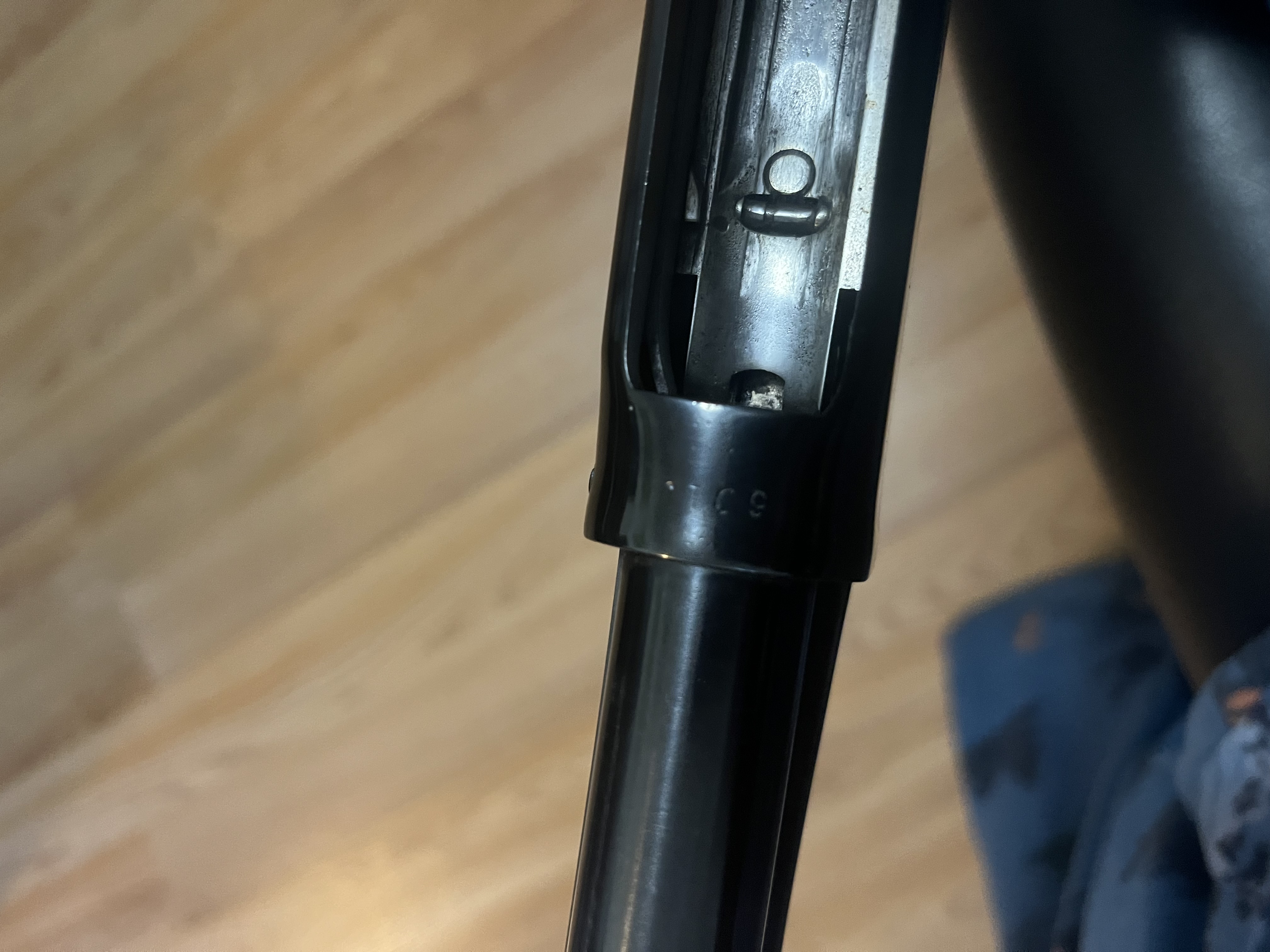

Need help, I have came into a model 17 with no receiver markings. Numbers on barrel on left side show 6019 and on bottom forward section of receiver it depicts 601 and what appears to be the lower portion of the 9 but appears stamp was not properly set to press the full mark.
Trying to find date of manufacturing and any additional information regarding this item.

Your shotgun has been reblued. Heavy polishing has removed the stamped information.

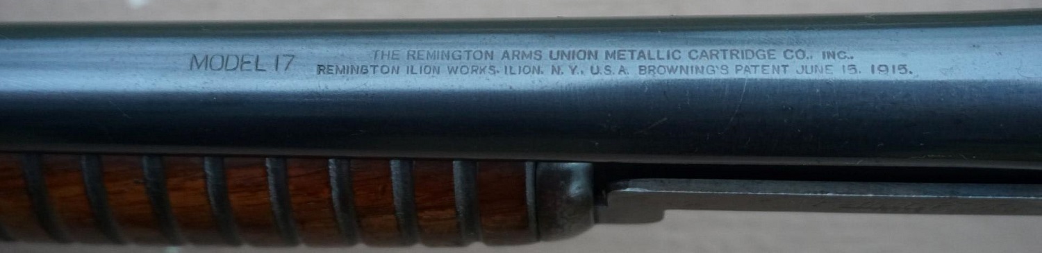

They must have been already working on them for a while as we see the barrels marked The Remington Arms Union Metallic Cartridge Co., Inc. into the 28xxx serial number range.
14837 02 The Remington Arms Union Metallic Cartridge Co., Inc..jpg (108.73 KiB) Viewed 8585 times
Your gun 6019 would certainly be an early one from 1920/1. Unfortunately, the first page of Model 17 production is missing from the old factory ledger. Page 2 starts with serial number 35637 as the highest serial number receiver put in work by January 19, 1926.
