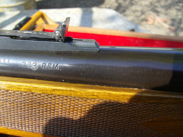

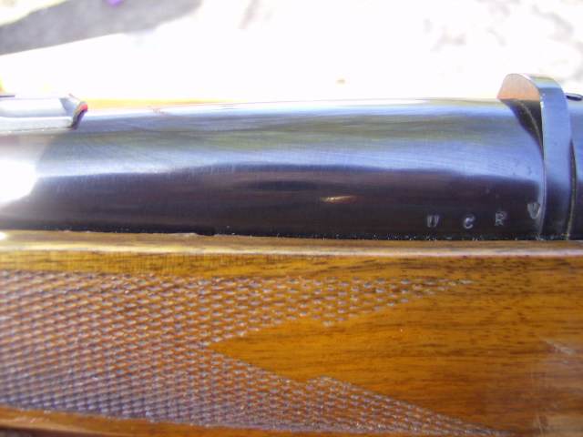

I have a model 660 chambered in a .223, It appears that a 3 is stamped over the 2. With that in mind, I sent a request to Remington and was in correspondence with Pete Harding to have the serial # verified, I did not give him the barrel code. His responce to me was that it is indeed a .223 manufactured early in 1968, a very rare find. I checked the barrel code myself and low and behold it too said the barrel was made in April 1968. I also read on this forum a fellow had a 700 VS in a .223 , with the 3 over stamping the 2, also read where the 6.5 mag. had the mag.xxx out. I've had fellow collectors tell me mine is a counterfiet. Well I paid a $150 for it back in the 80's , they appariently didn't make much of a profit. Is there anyone here that can tell me with out a doubt that mine is a fake and that under no circumstance would Remington stamp a 3 over a 2. I've read they used the same sights on most of their rifles to save a buck or was it inventory space. I somehow doubt somebody went to the trouble of getting an early 660 .223 receiver accourding to serial#(very rare) and then finding a .222 barrel with an April 1968 barrel code and rechambering it to a .223 for a whopping $150. Is there really an expert that can give me facts rather than opinions. Otherwise I feel that Pete Harding at Remington Arms Co. would be about as good a reference to the rifle's authenticity as I can get, he does work for the company that made the rifle.

There are no records that indicate what serial number was stamped on what caliber. What he may of done was matched the serial number to a date and the date to when the 660 was produced in the 223. In 1968 200 660s were made in the 223 and none in 1969, and then again in 1970 the 27 were made. By the looks of your three I would say its 99% counterfit. They did not stamp any 6.5 rem mags with XXXs. The XXXs came out on the 6mm Rem Mag, but that is a totally differant story. That had nothing to do with counterfitting. There are so many people that try to pull this over on people, and there are many many more that just like the 223 better than the 222. So they have a rifle they really like and they have it reamed out to a 223. Even though the 80s seem so long ago it would be hard to believe a 660 in the 223 would have sold for $150.00, but you may have been in the right place at the right time. If remington was to do what you are hoping they did they would not of used such a large 3. I also own a Remington 700 in the 6mm Rem Mag, and the mag is XXXed out and they are the same size. I would have to say SORRY its counterfit. Let me know if you find out any other info.

remington600 Again I thank you for your advice, and of course this a public forum, as for name calling what name did I call you other than friend. As far as the serial # test you have given me, it would help if you told me the model (not caliber) the # came off of. Like the barrel codes C R that could be for April 1924,1968,1997. You don't think the serial# is unique to all Remington firearms but rather too a particular model, due you?

222 in a Remington rifle always seemed to have a 1 in 14 twist. Most "hunting" rifles in 223 have 1 in 12 twist. Might this also be a telltale way of exposing a rechambered 222? Remington600-we should talk. I think you could teach me alot.

Someone rechamered it to 223 and marked it as required. Lighteup it is not a fake and IMHO not a collector.
It is a hunter/shooter. When I find one and want it for myself you can bet I will run the reamer into make it .223.

After all these comments, let us know what the barrel twist is.
I am also a member of the research team, but my interest is primarily in .22s. My bet is that it is a stamped over .222. I have seen several of them over the years.
