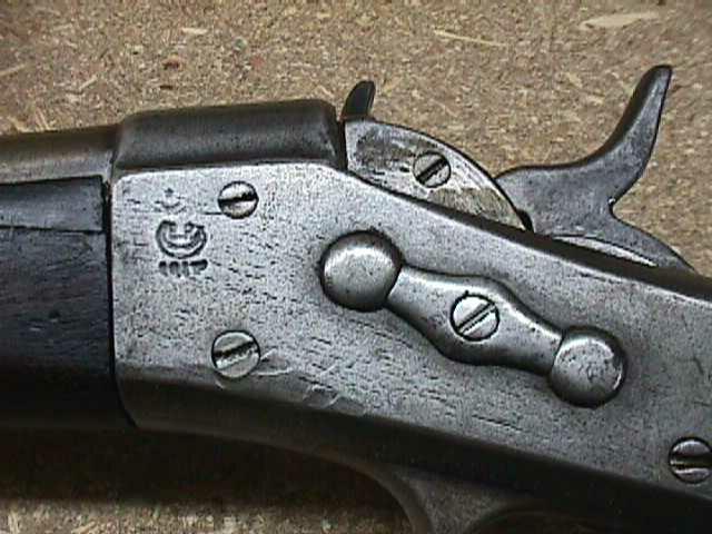

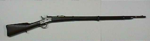

Hi everyone, I'm collecting info about clashes happened in Sudan in the '70s of the XIX century between Egyptian governative troops and Sudanese rebels.
At that time Egyptian soldiers were armed with Remingtons rifles, in fact in 1868 a large order was placed with Remington by the Egyptian Government for the No. 1 Remington Military Rifle to be chambered in the ".43 Egyptian" cartridge, because they asked some sort of "proprietary cartridge".
My main question now is about the .43 cartridges: in a contemporary chronicle of a battle, an Egyptian officer awaiting for supplies for his troops (armed with Remingtons) states that "finally the long awaited barrels of black powder and leand ingots arrived to the battlefield".
I've seen pics of the .43 cartridge and it seems to me an industrial factory made one, quite similar to the modern ones...was it possible to somehow recharge those cartridges? A supply of ammunition was to be intended as boxes of already assembled cartridges or was it possible also for the soldiers to assembly their own ammo starting from blackpowder and lead?

When one considers what type of soldier made up the Egyptian army at that time, I doubt very much that they would be capable of reloading any cartridge casing at any time. If, in fact, the Egyptians or some of them, might have been using muzzle-loaders of some kind, even casting lead bullets on the battlefield would have been totally impossible. My guess is the author of that report was mistaken or not even an individual present at the location of the battle. Cartridges were shipped in wooden cases. The wooden cases were lined with lead foil. The .43 Egyptian cartridges and the .43 Dutch Beaumont cartridge were largely interchangeable, quite similar. The bore diameters may have been a bit different. Your rifle appears to be in pretty good shape consider the years of use and mostly abuse it went through!
