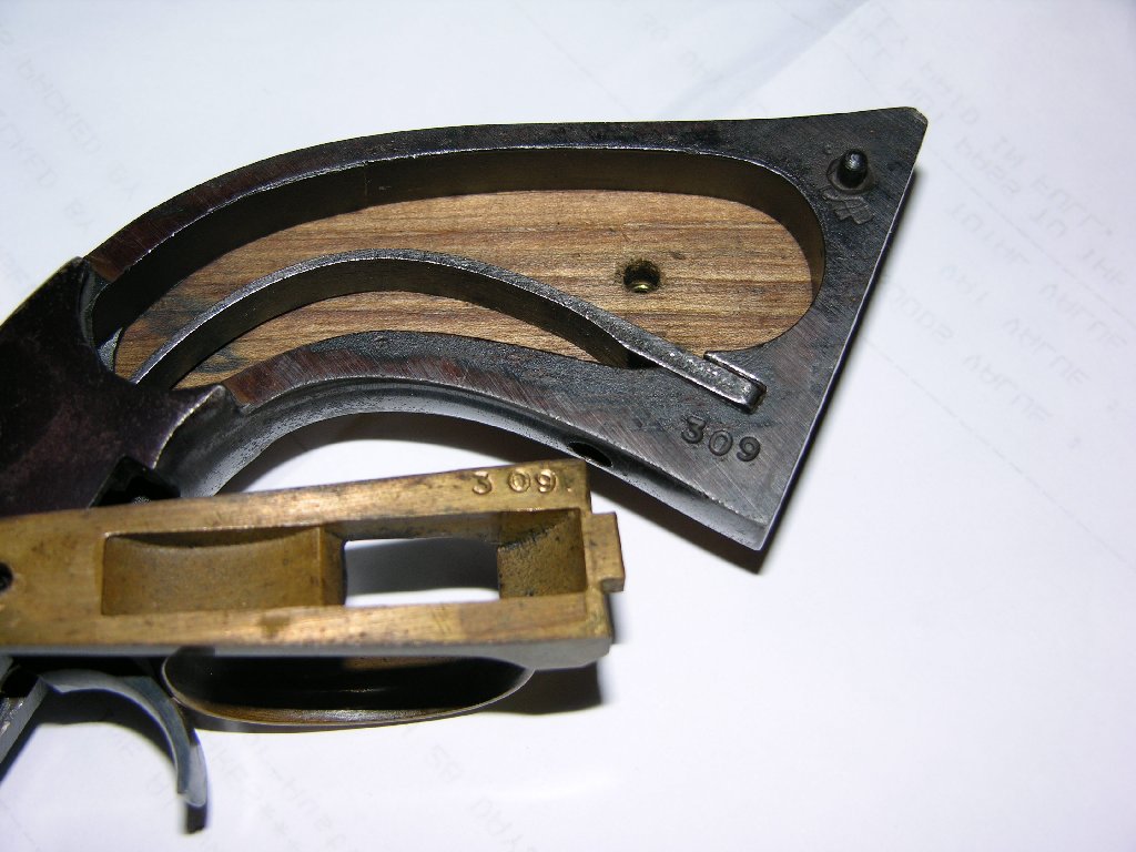

Mick, I'm attaching a picture of my repro NMA .44, made in 1978 (decoded from the Italian stampings). Made for the Navy Arms Co. N.J. by Pietta.
Note the 3 digit code "piece parts" numbers on grip frame and trigger guard.
Also note the short guard "tang". My cylinderhas got a different part number, but the barrel underside, hidden by the cylinder pin, has the same 309 number.
I fear that someone has obliterated the other tell-tale markings and "aged" the gun. Can you produce a good photo of the barrel top "legend"?
Best regards, George.

- part numbers
- Frame and Guard - repro.jpg (116.24 KiB) Viewed 6095 times
