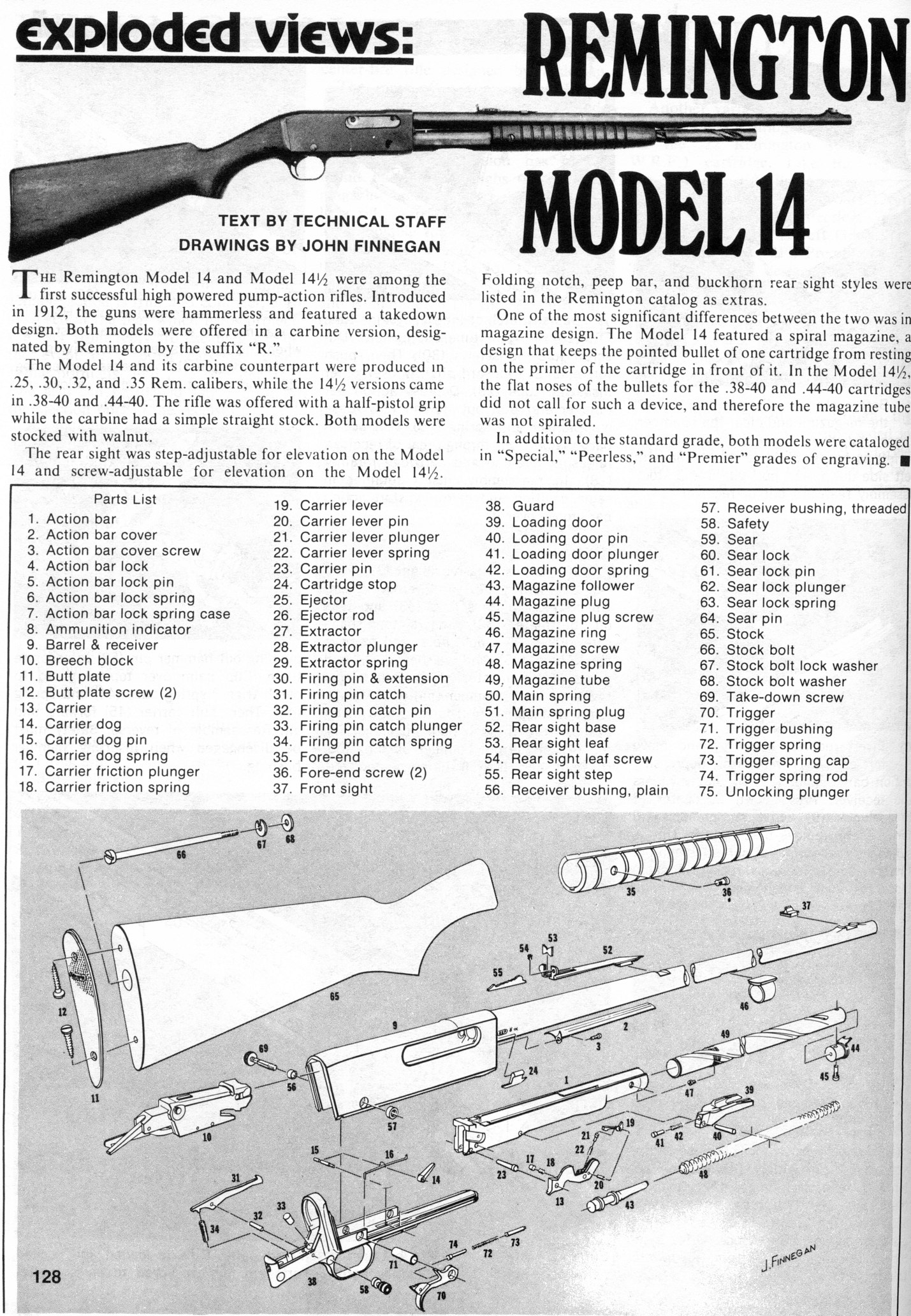

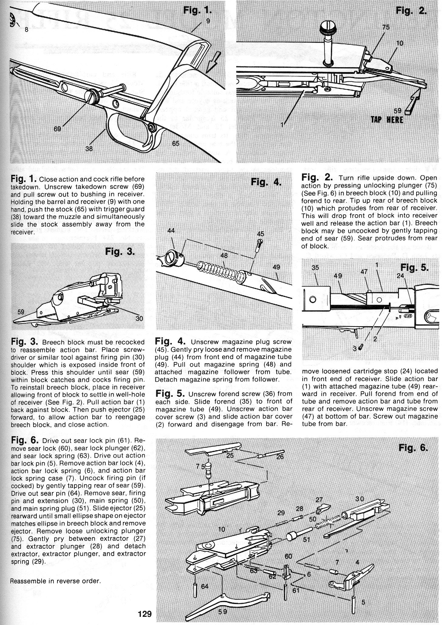

Model 14 - Dissassembly
American Rifleman - 1980
- Model 14 American Rifleman disassembly (clean copy) p1.JPG (1.97 MiB) Viewed 48734 times
- Model 14 American Rifleman disassembly (clean copy) p2.JPG (2.8 MiB) Viewed 48720 times
fbc3
Re: Model 14 - Dissassembly
Do you have a rifle available or only this drawing to reference?

The drawings will be great for reference, but the pin seems to be friction fit in the nose of the striker, and does not remain in place.

The firing pin should go back about 5/8" then cock or lock into position, it doesn't go back easily because there is one helluva spring inside but should readily engage. If it is not engaging there is the possibility that the sear lock is NOT doing its job. The sear lock is held into position by a pin that is easily removed, underneath the "sear lock" is a plunger/spring that work when the bolt is cycled. The sear lock "could" be damaged/missing or the plunger could be damaged. The lock has a flat base on it as you look at the bottom of the bolt and should not move freely but rather needs to be pushed against the spring plunger which are parts that are not easy to find and are slightly different than those used in the Model 14. They are around however.
