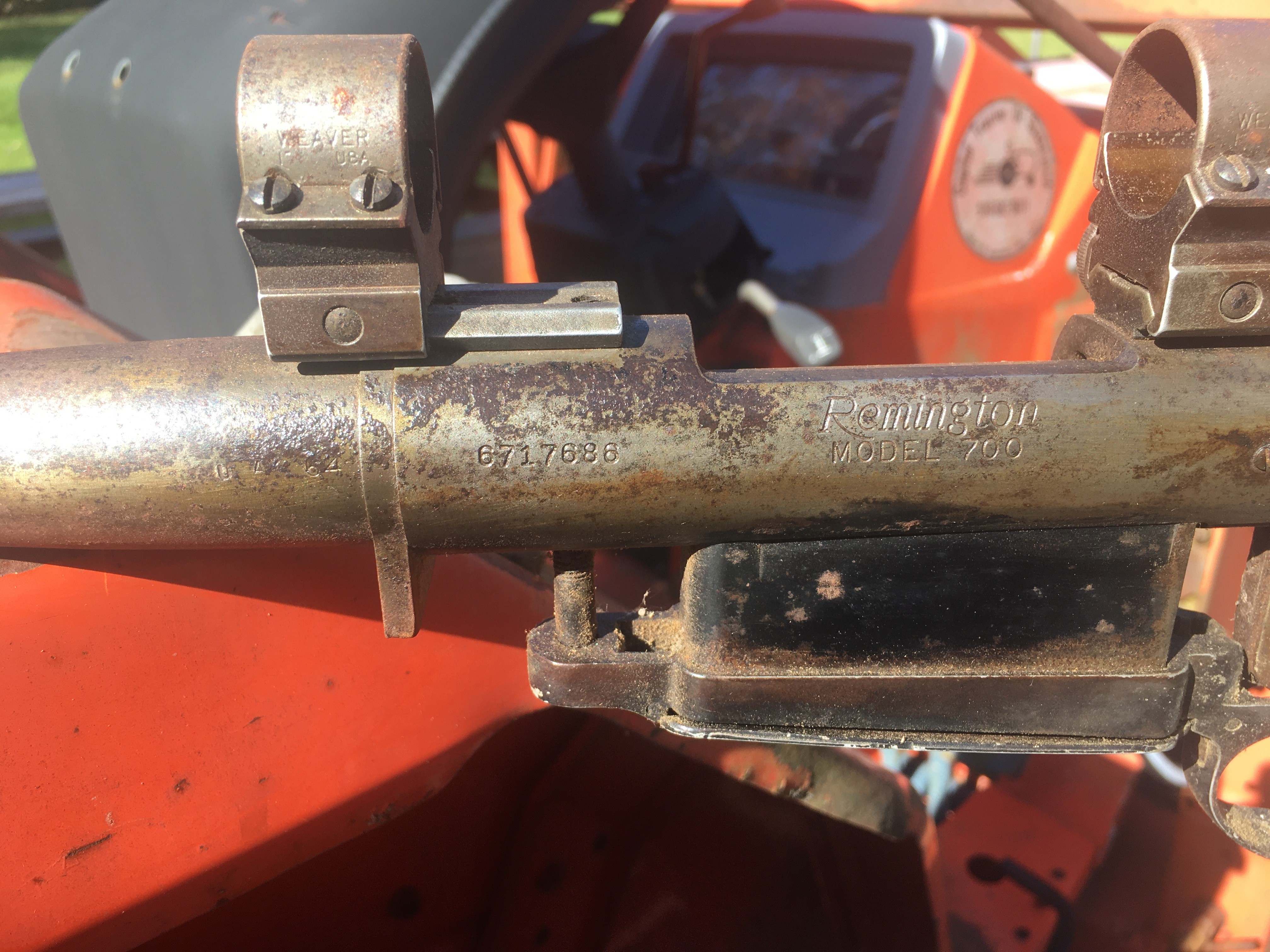

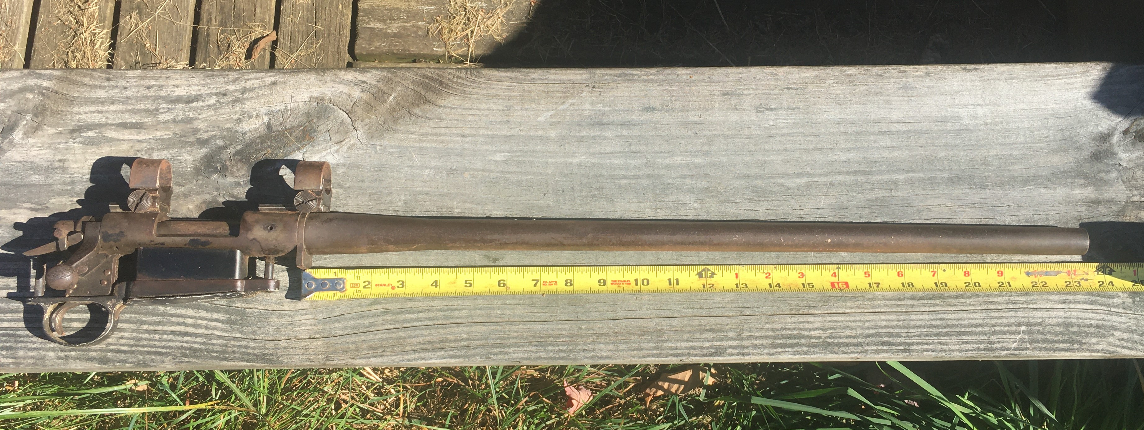

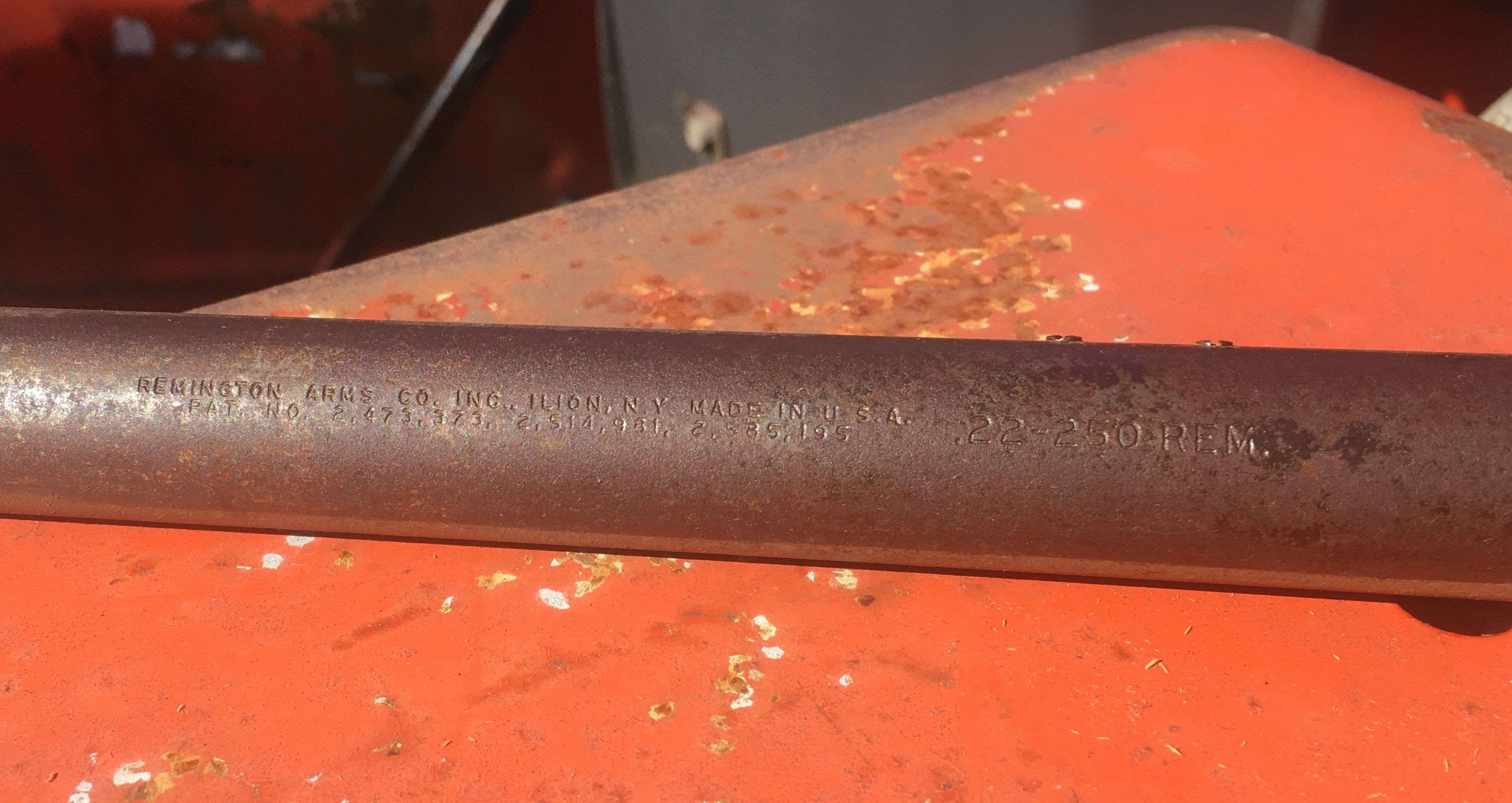

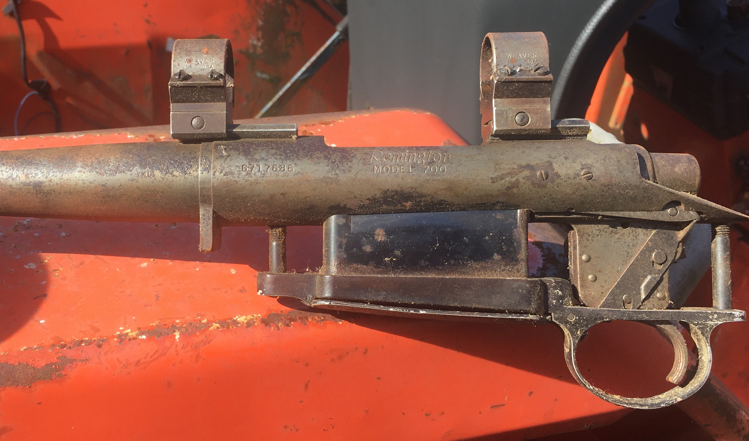

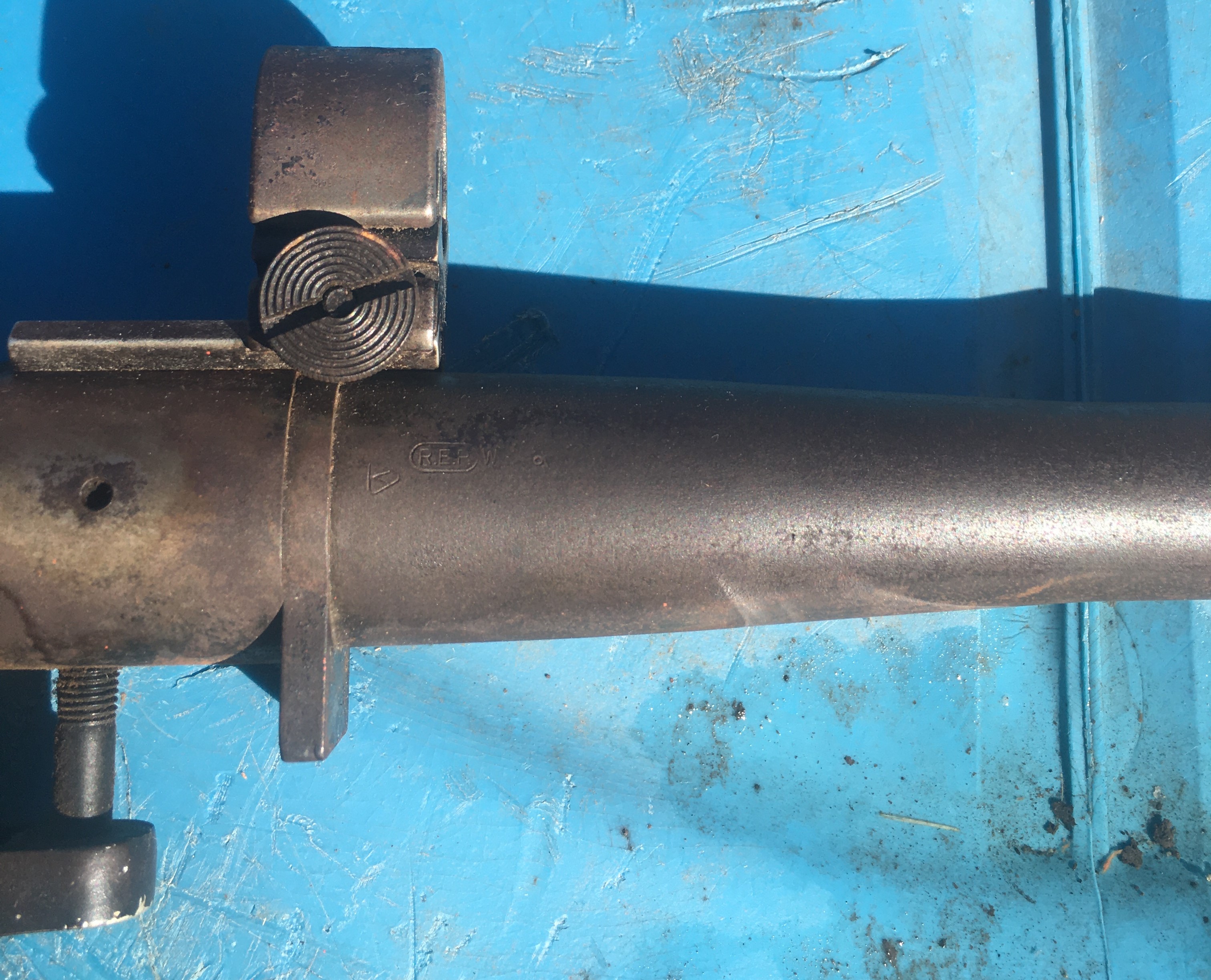

Hello- Newbie here, Apologies if I've revived an old post, but thought that might be how a new same question is asked. I found a 700 receiver/barrel (no stock) combo in a garage [sn:6717686, .22-250 cal] and wanted to see if it might be worth turning back into a rifle. I've always wanted a bolt action rifle and would be willing to put some time/money into it but don't want to learn gunsmithing on a valuable piece of history, if indeed that is what this is. I've read the manufacture-dates page and can't seem to make mine fit. Some of the markings are unclear to me and I'm hoping someone here can recognize them through the surface blemishes.
Some info to help you out-
Barrel Markings Left side:
U AY 64 (my read- this I don't understand)
Barrel Markings Right side:
The magnaflux mark contains a "V" rather than "S"- is this significant or just different?
There is a "W" stamped next to the [R.E.P.] proof mark, which is not described anywhere I could find. What's that for?
I'd like to know the approximate age of this; if there is any collector interest as original and an opinion if this condition/vintage is worth restoring for actual use. I've read a few negative reviews about QA/QC on certain vintages. Thank you very much for your time.

Chicken Bob wrote: Sun Oct 20, 2024 12:48 pm Hello- Newbie here, Apologies if I've revived an old post, but thought that might be how a new same question is asked. I found a 700 receiver/barrel (no stock) combo in a garage [sn:6717686, .22-250 cal] and wanted to see if it might be worth turning back into a rifle. I've always wanted a bolt action rifle and would be willing to put some time/money into it but don't want to learn gunsmithing on a valuable piece of history, if indeed that is what this is. I've read the manufacture-dates page and can't seem to make mine fit. Some of the markings are unclear to me and I'm hoping someone here can recognize them through the surface blemishes.
Bob
Looks to be a ‘74 model. It’s pretty rough. In that condition I’d say parts only at best. I’d be interested in it if you want to part with it.
