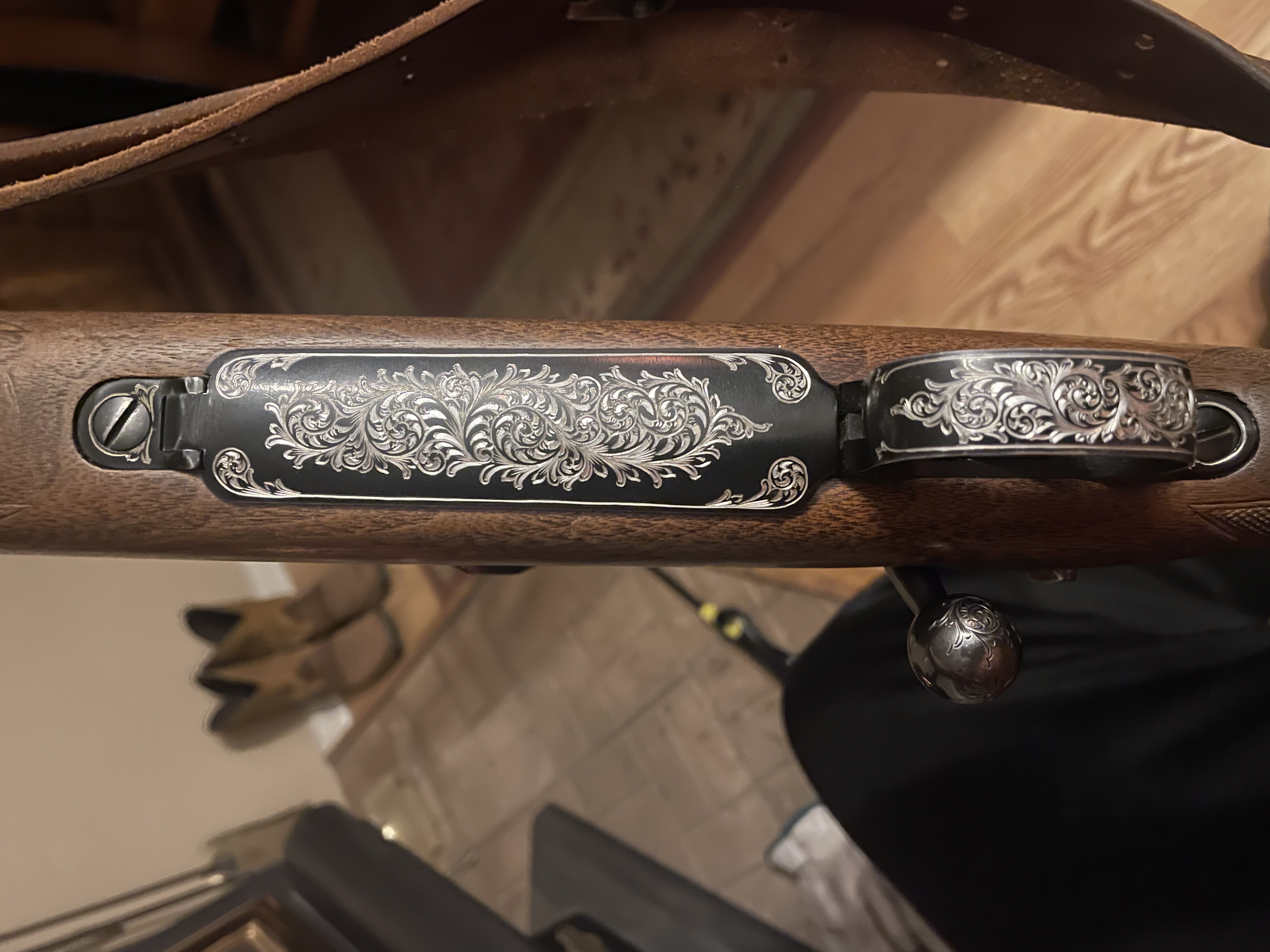

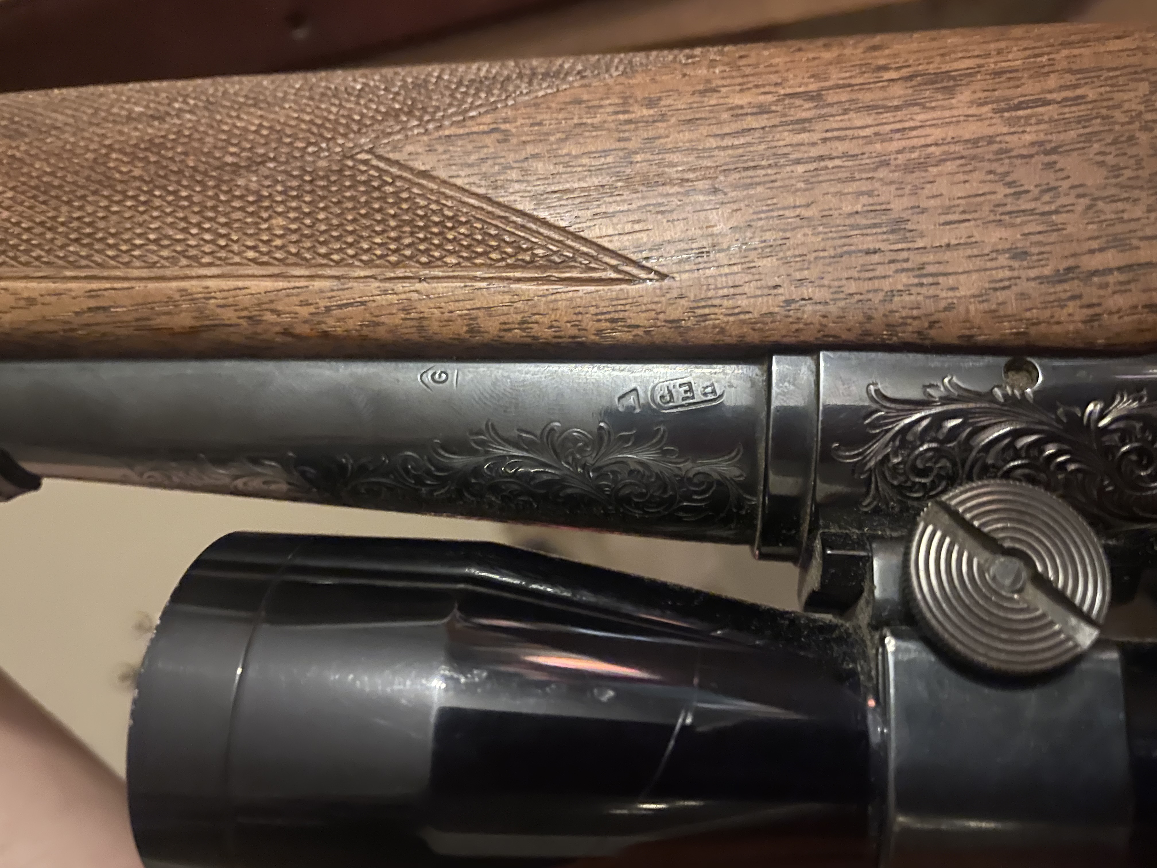

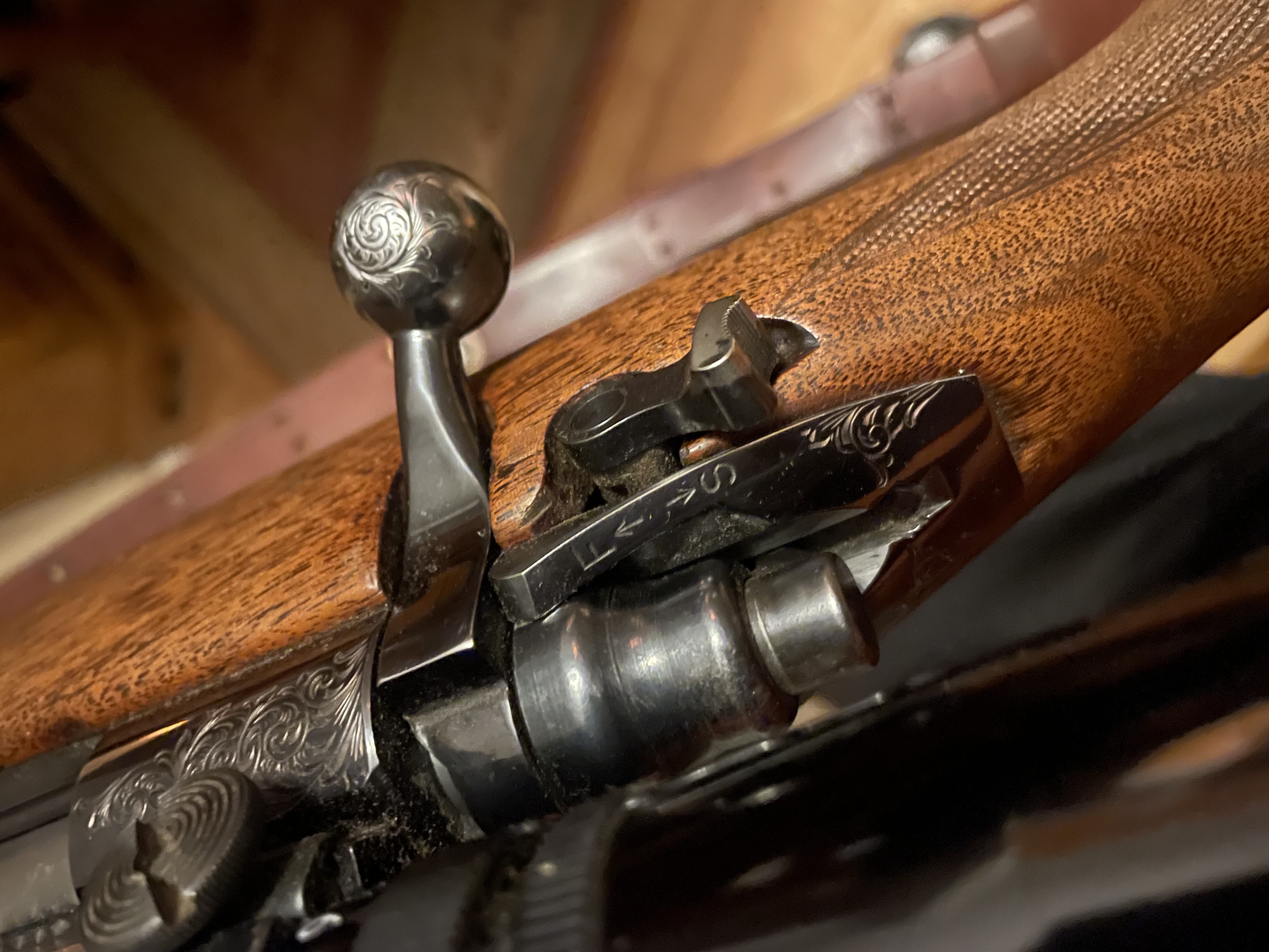

Joined: Sun Jan 12, 2025 6:46 am
Re: 721 722 725 dates of mfg
Post by Lagunita »
Hello new to the forum. Looking for some help to identify the grade of this 725. Based on serial number was manufactured in 1958. Caliber is 30-06 and appears to be factory engraved. Any help is greatly appreciated. Thanks

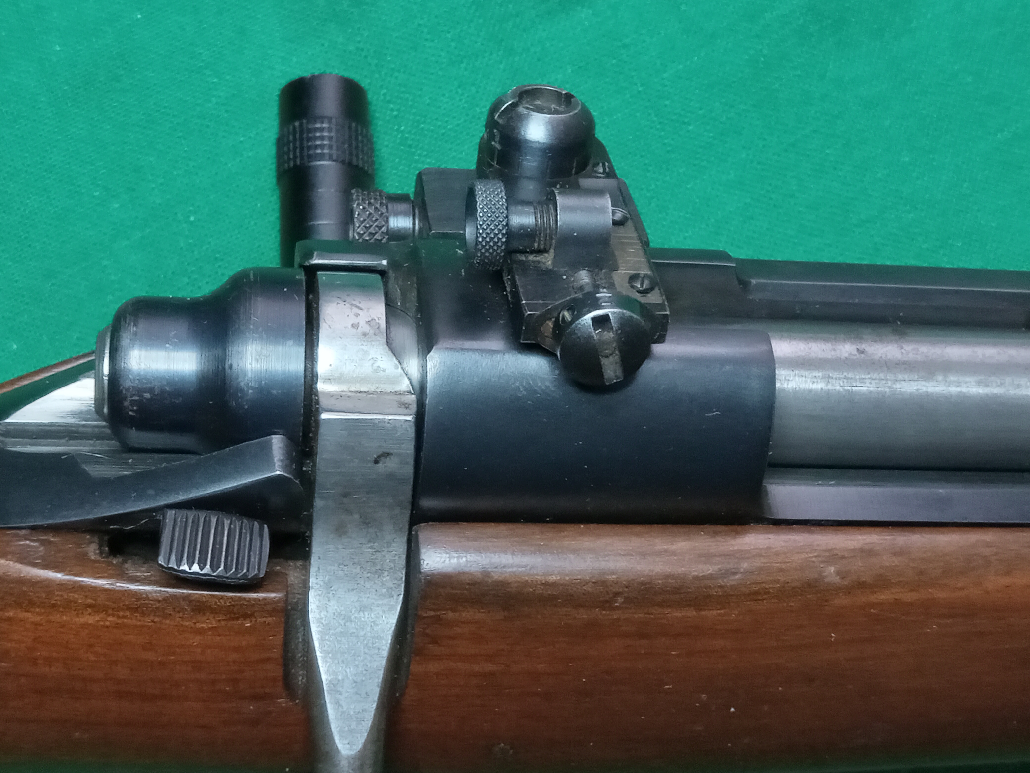

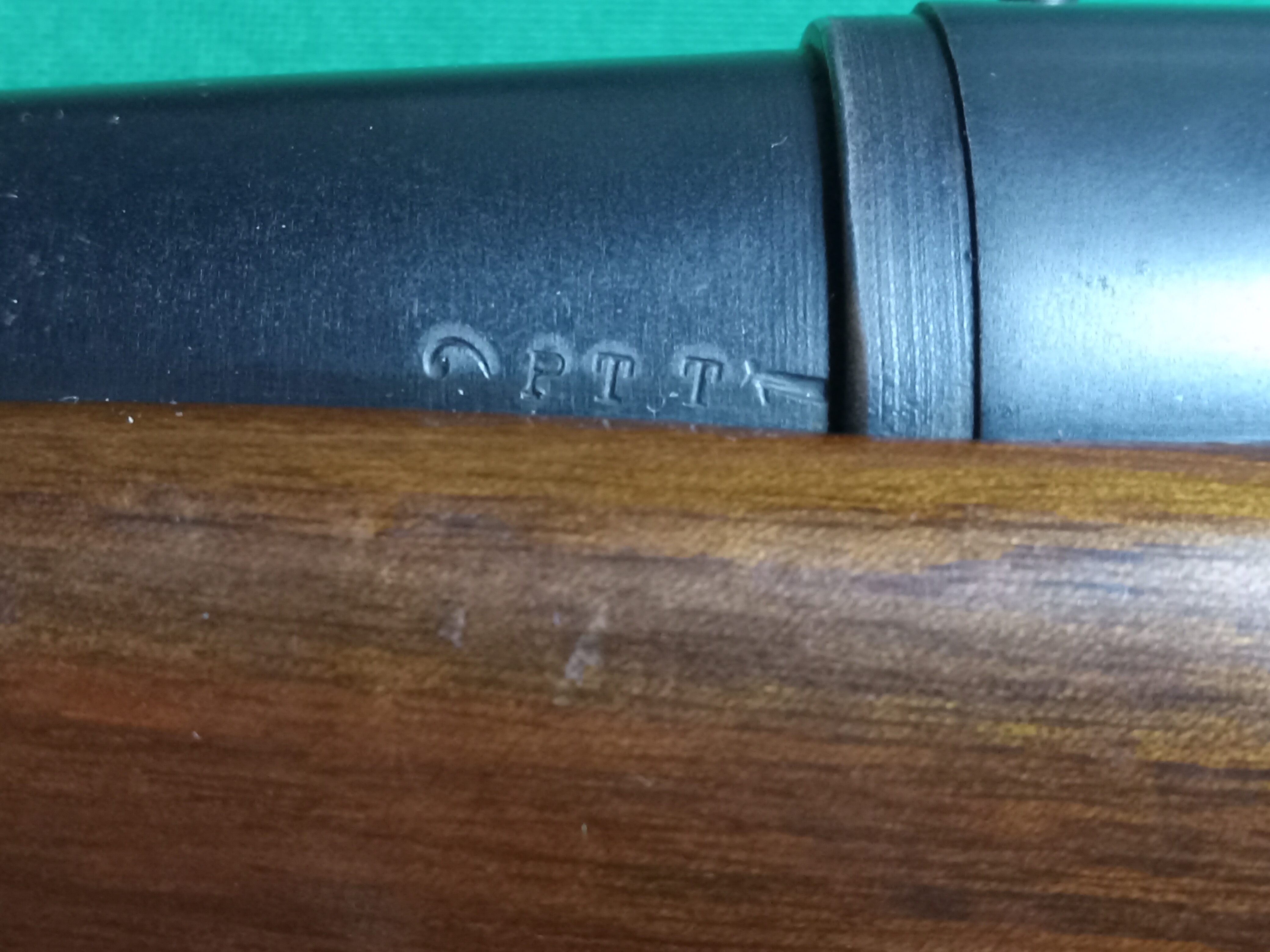

Hello, My first vintage Remington
A model 721
361XX, 721, .270, PTT, 6/48
Also has a vintage Lyman 48 WJS sight, appears to be original to the Rifle.
Dave
