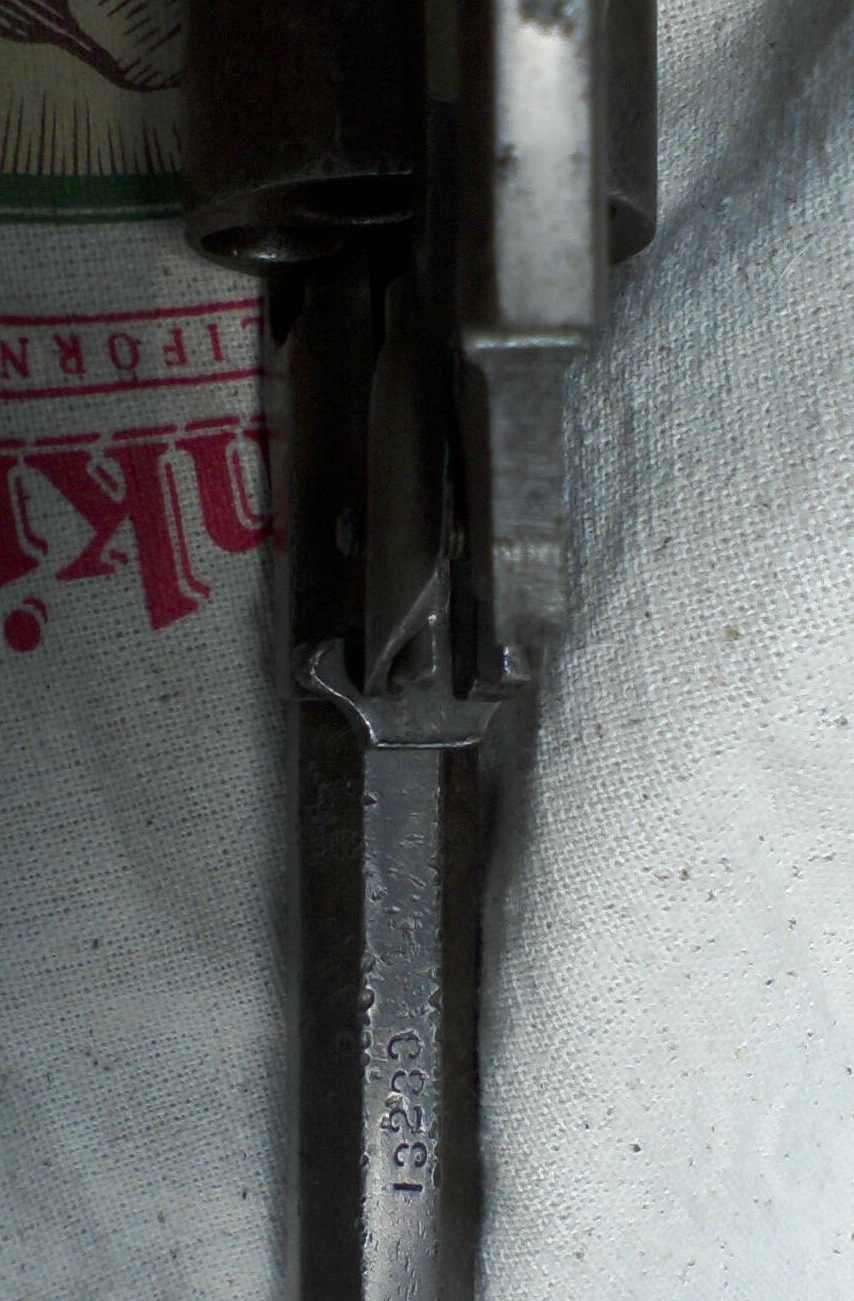

I am considering purchasing an 1858 Remington New Model Police percussion revolver from a friend, but wanted to confirm a couple of things prior to tendering an offer; here is what I already know about the pistol: serial number 13233 on the underside of the barrel under the loading lever (is this the only one?); overall brown/gray patina with traces of original blue in recessed areas on frame in front of cylinder on left side & behind cylinder near hammer (overall, less that 10% original blue present); case-coloring no longer evident on hammer; numerous nicks on barrel, frame & cylinder, but not unsightly; action mechanically tight/good; loading lever screw replaced with what appears to be a custom machined one that is a bit too long & protrudes slightly on the left side; stocks of walnut with sparse varnish remaining, but complete. Based upon Flayderman's Guide to Antique American Firearms & their Values, 9th Edition, I believe this would be classified in "GOOD" to "VERY GOOD" condition.

Most original percussion revolvers that were converted to cartridge will be a low serial number, Usually they added a two or three digit number to the original serial number which became the conversion number. You should find the serial number also under the trigger guard when removed on the tab that interlocks it into the frame, and under the grips on the left side of the frame. Usually a conversion number is put here if were converted. Since your gun has a high serial I believe it was made as a cartridge gun originally. Jay Huber RSA

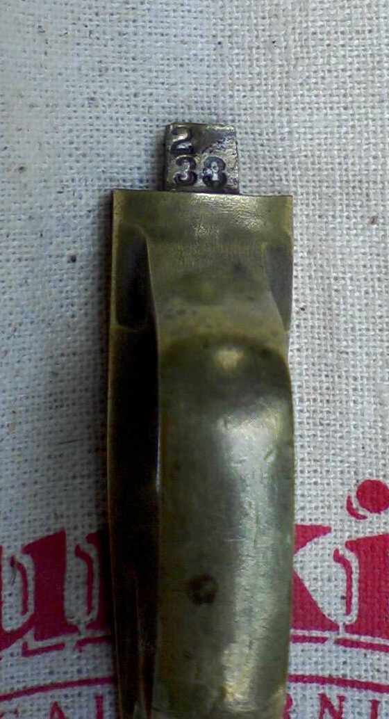

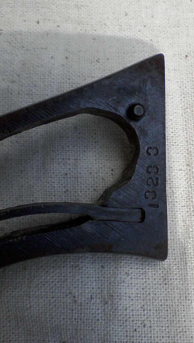

I checked under the tab on the trigger guard, the number there was 233 and under the left-hand grip, the number there was 13233. Would that mean the conversion number is 233 or just the last three (3) digits of the serial? Would the percussion cylinder be marked with the same number & where?

That is the last three digits of the serial number on the tab. The percussion cylinder probably isn't marked since it is an accessory that could be bought as en extra for the gun Jay Huber

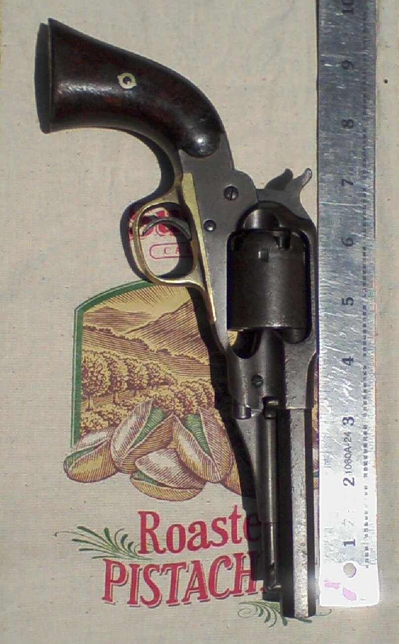

I have run into another anomaly: the pistol I have has a five(5) shot cylinder & 4.5" barrel like you would expect to find on the Remington New Model Police revolver; however, the markings on the barrel are those found on the Remington New Model S/A Belt revolver, see below:
PATENTED SEPT. 14, 1858
E. REMINGTON & SONS, ILION, NEW YORK U.S.A.
NEW MODEL
(the patent date of MARCH 17, 1863 is missing). I have included some pictures that might be helpful in this identification.

From the pictures, the gun looks OK to me. I would say that the stamping is a factoy error in that some worker picked up the wrong roll die. They were making the belt models in the same period. Jay
