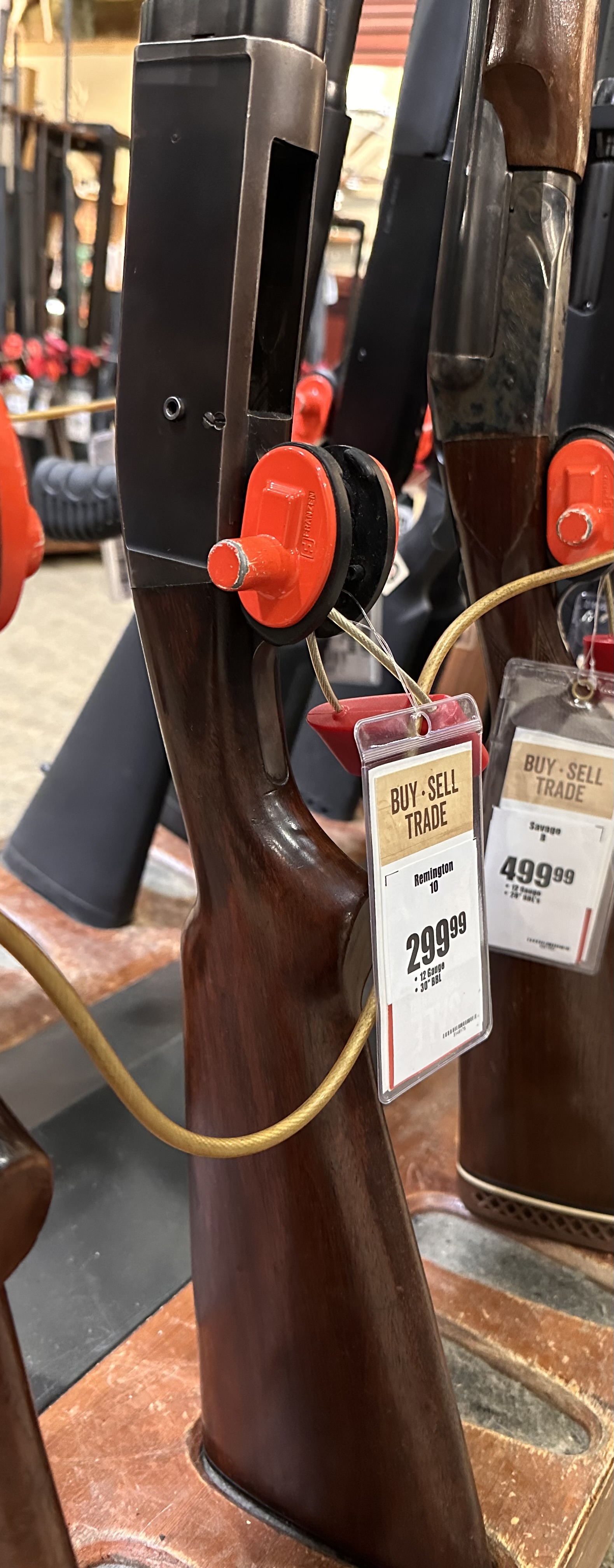

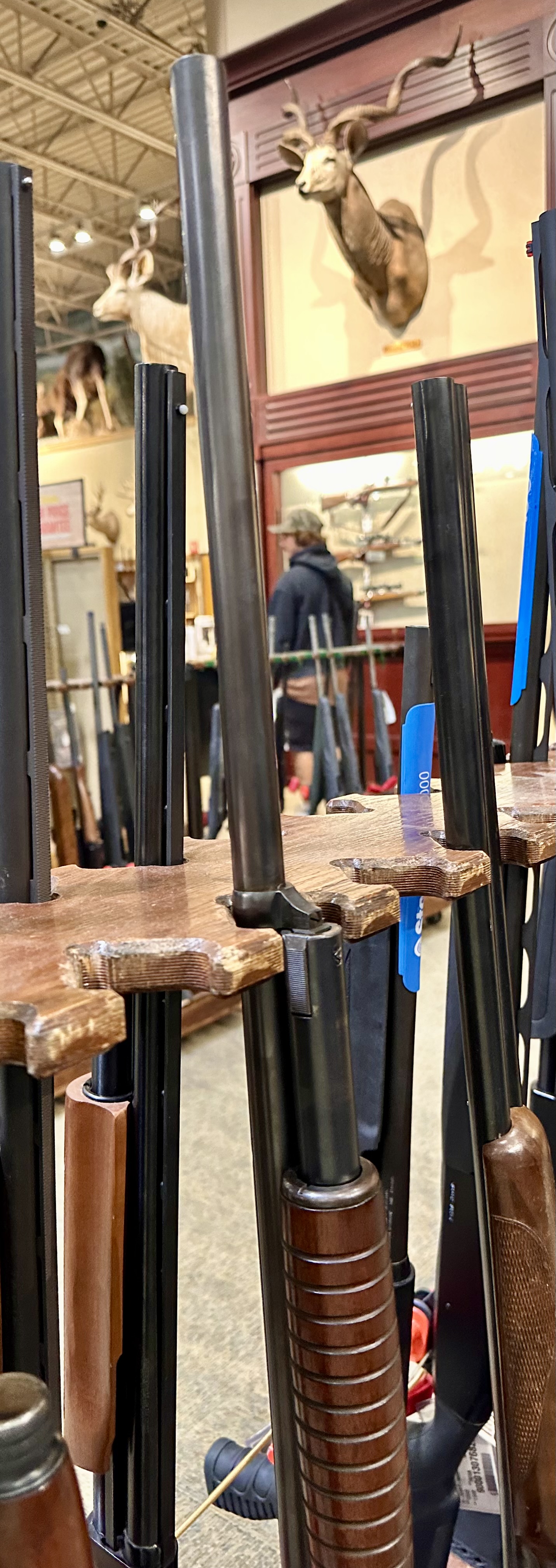

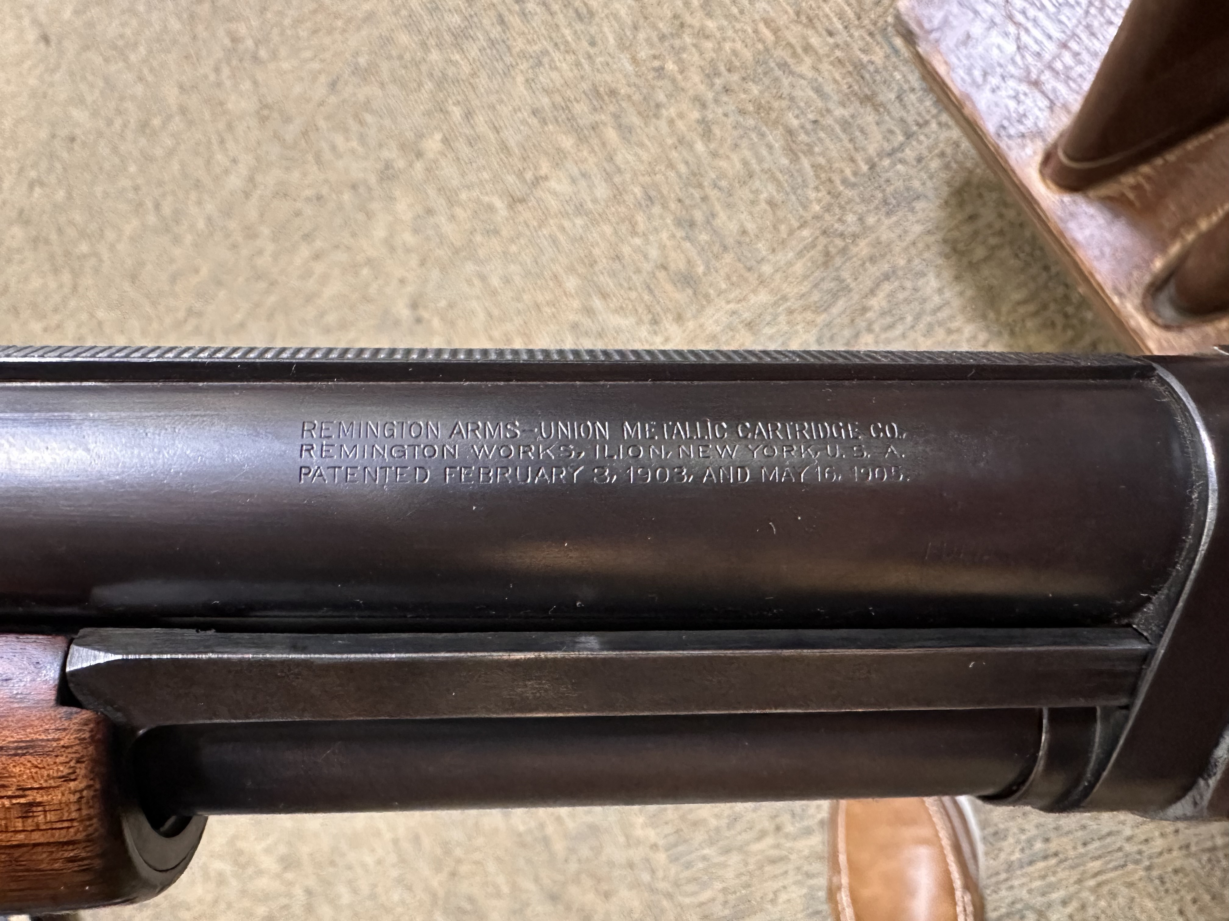

My recent trip to Maine included a stop at Cabela’s. I found a nice condition Remington 12 gauge Model 10 shotgun with solid barrel top rib. SN dates to 1928.
Wood is fairly standard looking with semi pistol grim stock. Receiver only says “Model 10”. Do the various grade guns have their letter postscripts stamped on receivers after the 10? (I.e., “Model 10S”)

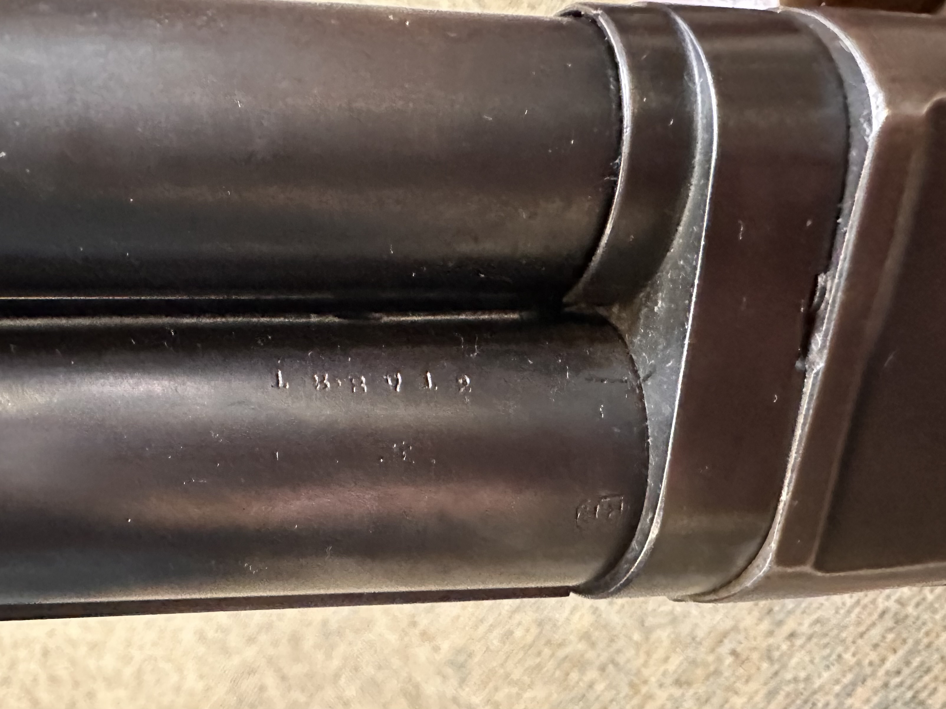

I noticed a number on the barrel that does not match the receiver SN. Is this supposed to be a matching SN to receiver or is it just a production cone?

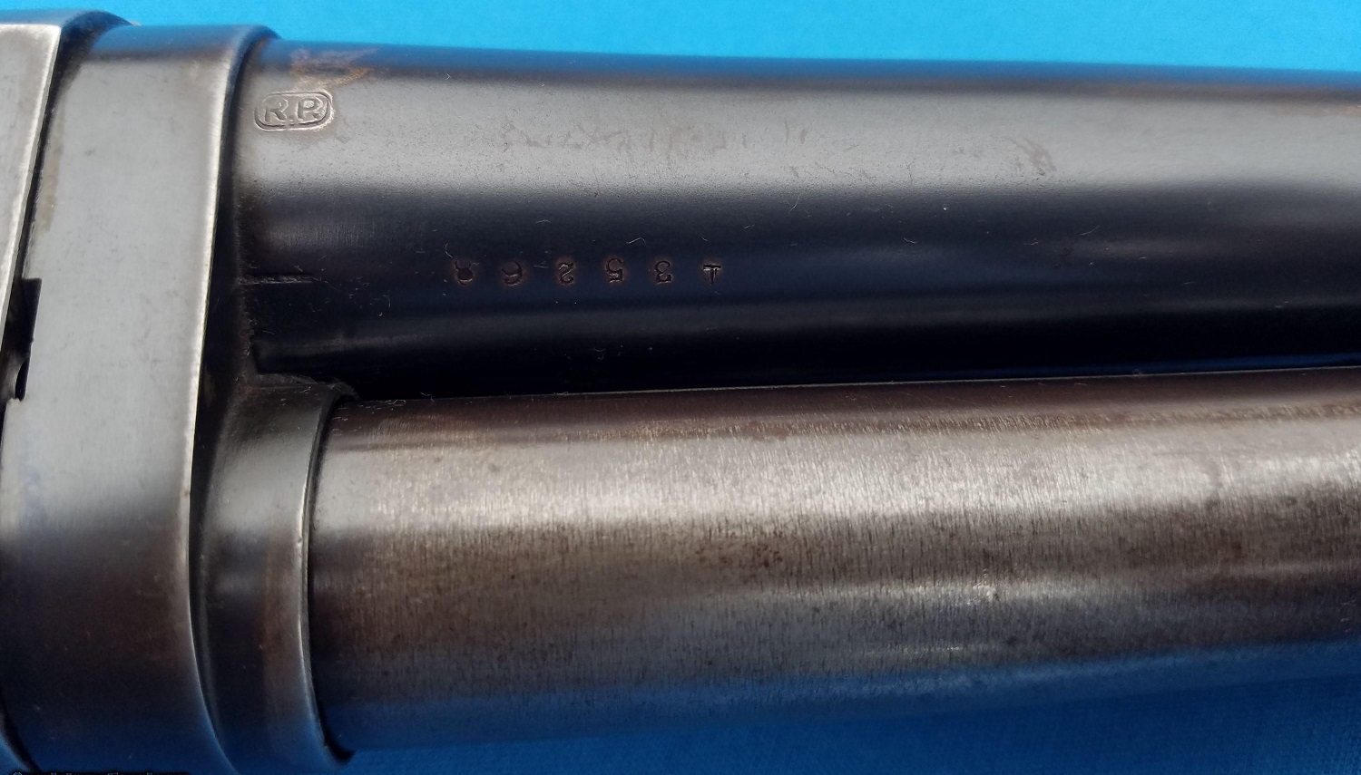

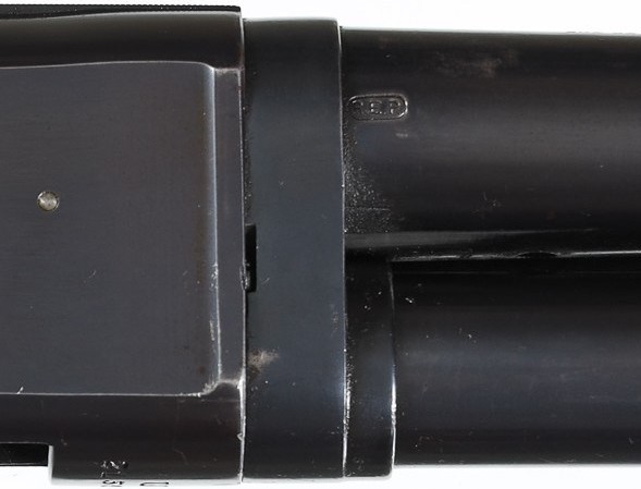

That barrel is from an earlier period than your receiver. The barrels during the Remington Arms - Union Metallic Cartridge Company and The Remington Arms Union Metallic Cartridge Co., Inc. period, 1911-1920, had the serial number stamped to be visible from the right side of the gun.
135268 03.jpg (297.2 KiB) Viewed 447 times

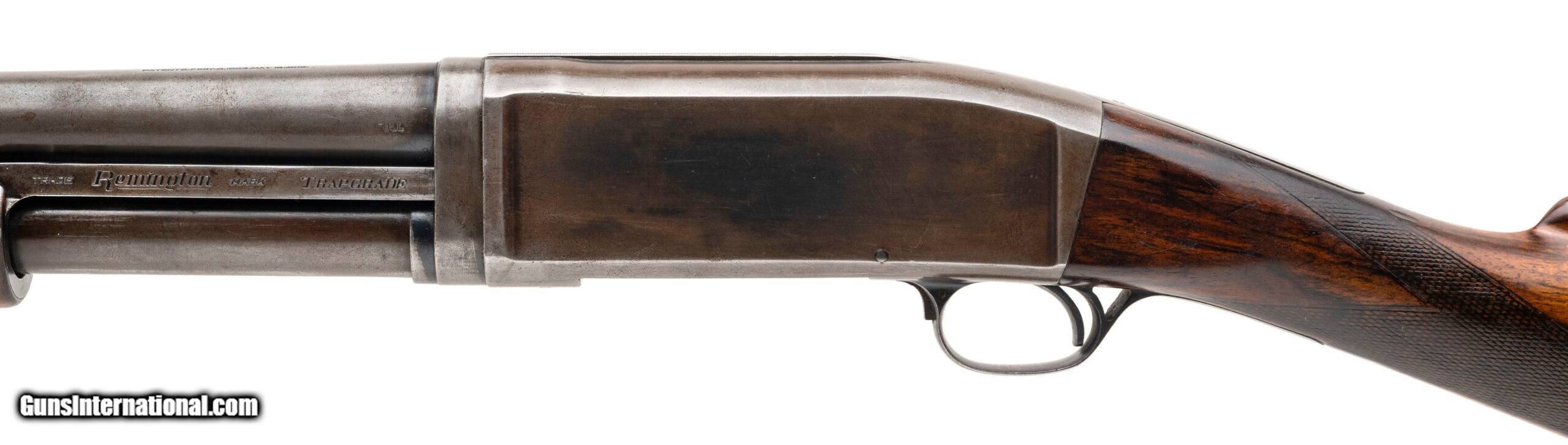

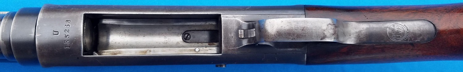

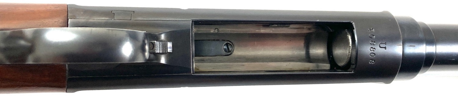

From the beginning, through this era the serial number on the receiver was on the bottom, ahead of the loading port, with the inventory letter U. Also the proof stamp on the right side of the barrel was R.P. in an oval.
135268 01 Model-10A, 30-inch, Full.jpg (121.82 KiB) Viewed 447 times

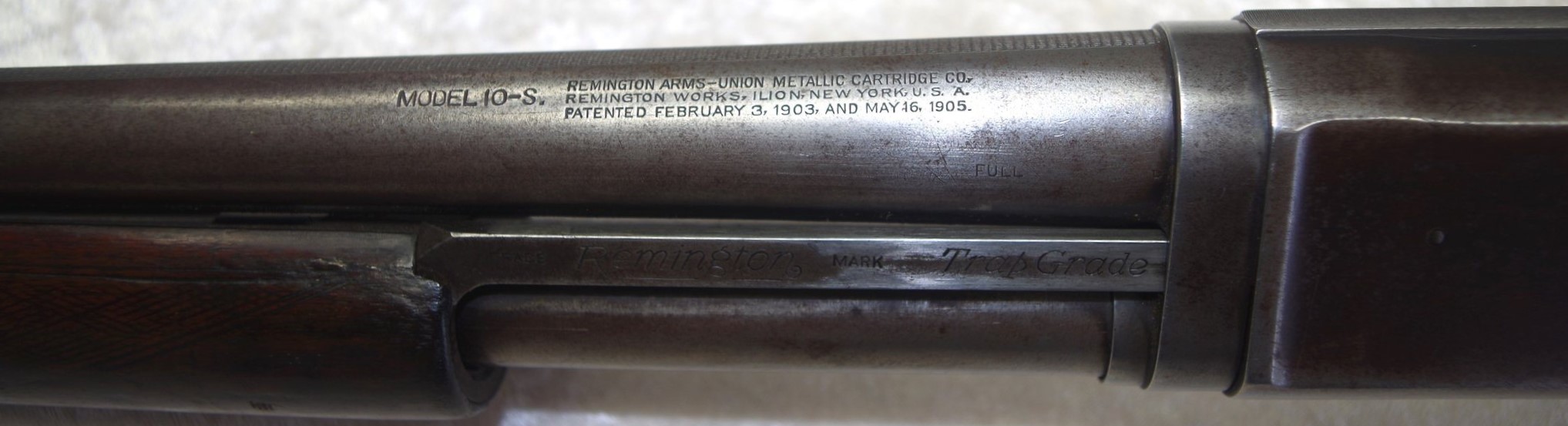

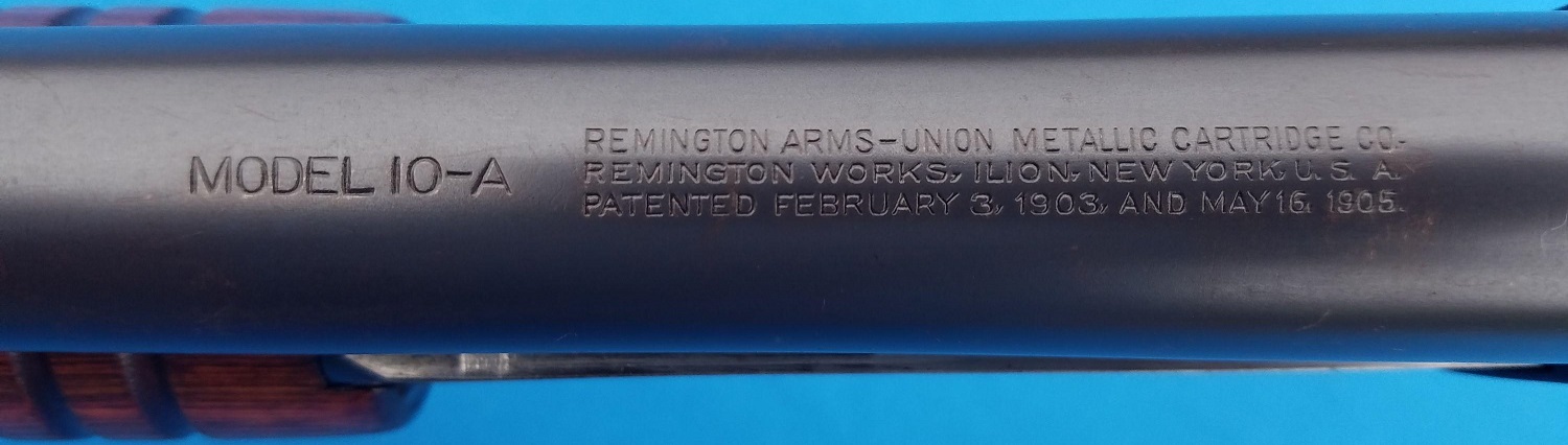

During much of this period the barrels were marked MODEL 10 and the grade letter --
135268 02.jpg (145.12 KiB) Viewed 447 times
Model 10-S with matted 30-inch Full barrel.jpeg (168.27 KiB) Viewed 447 times
The serial number remained on the bottom of the receivers for a while after the 1920 formation of Remington Arms Co., Inc., --
208808 04 July 1921.jpg (157.97 KiB) Viewed 447 times

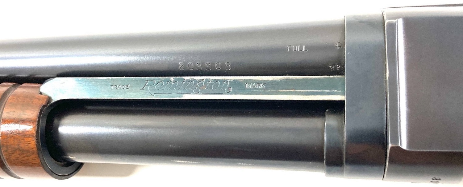

they began putting the serial number on the left side of the barrel --

I haven't narrowed down when the moved the serial number from the bottom of the receiver to the left side along with the Remington Trademark logo and MODEL 10, but it is somewhere between the 215xxx and 232xxx range. The engraved guns Tournament, Expert and Premier grades always had the serial number on the bottom of the receiver. Also, the C "Trap" Grade and S "Trap Special" Grade had Trap Grade on the action bar --

That’s a lot of good history. I kinda thought the barrel might be mismatched. I still like it.
