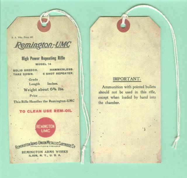

This does not apply to the Model 8 but you should NEVER use anything but round nose bullets in the Model 14. That advice appears eleven (11) other times somewhere in this forum. There are a lot of sharp corners/edges in the feed system that react poorly to anything but RN bullets, even the hang tags that came with the rifle state "use round nose ammunition only" and OACL is critical on the Model 14.

PS : If you have it , my best powder in .32 Remington in my m14's is IMR 4320 to the tune of 34.5 grains with a 170 grain Jacketed RN bullet. I'll add the hangtag referenced by Jim incase you haven't already seen one .
- remington14ht.jpg (40.27 KiB) Viewed 1626 times
