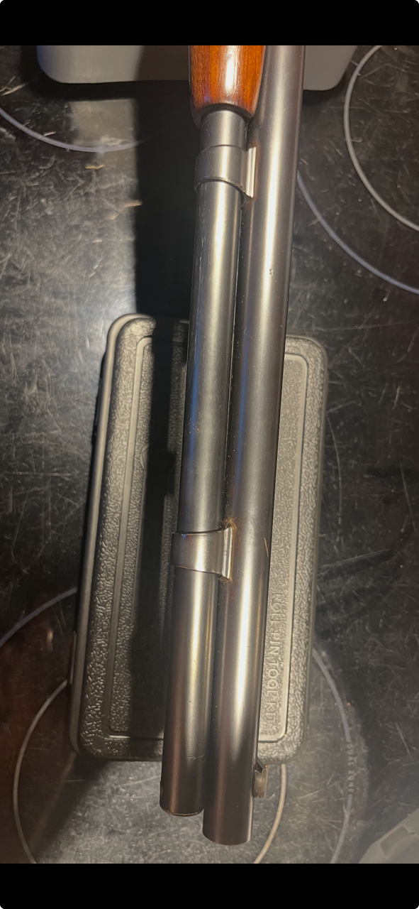

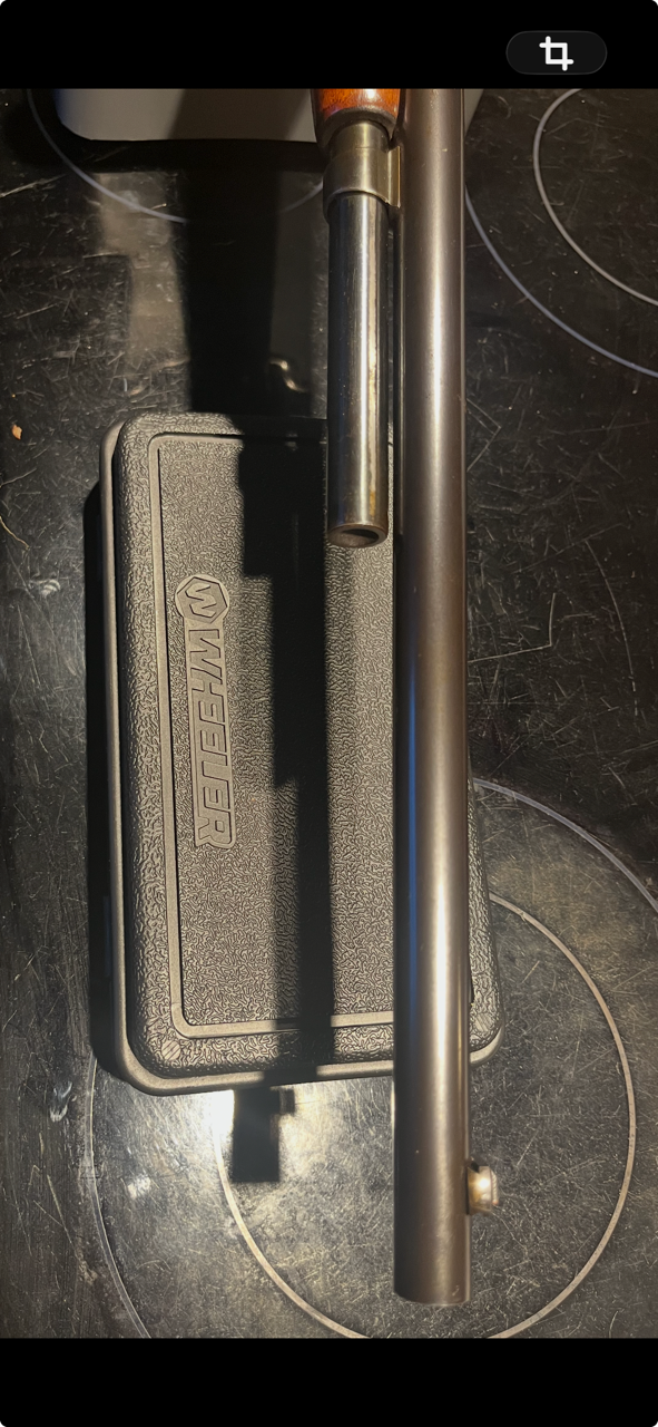

I recently purchased a Remington Model 14 1/2 rifle from Cabelas. It came out of a Denver store and is chambered in .38-40. I can back out of the deal and need to decide whether to keep it or not. I am a stickler for all of my old guns to be OEM, as they came out of the factory. So when Bubba gets ahold of them and starts to butcher and modify them, that is an instant deal breaker for me. I have all of the model 8's and model 14's in all 4 calibers already. And I have a model 14 1/2 in .44-40, so this would fill out my collection. I also have the 2 Model 25's as well. So this would be the last piece of the puzzle for me.
The problem is that Bubba got ahold of this one already. Someone chopped about 3/4" off of the stock and removed the steel buttplate with the Remington logo on it. And replaced it with a thick, black plastic buttplate. It is professionally installed, but it is not factory. The rear sight is a replacement also. But it looks to have had a receiver peep sight on it at one time. So it may not have had a rear sight to start with. I could live with that. The deal breaker is that, it is the rifle with the 22" barrel on it, but it has a short , or carbine length magazine tube on it. My online research doesn't find any full length rifle that left the factory with a carbine magazine tube on it ?? The barrel and the magazine tube are weathered about the same and the patina matches fairly close on both of them. Every screwhead on the entire rifle looks like it has never seen a screwdriver. The screws have never been touched. The bore is nice and shiny and looks great. And the best part is that the wood is pristine with no cracks or splits. That is unheard of, the fore-end is usually always cracked around the screwheads. And the wrist of the stock is always cracked at the receiver and working back into the wrist of the stock. Usually in several places. So this rifle is in beautiful condition except for the chop job on the stock.
My question is, is there any chance that this rifle could have come from the factory with the 22" barrel AND a short carbine magazine tube. Chambered in .38-40 ?? Or was the short magazine tube the result of Bubba modifying it at some point in it's life ?? I have a picture that I will try to attach to this message. Any input will be appreciated.
Need some advice on a Model 14 1/2 rifle

You have possibly found a rarity.... it could be original, i have never seen the small 'filler" under the barrel at magazine end though. That area is where the second magazine hanger normally is slid into a dovetail. Remington would do some "off the wall stuff" to make a rifle order. The factory would mix up serial numbers by as much as a decade, use a barrel with A front sight boss from a model 14 on 141 and all kinds of antics so I would say..... it could possibly have came from Ilion, N.Y. that way.
BUT the likely history of this little sweetheart is that the magazine end was damaged, the owner took it to a Smith and there it was ring cut and fitted for the end plug screw. To keep it from hanging up on the front hanger, the hanger was removed and the Smith very thoughtfully machined the ring off and reinstalled the dovetail and peened it. Some evidence to back that up is the patina wear at the very end lightens up like it was cycled through the ring.

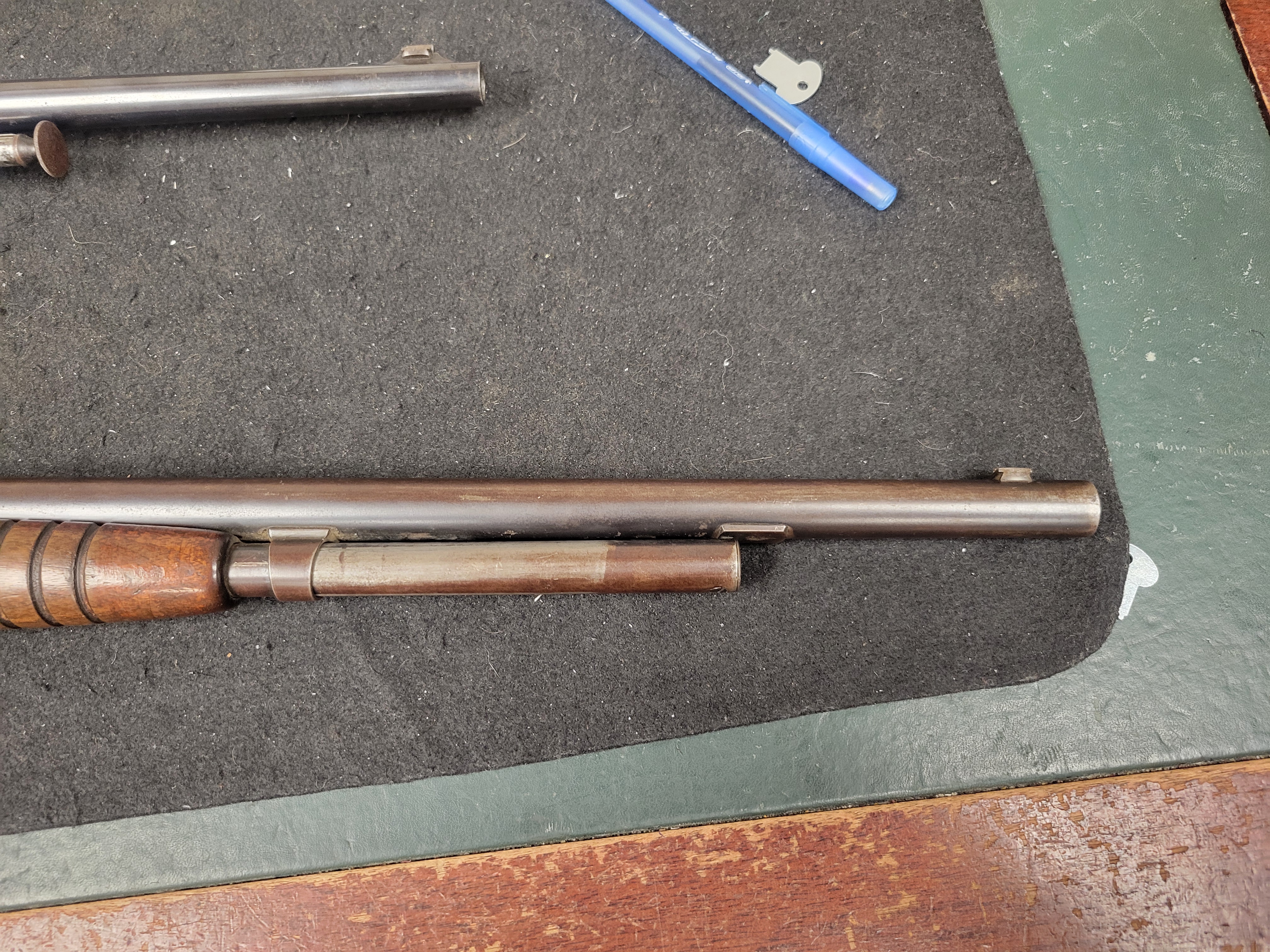

I added a two comparison pics below that show a short mag compared to a normal 11 shot mag. Notice the short mag has no second hanger. "The classic Remington Model 14" and 14 1/2, model 25, and 141 book by KEN BLAUCH is a wealth of knowledge on these rare little darlings....
Those 14 1/2's are hard to find, you might use this information as a bargaining tool and buy her to keep for a few hunnerd less.. just sayin'.... a modified 14 1/2 in 38 is better than no 14 1/2 at all there were so few made that in my opinion all of them are precious........
In my humble opinion that repair isn't a Bubba fix, it was just a Smith making an old gun useable again as parts for 14 1/2 dried up after being discontinued.

14-1/2 Half Magazine rifles are a rarity, many were converted to carbines at the factory because they didn't sell. Yours is NOT a factory half/mag rifle and from what all you describe it has indeed been butchered. Its little more than a "parts gun" but since parts for the 14-1/2 are extremely hard to find that might not be a bad thing, depends on how much you paid for it.
Maybe you can remove the filler in the slot where a magazine ring should be, re-install the magazine ring, and have a new rifle magazine tube from a Winchester Model 94 tube. To do the latter you need a "smith" that can thread the tube properly because the threading like most screws on the 14/14-1/2/141 are obsolete but dies can be found. I had a very talented "smith" in MN that made me magazine tubes & followers for 20+ years until he passed away.
Original replacement stocks & sights can be purchased on Gunbroker or Ebay but you have to be patient until they show up. In any event your rifle as it sits will require a lot of work.

Jim and Ray, Thank You both for your very detailed replies back to me on this. I was afraid that it was not original from the factory with the short magazine tube. It would have been great to have been all original, as it would have finished out my collection of Remington pump rifles. I will think about this for a few days, but my initial thought now is to return it. As it sounds like alot of time and work to get it completely back to factory condition. It's beyond me why somebody would go through all of the work to cut the stock off and put another buttplate on it, just to shorten it by 3/4" ?? And the magazine tube must have been damaged on the end. So to shorten it and keep the rifle in working condition, at the time, was a good choice. And the gunsmith that did it, appears to have done a good job, with what he had to work with.
Thank You both again. Your replies are appreciated. I will try to find a copy of Ken Blauch's book on this series of rifles also.

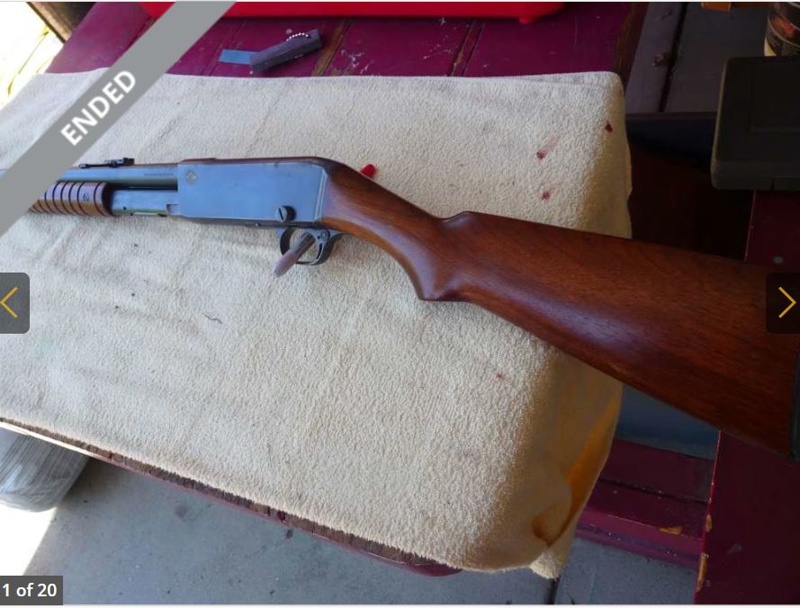

You didn't say what you gave for it but bass pro ain't known for real deals and a really nice one in 38-40 just went with no bids on gunbroker for the asking of $1850, after you figure time and trouble that may be a cheaper option, I feel it was priced high and apparently everyone that ever wanted one did too so maybe the seller will relist that little sweetie with a couple to 3 hunnerd off to get a buyer. Id like to have had it for mine to have more company on the gun rack but I felt that's a little $high$.... or was it....? I don't set the market...
Search 38/40 in the COMPLETED LISTINGS of PUMP RIFLES if you want to see more pics. Item 1183539460 has ended.
After $85 shipping and like maybe $180 sales tax you'd be out about $2115 before you tip your FFL dealer.... you be the judge.
