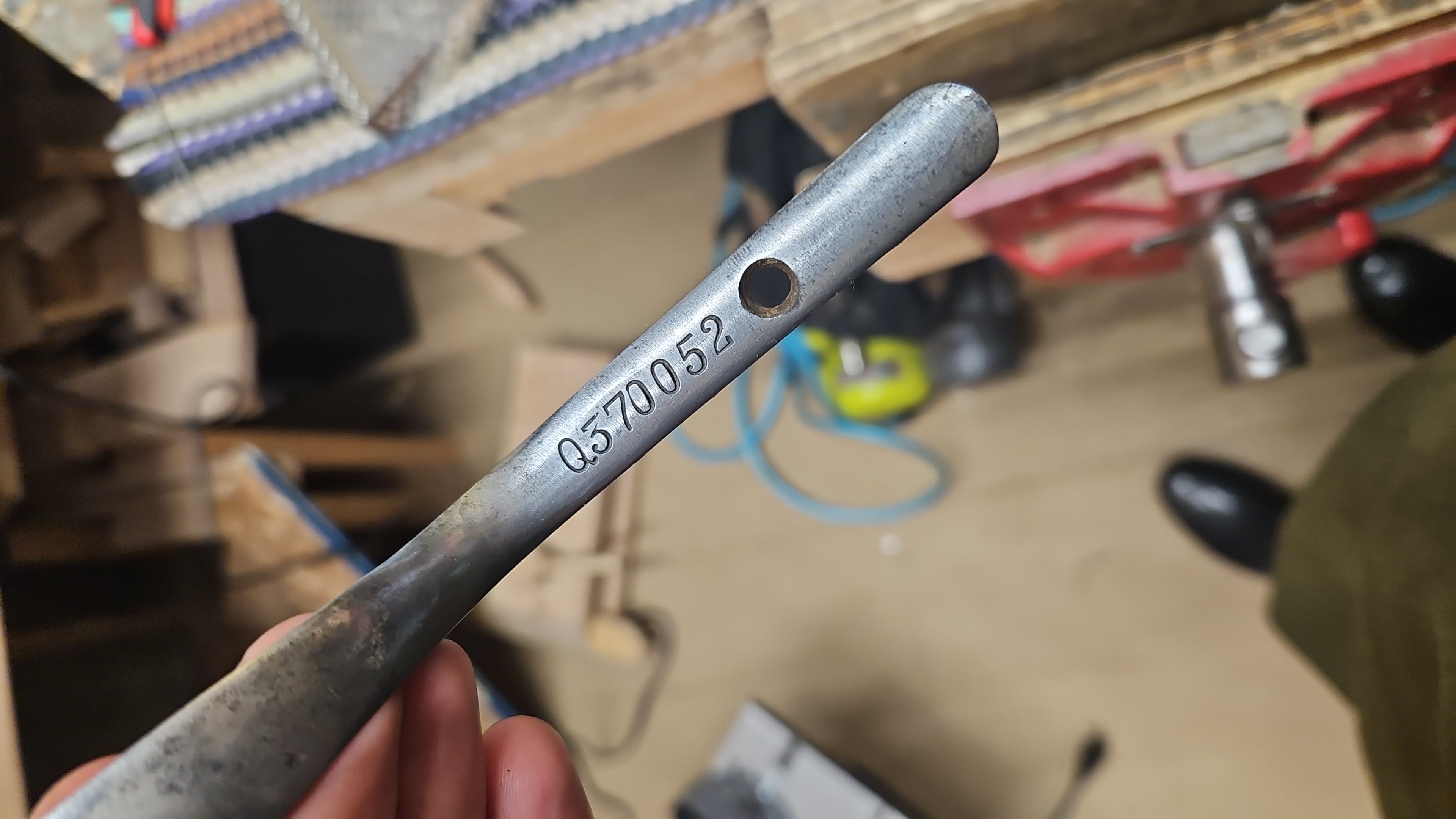

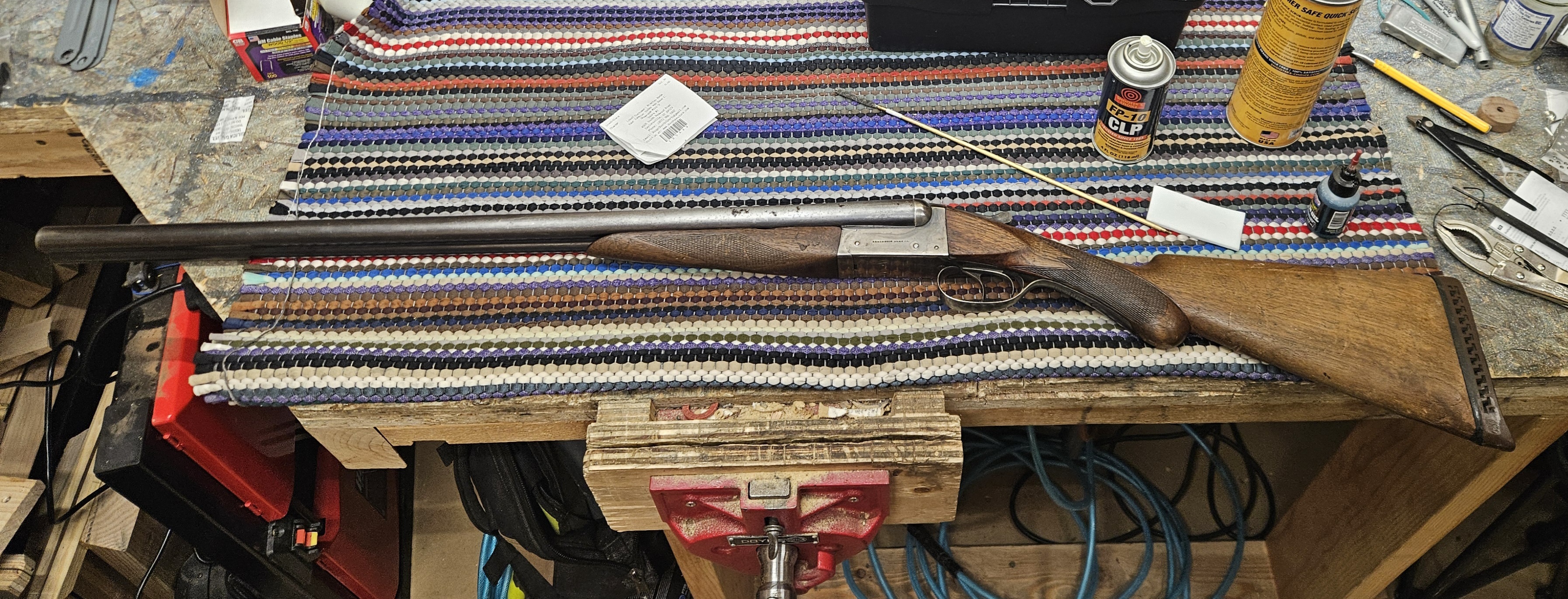

I've been looking for a while and am very excited to have picked up my first SxS.
I've got it stripped down for cleaning right now but in the mean time I've been pouring over the archives trying to figure out what I can about it.
I believe I've narrowed it down to being a KE grade Model 1900 that was built in 1907 (I erroneously knocked it as 1960s~ because of the Q prefix serial and going to the wrong serial lookup, very excited to see that it's a bit older)
One thing I haven't been able to decipher is part of the letter code on the barrels: LKEB
I assume the "KE" is the grade, steel barrels with split rod ejector, but I haven't found another example with "L" or "B" or anything on what they might infer.
Thank you so much for your time!

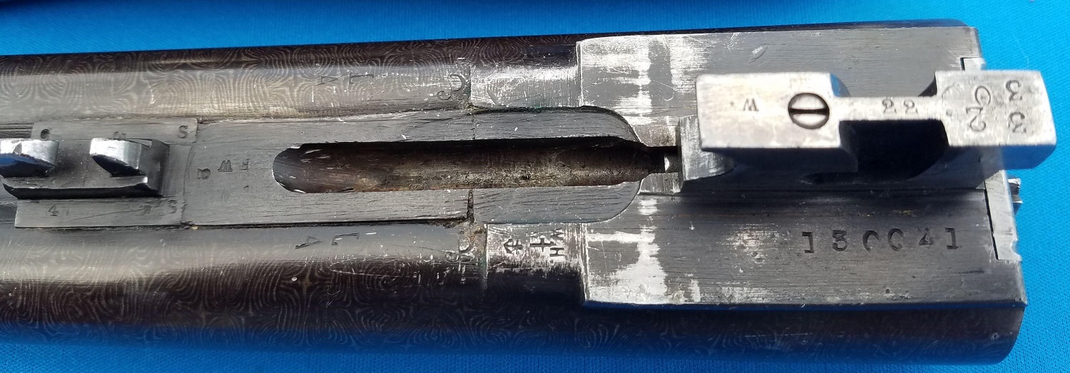

I have been looking at and recording those markings for some time and what I've come up with is --
L is light frame 12-gauge -- /// is standard frame 12-gauge -- X is 16-gauge
KE is the grade of the gun
B is a date/batch or some other code I haven't thought of yet.
The Q on the trigger guard tang is a Remington inventory code they began using with the switch to the later style frame with the relocated sear pin and the separate firing pins between 348604 and 353470. P was the inventory code for the Model 1894s.

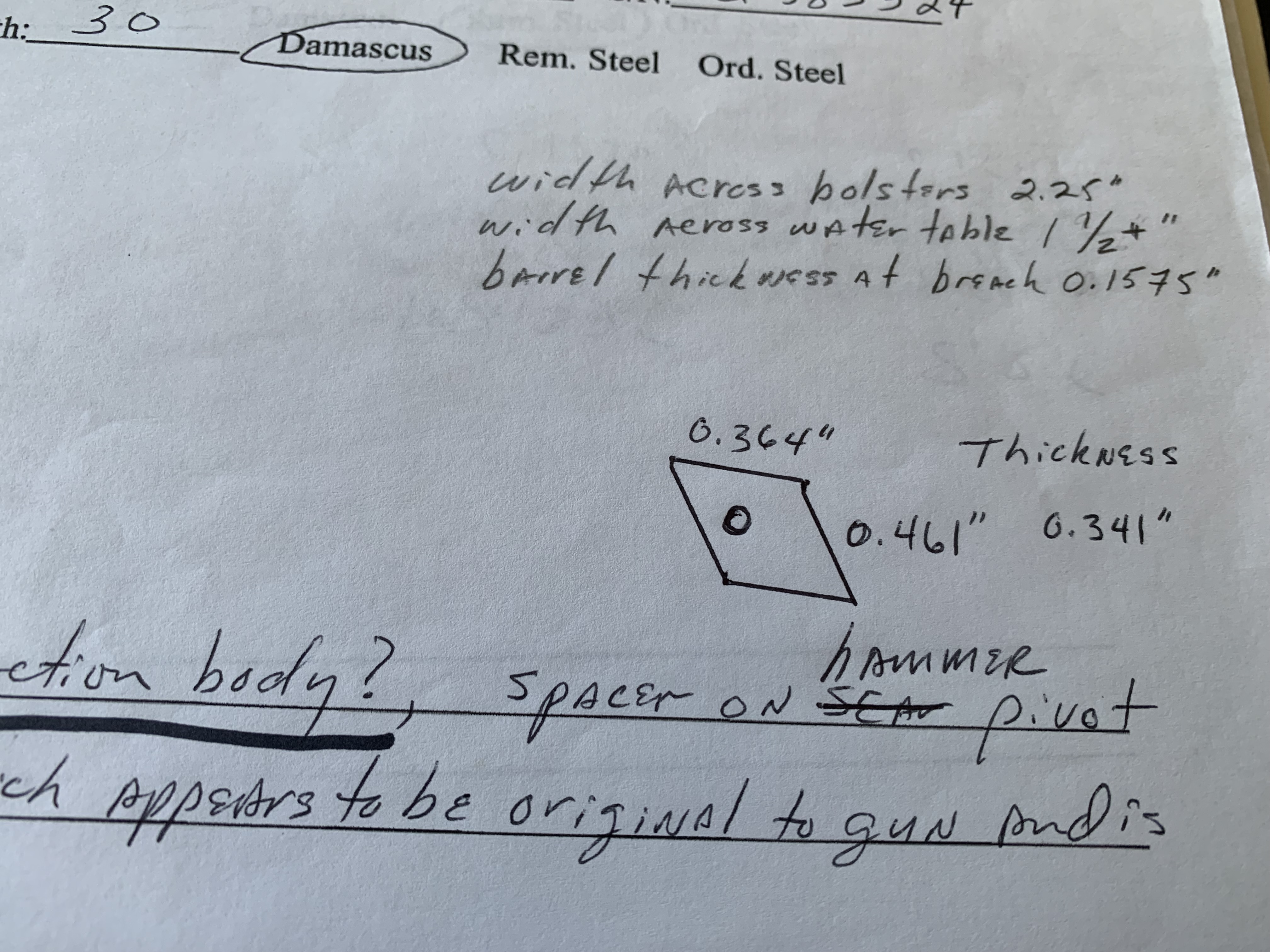

Also my KED has an extra part. The attached drawing gives dimensions. It sits on the hammer pivot pin. Have no idea what its purpose might be. It is well made and appears to be original to the gun.

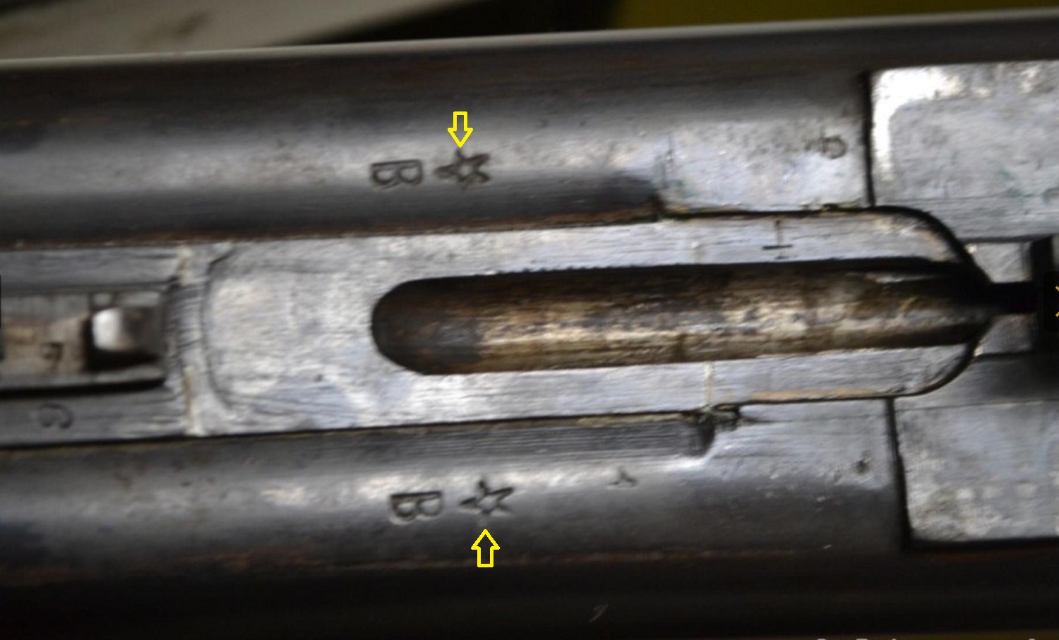

I have not recorded a star on a Model 1900, but I've recorded five on Model 1894s all on guns with the early style frames, serial numbers from the 114xxx to 131xxx range.
This DE-Grade has the star at the end of the string of letters --
In addition to the normally seen ///, L & X on the Model 1900s I've also recorded two with a $.
