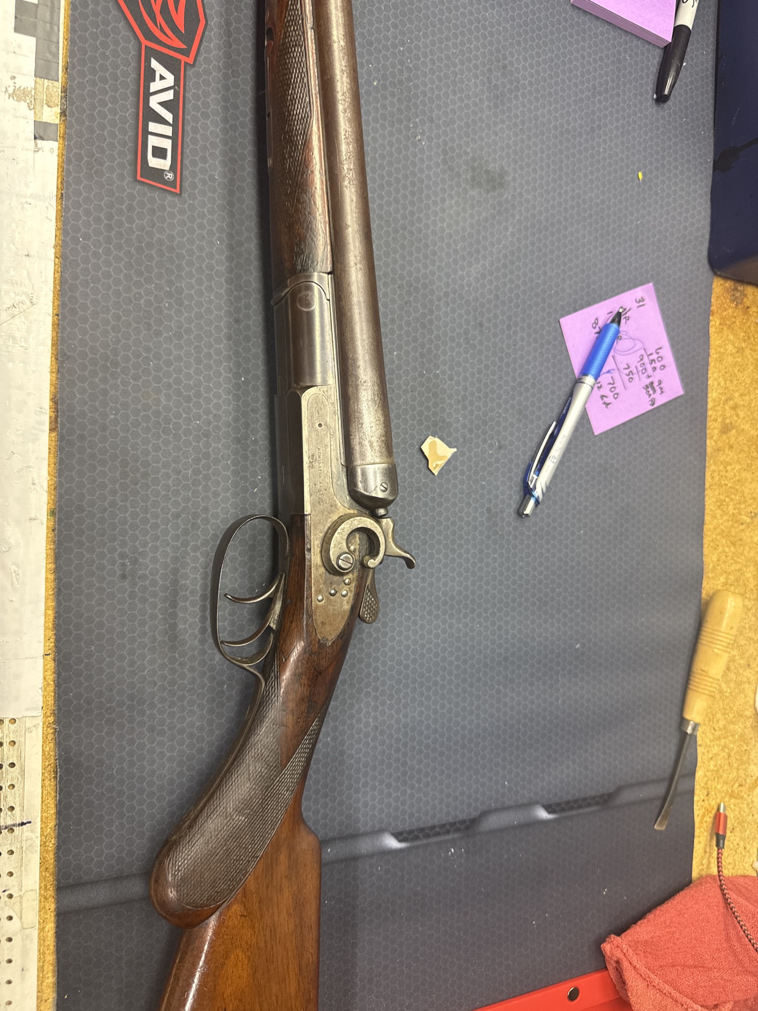

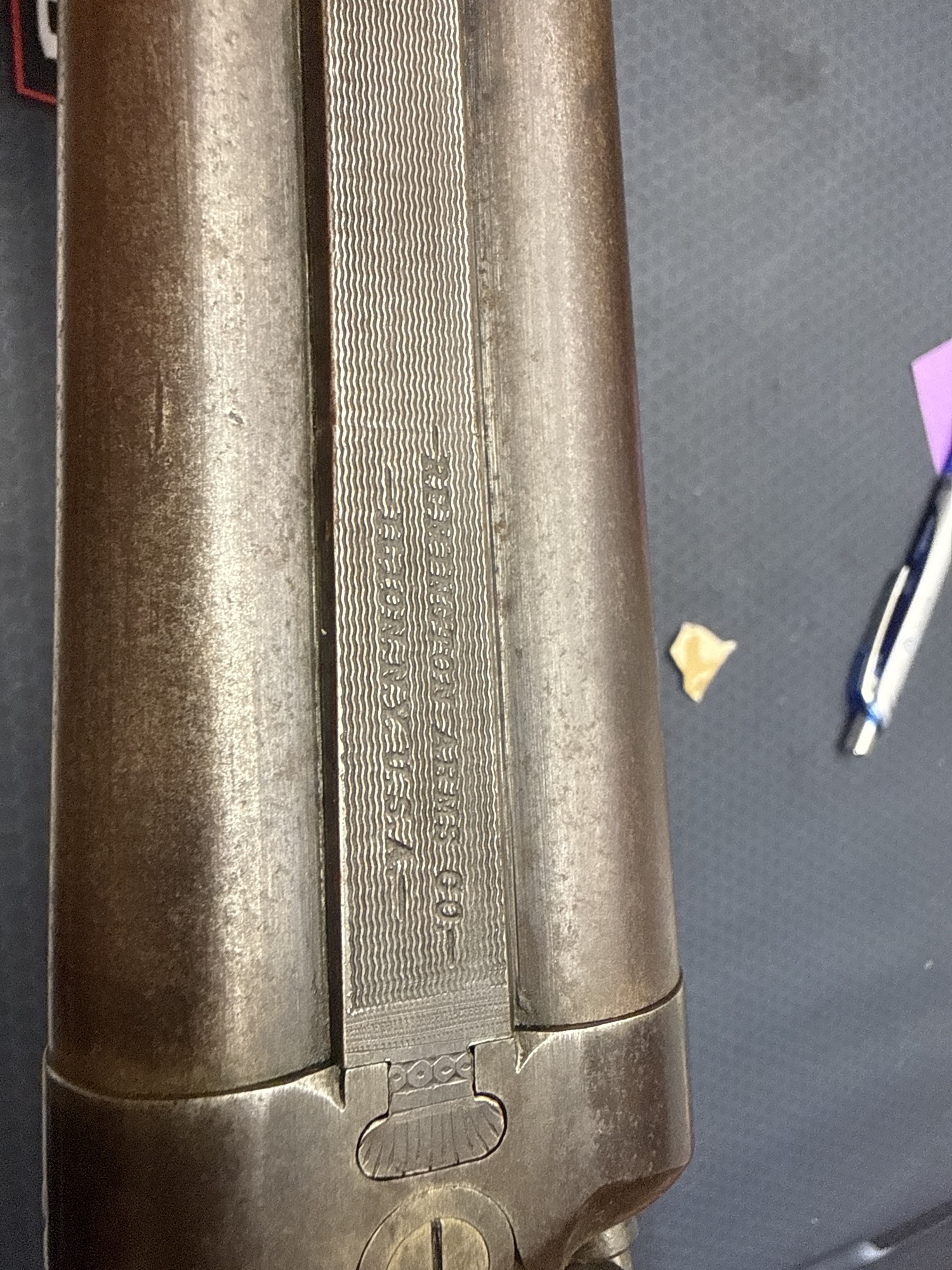

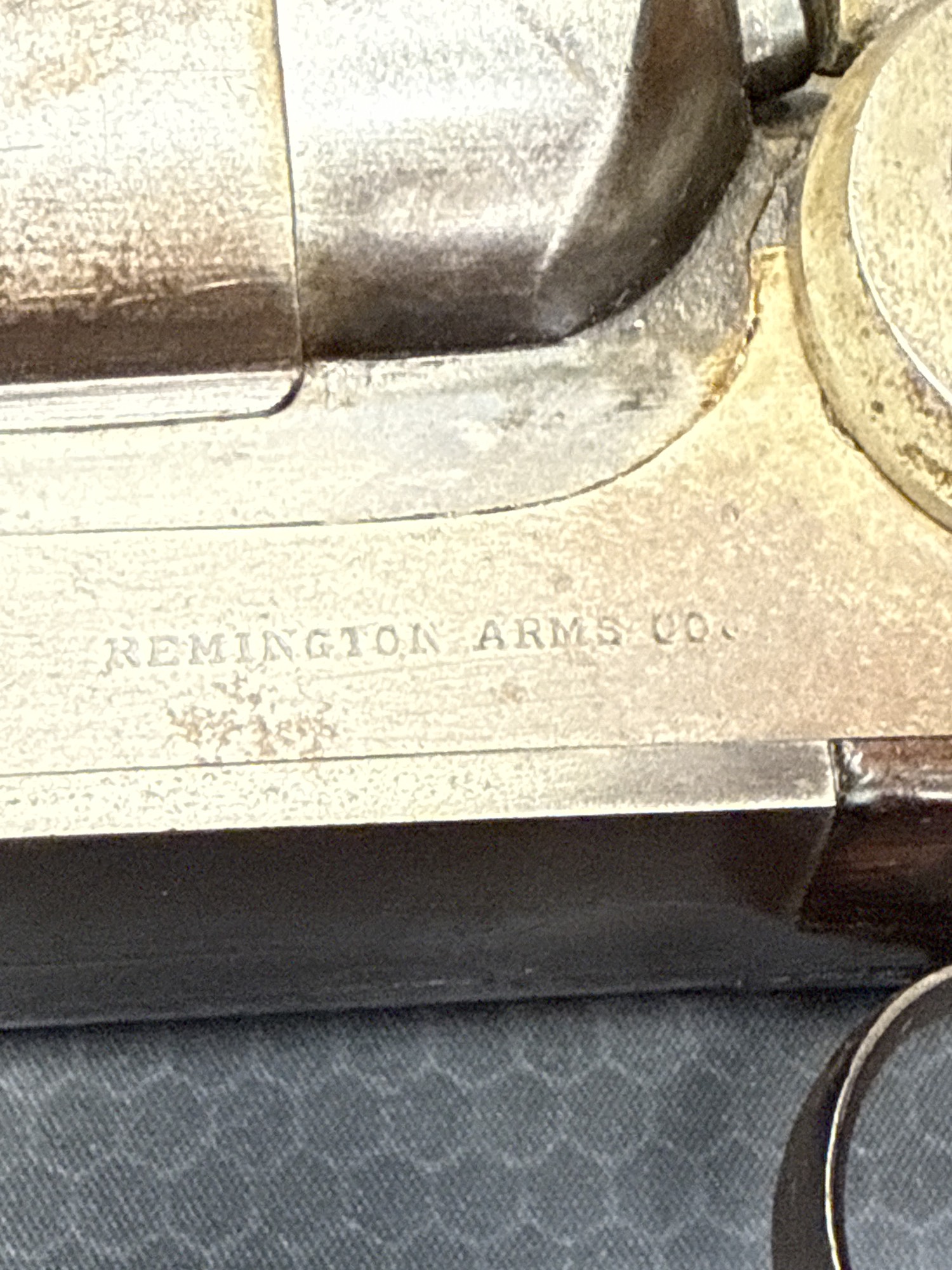

Post by NavionPilot »
Helping a friend’s widow clean out the house and gun safe.
What I have appears to be 1889 s/n 208464 makes it born in 1901. What is the 195 stamp?
How do I get a factory letter and how does grading work?

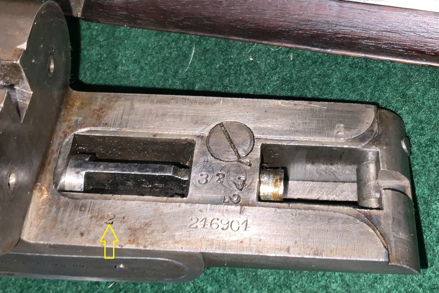

The Grade Number is stamped on the watertable to the left of the serial number --
92824 01 12-gauge, 28-inch, No. 1, grade number annotated.jpg (316.45 KiB) Viewed 1701 times
246904 01a No. 2 annotated.jpg (581.25 KiB) Viewed 1701 times
221026 03a No. 3 annotated.jpg (169.63 KiB) Viewed 1701 times
As for most of the numbers other than the serial number and the grade number, no one left alive knows what they mean.
