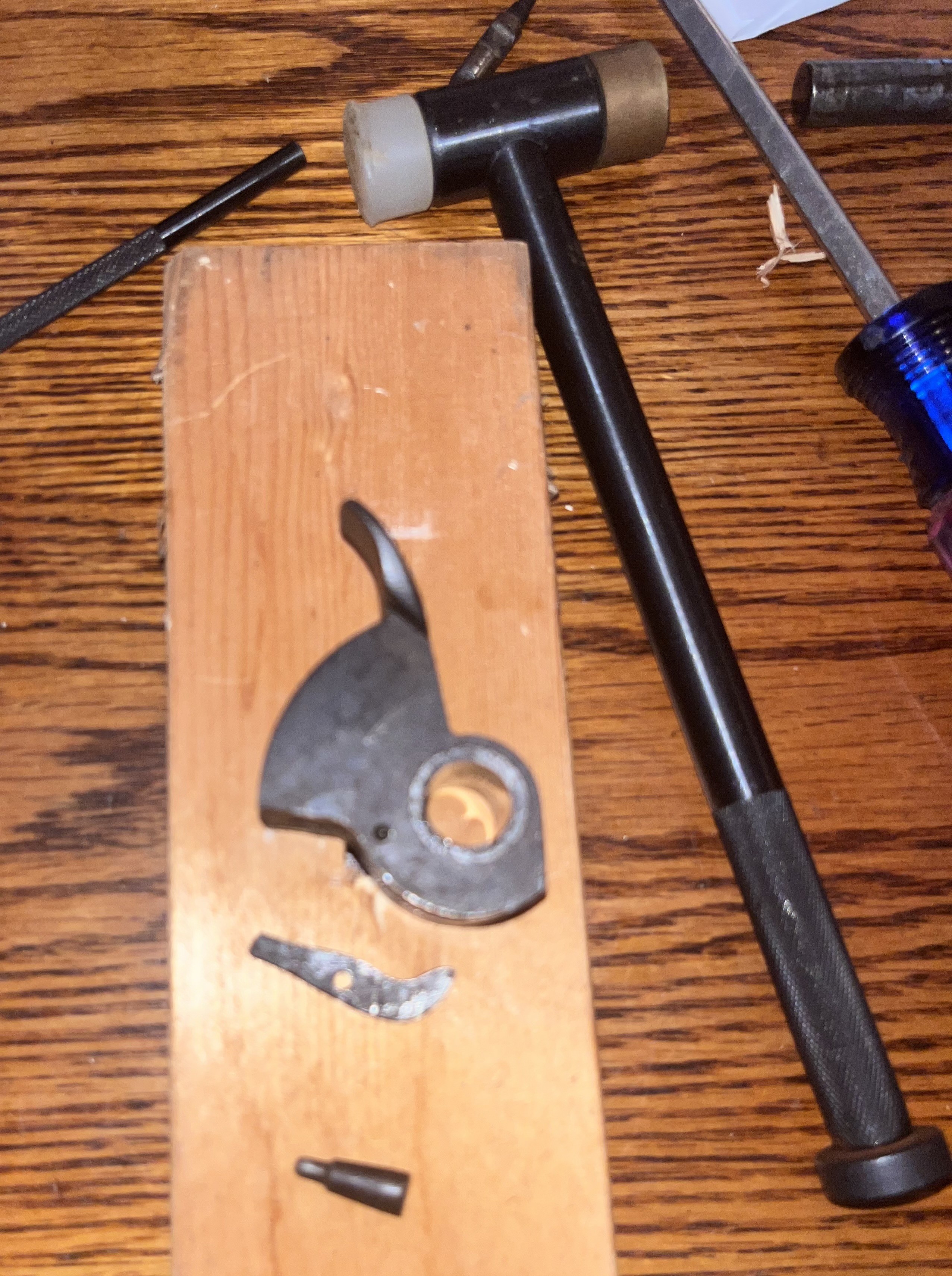

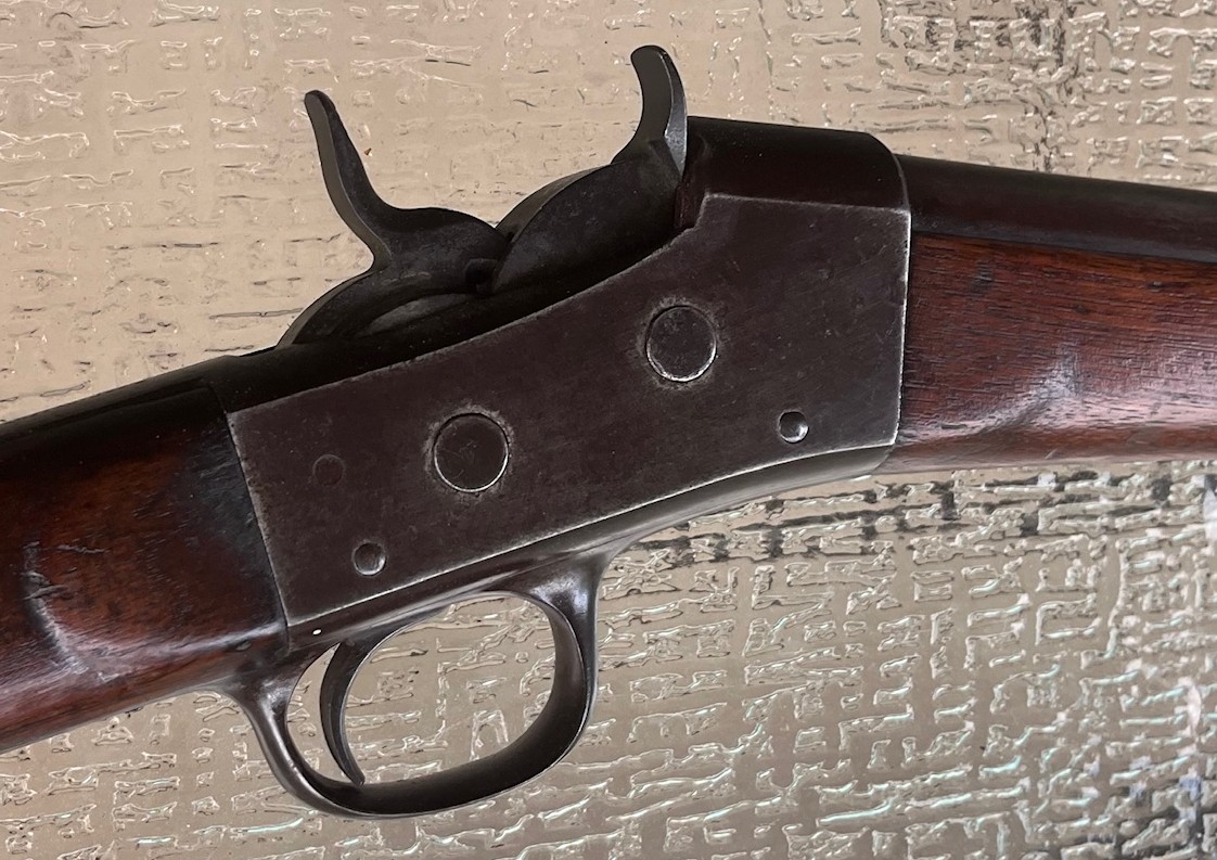

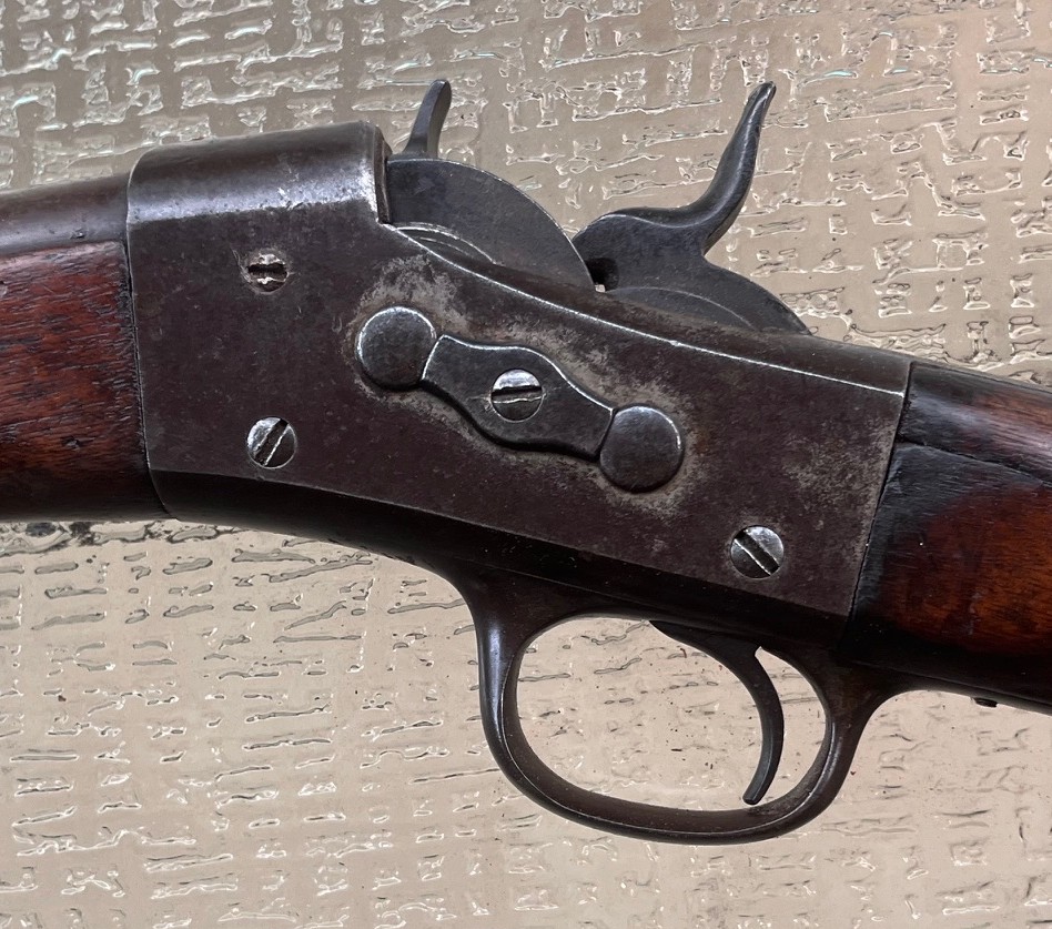

Folks, I was given this shotgun and I want to learn more about it so I can maybe make some cartridges and shoot it.
Looks to be a number 5 with a Firing Pin Retractor,
Firing pin is quite short and doesn't look like the hammer would touch it.
Research shows that it is a 16 ga paper cartridge of 20 ga brass.
Upper and lower tang reads 1214.
Some questions:
Best reference to operate a rolling block shotgun?
Date of manufacture?
Do I have the correct firing pin?
Is my assumption of a model 5 correct?
Any and all operations guidance would be appreciated.
