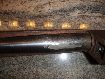

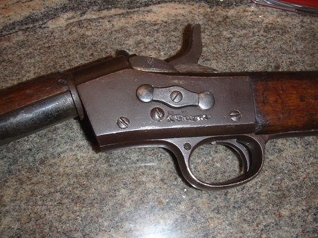

I also have one of these rifles and would like to find out a little more about them. What does a guy have to do to get a copy of the report?
smaller (3).JPG (98.78 KiB) Viewed 23834 times
smaller (1).JPG (63.65 KiB) Viewed 23834 times
smaller (2).JPG (89.04 KiB) Viewed 23834 times

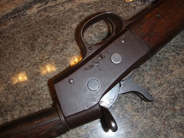

One more photo showing the welded over identification symbols.
smaller (4).JPG (65.88 KiB) Viewed 23831 times

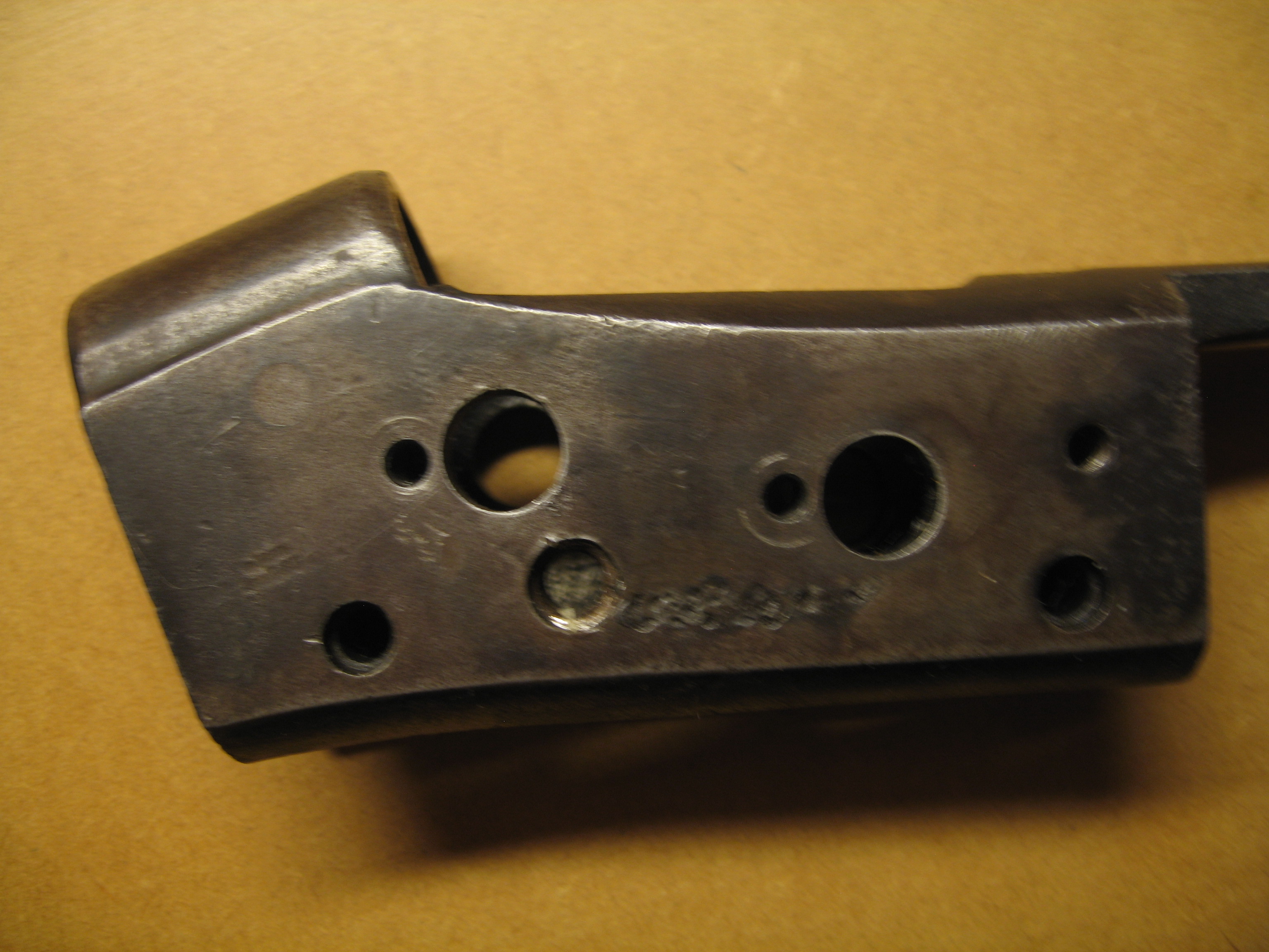

I know this is an old topic, but on an off chance THBailey do you have pictures of the extractor from the RB you have?
I have a Swede 89 model with identical marks. It has barrel hammer and breach block but the extractor is gone and I need images to be able to make a replacement one.
That is unless the breach has been modified from the standard 89 Swede breach.
Also trying to find out what the fore grip looked like.

Womack's list the rotary extractor for the 1889 model....
