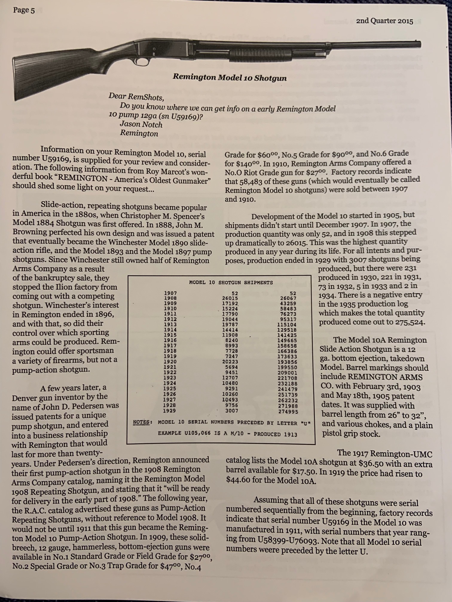

As for production dating serial numbers this chart was published in the RSA Journal where and by whom it was developed I do not know or recall.
Good Luck with it they were very popular in the early 1900's!

Your is more than likely a 10A grade then and the D is an inspection stamp.
