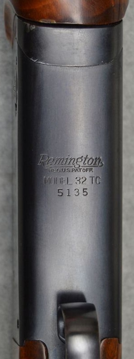

A righteous Model 32 TC would be marked as such on the bottom of the frame --
5135 01 Model 32TC.jpeg (94.37 KiB) Viewed 9815 times
The barrels on the gun could be a set added at a later time?!?
