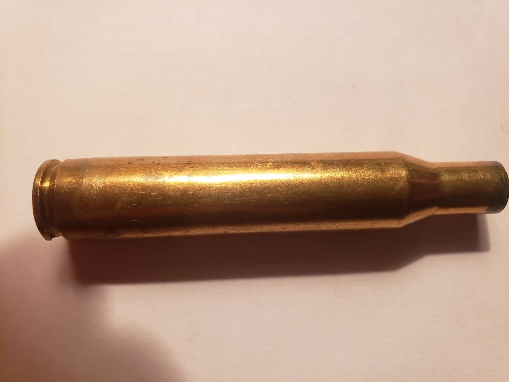

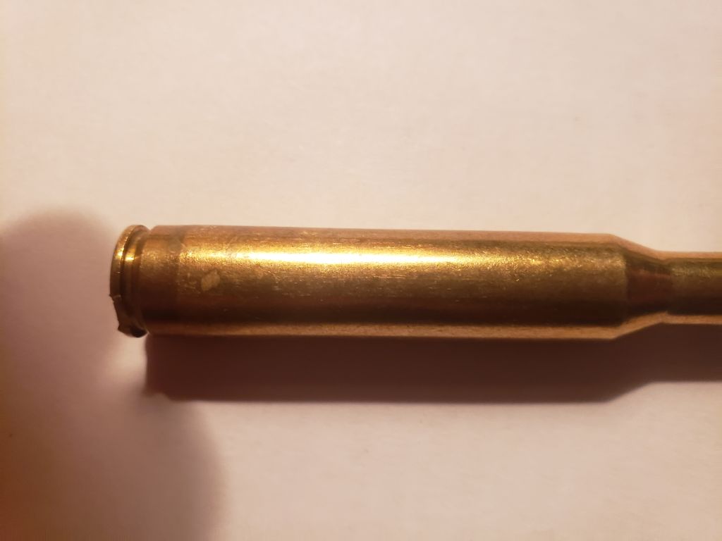

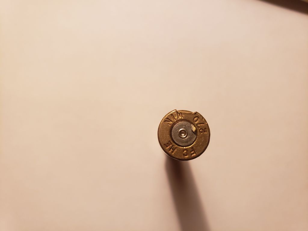

As promised here are a few photos of a spent cartridge from about 3 weeks ago. It has been sitting on the window sill of my deer stand and has discolored a bit but it is typical of what things look like. I should add that I don't feel any bumps on the casing.
Jack

The last pic showing the primer seems to indicate high pressure, are these reloads? High pressure can cause the problem you are having, try a different make or type of factory ammo. If you are shooting reloads then check the data, if the data is fine the loads may still be too hot.
The body of the case looks much better than I expected. Usually a bit of rust in the chamber will be the bumps, the case will be the reverse and shows divots where the pits are. I'm not sure I see anything that indicates a chamber problem.

These are Federal Premium Vital Shock High Energy 140 grain Trophy Bonded Bear Claw. They are a hotter load than some with a muzzle velocity of 3100 fps. Looking at the primer of a live cartridge and a spent cartridge I do see that the primer has tried to come unseated after firing. Also the first 1/4 inch of the casing closest to the primer is deformed compared to the rest of the cartridge. You can see the difference in the color of the cartridge in the above photos. Both of those observations seam to back up your theory.

The two different colors on the case, after firing, is normal. Forward of the line is the chamber and rearward of the line is the part of the case that sticks out of the rear of barrel.
The primer shows high pressure two different ways. The "flattened" primer can be common but is an indication of high pressure. The ring around the firing pin indication is where high pressure pushed the firing pin rearward then started pushing the primer into the bolt face, this is not good.
I think that this rifle with this ammo is incompatible.
