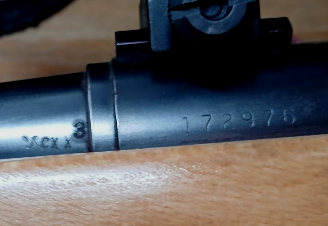

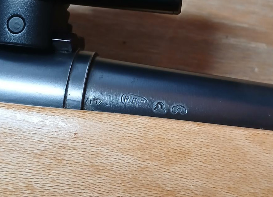

To all,
I have looked at the following page https://www.remingtonsociety.org/manufacture-dates/ and am having no luck pinning this rifle down. Would you all be so kind as to decipher the markings?
Left Side Marks 1.jpg (325.34 KiB) Viewed 5883 times
Right Side Proof Marks 1.jpg (395.25 KiB) Viewed 5883 times

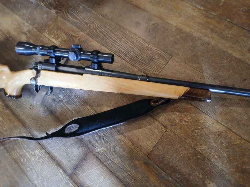

Rifle Profile 1 copy.jpg (456.45 KiB) Viewed 5883 times
Wife's father's rifle.

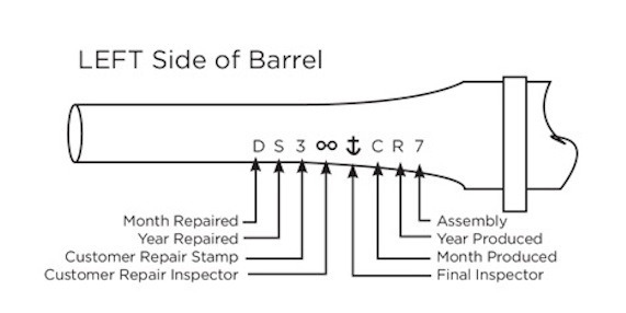

In as much as this legend infers:
Remington Left Side Barrel Legend.jpg (71.88 KiB) Viewed 5874 times
This rifle is marked <strange symbol> <C - Month?> <X - Again, month?> <X - Year?> <3 - Assembly?>
Or am I looking at XX – 1951? Does this seem reasonable given such a high serial number of 172975 ?

Re: Remington 721 Identification Challenge
Post by 600RemGuy »
April 1951 lines up with both the barrel date code and the serial number.

Thank you for responding. Do you have any insight as to what the fancy wave 'final inspector' cartouche is exactly? Does this refer to a specific individual?
Post by 600RemGuy »
Yes, that would be the inspectors "mark", unique to them.
