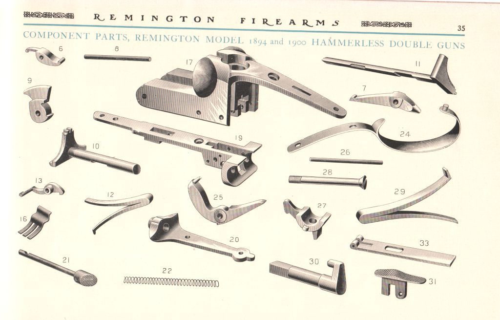

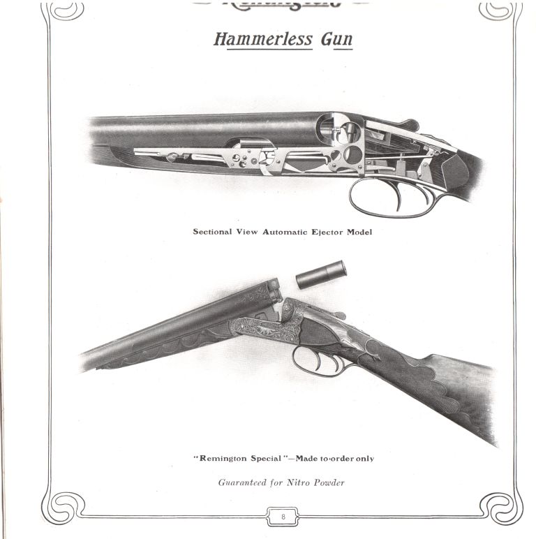

Re: Remington 1900 firing pins
The cut-away drawing and the parts diagrams in the Remington Arms Co. catalogues don't begin showing the new style hammers with separate firing pins until 1908 --
1908 Catalog pg 8, cut-away.jpg (56.4 KiB) Viewed 11602 times
1908 Catalog pg 48, Parts Diagram.jpg (98.13 KiB) Viewed 11602 times
The earlier catalogues showed this, from 1901 catalog --
1901 catalogue cut-away.jpg (111.93 KiB) Viewed 11602 times
1901 catalogue parts diagram.jpg (85.59 KiB) Viewed 11602 times
Generally speaking, the guns I've recorded into the 131xxx serial number range are the early style action, while a gun in the 132xxx range (1905) has the new style. In K-grades the change is between 348xxx (1904) and 356xxx (1906) and I've recorded a couple of guns in the 355xxx range that have the sear pin in the new-style location and you can see the early location hole has been plugged.
