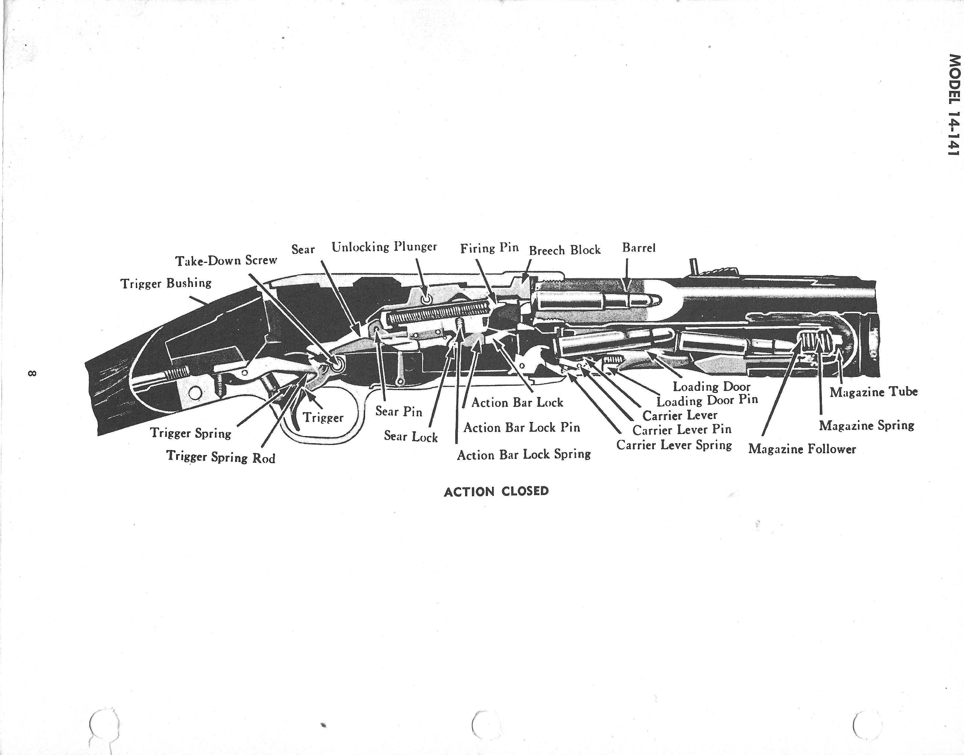

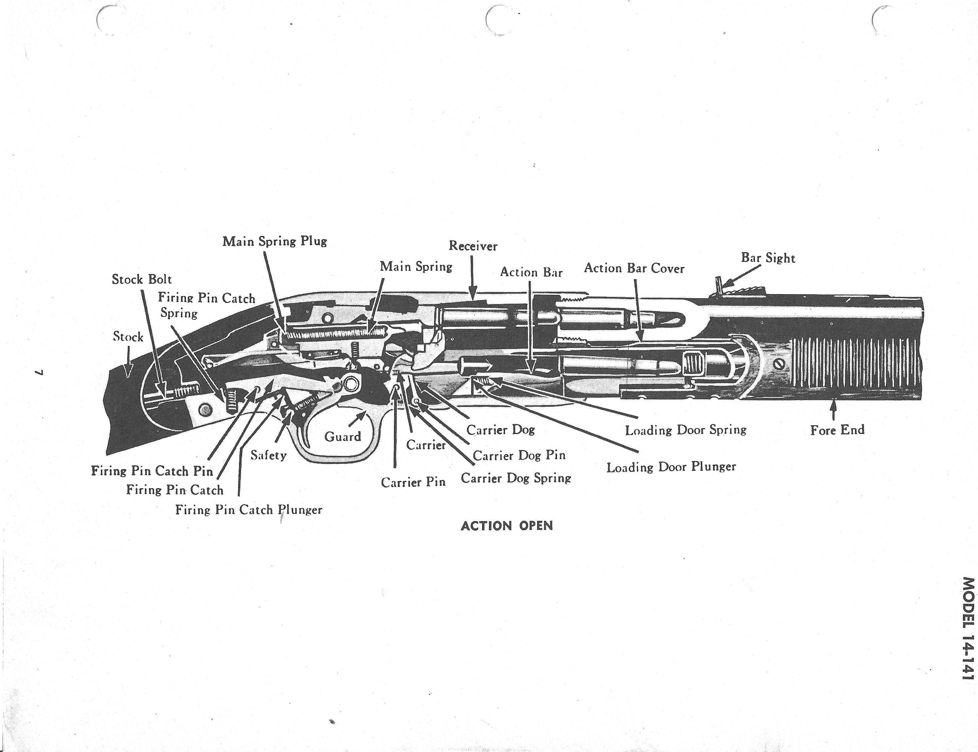

While I'm not Jim, I believe the part you are referring to is the "Firing Pin Catch". Please see the pictures attached. The Remington Service Manual can be found here --> https://whitebeachone.wordpress.com/wp- ... l_1973.pdf
- Rem_Model_41-141_1973B.jpg (625.21 KiB) Viewed 1707 times
- Rem_Model_41-141_1973A.jpg (555.97 KiB) Viewed 1707 times
Re: Model 14/141 Slam Fire
The "Sear" is called a "Sear" and is Part #122, nice the other chap downloaded a repair manual, should have been done a long time ago.
