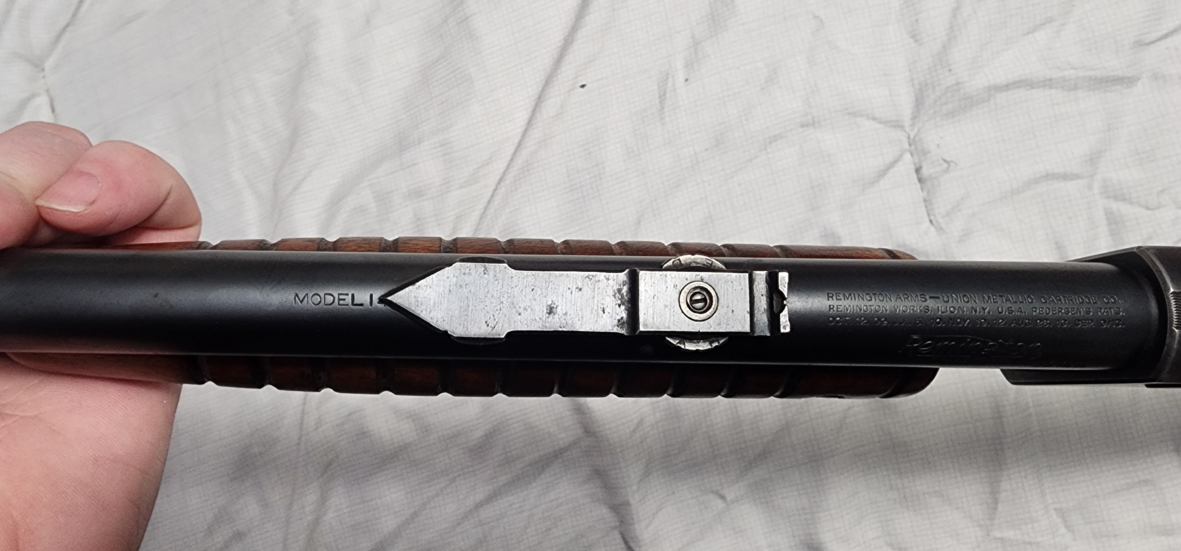

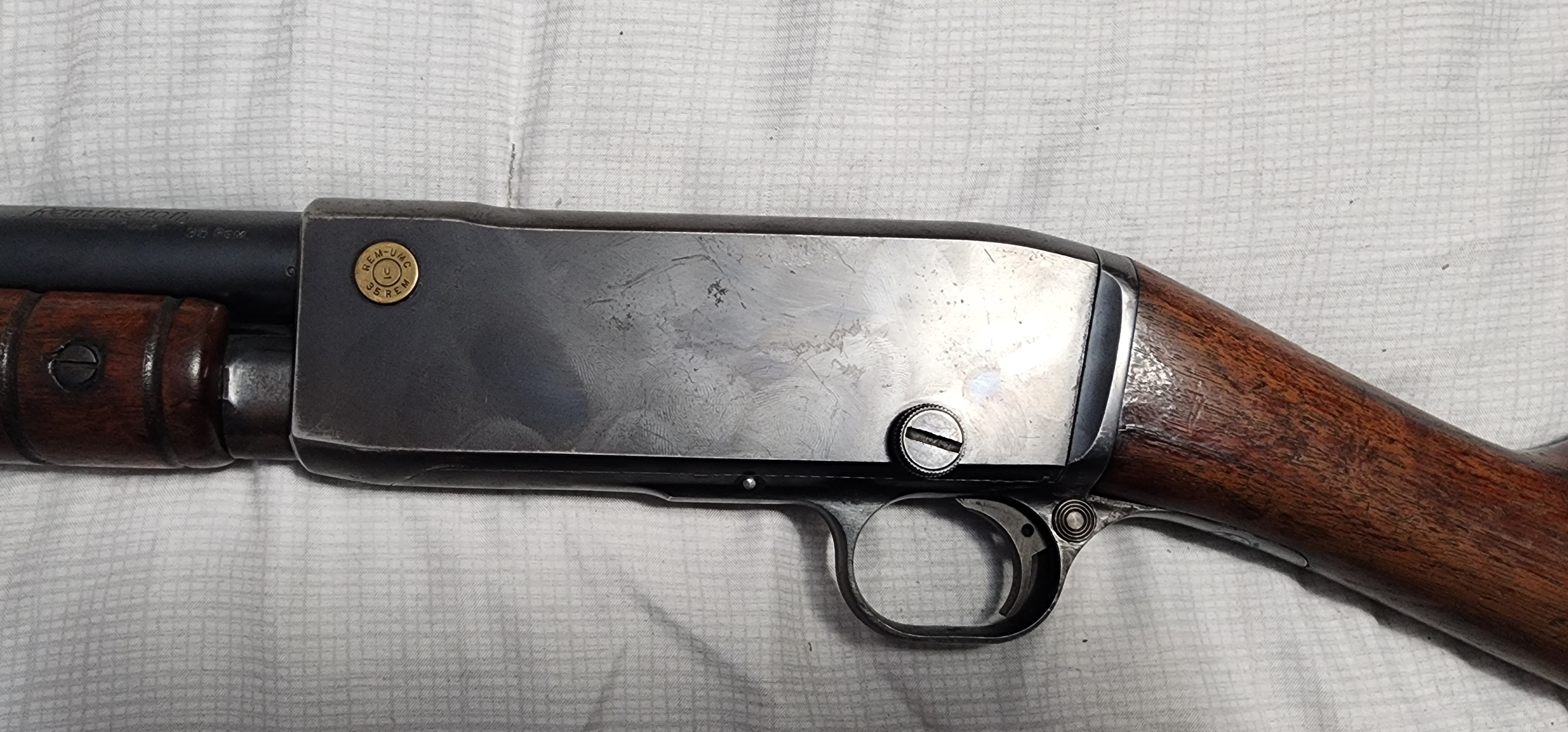

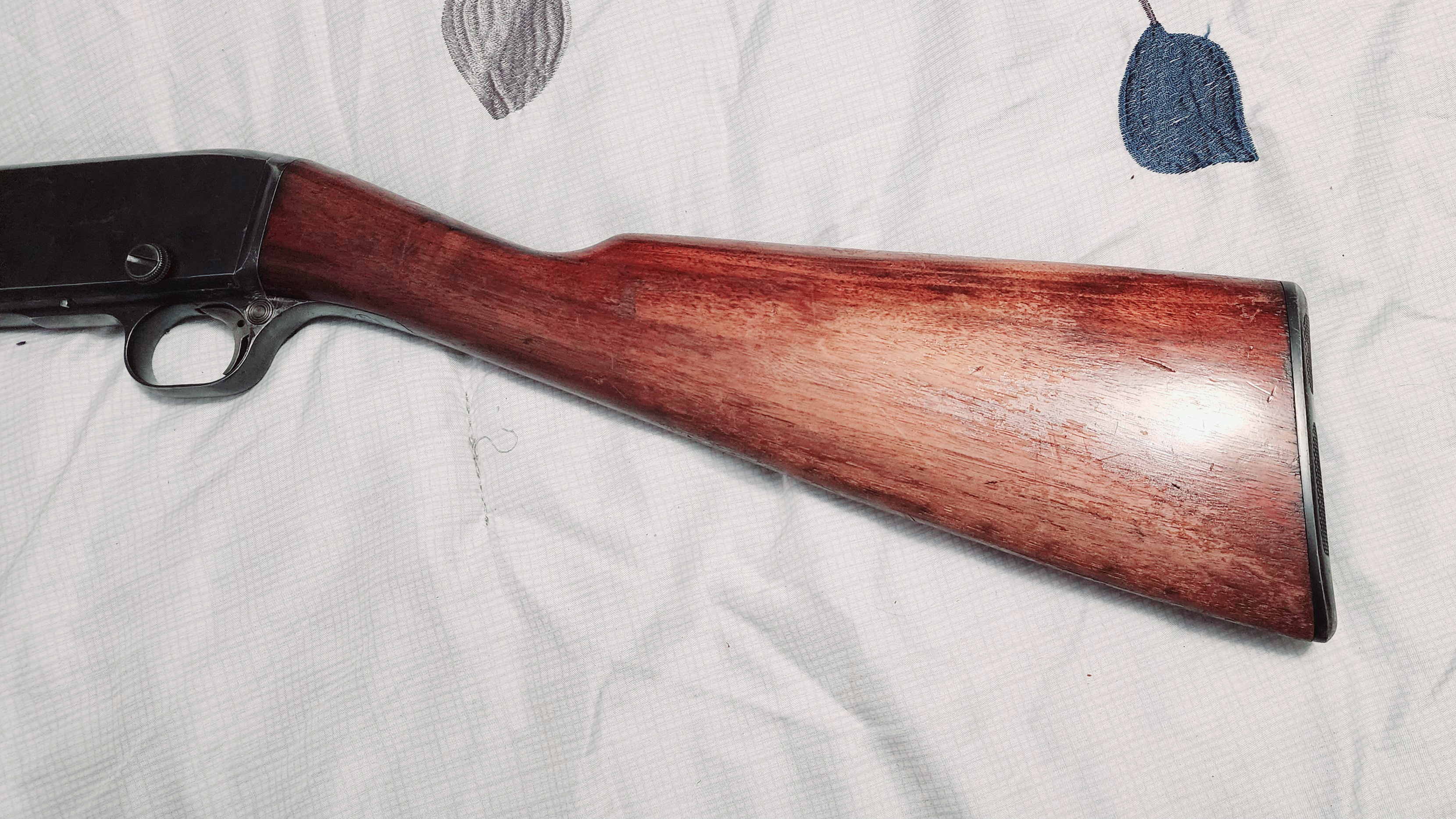

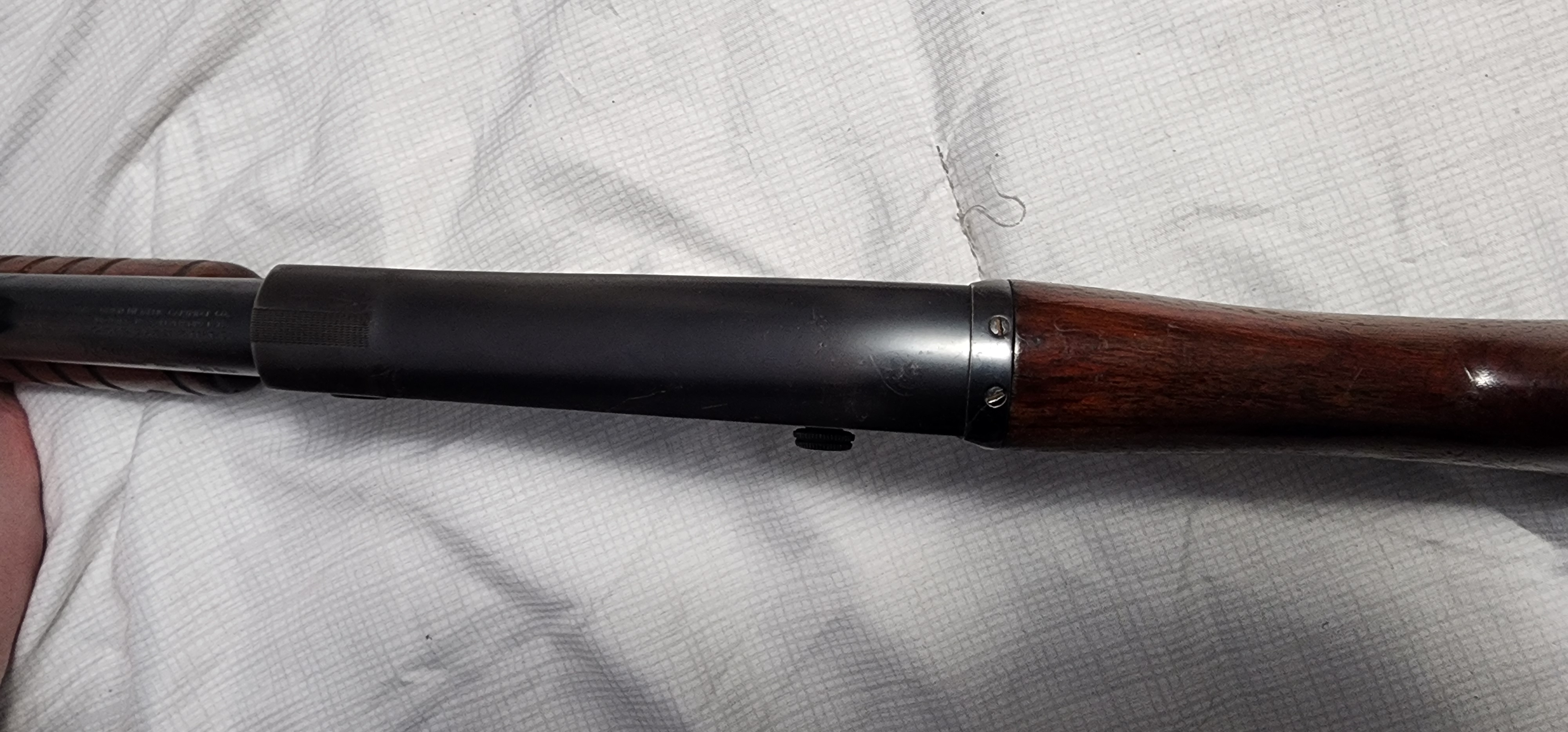

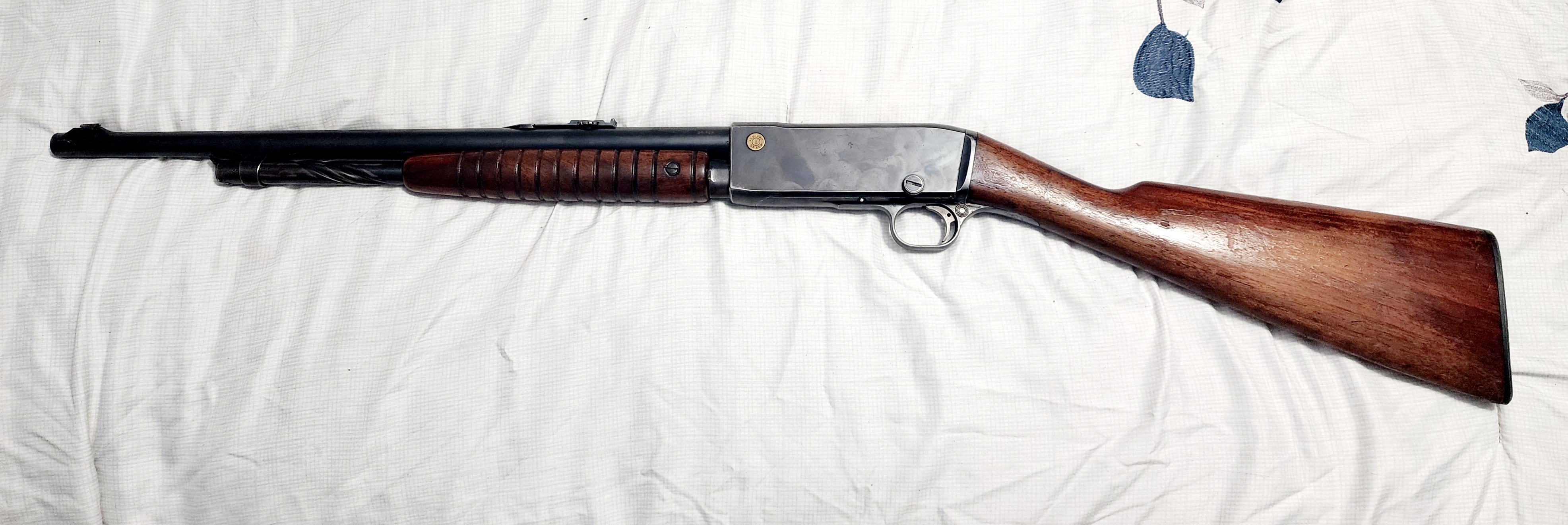

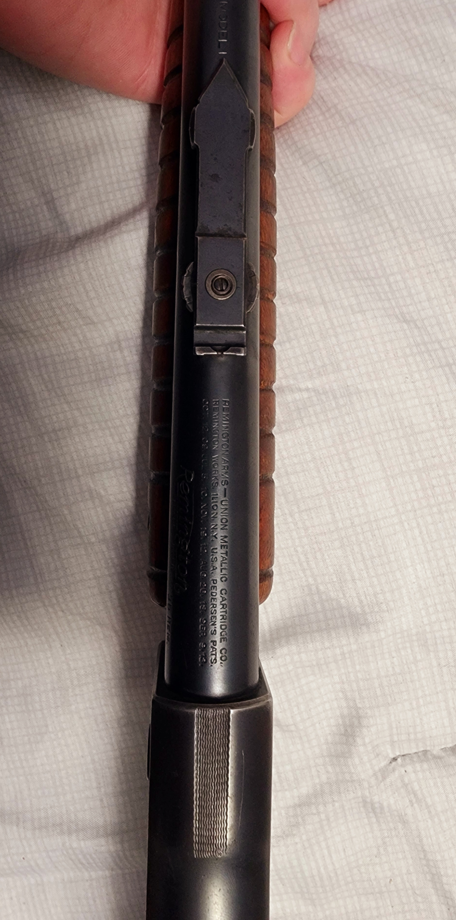

I recently picked up what I believe to be a Model 14 35 Remington carbine. I have always been a fan of the 35 and have had a few other Remingtons chambered for it, but never a 14. It is in nice condition and should make a good shooter, but the trigger is not working at the moment. It feels like the safety I'd engaged in either position. Before I dig deeper I thought it best to get some information. Also, if anyone knows a good gunsmith in PA that could work on these I would just as soon take it in for the work.

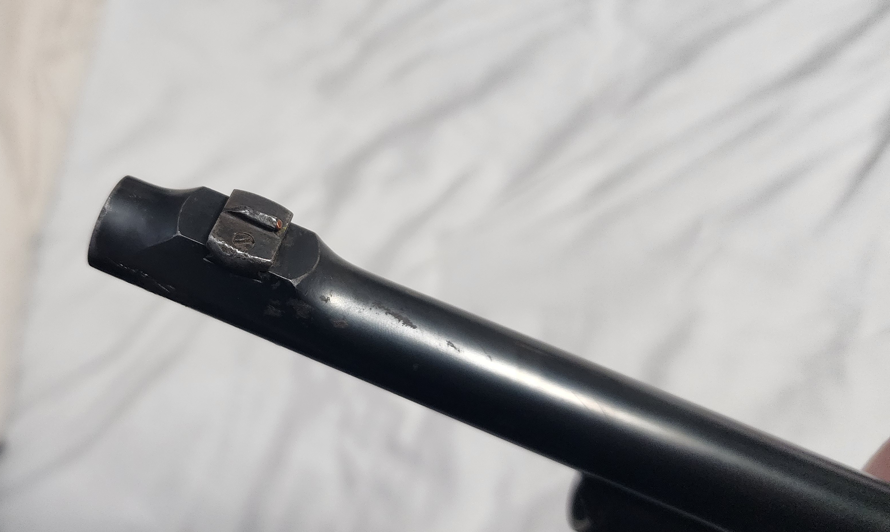

Also, the rear sight is extremely fine and should be great on paper, but I would prefer a peep sight. Which model would be correct for this vintage 14 that would not require any drilling/ tapping or other alteration? Any information you could provide would be appreciated.
Here are a couple photos of the gun.

Re: Questions About Model 14 Carbine
14 Carbines in that condition are difficult to find, nice rifle!
Lyman R14 tang sight fits in the holes provided by the factory at the back/top of the receiver, so will a Marble R8 but it has a small screw that goes into the stock. Either sight would require replacement of the front sight. The Wheel sight looks spiffy but has an awful sight picture. It was designed by John Pedersen to fit into the extra slot on the barrel, that slot was needed for the milling process. Drilling the receiver for a "receiver sight" would scuttle the value of your nice Model 14R.
Your trigger situation I have seen hundreds of times, dried oil blended with a little muck gathering in an area where there is no escape. It usually requires the trigger/cross bolt safety to be removed, cleaned/polished while flushing & cleaning the guard assembly. The exciting part is putting the trigger assembly back together while launching the trigger spring cap off into space. Its a bit tedious but after you do it 15-20 times not so bad.
PA has a lot of these guns so maybe you can get lucky with a gunsmith but he won't have parts in case that "trigger spring cap" eludes him. Most gunsmiths today have never seen one of these rifles. In parting let me give you a warning, don't try to use Leverevolution ammunition in this rifle. Use RNSP ammunition only!!
