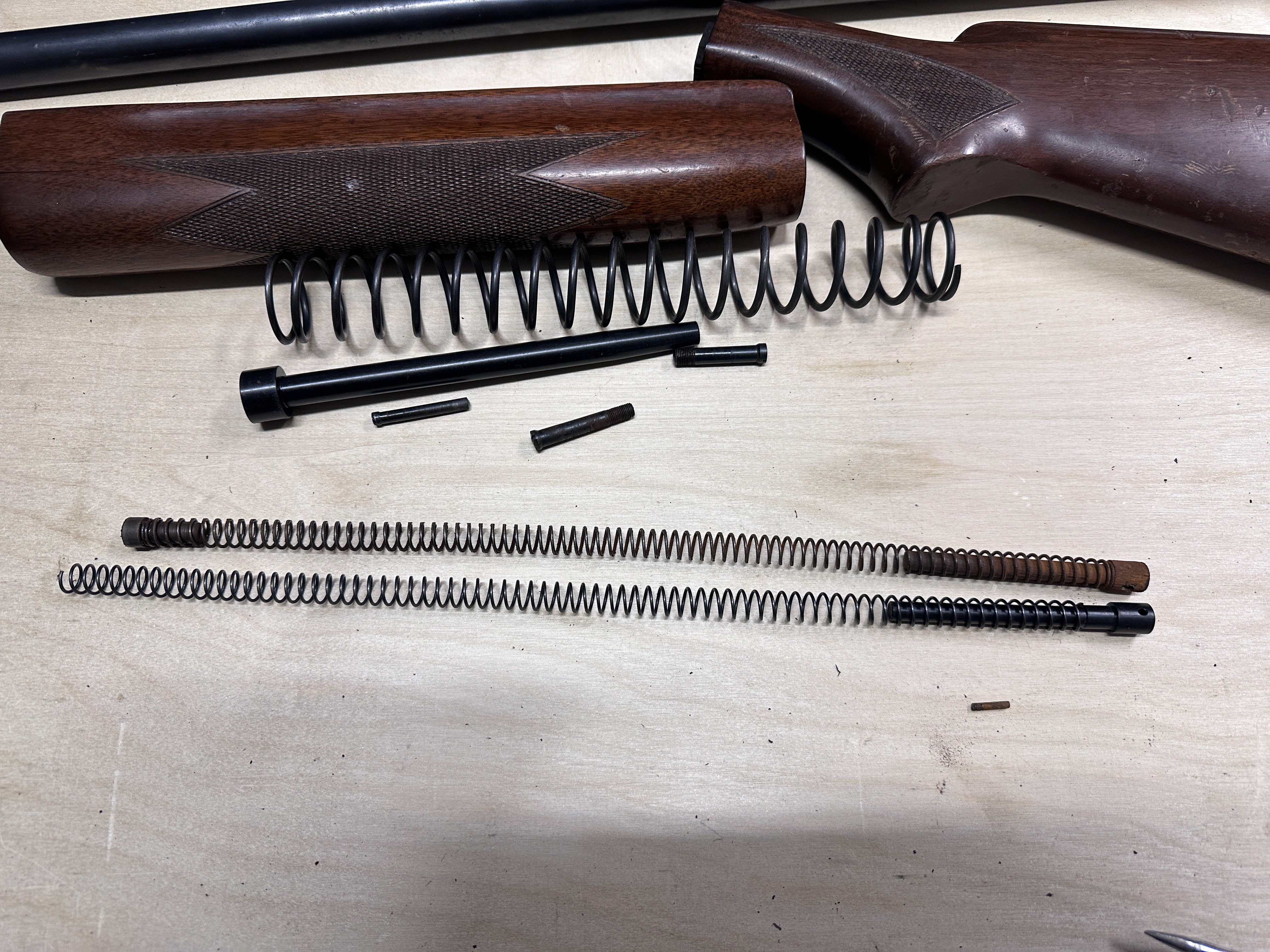

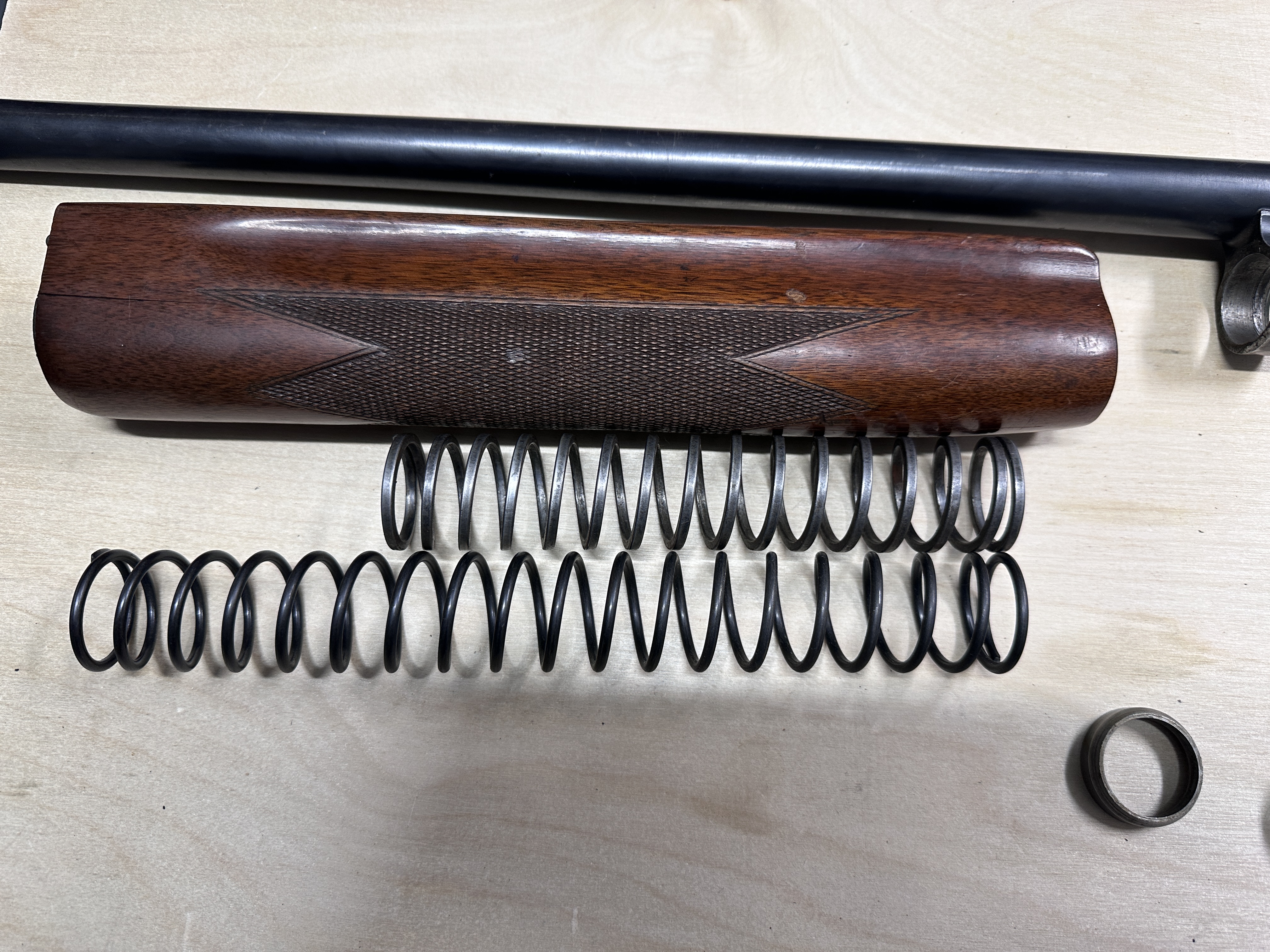

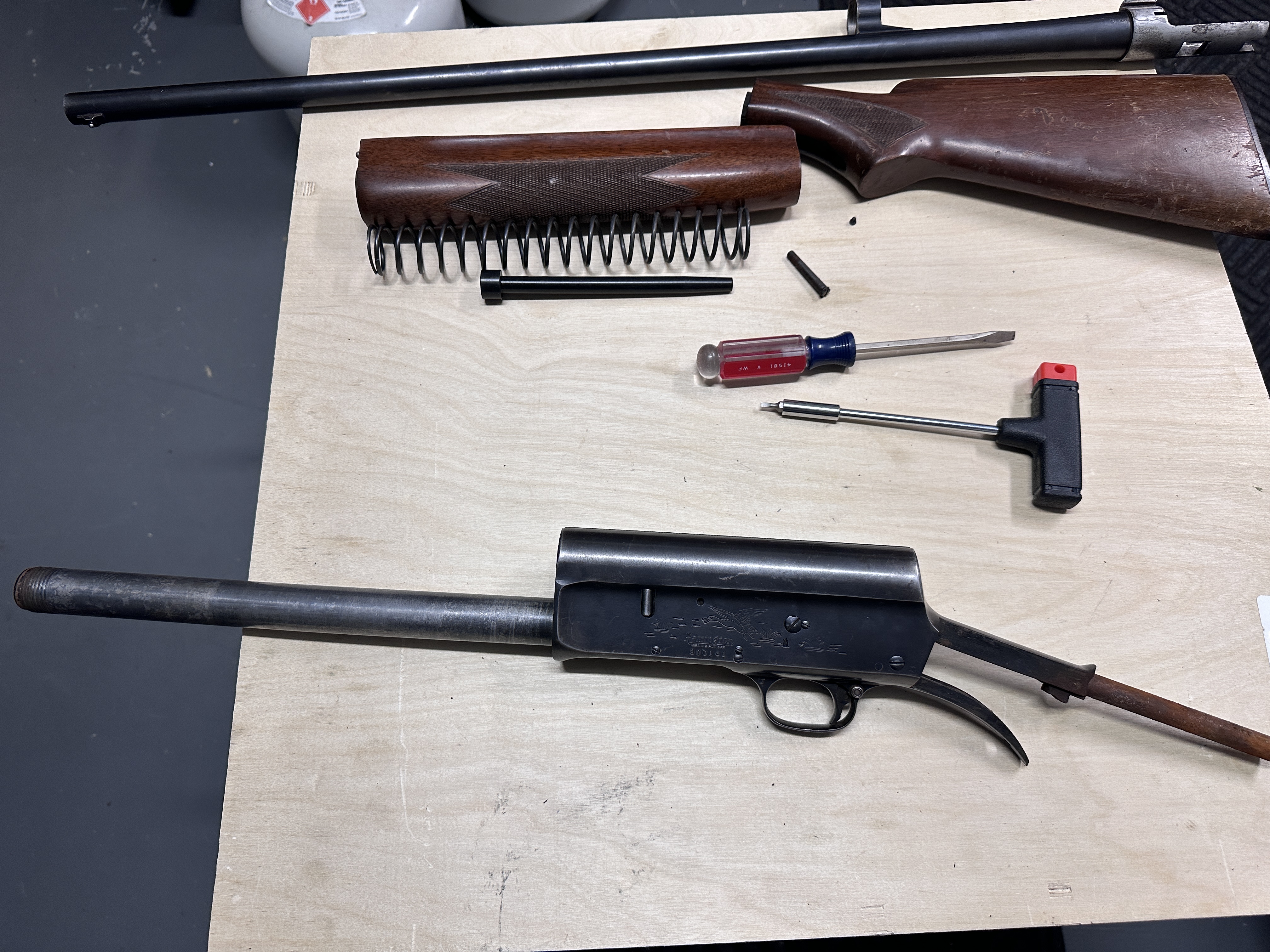

The main spring and rear action spring were both clearly worn out. I replaced the friction pieces just because. The stock extension was rusty as heck, so I sanded it down to metal again… next time I’ll plan to cold blue it maybe.
Unsurprisingly the action was full of dirt, grime, grease, and who know what else. Now it’s much cleaner and much better lubricated, though it took some bites out of me for the trouble.

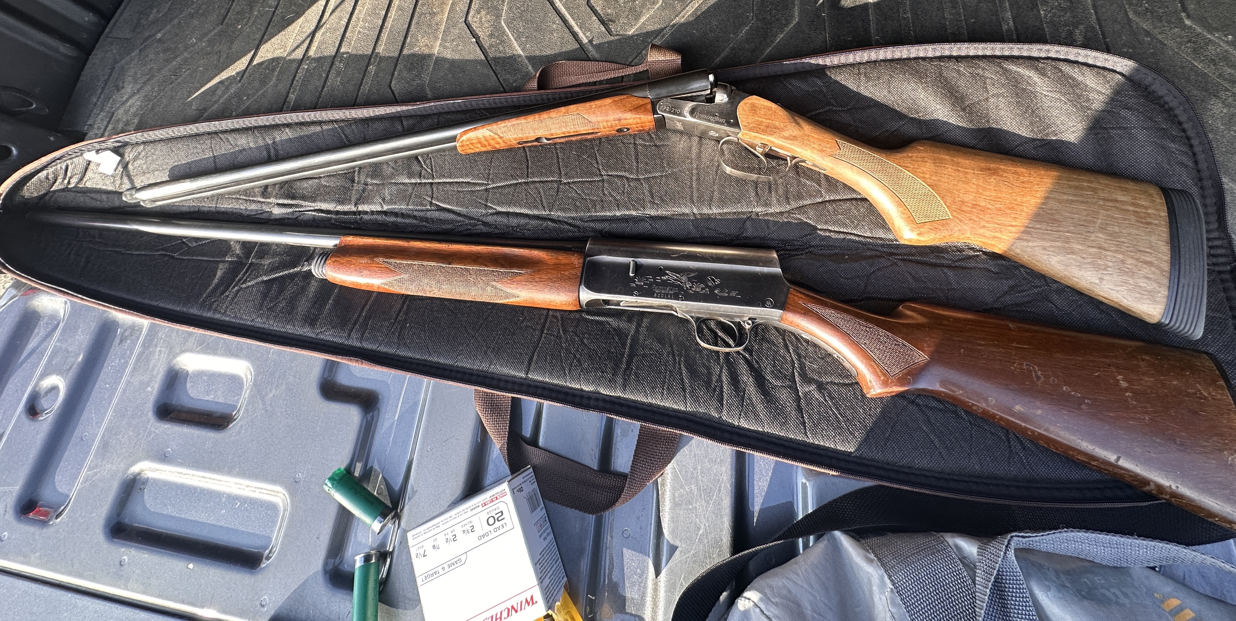

Trap Day!
Took my model 11 and SPR 210 out to the trap range for the first time. I’ve shot trap once before about 15 years ago but never made it back. I’ve shot some hand thrown clays with the 210 but never anything formal.
With the original springs, that I think were original to the gun (1948), I could feel the barrel and bolt slamming to the back of the receiver on every shot so recoil had a weird “chunk chunk” feeling. With the new springs it ran smoothly and recoil was fairly soft. Shot 16 of 25 with it, not bad for the first time really ever shooting trap and really ever shooting this gun.
I did less well with the Remington Spartan SPR 210 aka Baikal IZ43c. It’s a single trigger 20 gauge, left barrel has a skeet choke and right barrel has a Light Mod choke. I mostly shot on the right barrel LM barrel 8 of 25 for that one. Still, I’m happy with it for being an relabeled Russian fence post. Next time I’ll try tighter chokes…
