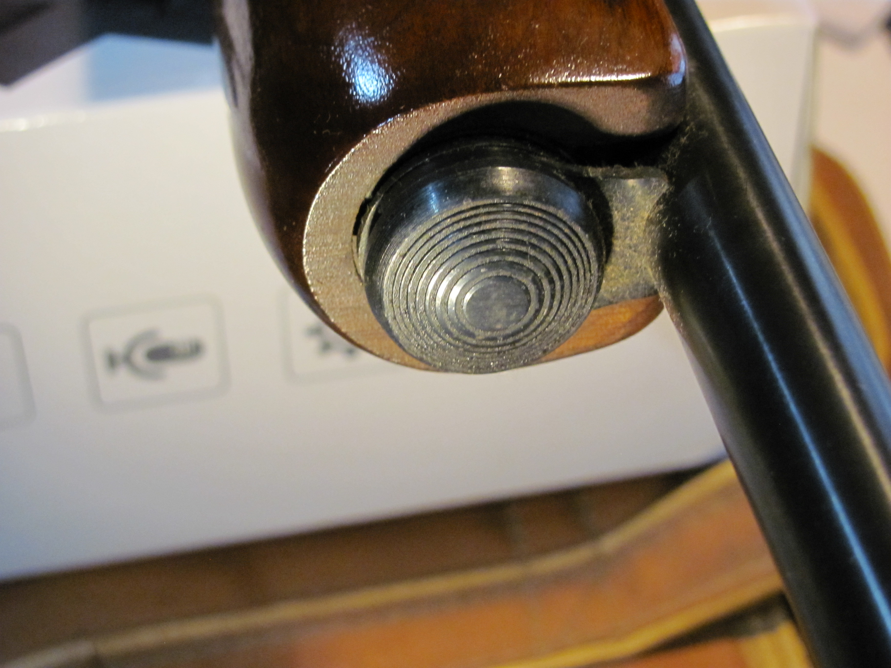

I inherited a Gamemaster 760 .35 without a firing pin (long story). I would like to get the weapon back into working condition, so I looked at a couple of videos on disassembly. They all say to remove the Fore-End cap screw by just unscrewing it. My issue is there is a cap over the top of the screw and I am unsure how to remove it. See attached photo.

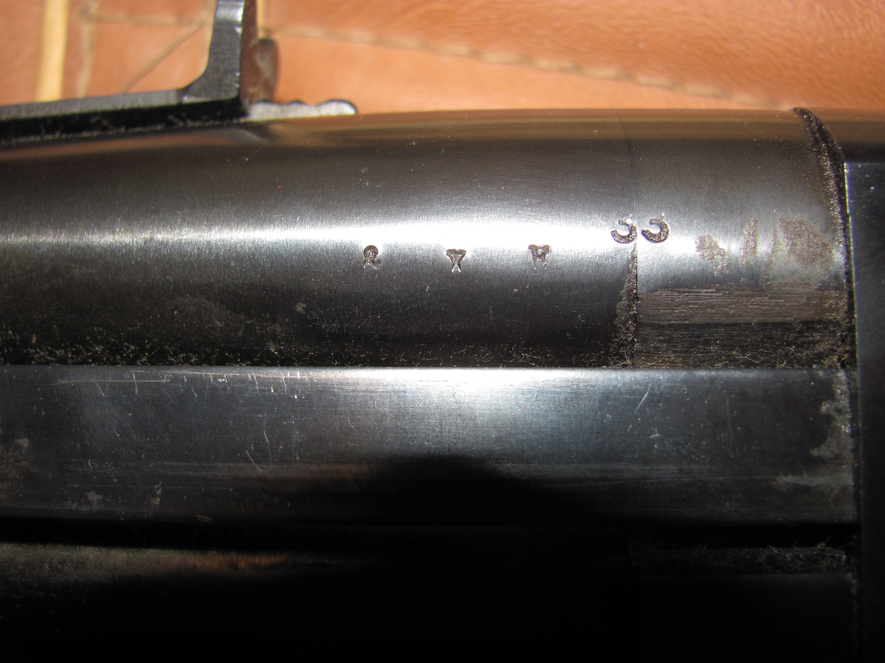

I am unsure what the age is either, as I went to the Society page on Manufacturing Dates and what it shows is not stamped on my weapon. Instead of a date code I have 2 numbers and some symbols. See attached photo.
So either the weapon was built in March 1903, which I doubt, or I am reading something wrong.

The entire Action Tube is meant to be unscrewed. Open the action then look at the Action Tube, there are probably two holes that aid in disassembly.
