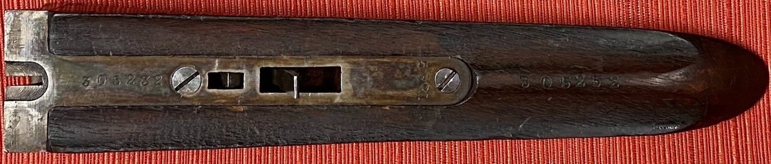

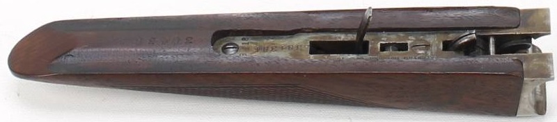

Extractor forearm --
305232 02.jpeg (227.26 KiB) Viewed 2860 times
Ejector forearm --
384384 08.jpg (40.37 KiB) Viewed 2860 times

Thank you for your reply. His forearm looks the same as the one in the bottom pic. This is confusing to us, because his barrel is stamped "K D".
Don't know what the proper name is for them, but one of the pieces that actuate the ejectors does not seem to be working properly. One of them is in the down position, and the other is up when the forearm is removed. The one that is up interferes with the forearm getting into proper position for reattachment. He can/does push it to the down position(uses a piece of wood as it takes more pressure than can be applied with just his hand), then is able to reattach the forearm. When he fires the gun, and breaks the action, the ejectors react like extractors, not ejectors.
