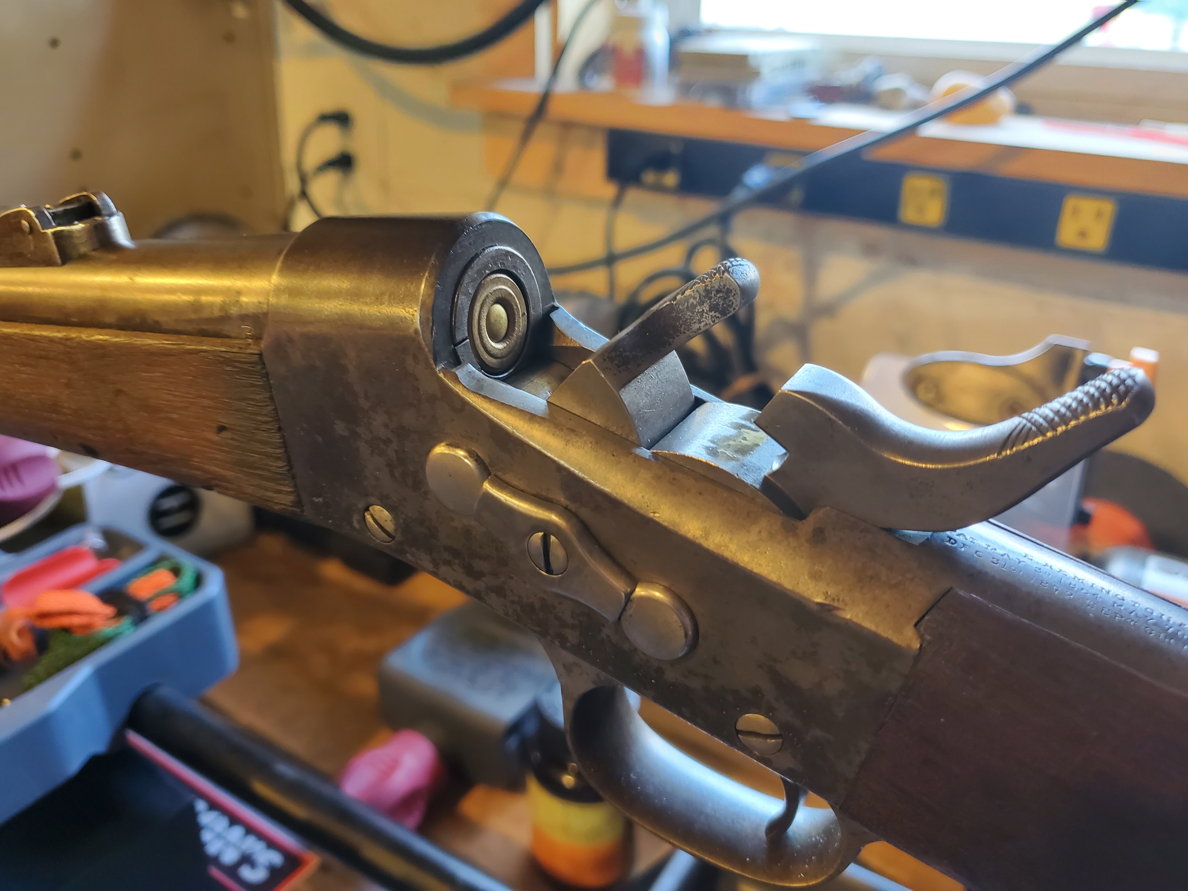

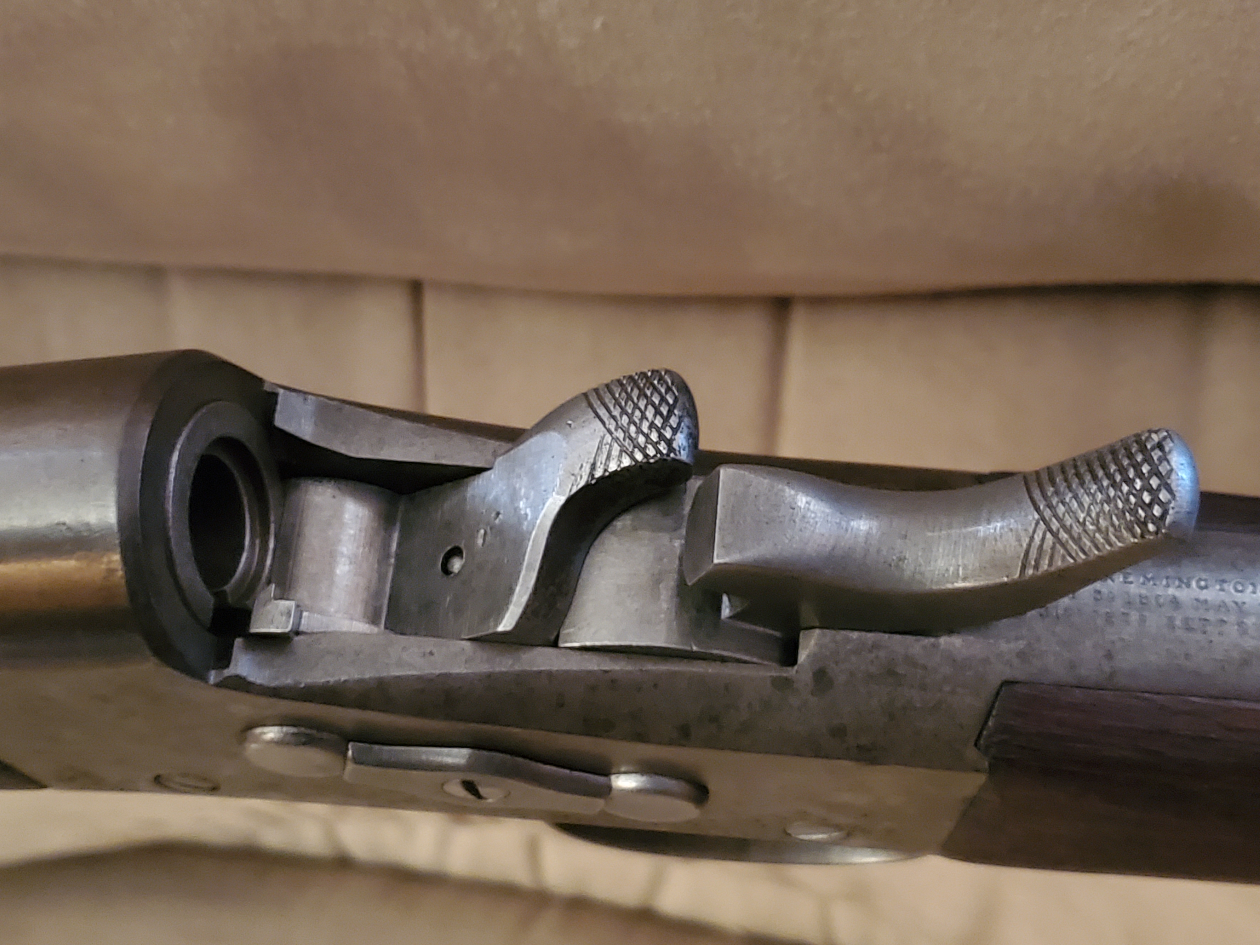

Recently purchased what I believe to be a #1 Rolling Block chambered in 43 Spanish. Any additional information confirming or correcting this would be greatly appreciated. It did come with a m1871 first pattern bayonet.
I purchased a couple .43 Spanish cartridges on GunBroker from a collector that failed to chamber. So either they were not 43 Spanish, they appear to be 43 mauser, my rifle is not a 43 Spanish, or both.
Overall Length 50.5"
Barrel Length 35.25"
Muzzle .431"
Receiver 1.325" at the flats

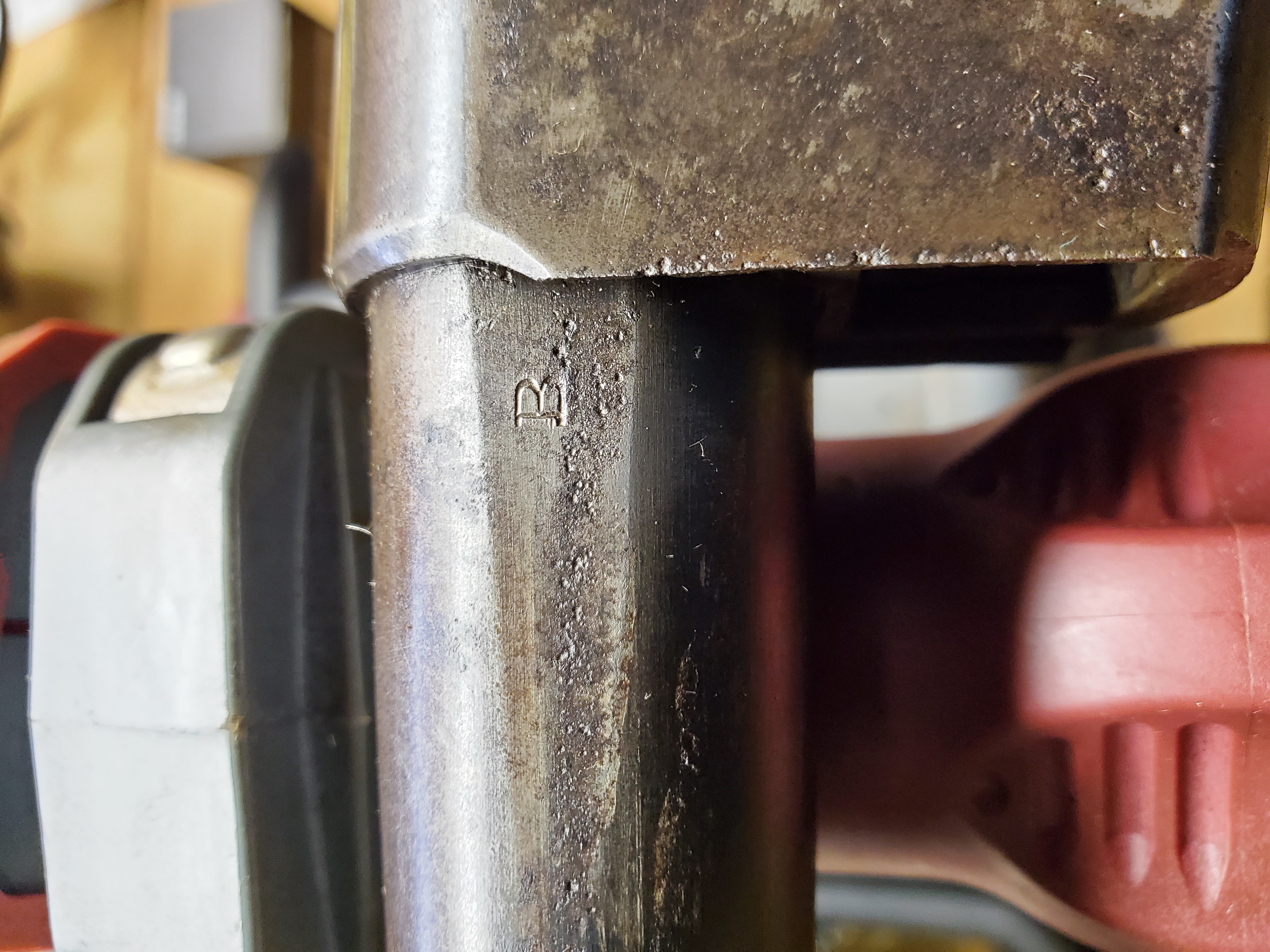

These are the markings found when disassembled.

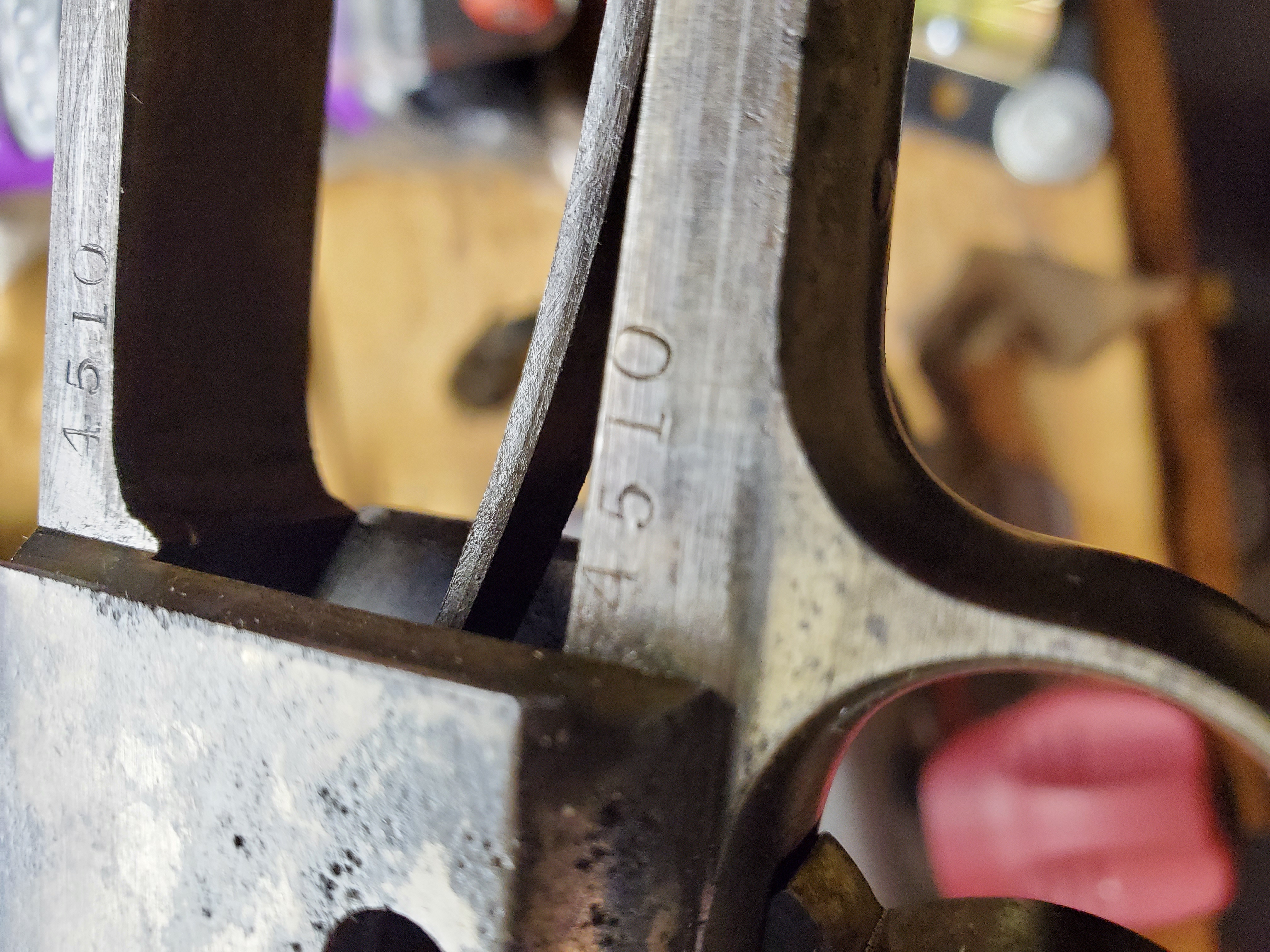

Upper and lower tang - 4510

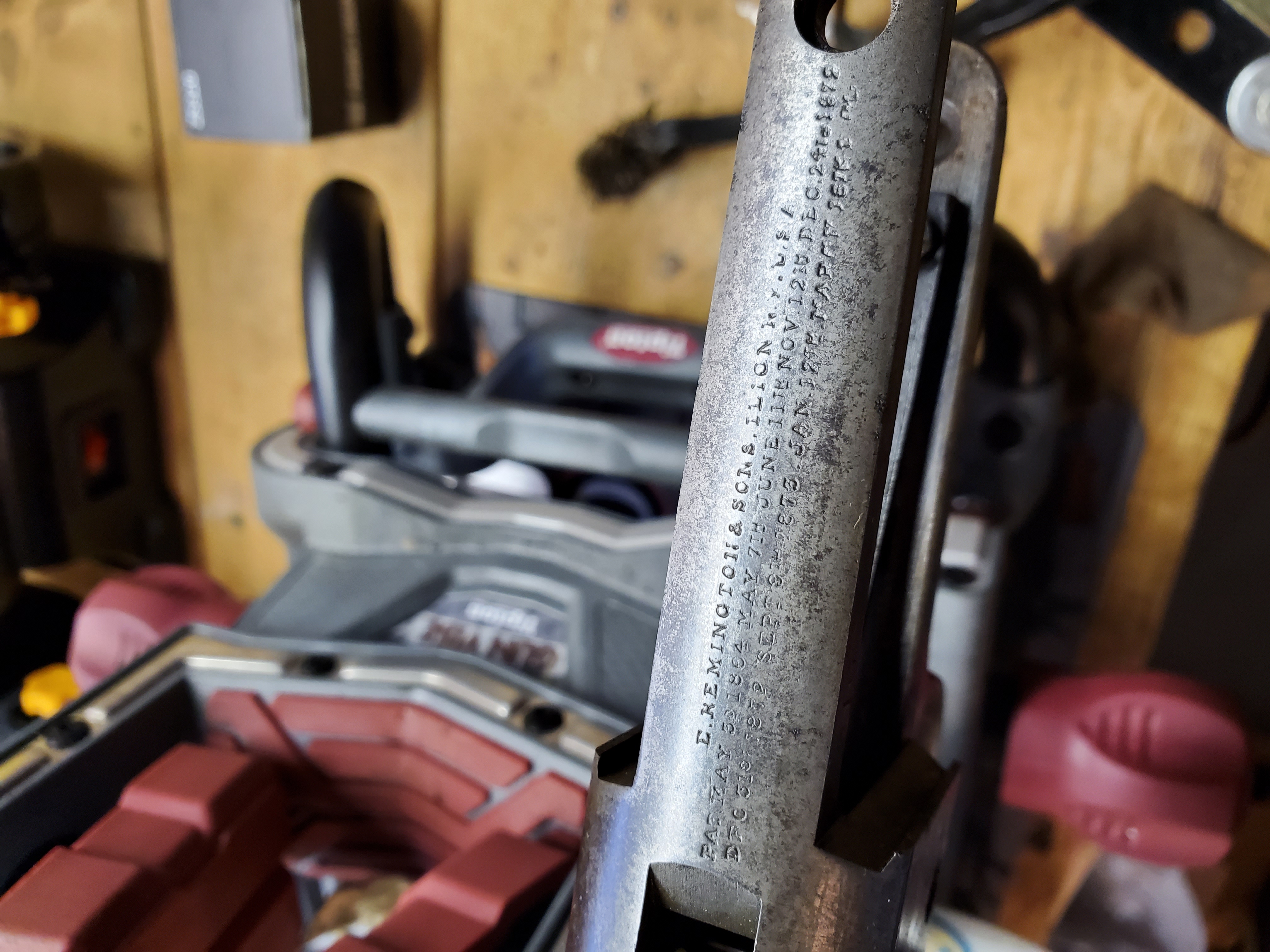

Upper tang three lines starting with E Remington & Sons, the final patent date is illegible.

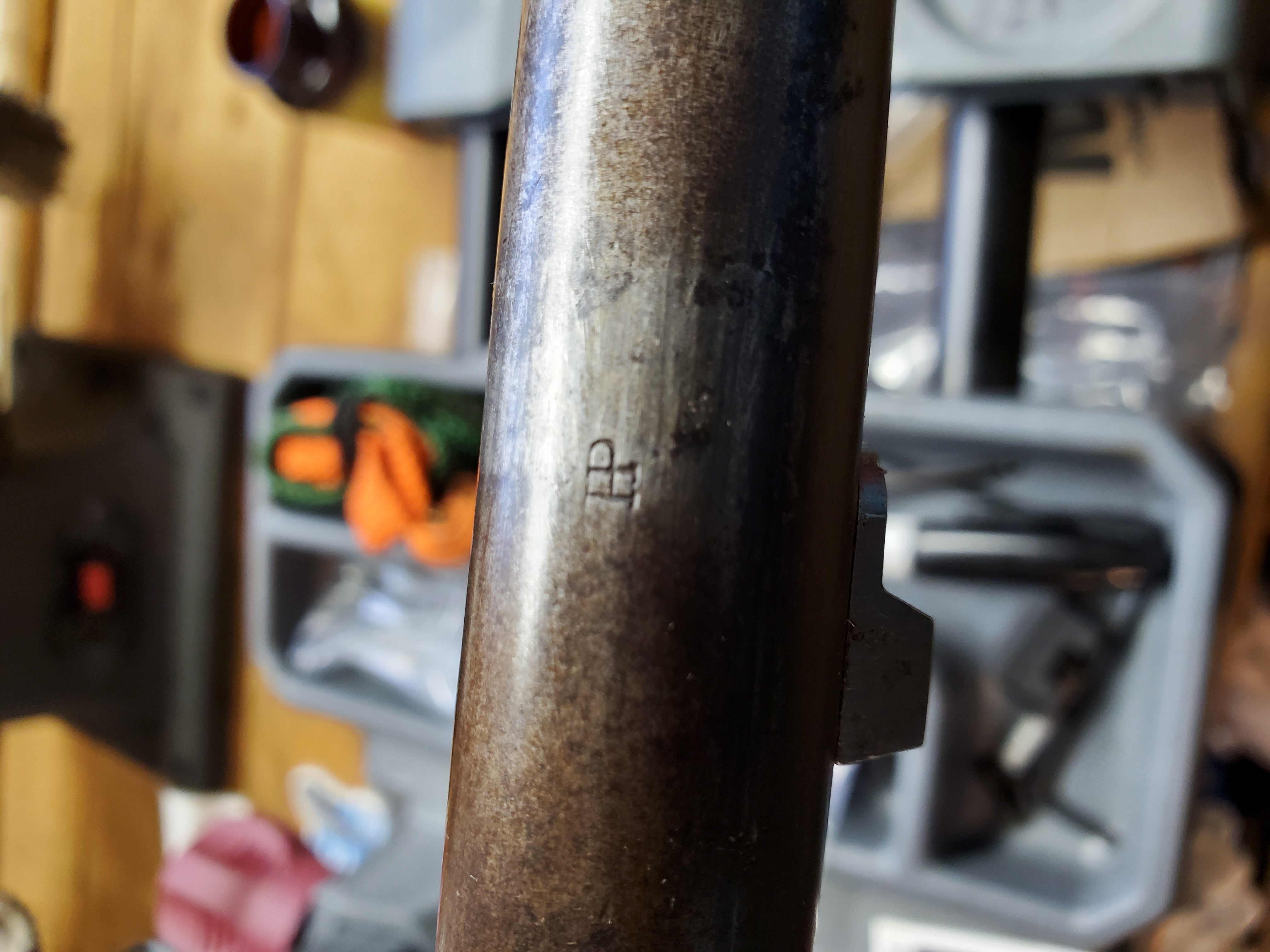

Barrel marking just before the receiver - B
Barrel marking under first barrel band - HP
Buttstock - 2
Forearm sling mount - Paid Feb 11th 1866
The receiver original finish was Case hardened as some of it still remains.
I have not "slugged" the barrel yet.

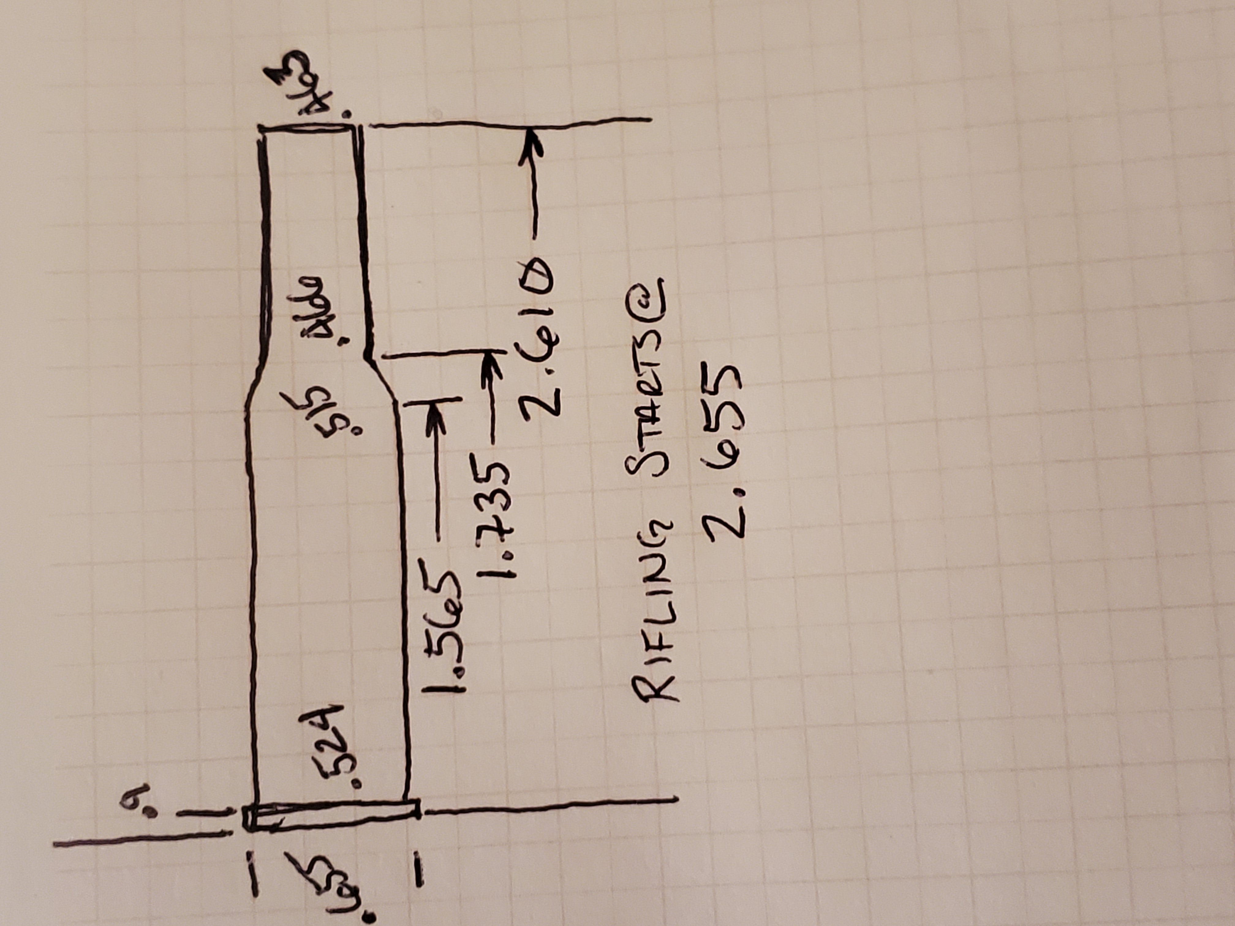

I did do a cast of the chamber and the dimensions are attached as an image.
That is all I have for information.

Re: Rolling Block identification help
It's not a 43 spanish nor reformado if that helps don't believe it's an egyptian The good news is this is the very best place to sort it out. Just went through the process myself good luck with it. Bill

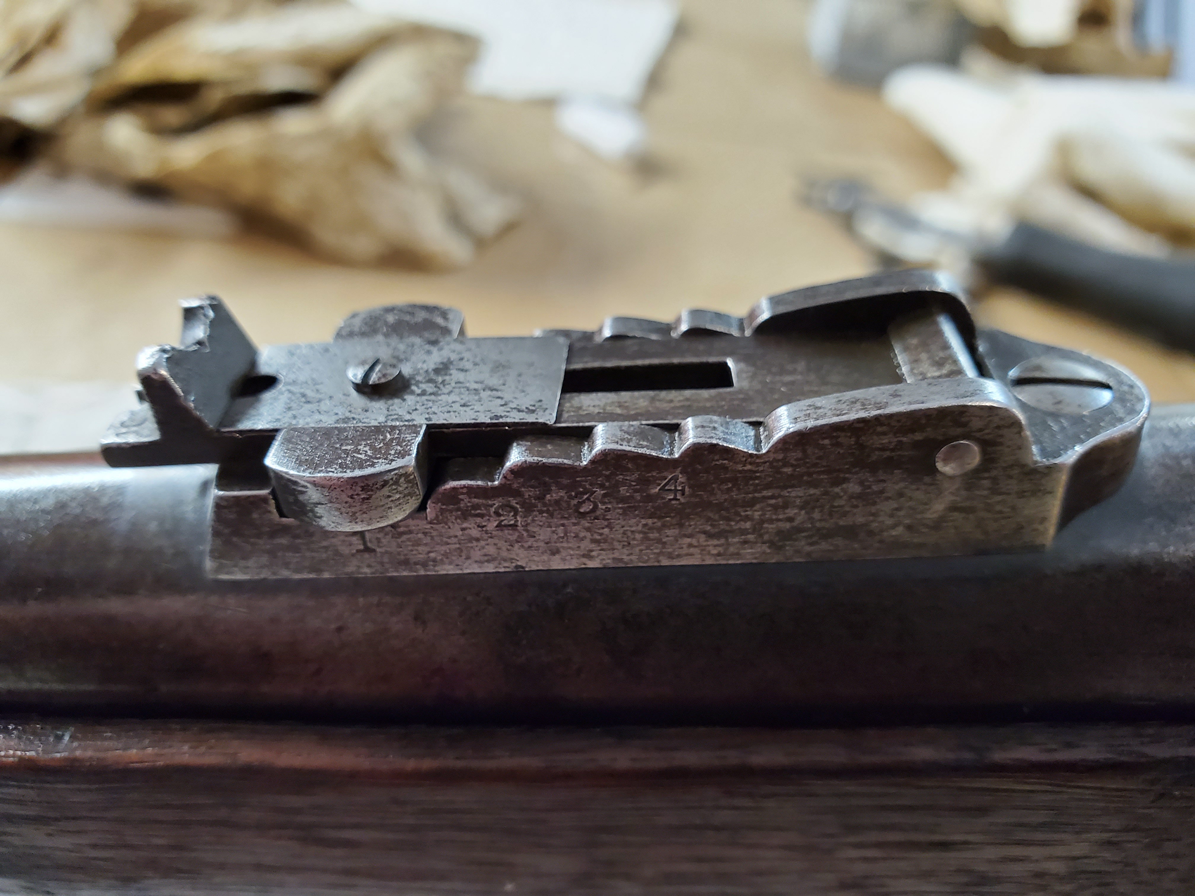

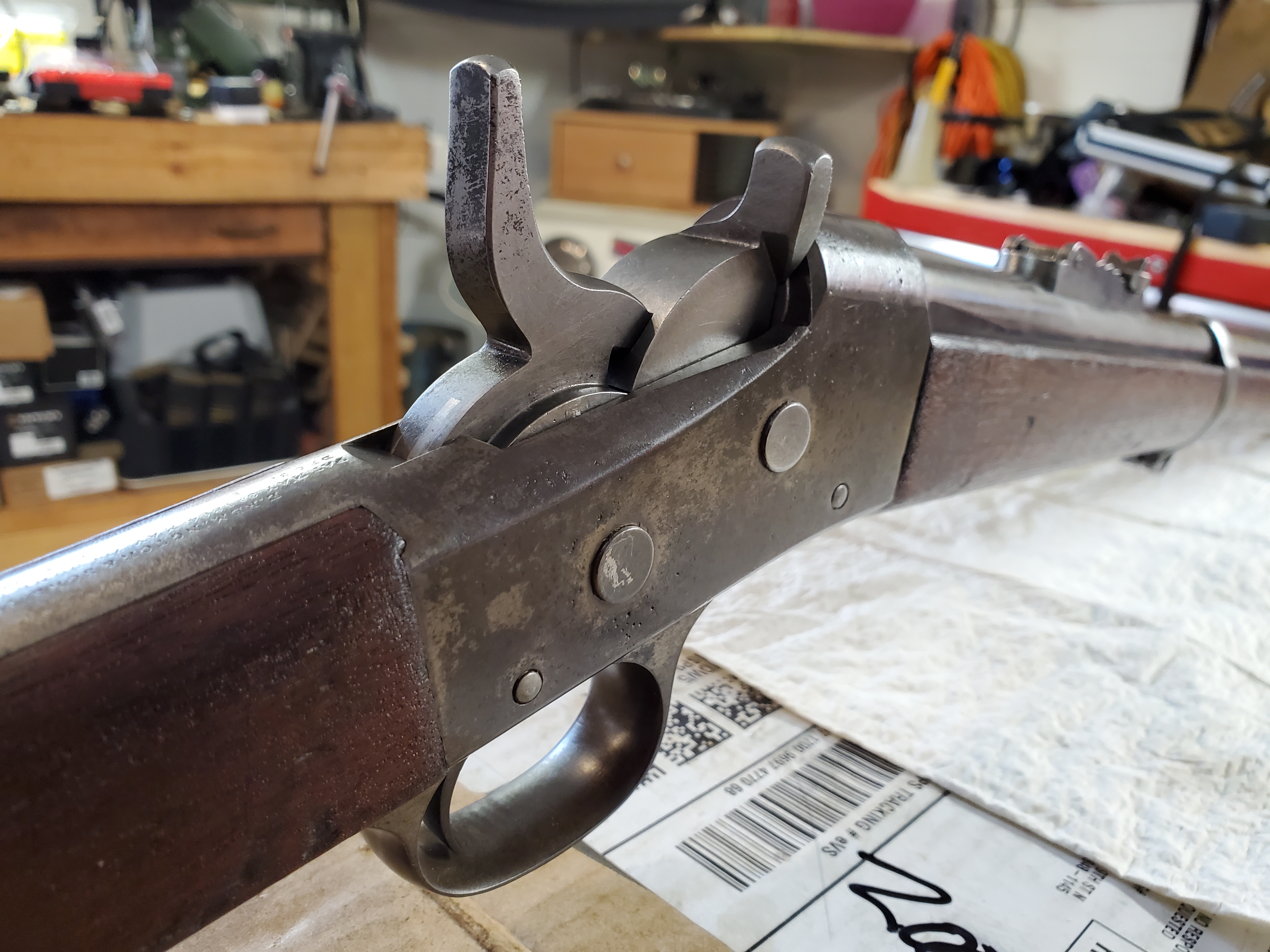

Here are a few more images of this rifle.
This is a very strange chambering for the Remington Rolling Block you have considering the chamber cast measurements. It's closest to the .44-90 Sharps than to any Spanish variation of the .43 cartridge. I wonder if someone ran a .44-90 reamer into the chamber to open it up? Or if it possibly got some special chambering many years ago?

You're correct that the numbers on the top and bottom sides of the tangs are not serial numbers. They are there to keep the parts together during different phases of finish and fitting work. So it has nothing to do with dating these rifles or actions.
The .43 Mauser does have a larger bullet diameter than the .43 Spanish. I believe the .43 Spanish uses a .439" bullet and the .43 Mauser uses a slightly larger .445"-.446" bullet?
Lee sells both die sets for the .43 Spanish or .43 Mauser at pretty reasonable prices, so whichever is closer would work for bullet seating, but likely not for full length sizing if your gun isn't one of the two cartridges.
But the .44-77 Rem./Sharps, and the .44-90 Sharps both use a much larger .451"-.452" bullet, unless it's paper patched. They use the same .446 for paper patched, which becomes a .452" with two wraps of paper. I shoot a .452" grease groove bullet in both my Creedmoor Roller in .44-77SBN, and my other Roller in the same caliber. I reload both using .43 Mauser dies because they were cheaper than buying expensive .44-77 SBN dies.

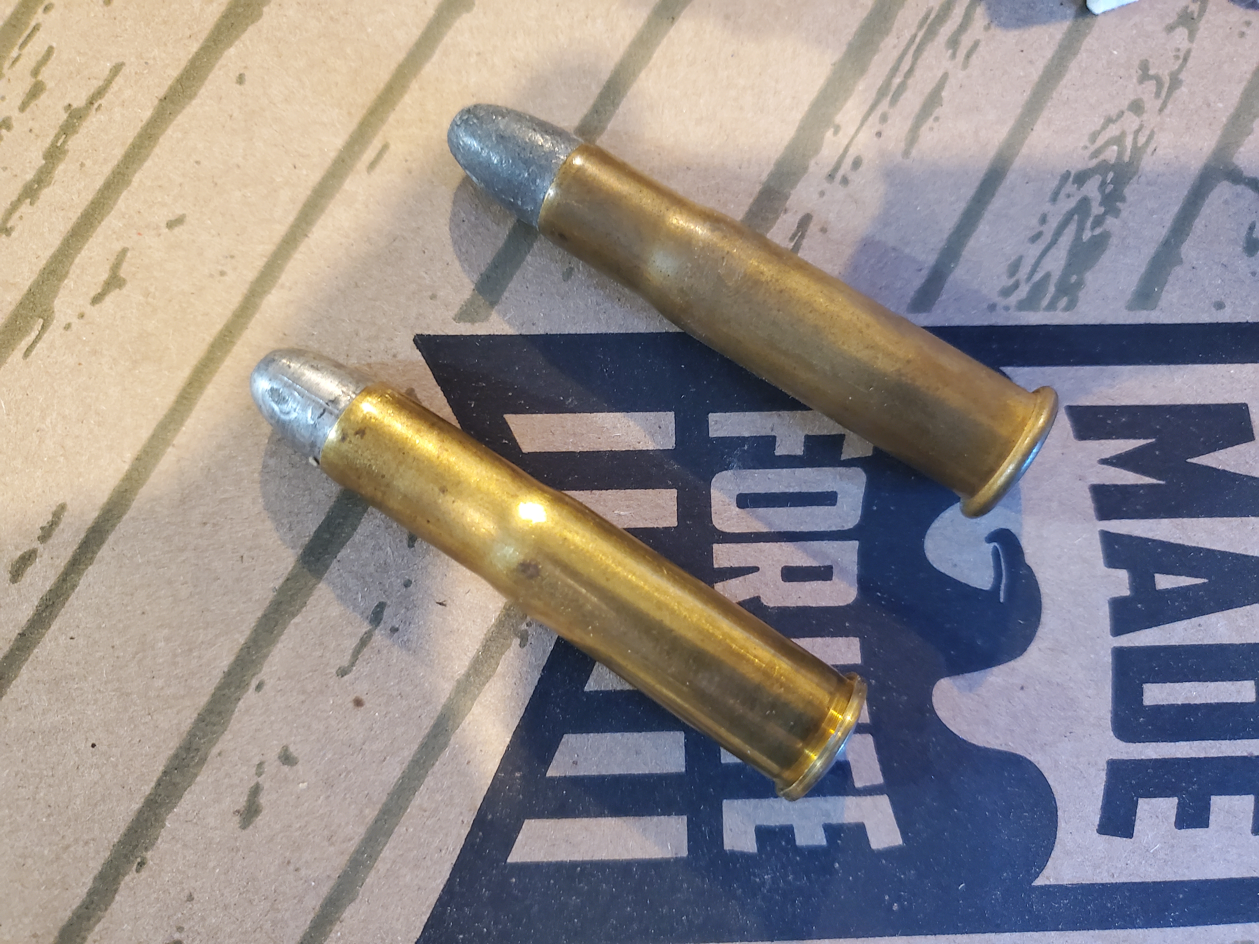

Attached are images of a .43 spanish (top), a .43 mauser (bottom), and a side by side (mauser on left). I ordered both rounds off Gunbroker as .43 spanish.
The Mauser round does not fully chamber, however, the .43 Spanish drops in like a long lost friend.
Hi There,
Your chamber measurements are consistent with the
same measurements of my chambers of the two rifles
I have in .43 Spanish.
Good Luck!
