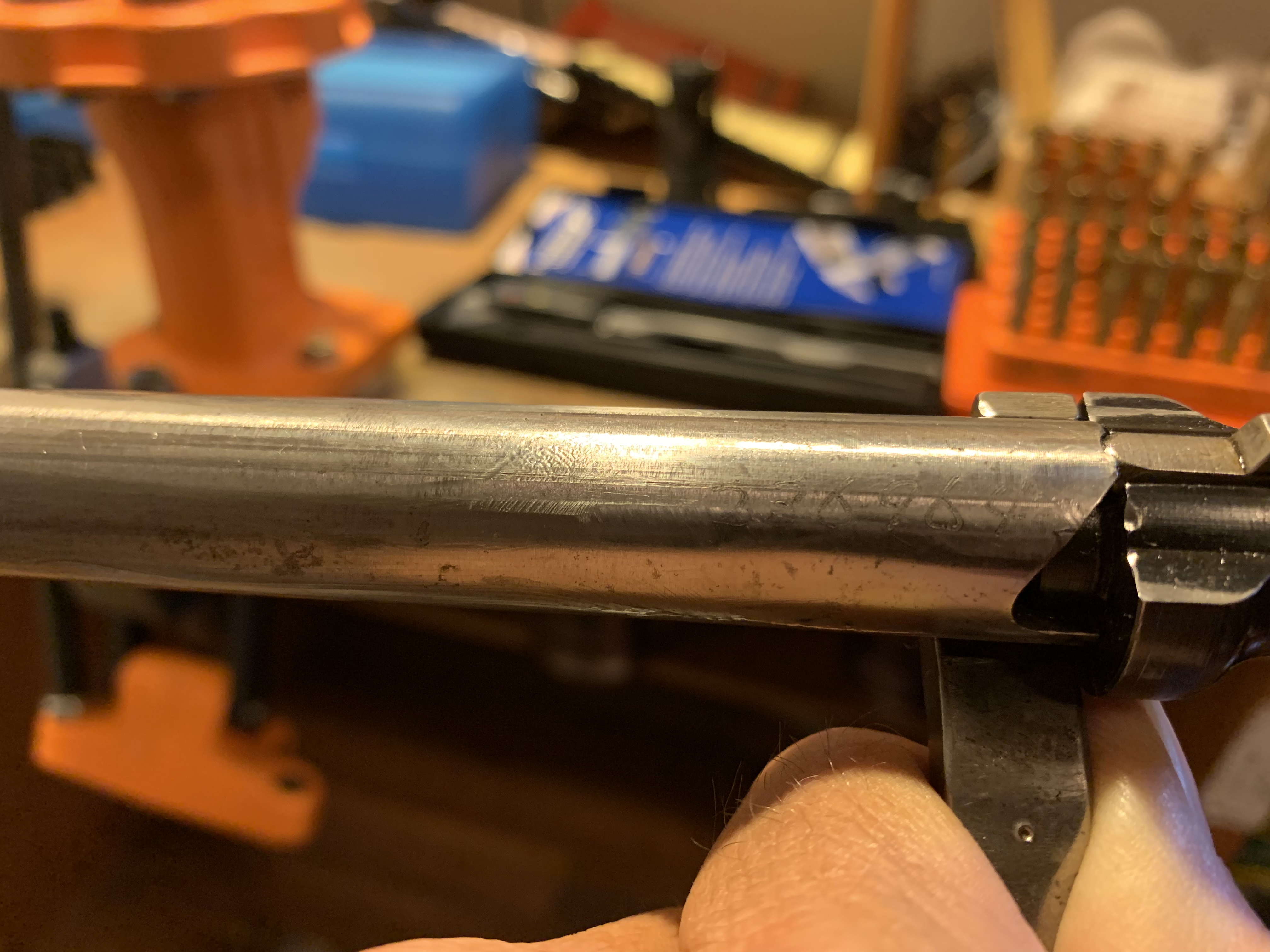

423360 722/308 AE 3/58O
OD Barrel and receiver

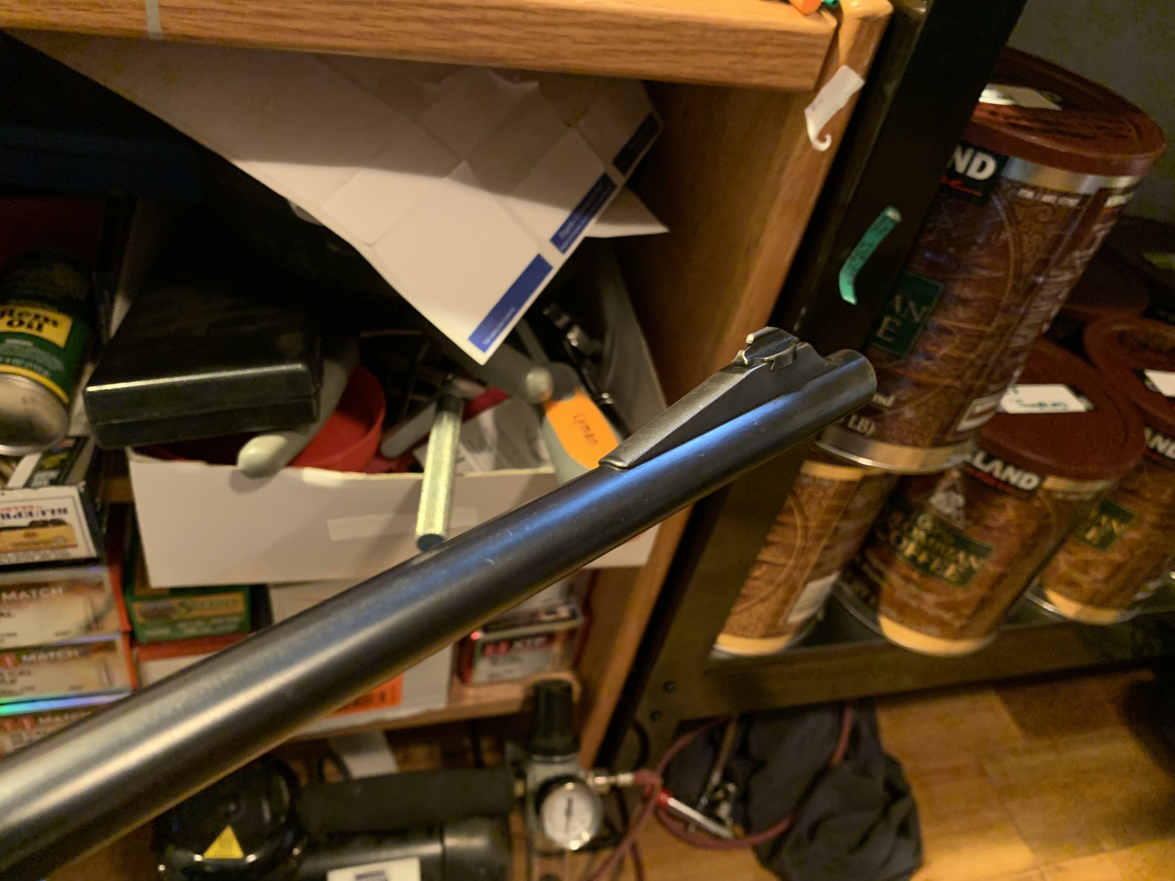

Rear barrel sight screw mounted

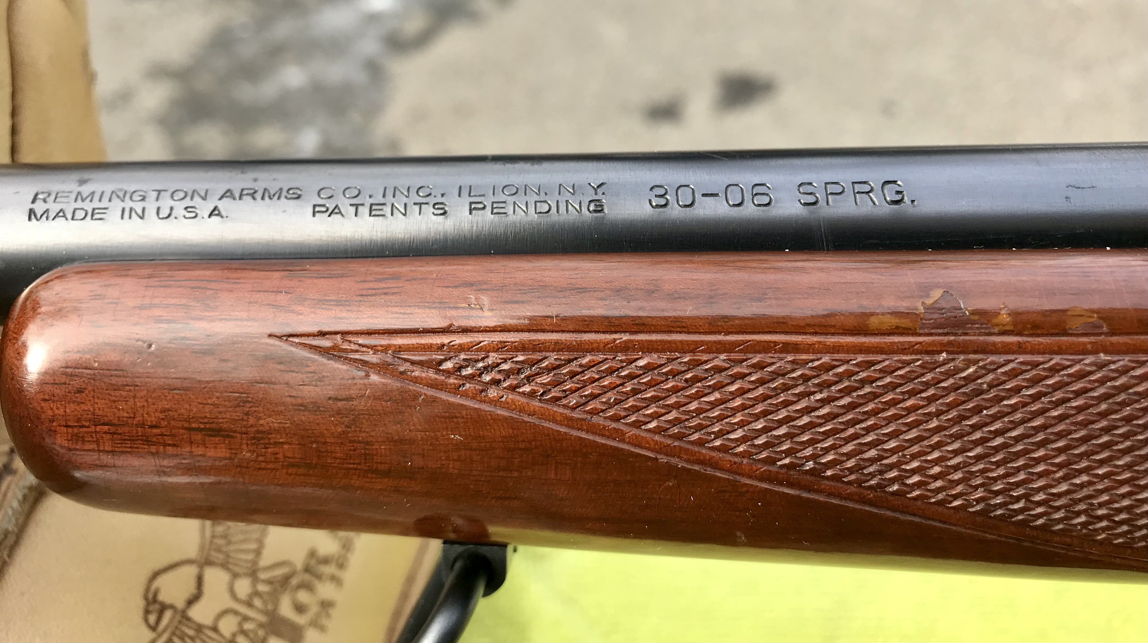

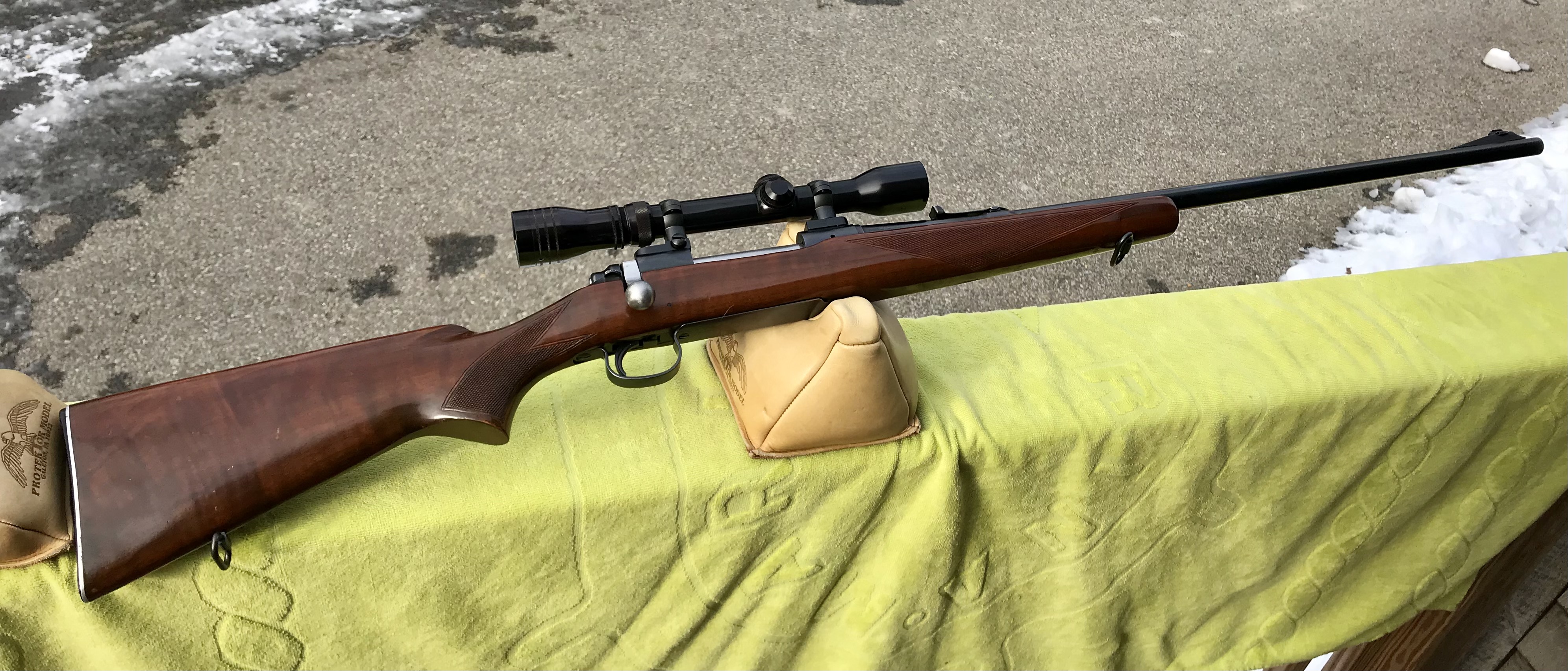

Was up in Idaho last week and stopped in a local gun store. They had a Remington Model 721 in 30-06 sitting on the shelf. I could not pass it up for $240.00, it has an Herters I think, after-market stock with a really short length of pull, I'm going to look for a factory stock to put back on the rifle. The stock looks to have been cut down for a Jr. shooter. The bolt and follower are both jeweled which is interesting. The blue is near 100% and the bore is fantastic.
254269 721 30-06 O YY 07/1952

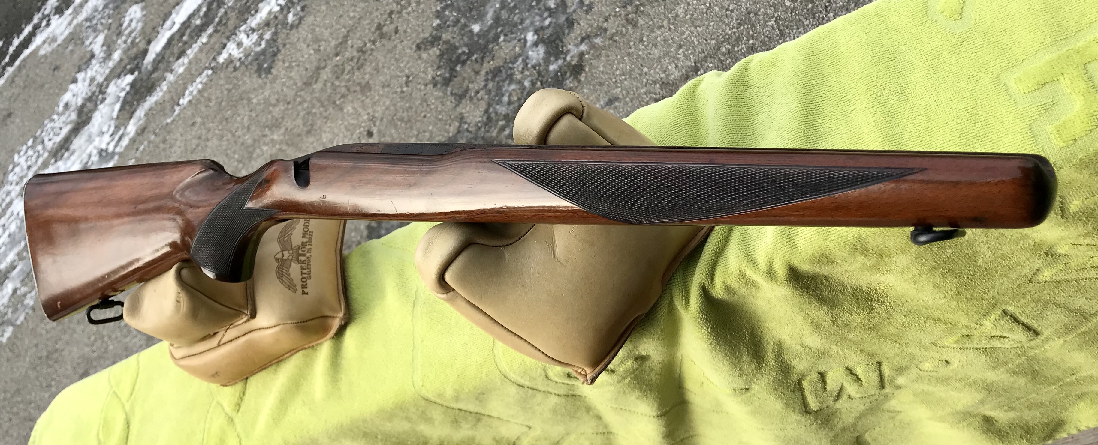

I call this one my "rescue rifle" it looks like whoever owned it before left it in the corner of their bedroom closet and let it rust up. It needs a good cleaning and de-rust treatment to get it in working order but everything is there, headspaces correctly, and has an excellent bore.
Hre are the specifics for the data listing:
316984 721 270 P ZZ 06/1953

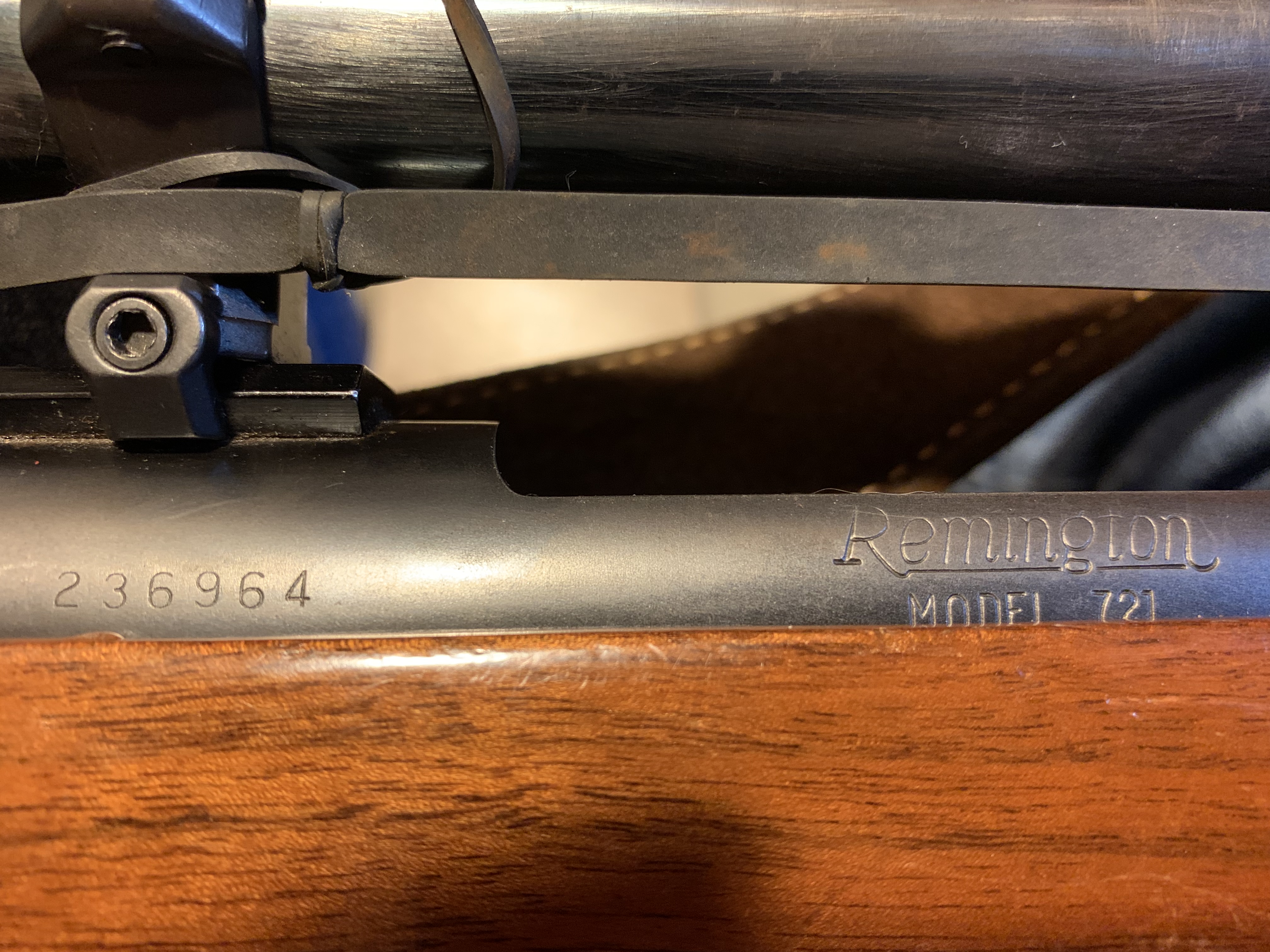

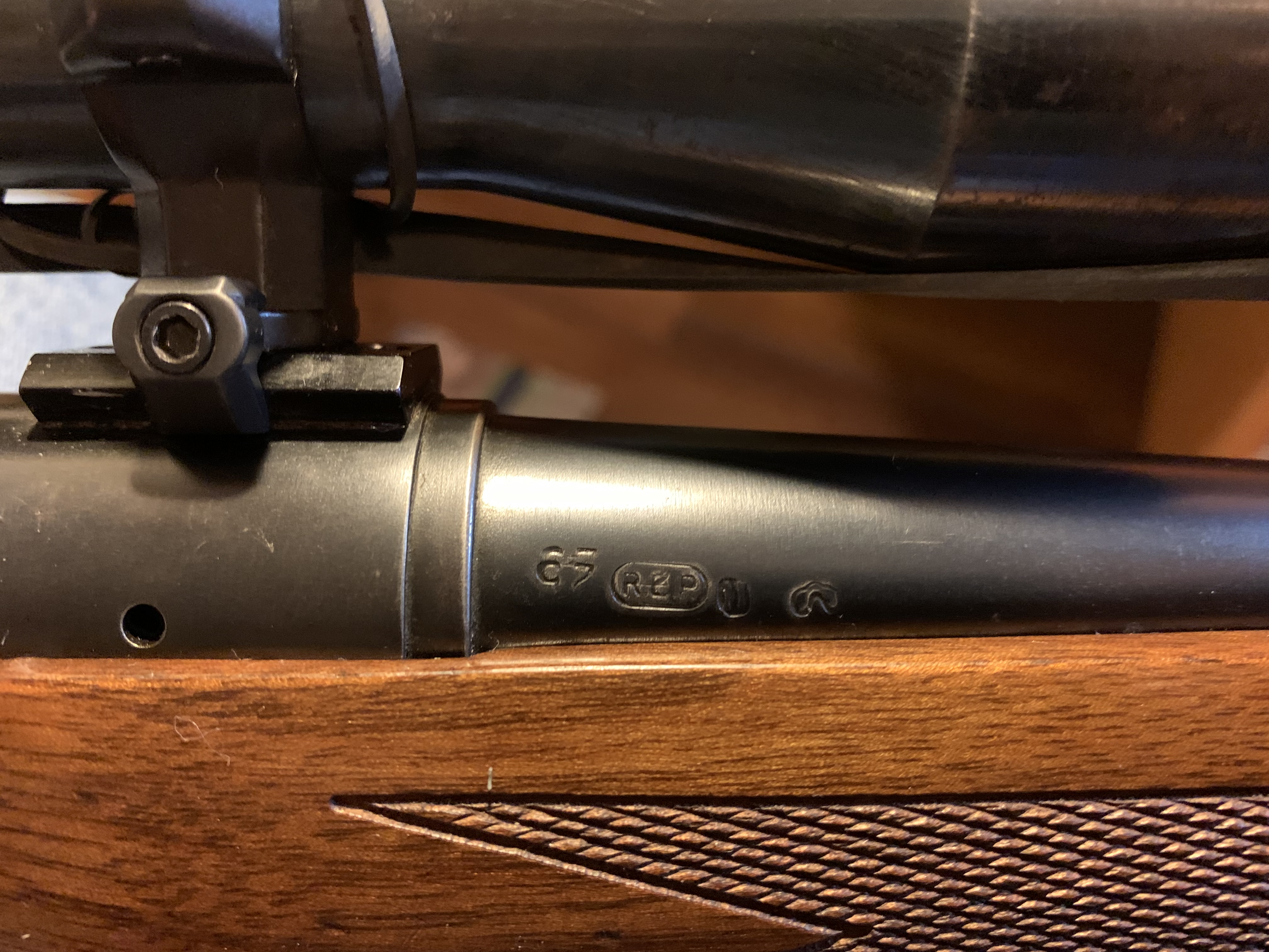

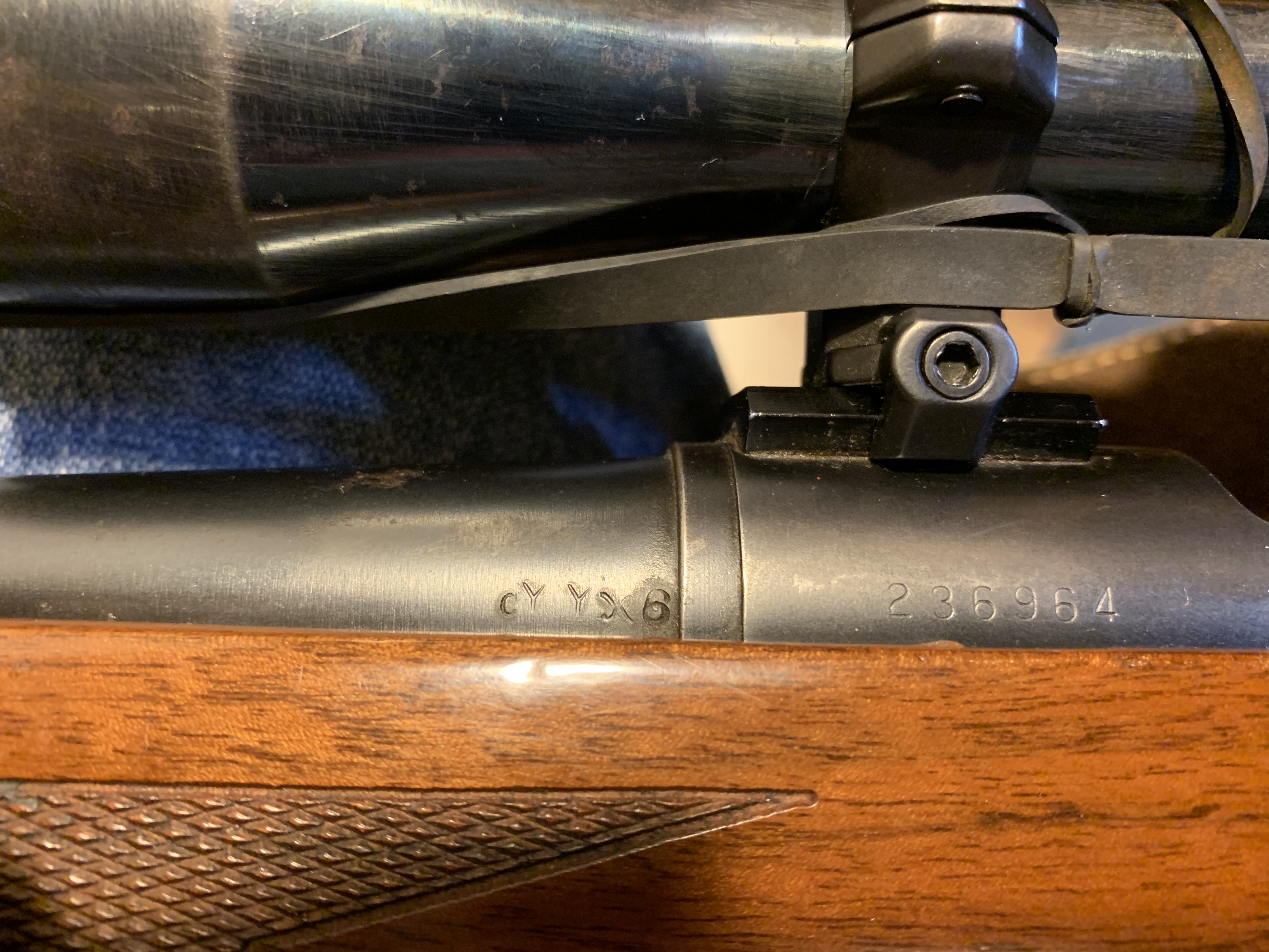

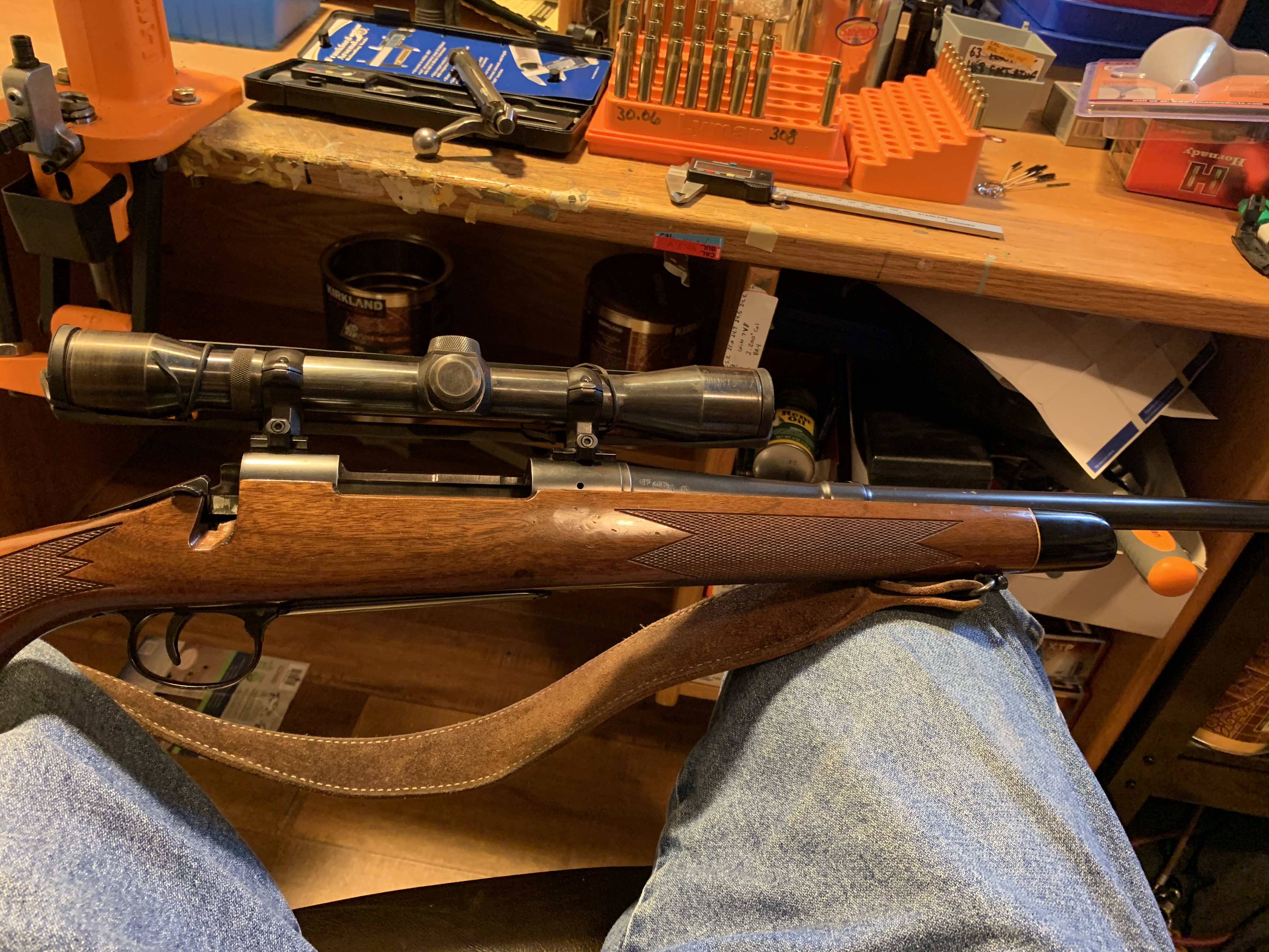

C YY 4/52 SN 236964 .30-06Sprg. Bought new December 1952 at Hi-Ho, Puyallup, WA. 700 BDL stock put on in November 1972 when 4x5 double eye guard bull elk was hit over the snout with it as it started to get up. Still shoots straight and has 16 Elk on it since Grandpa gave it to me Christmas 1976.

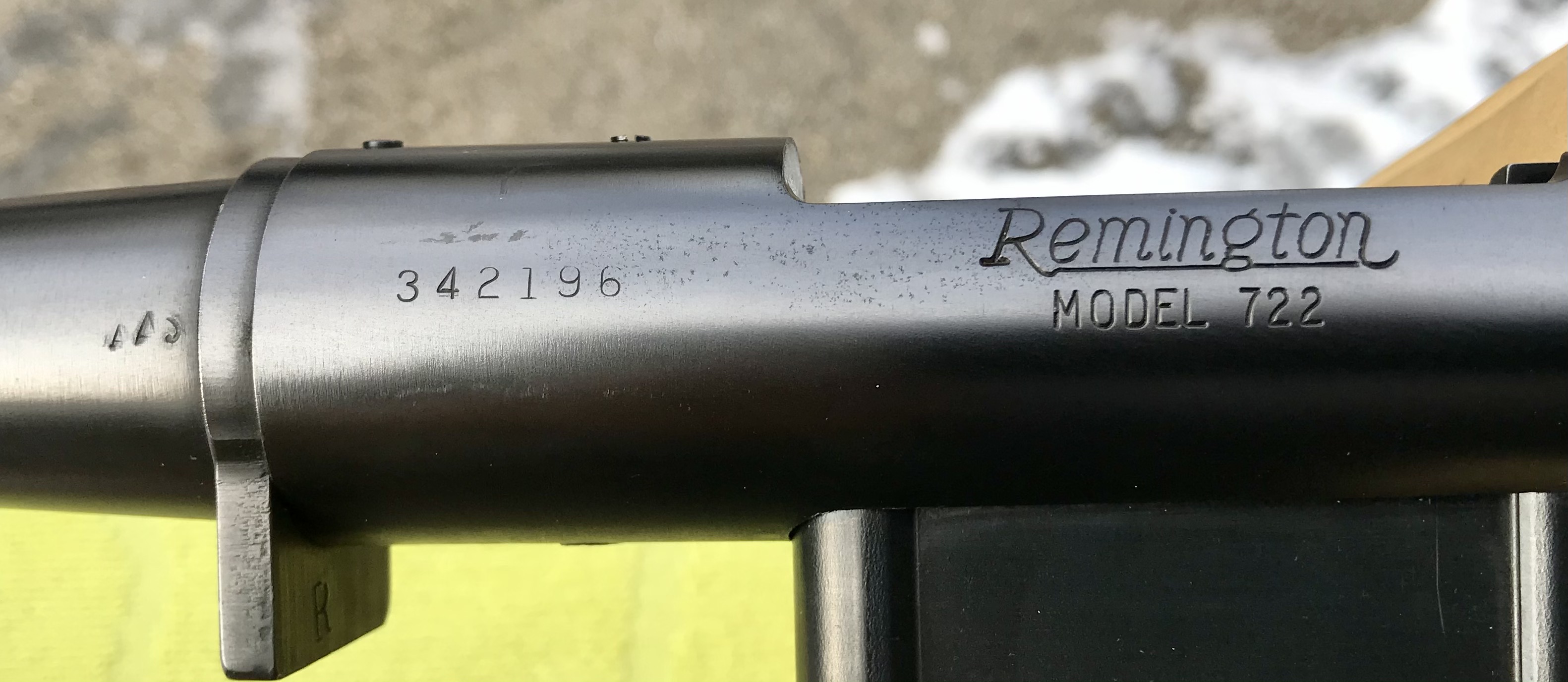

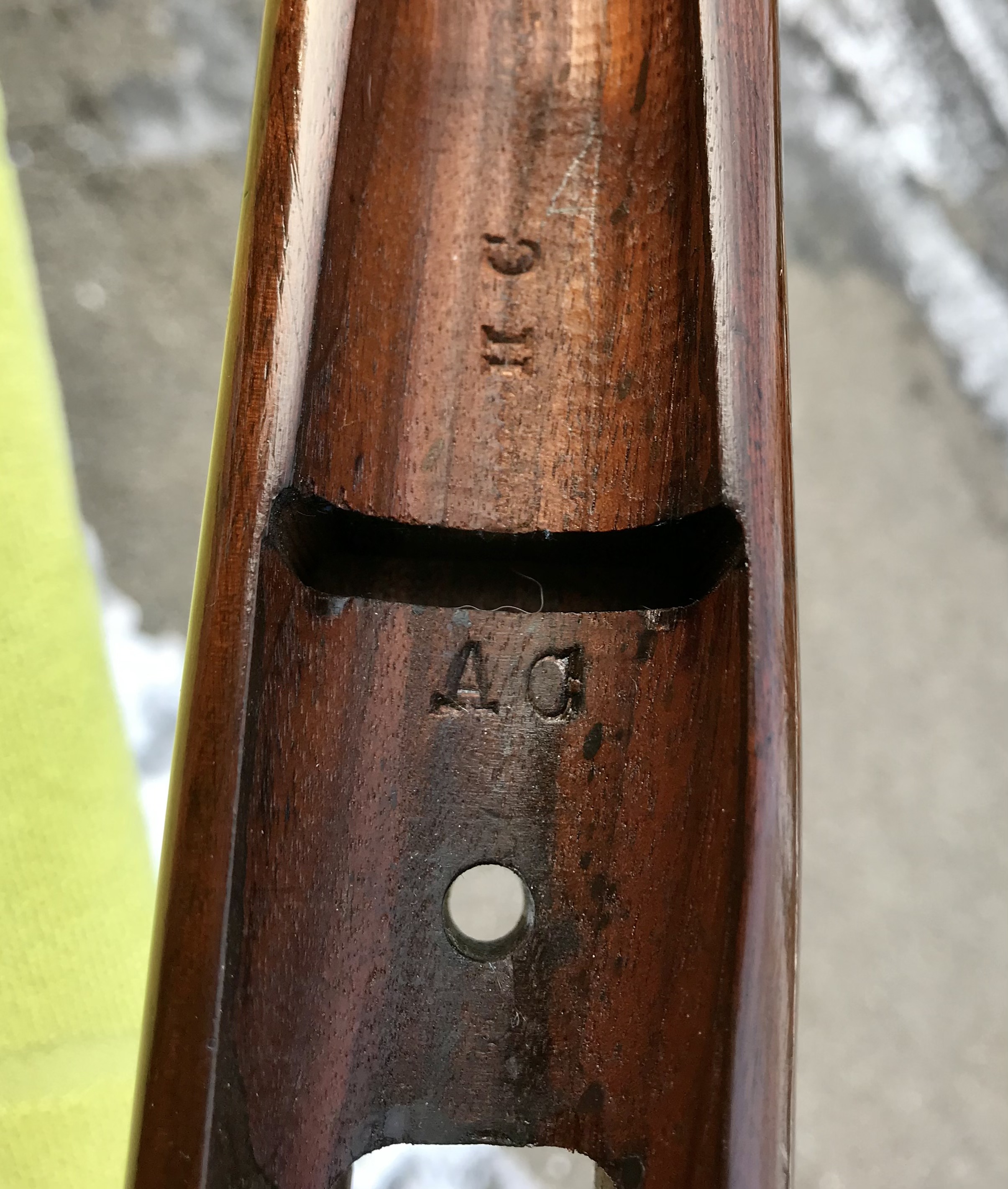

Model 722-AC, 222rem, No barrel code, Serial # 342196, 26" barrel, Barrel channel stamped with AC and HC. Dovetail for rear site and rear of receiver drilled.

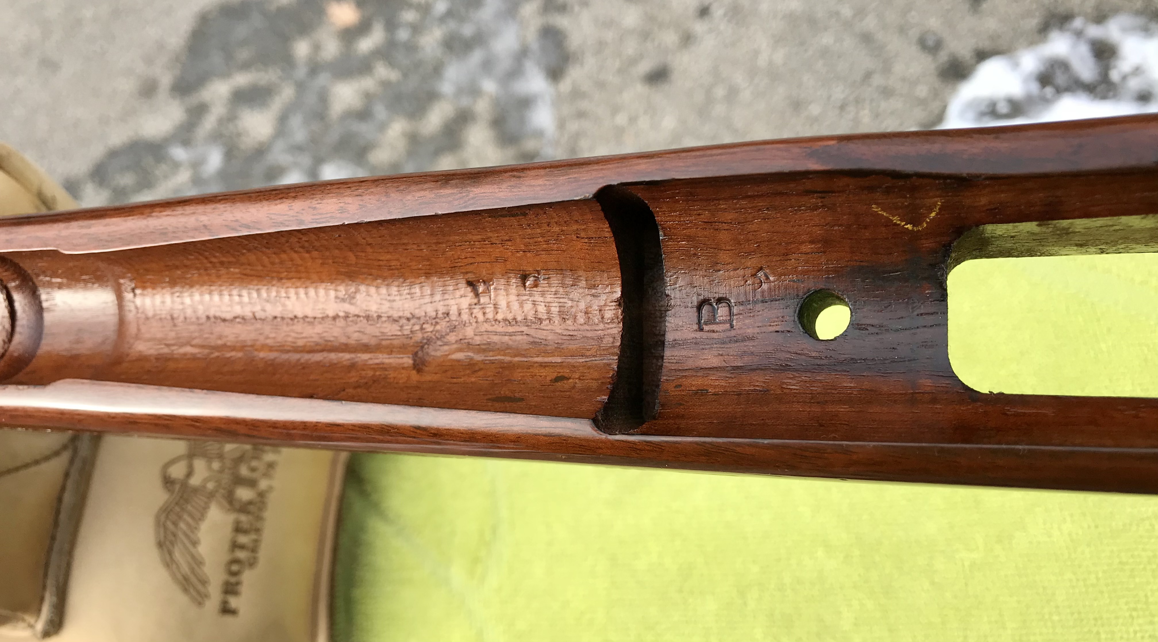

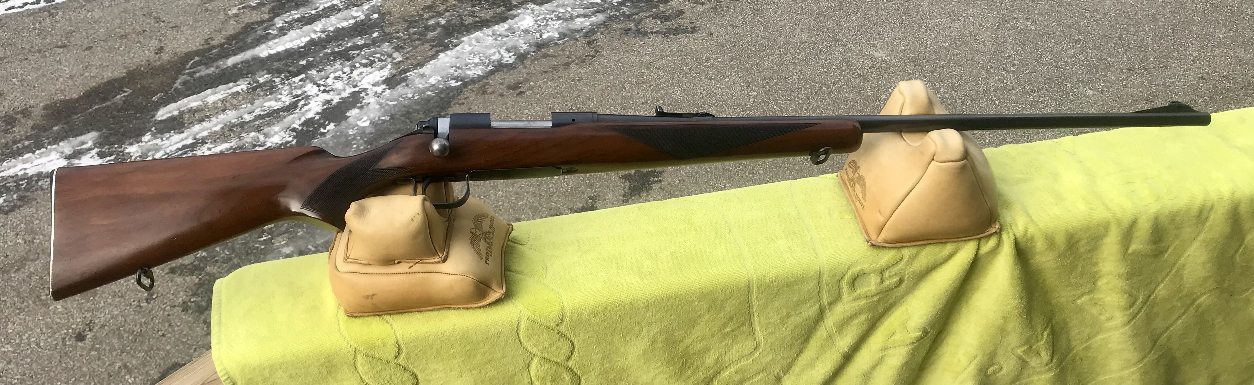

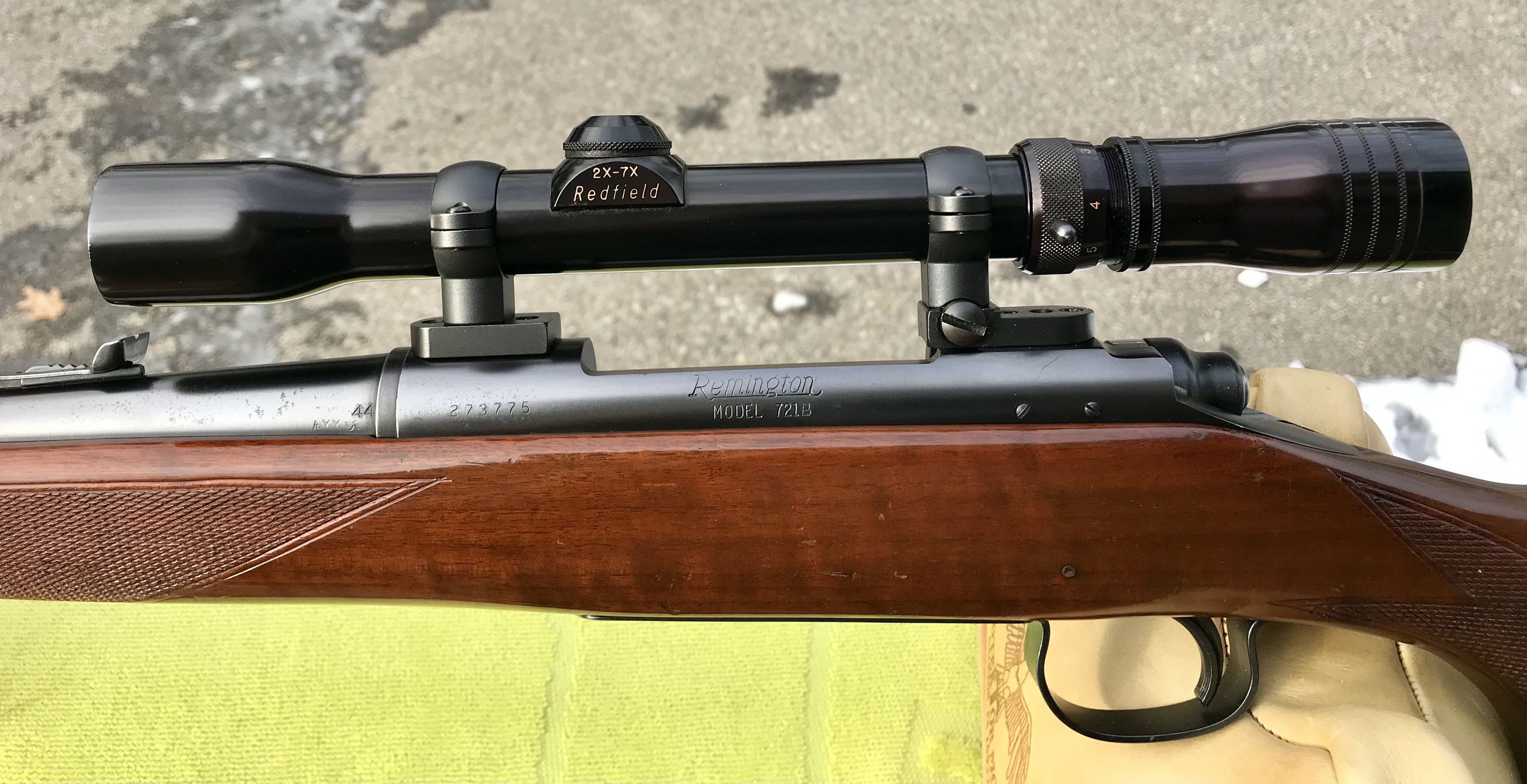

Model 721-B, Serial # 273775, 30-06 Springfield, barrel code RYY Nov1952. dovetailed rear site, rear receiver drilled and Barrel channel stamped wit "B" and receiver with hand engraved "B" after 721

54bullseye wrote: Sat Jan 15, 2022 10:18 am Model 722-AC, 222rem, No barrel code, Serial # 342196, 26" barrel, Barrel channel stamped with AC and HC. Dovetail for rear site and rear of receiver drilled.
Looks to me like the barrel date code is "A A"......March 1954.
Den
54bullseye
Posts: 137
Re: 721 722 725 dates of mfg
Post by 54bullseye »
Your right and I did see that but see how one A is bigger than the other. I hadn't seen date codes that were different sized !! I have seen them partially stamped and not lined up straight but not different sizes ?? I stand corrected ! Thanks John Taylor
