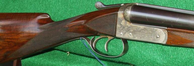

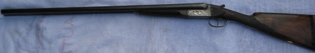

I believe that any no-safety Remington Hammerless Double was a special order item --
139072 05 CEO-Grade Pigeon Gun.jpg (50.11 KiB) Viewed 21708 times
Re: Remington Model 1894 Pigeon and Trap Guns
The no-safety guns I've recorded are all in the 132xxx and higher serial number range. The one that broke my heart was, 139928, a DEO-Grade that Pete Harvey had at the Pikesville, Maryland, gun show at least three decades ago that had a very poorly done retro-fit safety.

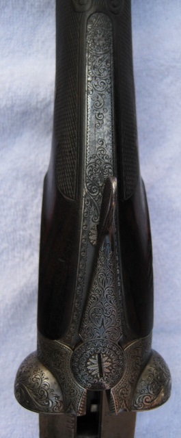

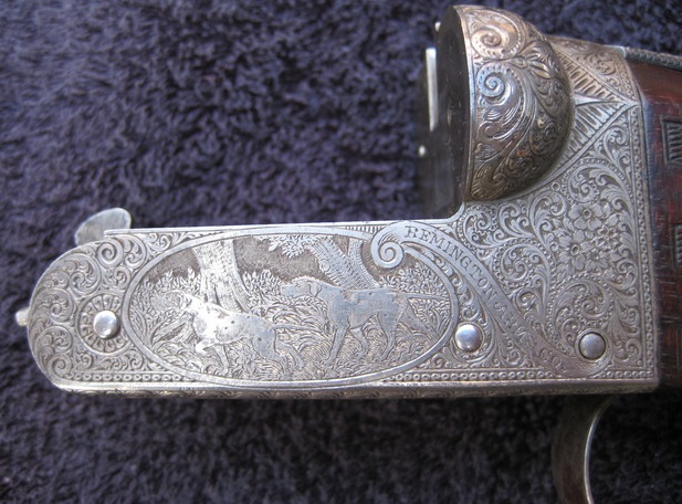

There's at least 1 EEO out there, Dave you have it don't you?
I have listed an EEO with no safety, 137777 --
137777 02.jpg (50.71 KiB) Viewed 21441 times
I have 11 pics of 137777. Here are some more --
137777 01.jpg (92.9 KiB) Viewed 21423 times
137777 08.jpg (119.73 KiB) Viewed 21423 times
137777 11.jpg (19.88 KiB) Viewed 21423 times
