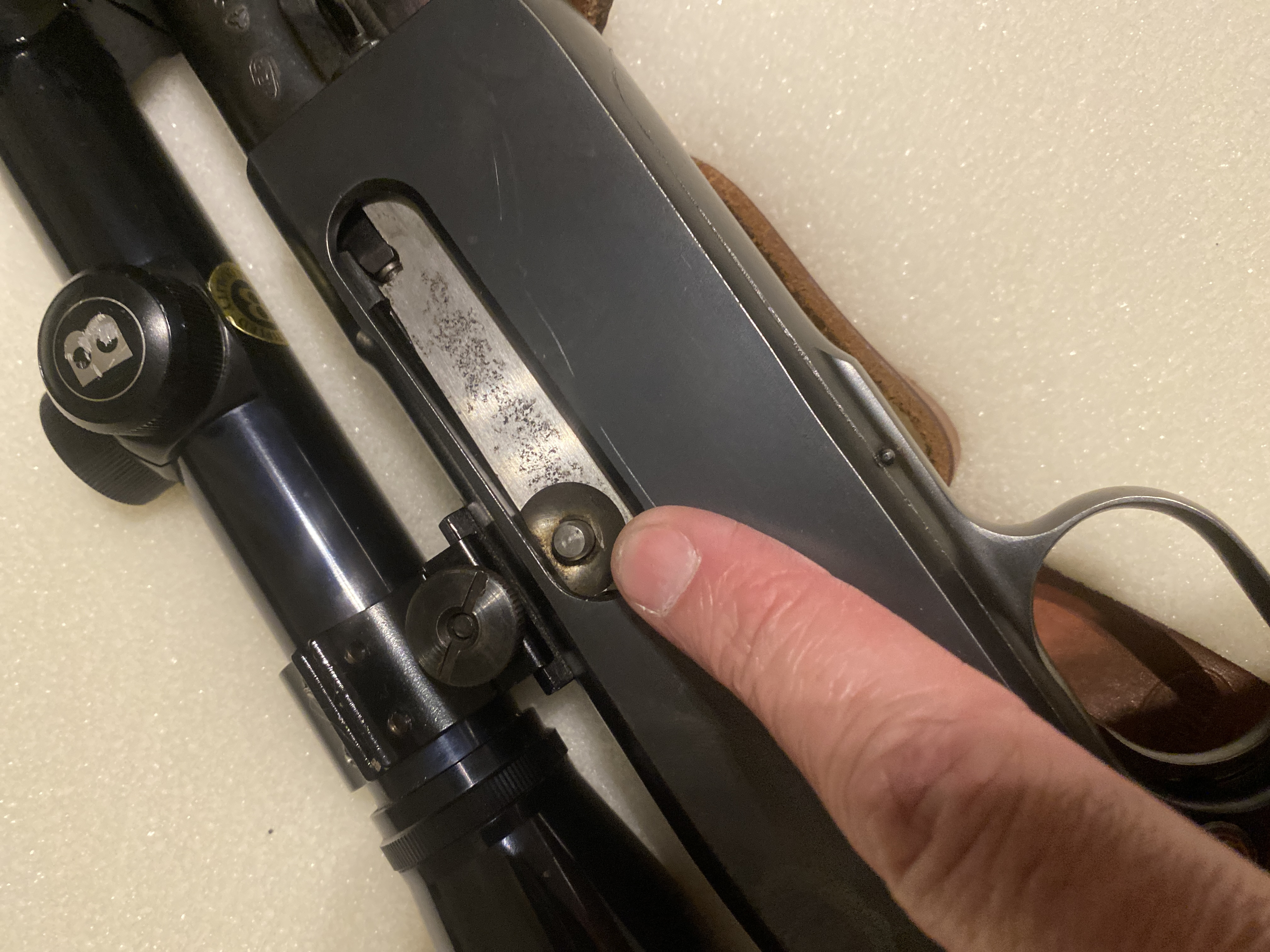

I just inherited my grandfathers .35 Remington model 141. The button to release the pump does not work. When I got it the action was open. I closed it while I was looking at the gun and now it won’t open. I push the release button it feels like a spring or something broke inside. Anybody know anything about this?

Here’s a picture of what I am talking about.

You are correct in that something broke inside, probably the action bar lock which is spring loaded by a spring/plunger in the bottom of the firing pin. Sometimes the arm that reaches up to activate the button release will break off, this seems to happen more on the later Model 141's. It could be something else, hard to determine because the bolt on these things is pretty damn complex (21 parts). The action bar lock can be replaced without fully stripping the bolt BUT these guns (even the 141's) are parts specific in that one action bar lock is not always identical to another.
The repair requires that the bolt be removed from the rifle, a single ping holds the action bar lock in place, the action bar lock holds the spring/plunger in place so it will pop out when the action bar lock is removed. Essentially its easy once you've done it 100 times. Its a whole lot easier than removing the sear because that pin is "pressed" into place.

Forgot to add, turn the rifle upside down and shake it, and see if it will release. Believe it or not, this works more often than you might think.

I know you're getting ready to pack it up and send it to me but try one more little thing before you do so. Check to see if the screw or screws from the scope mount aren't binding with the top of the bolt. I've seen this more than just a few times where the bolt will go forward under the screws but not back out. Something to try before sending it off, probably not the problem but worth a try.
