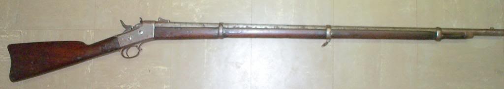

I just acquired a transformed rolling block rifle chambered in 58 caliber Roberts. It has the longer lower tang. The breechblock base is concaved with a morised plate, indicating pre-August 1870 manufacture. The rifle has screwed convex barrel bands with spring retainers and stamped with a "U". It has a tulip cleaning rod, indicating Remington as opposed to Springfield manufacture. It has a sliding extractor. The butplate is not marked with either U.S. or any other marking I can see. I believe I can see the remnants of the ESA cartouche on the buttstock, but it is hard to make it out. Someone said that Remington transformed rifles in 58 Roberts were possibly part of the 5,000 ordered by South Carolina since they also ordered 5,000 Roberts conversions. The thought being that transforming the 5,000 Remingtons to 58 Roberts would keep the amunition the same for both conversions. Did anyone other than South Carolina order transformed rifles in 58 Roberts? Does anyone have any idea who this rifle was manufactured for? I understand that over the years that parts and wood could have been changed out, making this harder to determine. Is there a way to bring out the ESA cartouche without damaging the wood? I am in the process of making 58 Roberts amunition to be able to shoot this rifle.

Just curious about your description of the "longer lower tang", which was only used on Sporting Rifles from what I've seen? Does this longer lower tang have the extra hole, and wood screw going into the wrist like a Sporting Rifle has?

Re: 58 Roberts
Hello,
Thanks for the information. I know this is a transformed 58 caliber musket with the longer lower tang needed to fit the inletting in the 58 caliber musket stock. Yes, the lower tang has the bolt through the stock and a wood screw on the extended part of the tang. It is chambered for the 58 Roberts and may or may not have the ESA cartouche. That is why I was asking if anyone had a method to "bring out" a cartouche to make it more visible. It is very difficult to see, or I am imagining it. Layman says that Remington bought 4,070 musket stocks from the ordance department in June of 1868. If mine has an ESA cartouche, this could be how this happened. I was trying to see if anyone has more information than what I have gotten from the book by George Layman or the book by Richard Hosmer. Layman shows an apparent South Carolina transformed rifle, but says the S C on the buttplate tang is inconsistent with the South Carolina stamp. Does anyone know if Remington made 58 transformed rifles chanbered in 58 Roberts for anyone other than South Carolina?

Re: 58 Roberts
Bob,
Only South Carolina bought the Remington transformation in .58 Roberts.
The stocks bought by Remington were more likely stock blanks — but if actual machined stocks, Remington would have removed any cartouches in reconfiguring the wood with a slimmed wrist to fit the frame.

Re: 58 Roberts
Thanks again for all the information. As I suspected, since my rifle is chambered in 58 Roberts, it is most likely a South Carolina rifle. As I stated earlier, I cannot tell if it has a cartouche or not. I am satisfied that this was one of the 5,000 bought by South Carolina. Stocks, butplates, and other parts may have changed over the 150 years of existance.

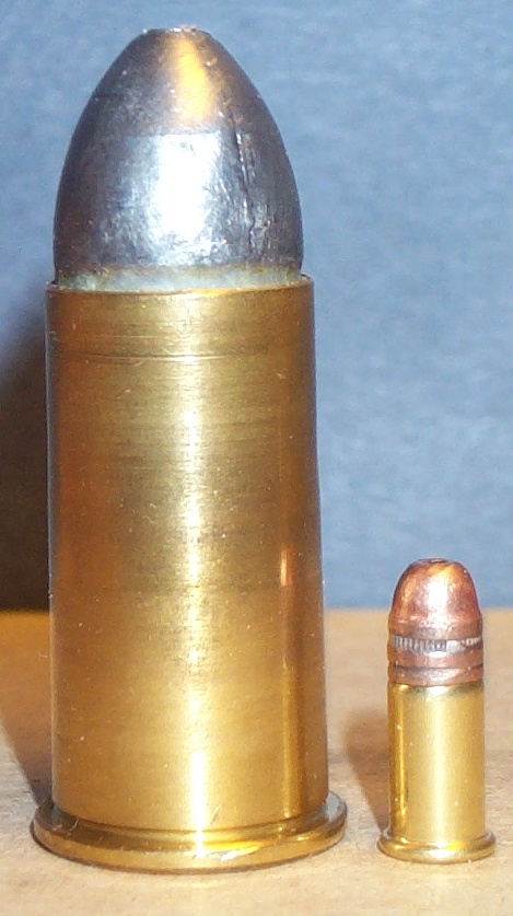

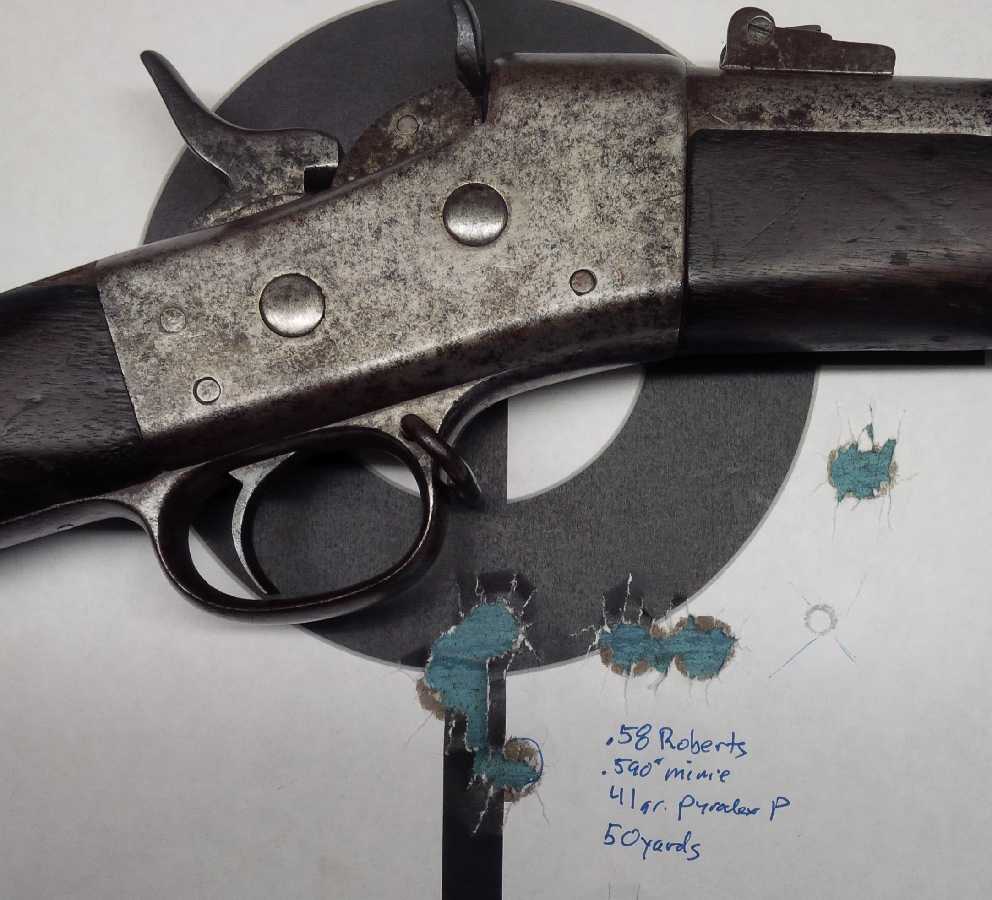

I just saw this thread. I too have a .58 Roberts Transformed rifle. I've looked closely, but found no SC stamps anywhere. It appears to be pretty well beat up on the outside, but has an excellent bore. It makes me think that it could have been used as a drill rifle at some point. But regardless of the exterior, it shoots quite well. It took me a while to work up a good load and find and proper sized bullet. It sure is fun to shoot and always gets attention at the range.
