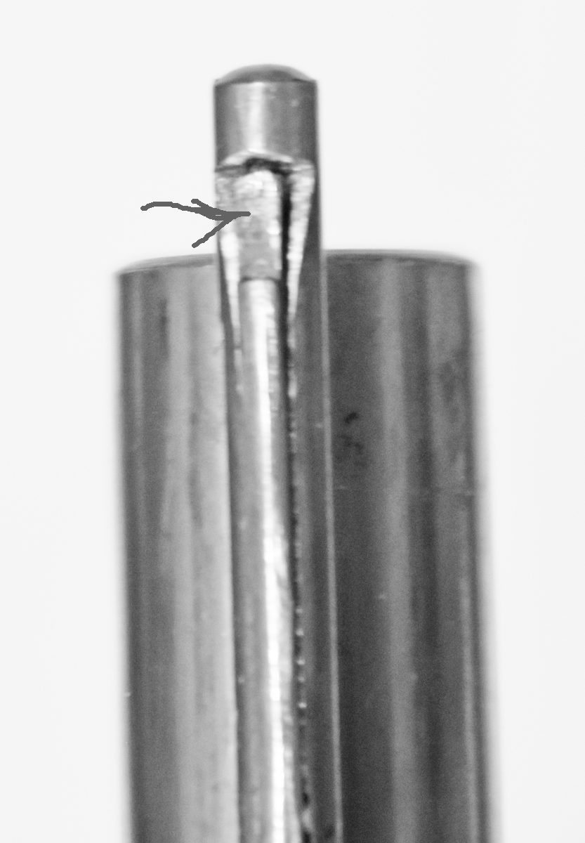

Hopefully the pic will get posted. The pic shows the underside of the tip of the cyl pin. You can see that a notch has been machined into the pin. The "arrow" points to the cyl pin retention spring. here's where the fun begins. If you can, put a couple of drops of gun oil around the spring so it flows down the sides of the pin, toward the cylinder.
[img][/img] [attachment=0]Cyl pin spring - 334-BW.jpg[/attachment]
The spring has to be depressed, not a lot, and then at the same time, push the pin forward. Use a non-marring material, a small piece of wood will work, or something similar. Be happy if the pin just moves a little bit. It may take several attempts. Once past the spot where the spring catches, you can then use the "tool" to move the pin forward all the way. The pic also shows the pin fully forward. Once in that position, the cyl can be removed.

Thanks Dan. I'm trying to soak the pin in penetrating oil wherever I can get access. The think it is just rusted in place. The gun looks to have had some hard useage and not a lot of maintenance. I appreciate your response.

The pin should be relatively easy to remove. I just checked two 1890s, and two 1875, and 3 of the 4 pins can be moved with just a thumbnail. The 4th one moved easy when I use the rim of a cartridge case. It sure sounds like that gun has some serious corrosion issues.
