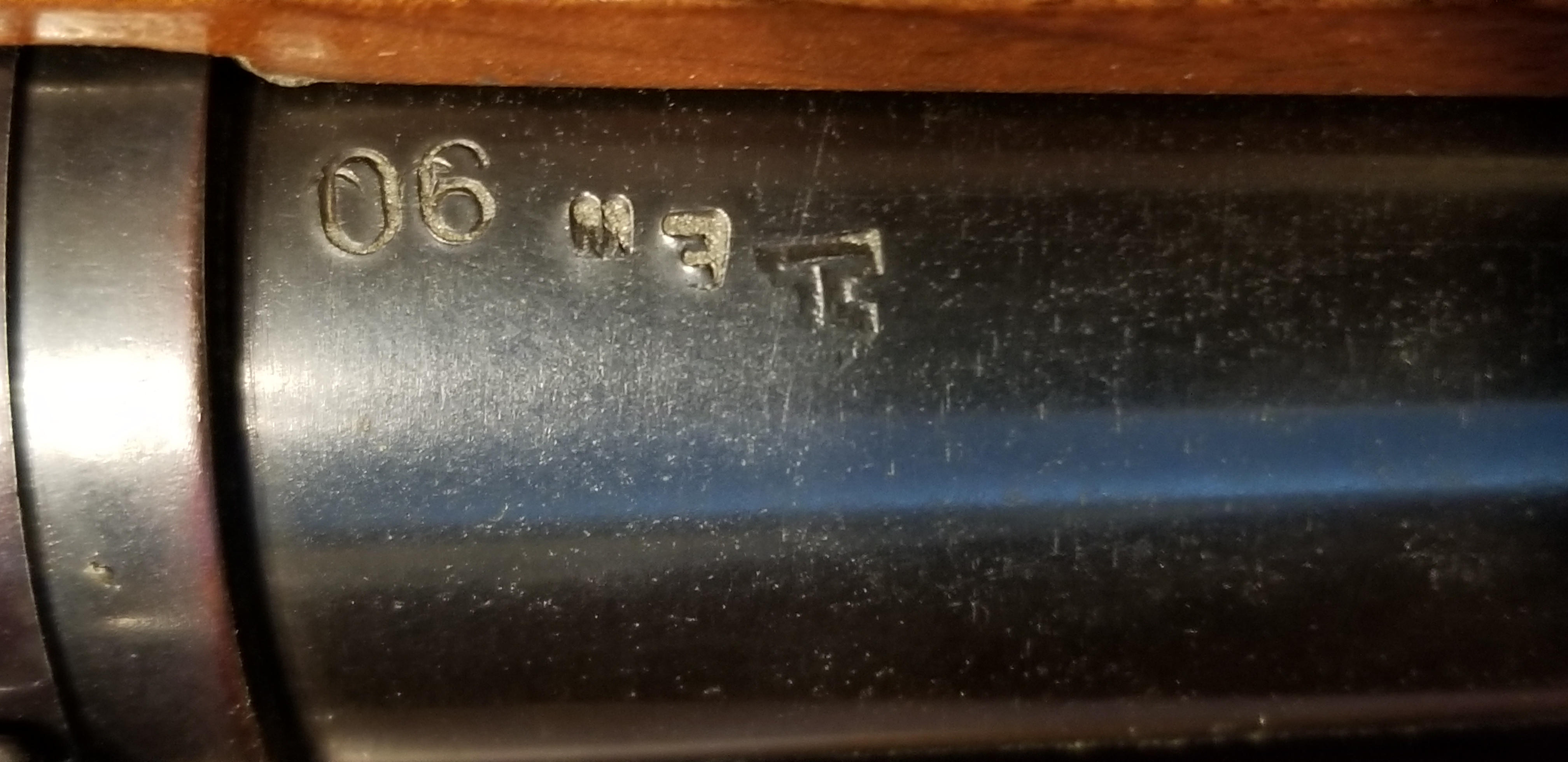

I've owned my 700 BDL-LH .30-06 since sometime in the 1970s or early 1980s, but I can't remember precisely when I bought it. Not surprisingly, the selling gun store went out of business many years back. So I've been trying to "date" it and recently found this site. By using the really excellent information (illustrations and codes) found here, I now think it was made in October, 1972.
However, I'm not 100% sure about that because the stamping on the left side of the barrel is not terribly clear.
I've included a photo of that portion of the left side of the barrel in the hope that someone on this forum with experience interpreting these stampings can either confirm what I think it means or provide a more correct interpretation.
Based on the illustration posted here, I believe the first stamp is the Final Inspection mark. The second appears to me to be a slightly askew "E" (which I believe corresponds to "October"). The third is more difficult for me, but I think it may be a lowercase "w" (which I'm guessing corresponds to 1972, though the chart shows it as an uppercase "W"). The last two characters stamped are "90" and -- from the illustration I found here -- I assume they identify the "Assembly" (although the illustration shows only a single character for this).
Is my interpretation correct and, if not, can someone please decipher the correct interpretation for me?

There has been no re-print of John Lacy's book. Add a search on ebay and hope to catch one early.
As for your rifle, I believe you have deciphered the information correctly. Your serial number will start between 666 and 669
