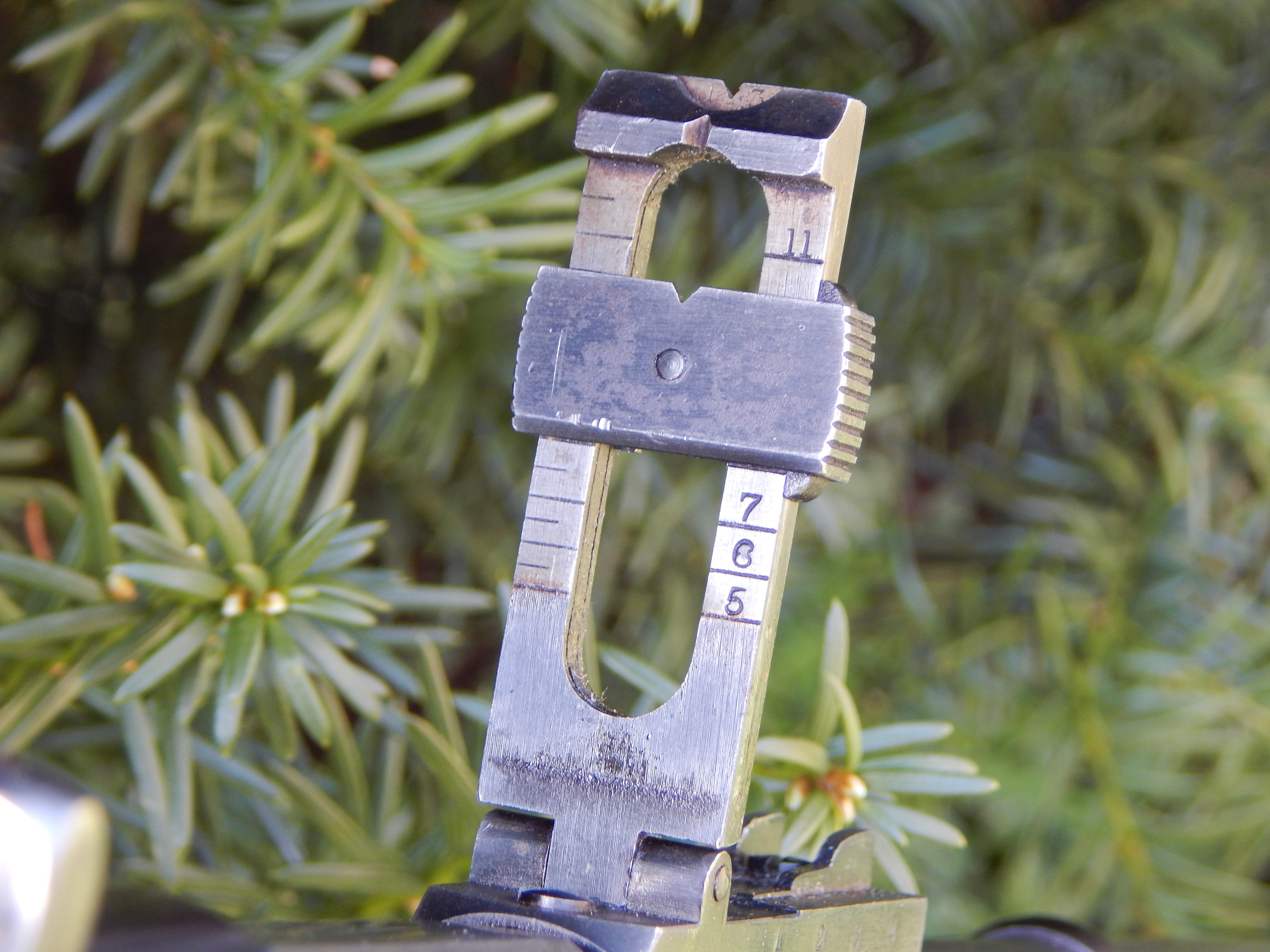

Another thought. Will the existing sights work with any type of ammo or are the sights specific for certain types of ammo?
This is the style I have for the rear.
Posts: 492
Re: Rolling Block #1 Barrel replacement
Post by marlinman93 »
They will work, but may not be accurate for distances shown. A nice addition would be D&T the top tang and using a modern repro of the period tang sight. The one on my project gun is a long-range version built by Remington in the late 1990's when they brought back the Rolling Block rifles. I bought all the parts from Numrich Gun Parts for $135, and simply assembled them. The lower tang/trigger guard, and stocks also are the 1997 Remington items. So my project is all Remington parts, plus a GM barrel. A Frankenstein.
