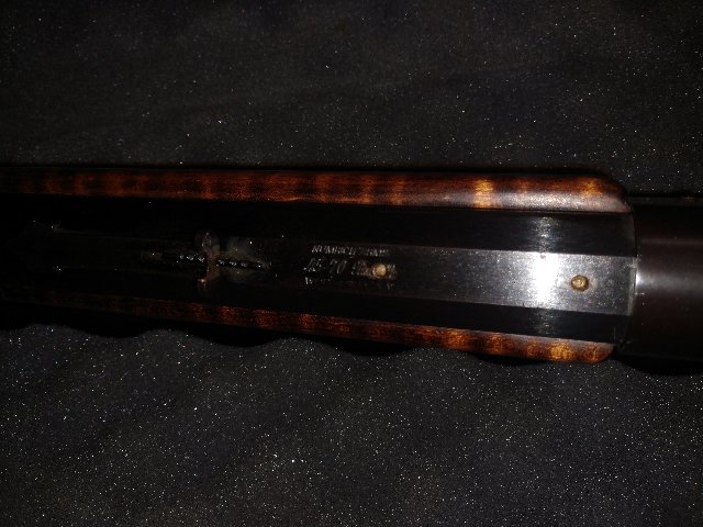

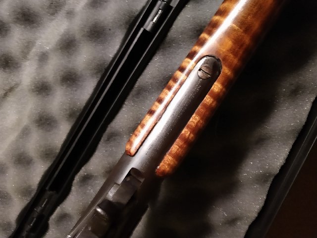

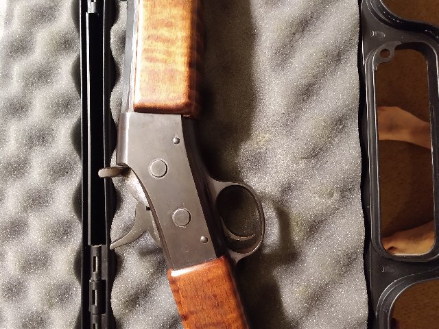

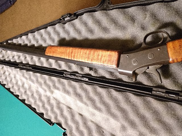

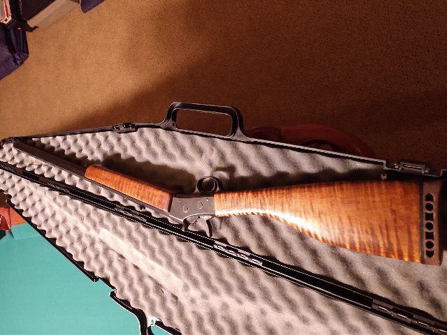

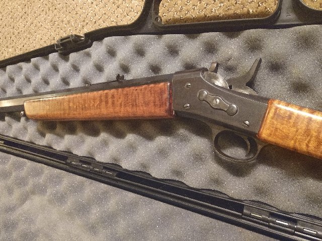

Need some experts to help ID my Remington Rolling Block. Numrick Arms .45-70.
From researching I believe Numrick Arms made kits with the new barrel and stocks.
The serial number, which is hidden behind the stock, is a low number three digit 1xx.
Can the experts advise what my Remington is and its value? I know from researching the action was very strong and could handle smokeless ammo.
What ammo would you recommend me using to fire it?
Thanks for your assistance,
Robert

Hi There,
I believe what you have is a later rolling block action.
They are called the No. 5 action and these were made
for higher pressure cartridges (like 7x57) originally.
Seeing that yours has the bar type extractor, it is an
earlier version (made from 1896 to around 1901 or 1902).
In 1902, the action was updated to the Day extractor
system that was more like an ejector than an extractor
(it will kick a spent shell completely out of the action).
The number stamped on the left side of the tang is not
the serial number. It is a lot number. Rolling blocks were
made in lots ranging from 10,000 to 35,000 units. Once
a lot was completed, the numbering was restarted in the
next lot. frames and trigger guards were mated and the
lot number made it easier to keep the two parts together
through manufacturing process.
As to value, I feel inhibited to put a price on it. It is mostly
subjective to the whims of the market. 45-70 is a popular
cartridge and the rise of BPCR shooting has made rolling
blocks in large BP calibers more popular (but I don't know
the quality of the Numrich Arms barrels and their suitability
to this sport). The action by itself is probably worth between
$300 to $500. The rest will depend on the quality of the work
done.

The mistake in the Bluebook of Gun Values might be based on the difference between #5 military rifles and #5 Sporting Rifles. The #5 in a Sporting Rifle is very rare, but military versions are plentiful.}
Yours is a military that someone reworked into a Sporting Rifle. Possibly Numrich, since they built some, but they sold kits, so it could be someone else bought the kit and assembled it.
Prices vary according to how well the gun was done, and fit and finish, plus wood quality are big factors. Not to be mean, but your gun doesn't have professionally fitted wood, as the rounded edges where it meets metal are more amateur workmanship. And since it wasn't color cased again, that reflects a lower quality build also.
Hard to say a price, as the market will determine that. But I'd be pretty surprised if it got over $750 in today's market.
